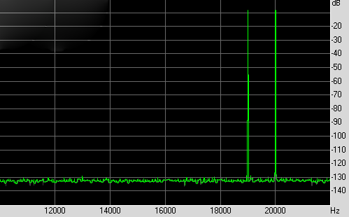

I've noticed, most people use 8R load. I prefer 4R, 8R is a lite load, handy for nicer thd numbers.
K200v3 bipolar buffer THD 30Vp 10kHz
4R - 0.0017%
8R - 0.0006%
Hi LKA,
Those are fantastic figures, but so far as a result from LTSpice I presume ?
Have you already had the opportunity to measure these figures live ?

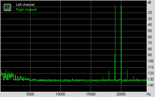

About the difference between 8 and 4 Ohm, I still have live recordings of IM distortion of 80Watt@8R and 160Watt@4R (notice the different freq scales).
And yes, 4R gives the Amp more work to do resulting in worse figures.
With LTSpice, the 80Watt/8R version was spot on, but I got the third image for 320Watt@2R that is even better as my 160Watt@4R measurement.
So the proof of the pudding .....

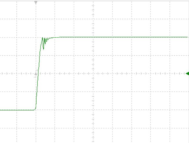

Hi Hans, The aux. circuit extracts the derivative of the output to magnify the crossover aberrations.
I switched to my non-switching version. Not only the circuit is stable ,it has an astonishing transient.
The error corrector can be very precisely adjusted, if under, the output is less than the generator, if over, than the output is more than the generator with negative input impedance. Strangely, it requires a symbolic inductor in feedback ,even 0 henry or else the distortion goes from 0.0072%to 0.01%. If the inductor is replaced by a 100 ohm resistor and a high value grounding resistor to reduce the feedback, than the output goes over amplifying . This circuit can also include current feedback.

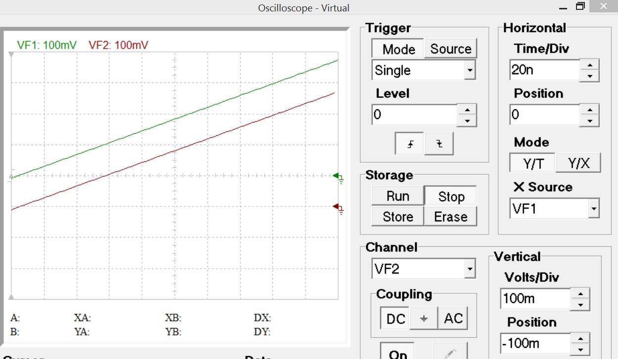

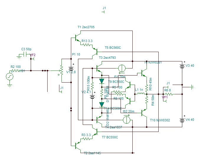

Hi LKA, can you export your K200 in format .LIB or .CIR .Tina distortion measurement is not straight forward, it needs to adjust a certain delay and verify with more delays that the value is mostly probable. With AKSA , we tried on the same circuit measurments, he never got as low value as me with Tina.

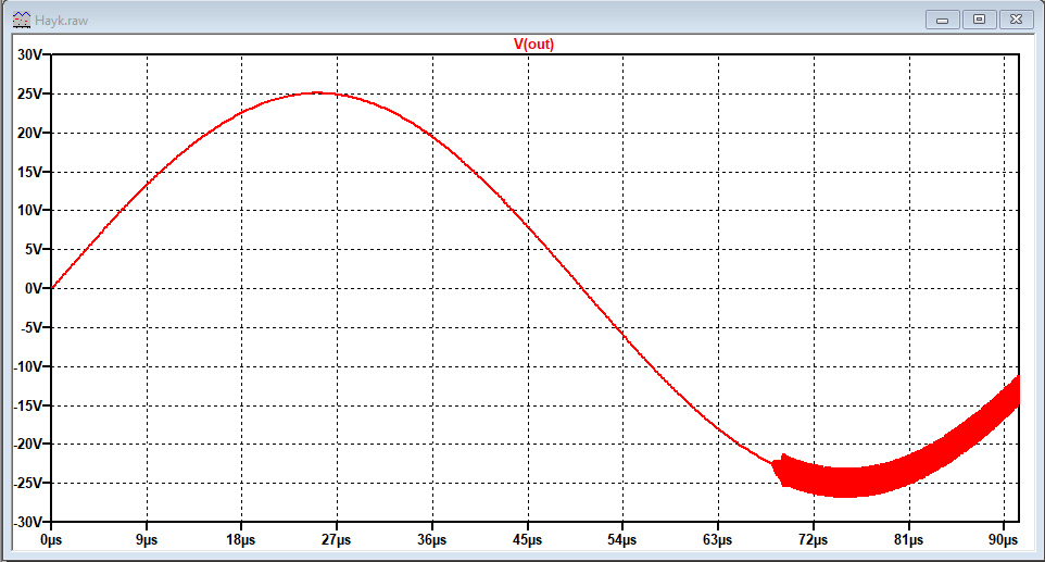

Hayk,
I modified the according according to your last version with only one output pair.
The max Sinewave input voltage is 2Volt. Everything above and oscillations are there at 15Mhz.
For 2Volt, I have shown the FFT.
Tell me what I'm doing wrong, because this cannot be what you have in mind.
Hans

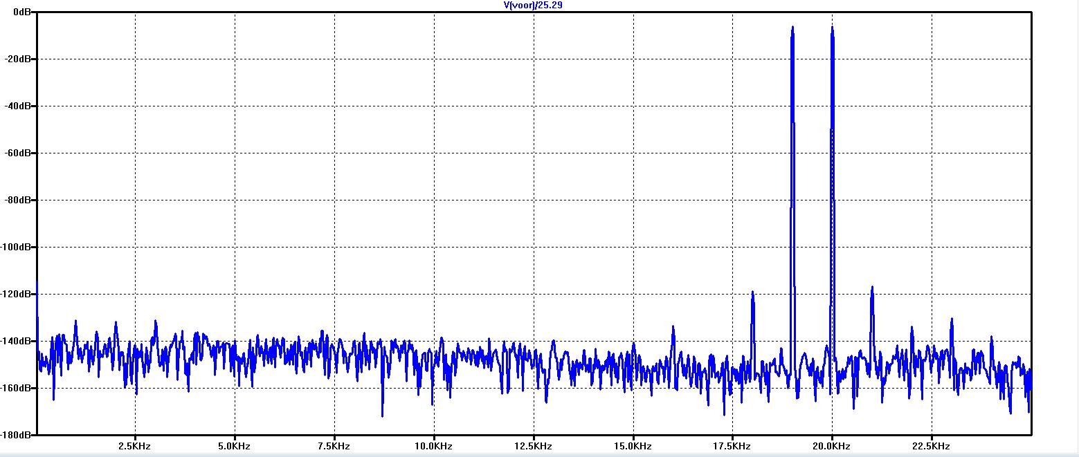

Hi LKA,
Thanks for your image, you have published this before.
1) In posting #71, you have shown a 100Watt/10Khz measurement having a distortion of the buffer alone of ca. -66dB, or 0.05%.
2) In the image you just gave, I see a measured 0.005% or -86dB at 100W@10Khz for the non GNFB situation, so this must be mainly distortion from the K200V3, right ?
3) But in posting #78, you mention 0,0017% distortion at 100Watt@10Khz or almost -96dB from LTSpice.
Those figures are 30dB apart, so I hope can understand that I'm a bit lost in your figures to understand what is what.

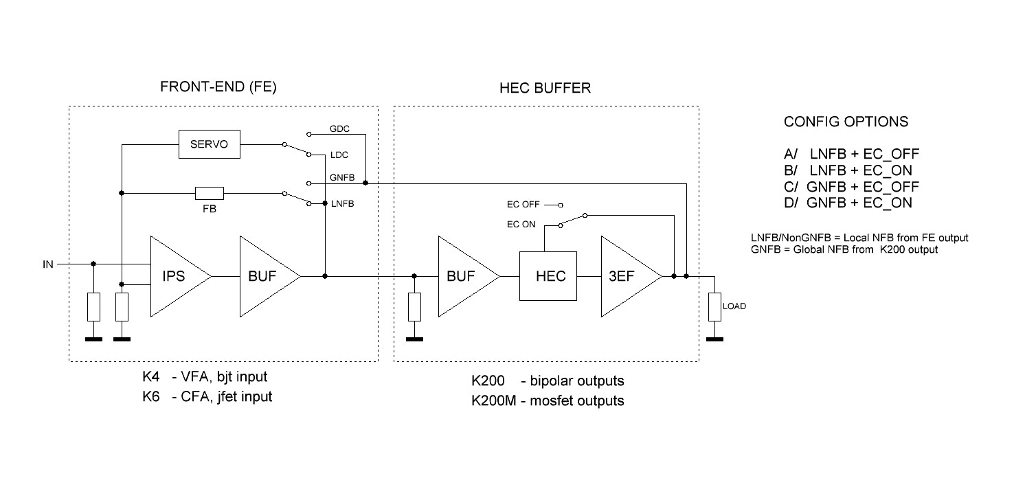

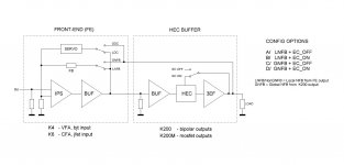

I hope attached picture helps to clarify things.
"1) In posting #71, you have shown a 100Watt/10Khz measurement having a distortion of the buffer alone of ca. -66dB, or 0.05%."
I guess you mean post #54.
This is a completed amp (chassis, SSR, etc) which I name KLA200.
Measured option A and B.
A/ 100W/4R/10k = 0.03% (LNFB, buffer without EC)
B/ 100W/4R/10k = 0.004% (LNFB, buffer with EC)
"2) In the image you just gave, I see a measured 0.005% or -86dB at 100W@10Khz for the non GNFB situation, so this must be mainly distortion from the K200V3, right ?"
Post #83.
Bare modules on the bench (no SSR protection)
B/ 100W/4R/10k = 0.0035% (LNFB, buffer wit EC)
D/ 100W/4R/10k = 0.00045% (GNFB, buffer with EC)
"3) But in posting #78, you mention 0,0017% distortion at 100Watt@10Khz or almost -96dB from LTSpice."
Yes, this is a simulated option B
LKA,
Thank you for your extensive explanation.
As I mentioned, my main interest was for the HEC buffer.
You made clear that LTSpice shows 17ppm versus a 35ppm distortion measurement, both for the HEC buffer at 100Watt@10Khz.
Still confusing is the 10Khz spectrum that posting #71 is showing for the HEC buffer.

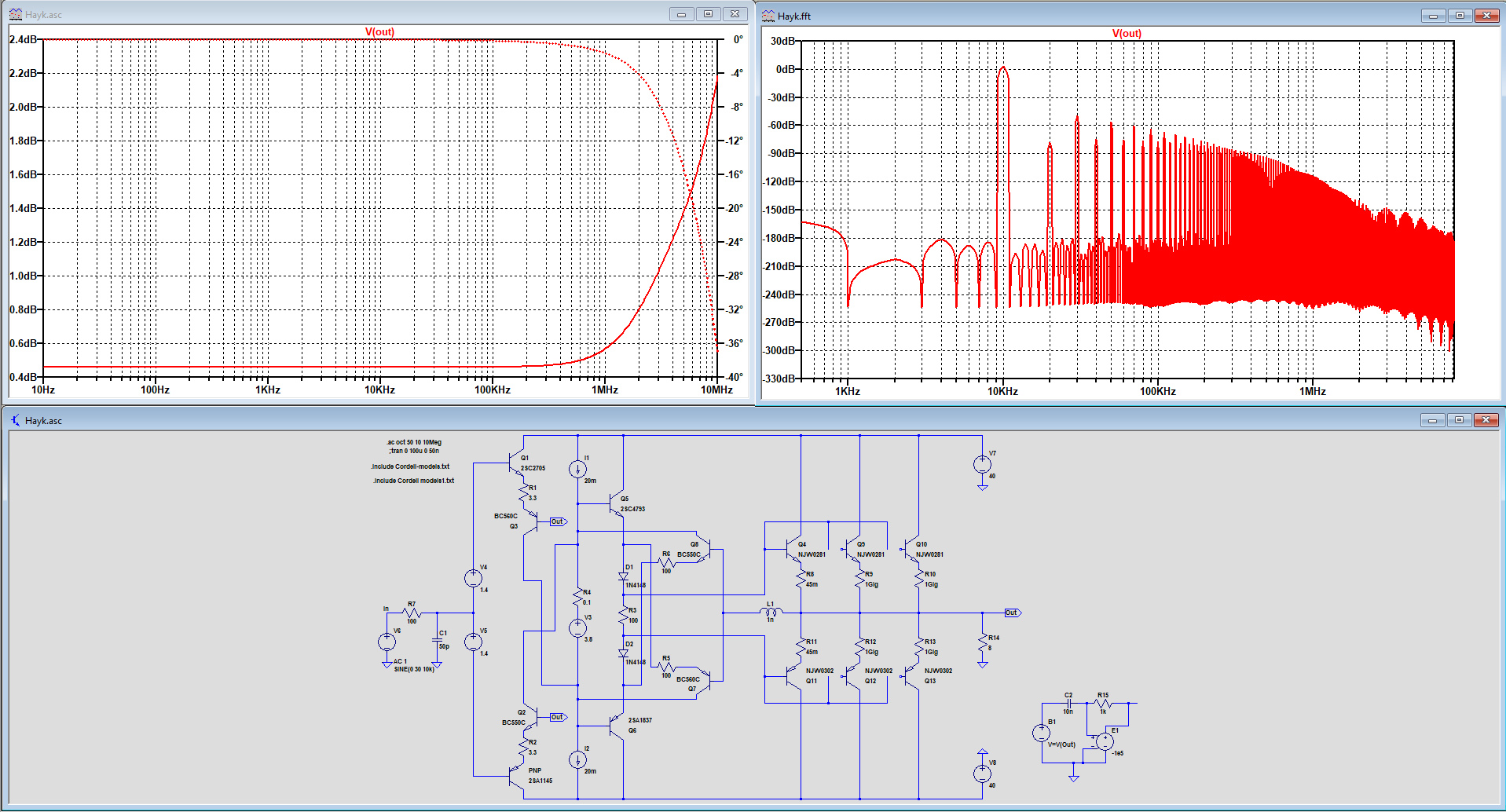

Hayk,

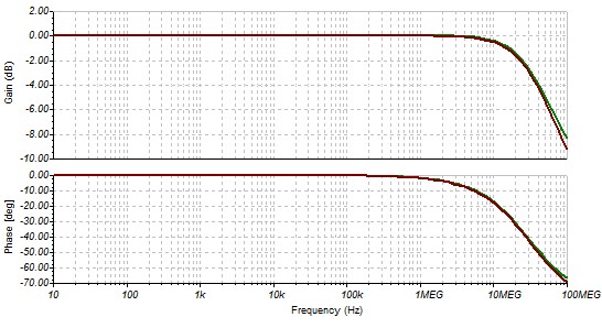

I didn't want to further take the route of going up and down between LTSpice and your Tina, so I tried a few things myself and got the thing stable.
Using the 80pF at the input that you suggested, and adjusting the idle current to the same 75mA that LKA is using.
I switched the BC550 and BC560 for the 2N5401 and 2N5550, and had to place 100nF caps par. to the 1N4148 diodes, see first image below.
Looking at the 9.5dB peak in the FR response with 80pF at the input, it's obvious that 15Mhz is the frequency where the thing likes to oscillate.
Without this cap, the peak is even close to 20dB.
So you must definitely try to get this peak down.

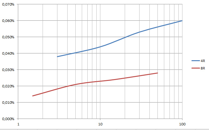

Anyhow, I could now measure distortion for 4R and for 8R, which is shown in the second image with Watts on the horizontal axis.
