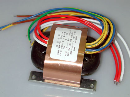

I am leaning towards a 50VA R-CORE transformer from DIYCLUB Biz that is off the shelf 4 x 0-18VA. That is an even split of 4 x 694 mA secondaries which would provide 0-54VAC @ 694 mA and 0-18 @ 694 mA. This would be plenty for a Kari's BOSOZ power supply and two preamps from what I have read.
These R-CORE transformers wiegh 0.7 Kilograms each, 454gm equals 1 pound for our non metric friends. This makes these transformers a hefty product to be sure, which at least to me indicates that are not some cheap trinket.
I do not reccomend EI transformers for preamps Due to the Magnetic field they generate and Toroids generally have too much bandwidth to be inherently quite. I think an R-CORE is the best choice for this application. I have attached a Photo, they look to be of good quality and have the rough dimensions of 3.5" square and 2" in hieght.
