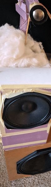

Headshake's far field 3way

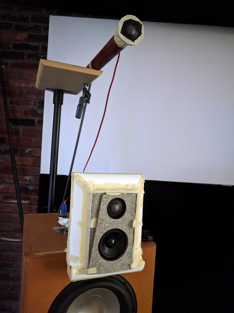

The speaker is all stacked up. So much effort just to put a box on top of a box!
I think it looks like a Neopolitan ice cream sandwich with the temporary baffle.
I will measure it some more this week.

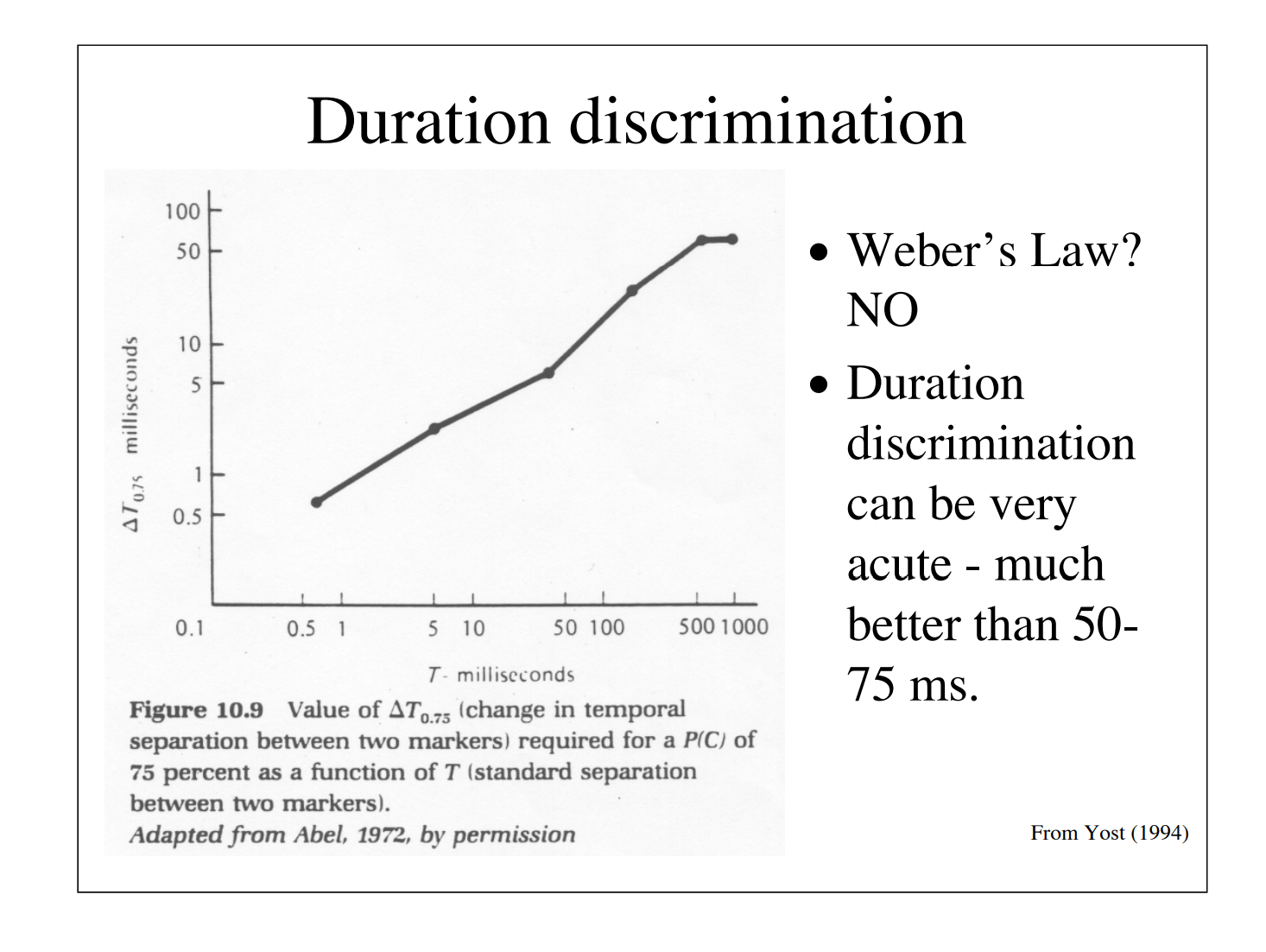

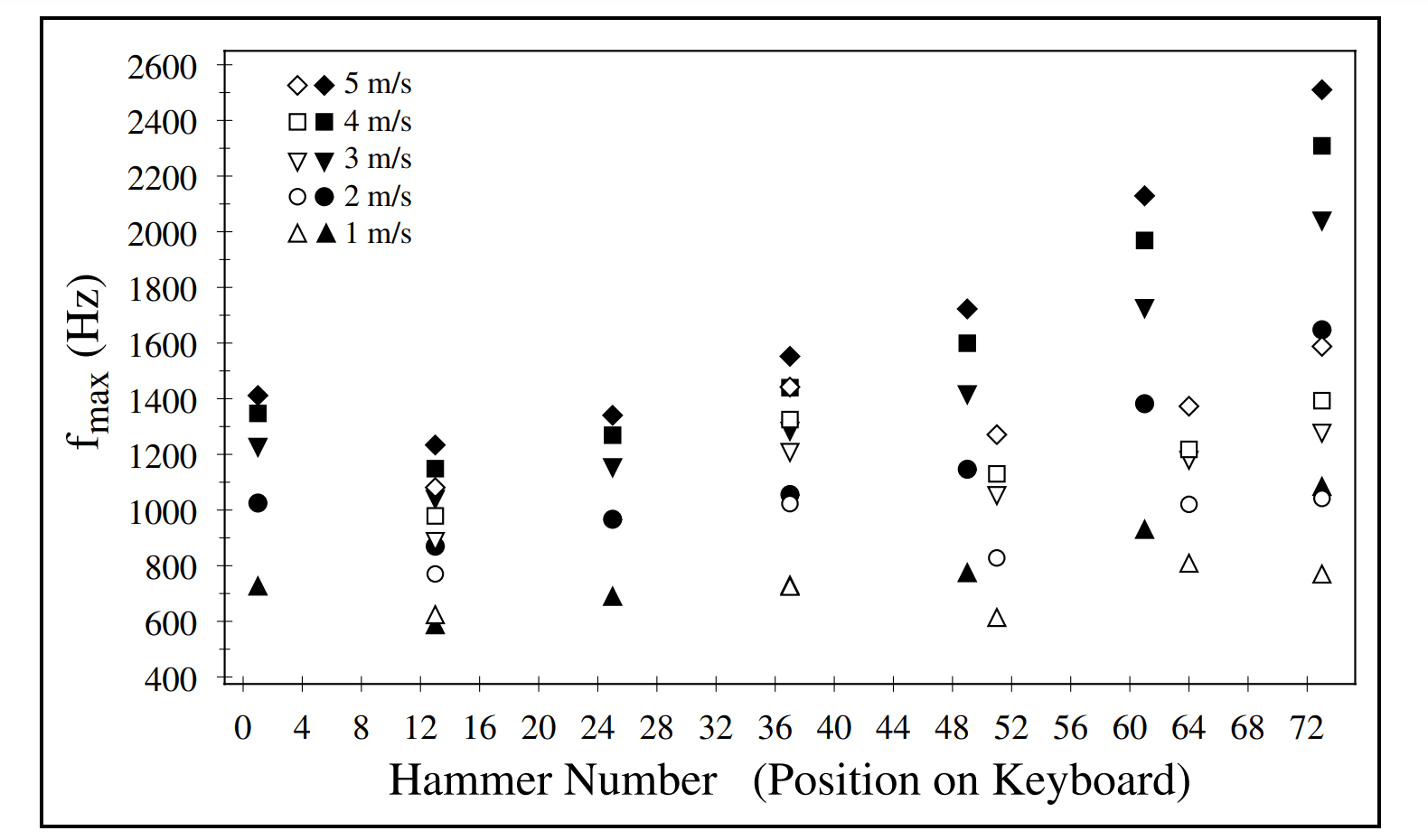

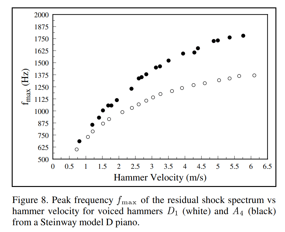

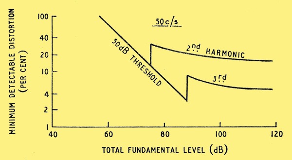

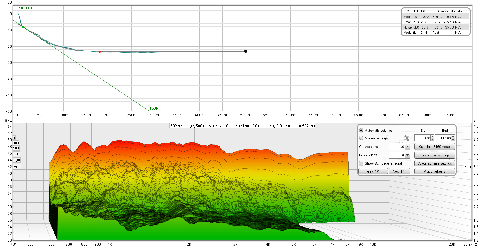

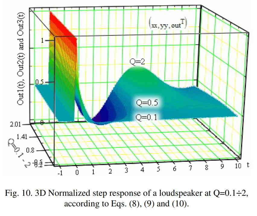

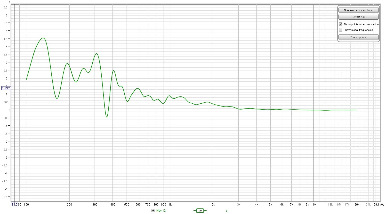

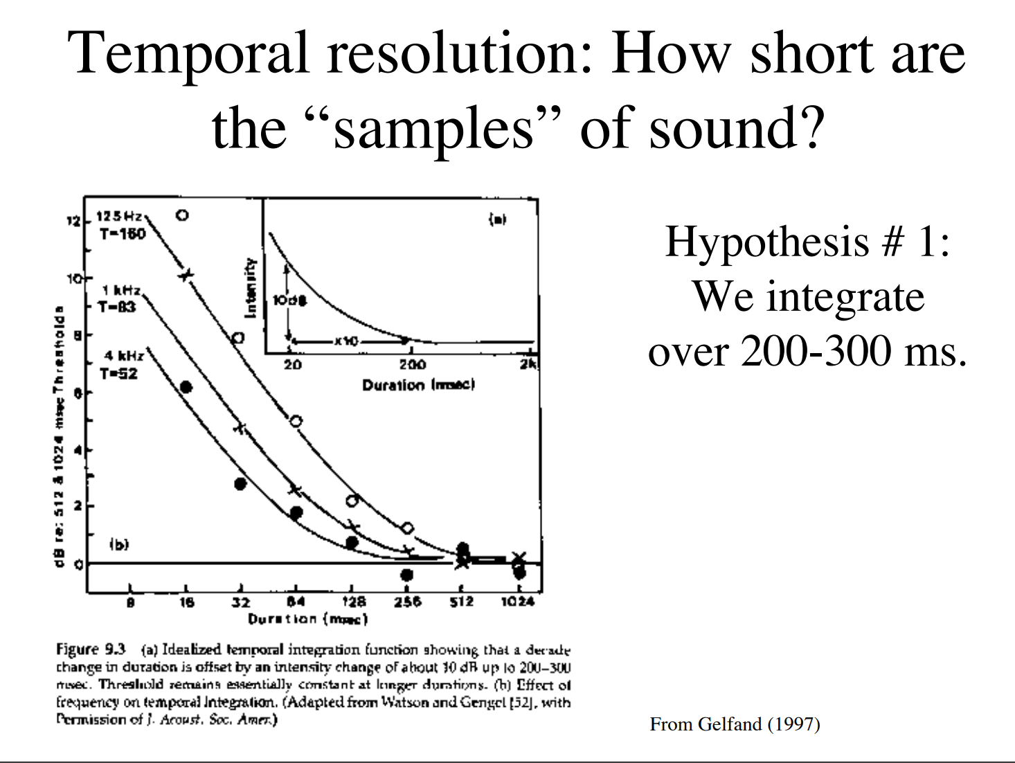

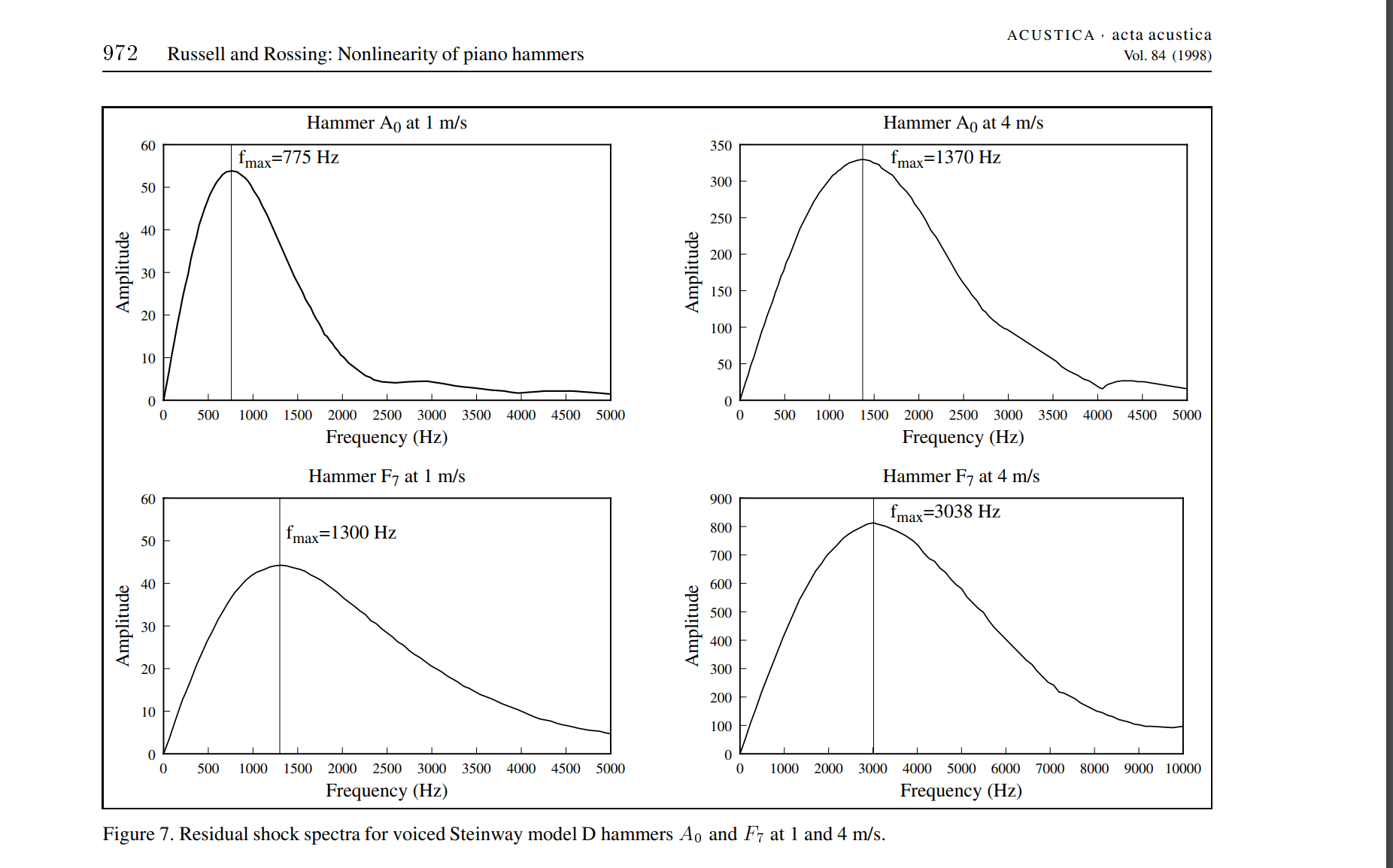

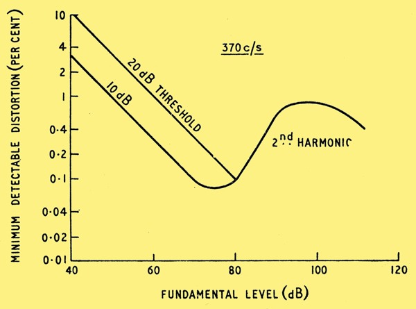

I collect all kinds of graphs and images and need to clear some things out but thought would post before I delete them. So here is a bunch of rando stuff that I think is interesting to see:
step_Q_response.pngrussell_rossing_piano_hammers_graph.pngpiano_delay.pngpiano_hammer_velocity.pngauditory conclusion.pngduration discrimination.pngtemporal resolution.pngmin_detect_dist2.jpgdetectable_dist_percent.jpg
I based many of the choices for the current speaker off these graphs.

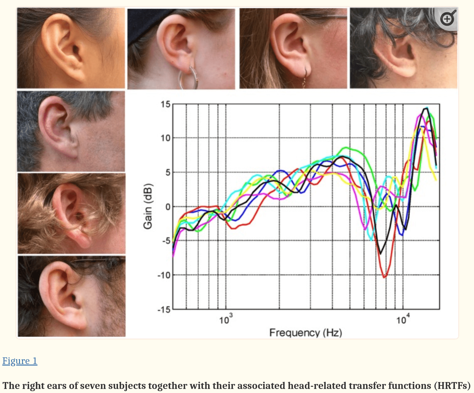

while looking for a paper for another thread, I found this cool one:
They put a mic in an ear canal of a bunch of right ears. Around 3-5khz seems most similar.
https://www.ncbi.nlm.nih.gov/pmc/articles/PMC4123622/
I wish they tested some bald folks.

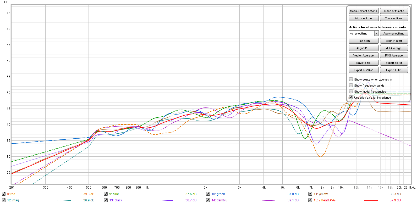

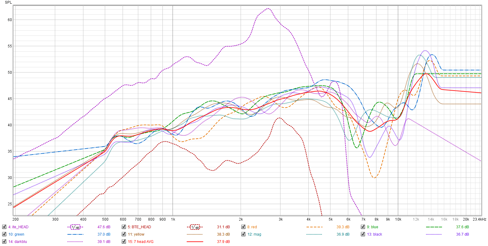

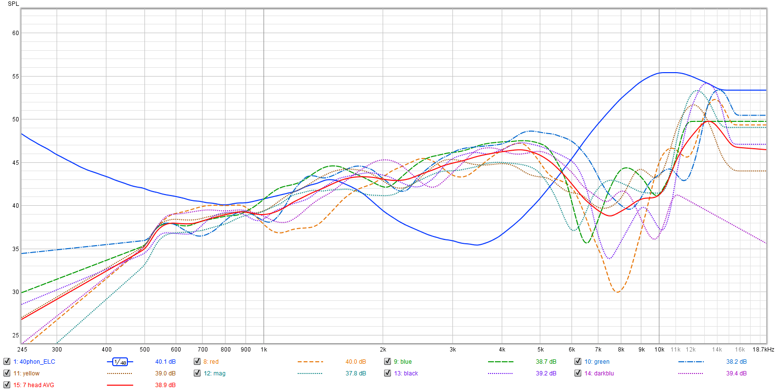

I traced the data for the real ears in the last paper and put them with the paper that measured a lab head. The equal loudness countour is there too.
blue equal-loudness c. . solid red is the average of the 7 HRTF from the right ears.
lab heads vs real heads.
Real heads with an average.

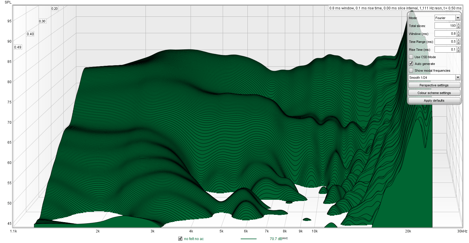

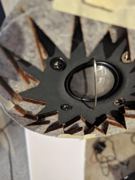

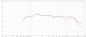

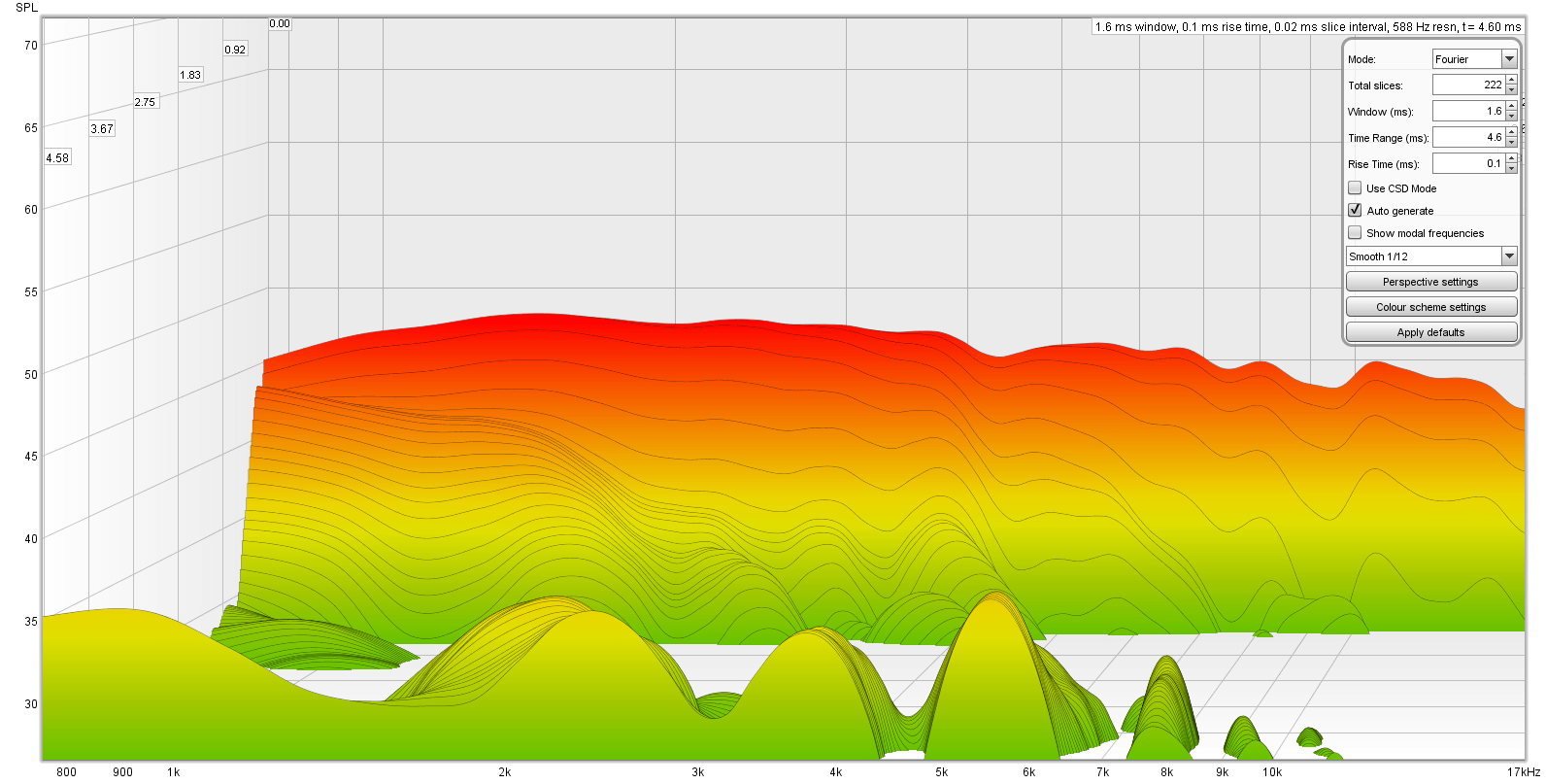

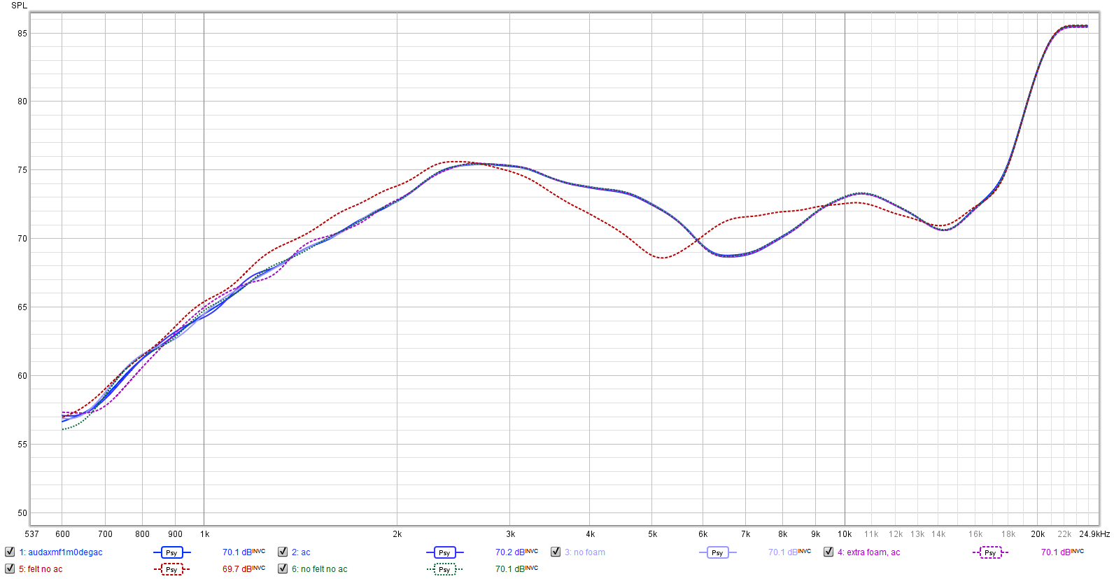

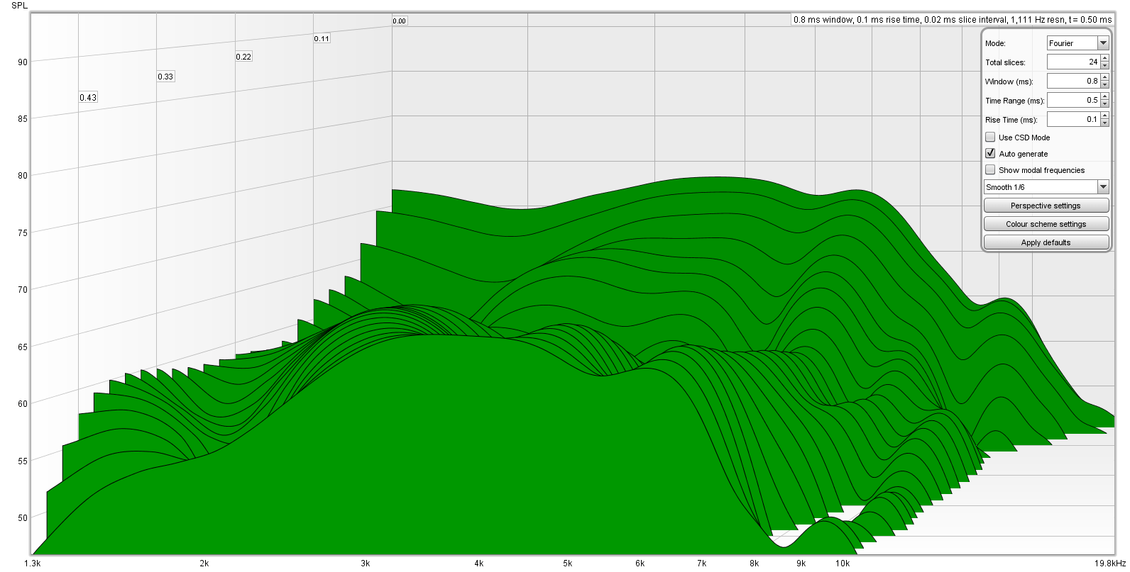

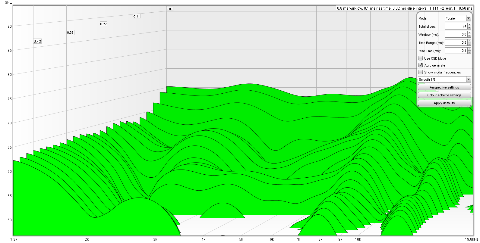

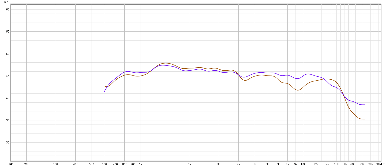

Ok, raw data from the audax Mg on a stick.
I did some measurements moving around foam and with the ac on or off. One measurement was done with some felt scraps from another experiment. Moving things around and the AC did not change much. The felt changed things the most.
I will try the t25b on a stick next.

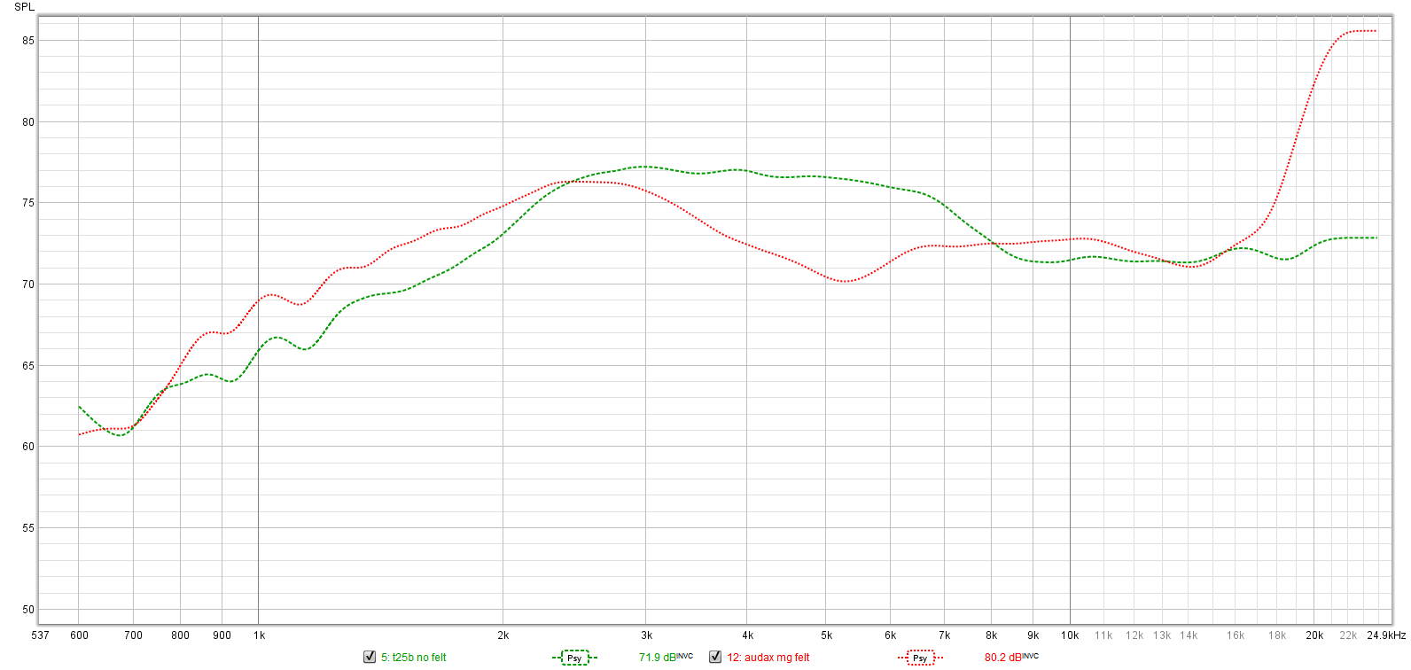

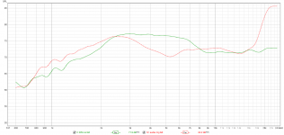

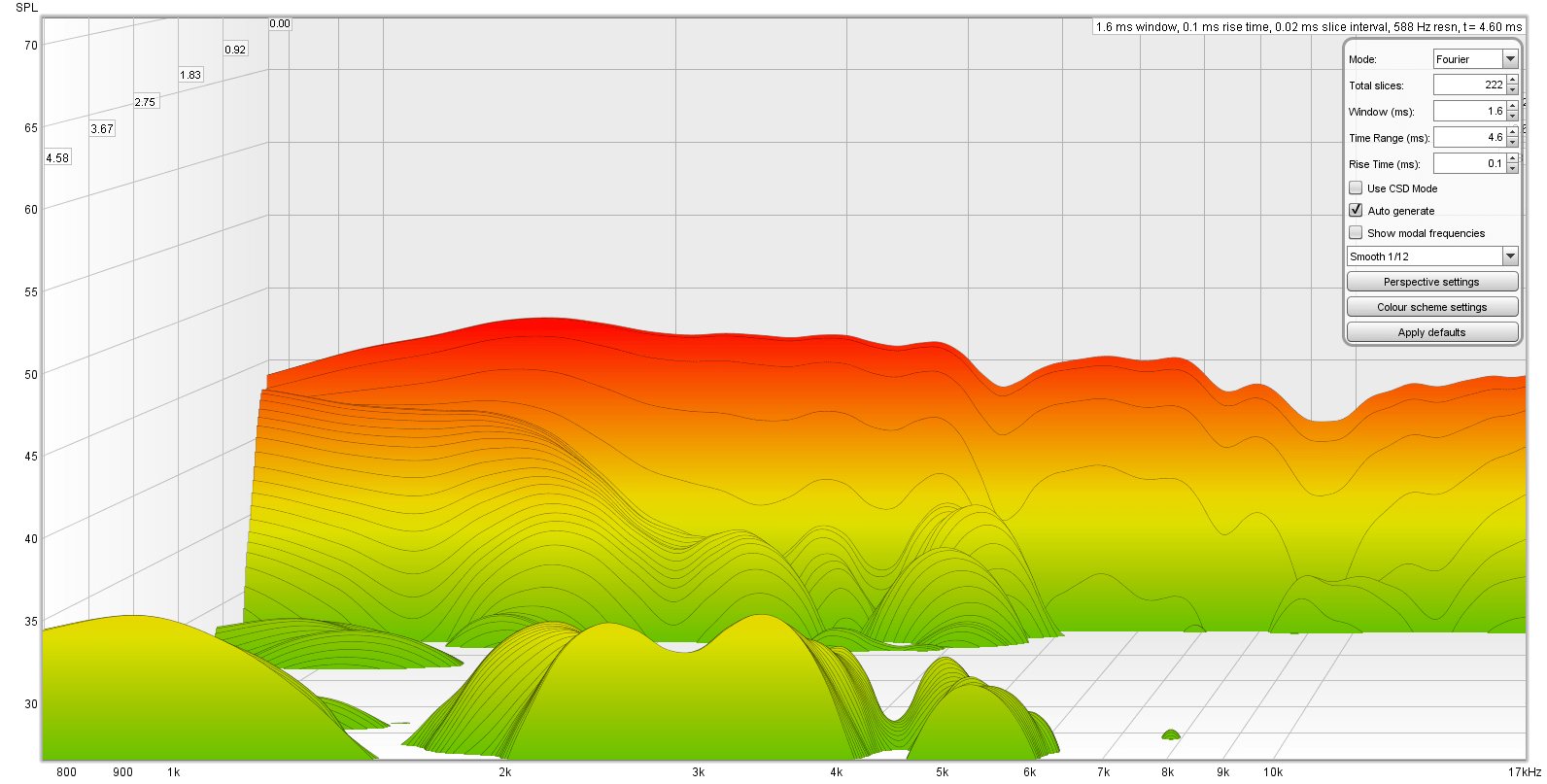

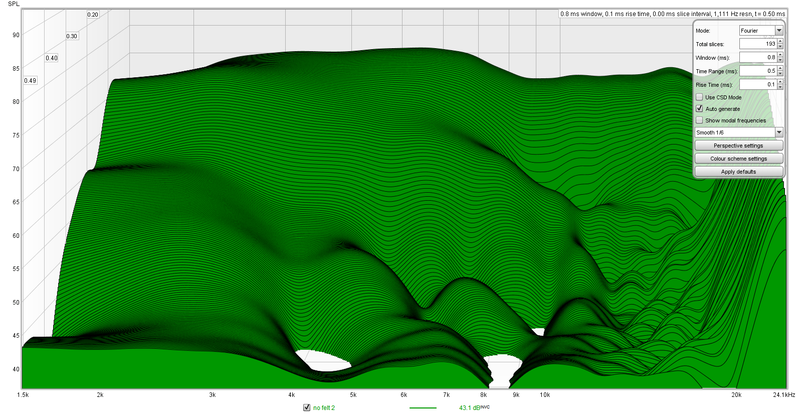

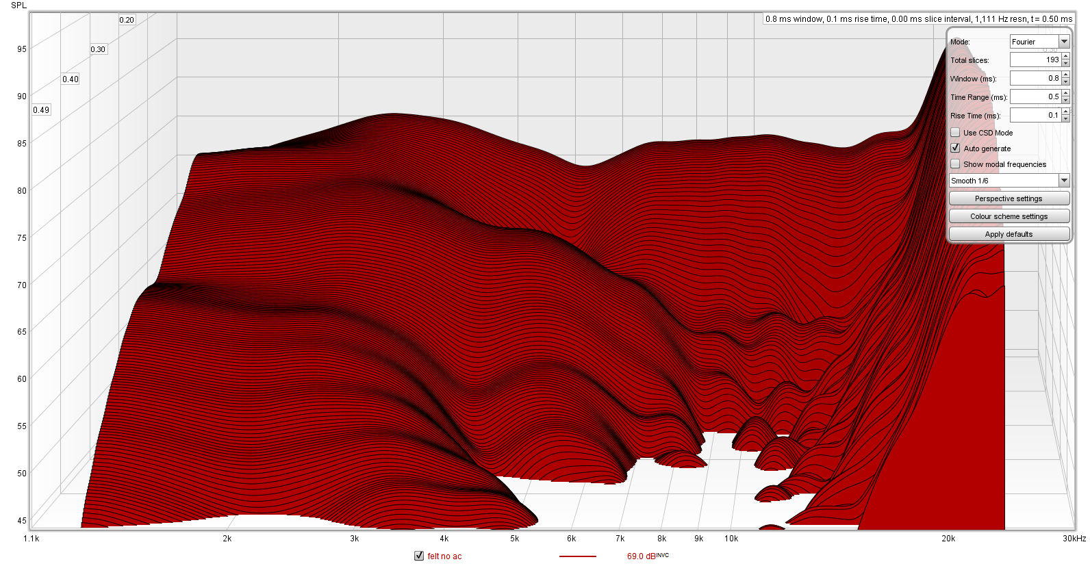

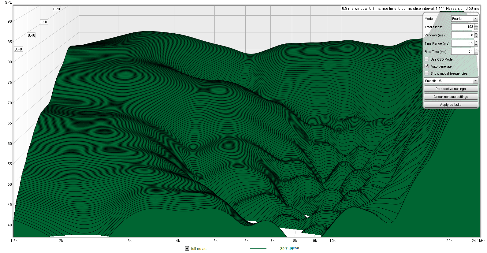

T25b on a stick. The felt here stuck out like a starfish past the edge of the tweeter. This did not help anything. So it seems like if I do anything with felt it should be just to the edge.
Since the Audax Mg did best with felt I have the data from that vs the t25b.

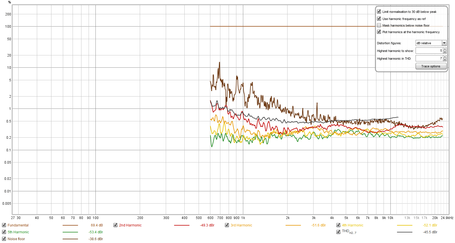

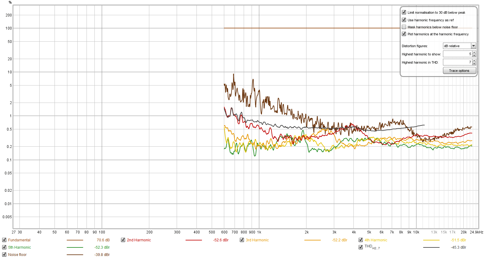

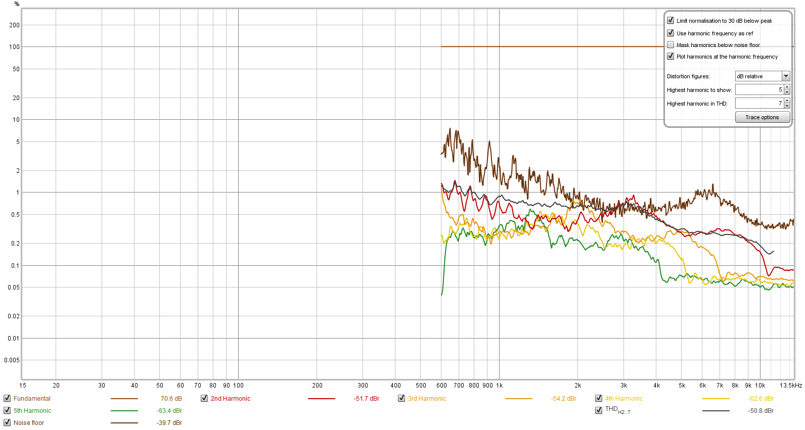

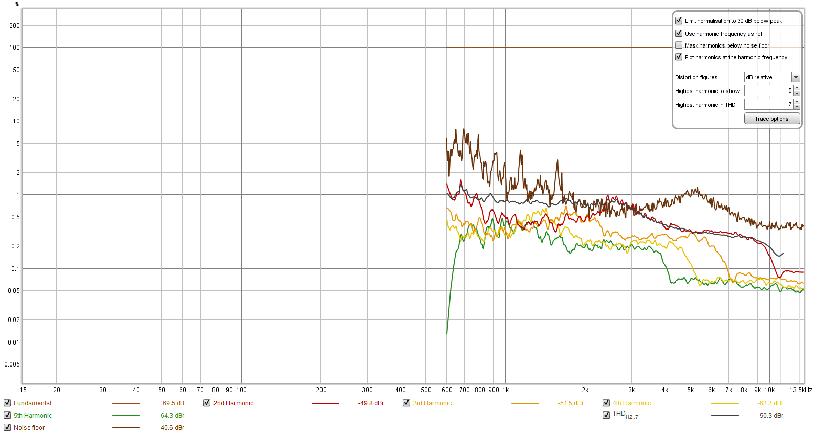

Distortion with and without felt on the t25b;
It seems like the motor is just as much of an issue as diffraction. Ugh.

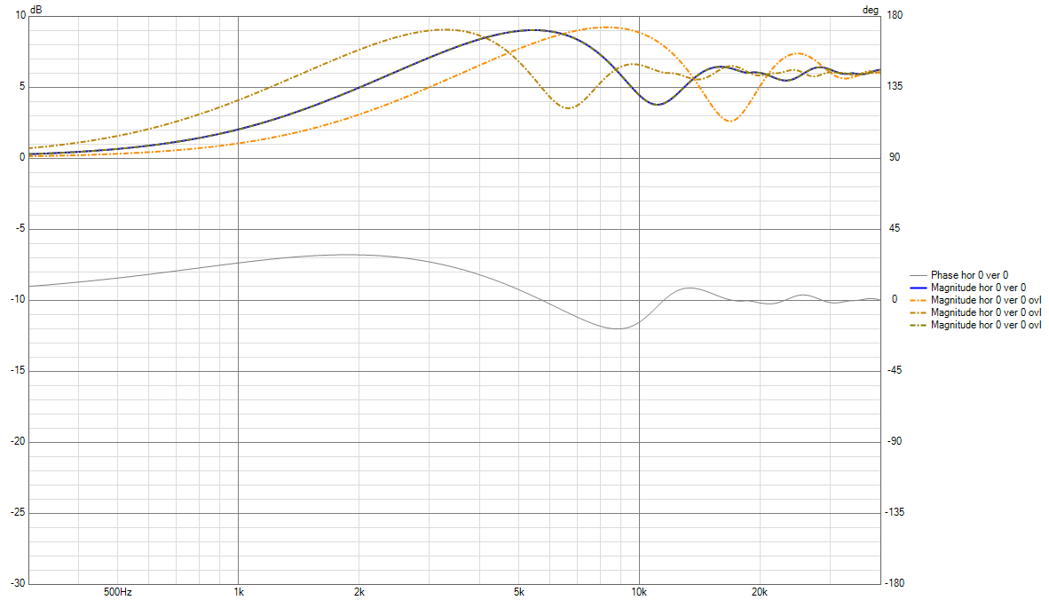

Made a quick sim of a few baffle sizes-100mm,70mm, and 40mm.
This goes with the two green graphs in the previous post.
The audax looks spot on for something 100mm. The t25b does have a dip where the sim says it should around 10khz. The interesting part is the dip is -10db down and a little lower at 9500hz.
I wonder if the diffraction is happening -10db down and not at 0db is due to the material, grill, or just the shape of the sound coming off the dome. Either way, the decay is interesting in that it ignores the diffraction for a bit.
It is quite difficult to get accurate baffle diffraction simulations very high in frequency. The shape/thickness of the domes and surrounds together with faceplate shapes can have quite an effect. Vituix is predicting based on piston size which becomes increasingly less likely to be correct as frequency rises.

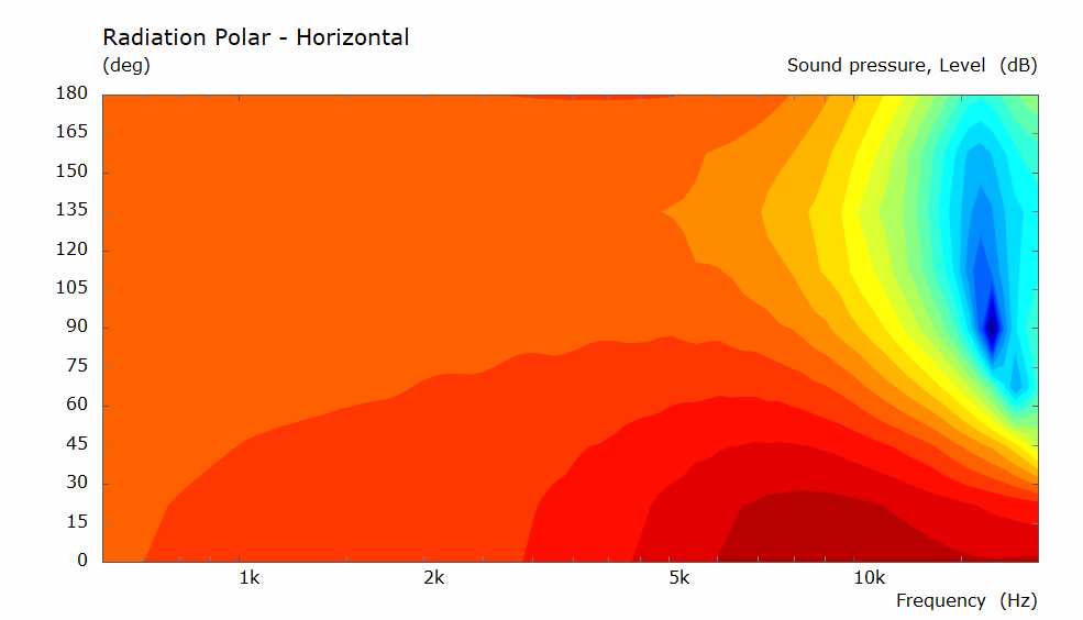

A question for polars.
Generally it is more productive to use design methods, or to use simulations with a view to reducing diffraction in the first place rather than to trying to balance what diffraction there is for a smoother plot.
This way you not only have less to worry about with regards to the accuracy of the simulations, but in general. It's good to know when you can build something without knowing the exact result, but with enough confidence that you'll simply fix what there is after measuring.

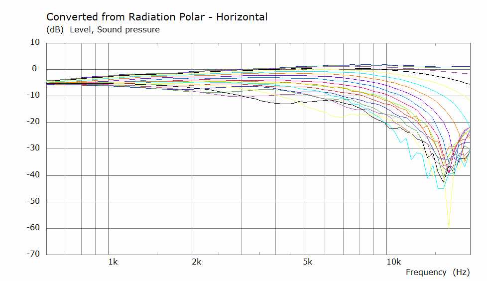

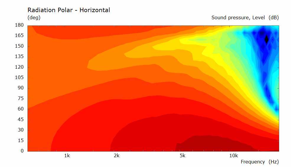

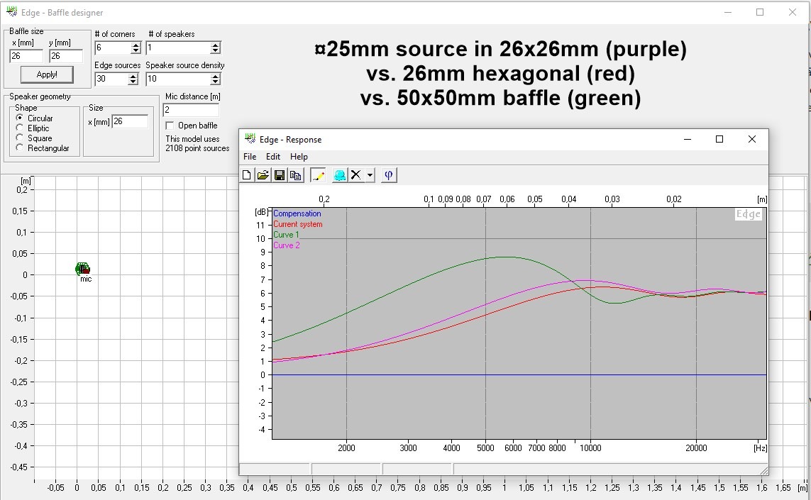

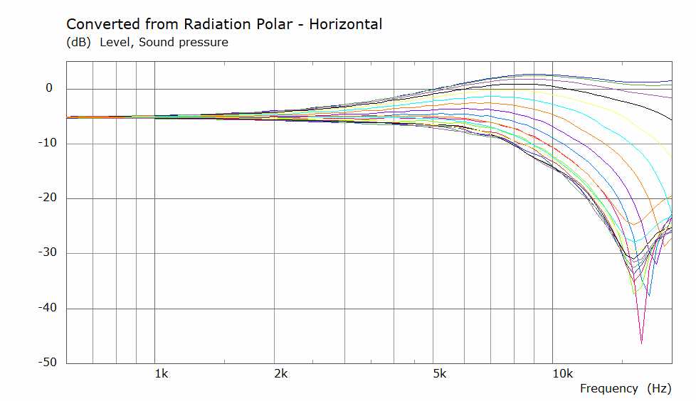

Here are quick Edge sims of ¤25mm round piston source in ¤26mm hexa or square vs 50mm square baffle. The benefit of square baffle is better distribution of distance to the edge than round or hexa/octa. The contradict is a bit lower peak/dip.
Reactions: HeadShake

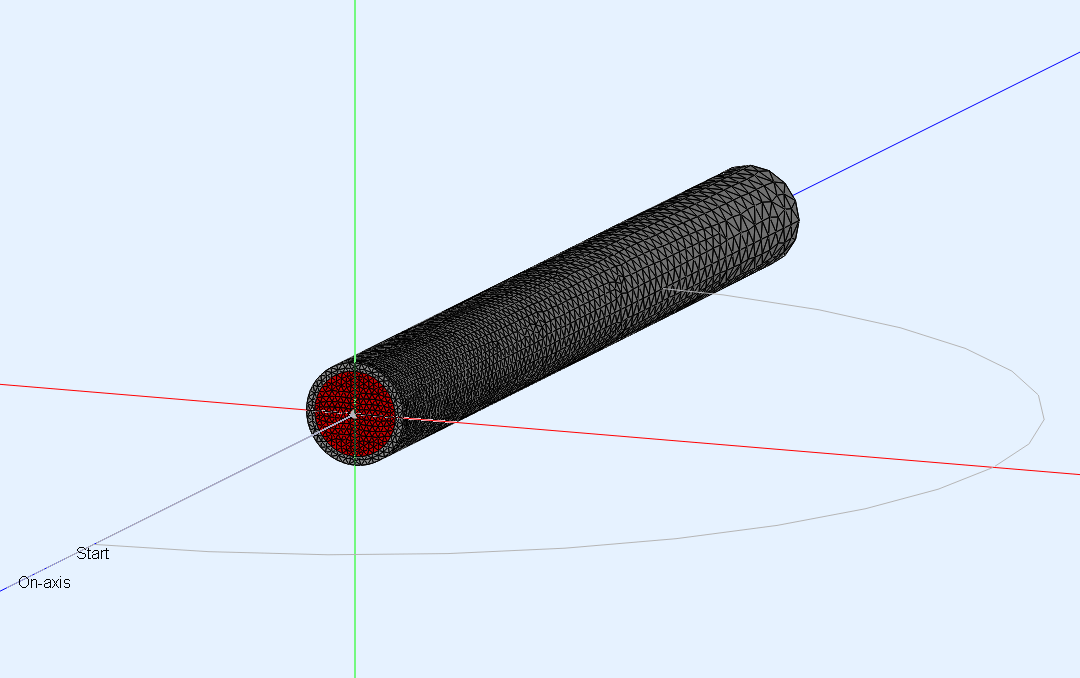

Well it didn't actually take that long 🙂
25mm driven Piston, Constant Acceleration as a base line to compare the diffraction and directivity.
300mm Tube just bigger than the driver vs sphere 104mm diameter.

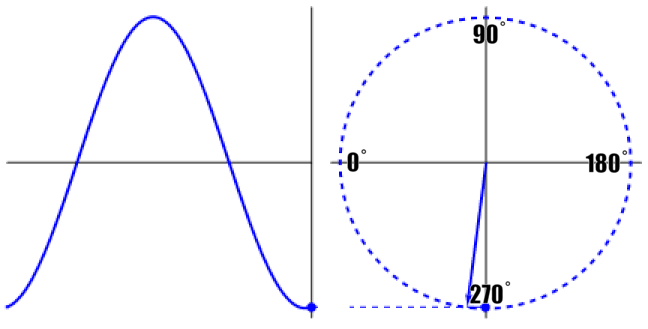

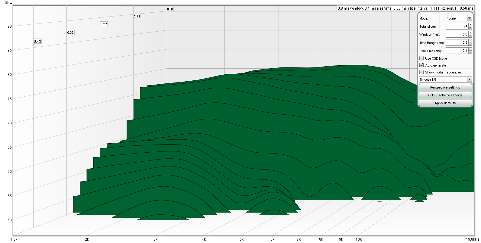

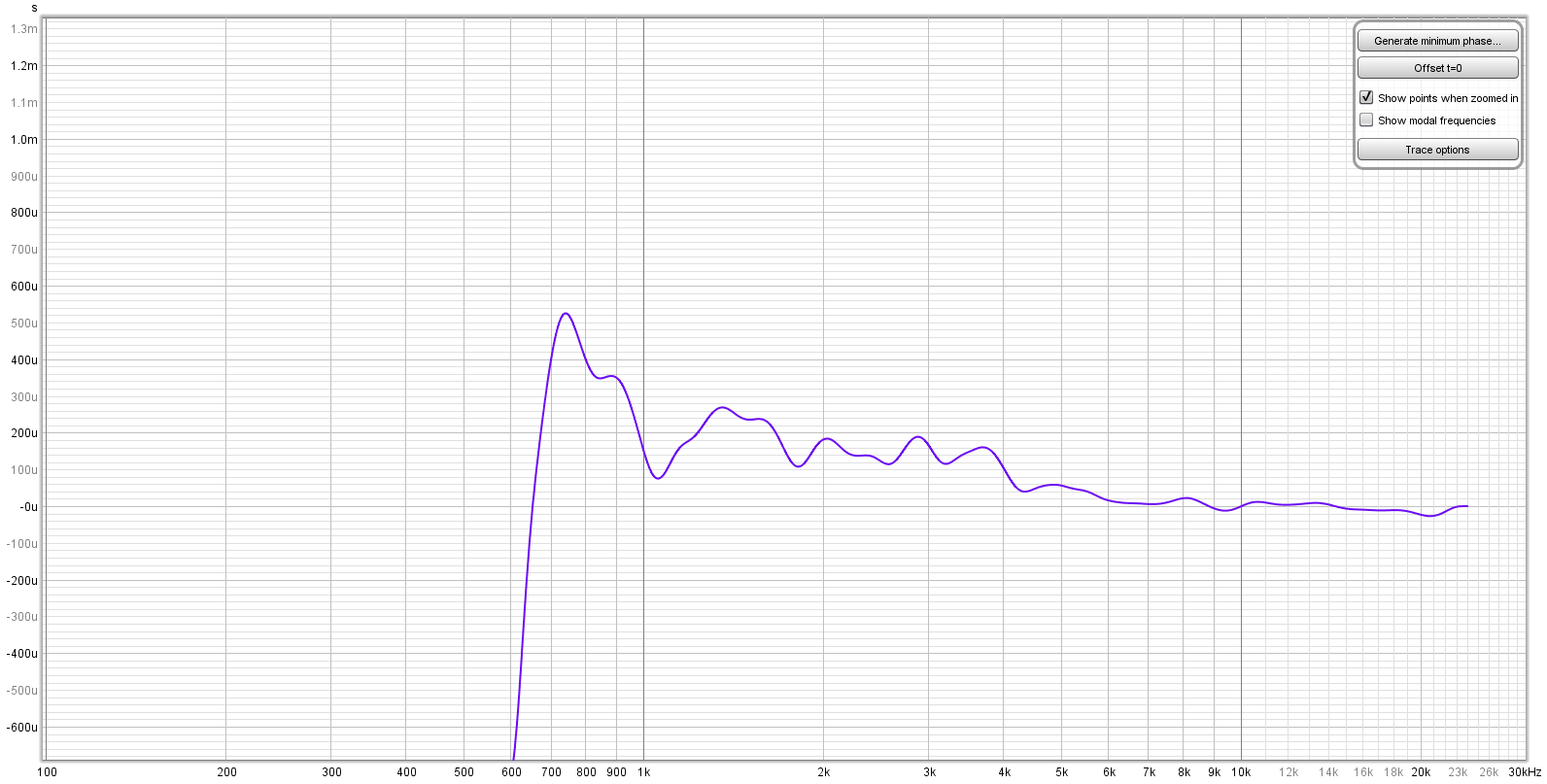

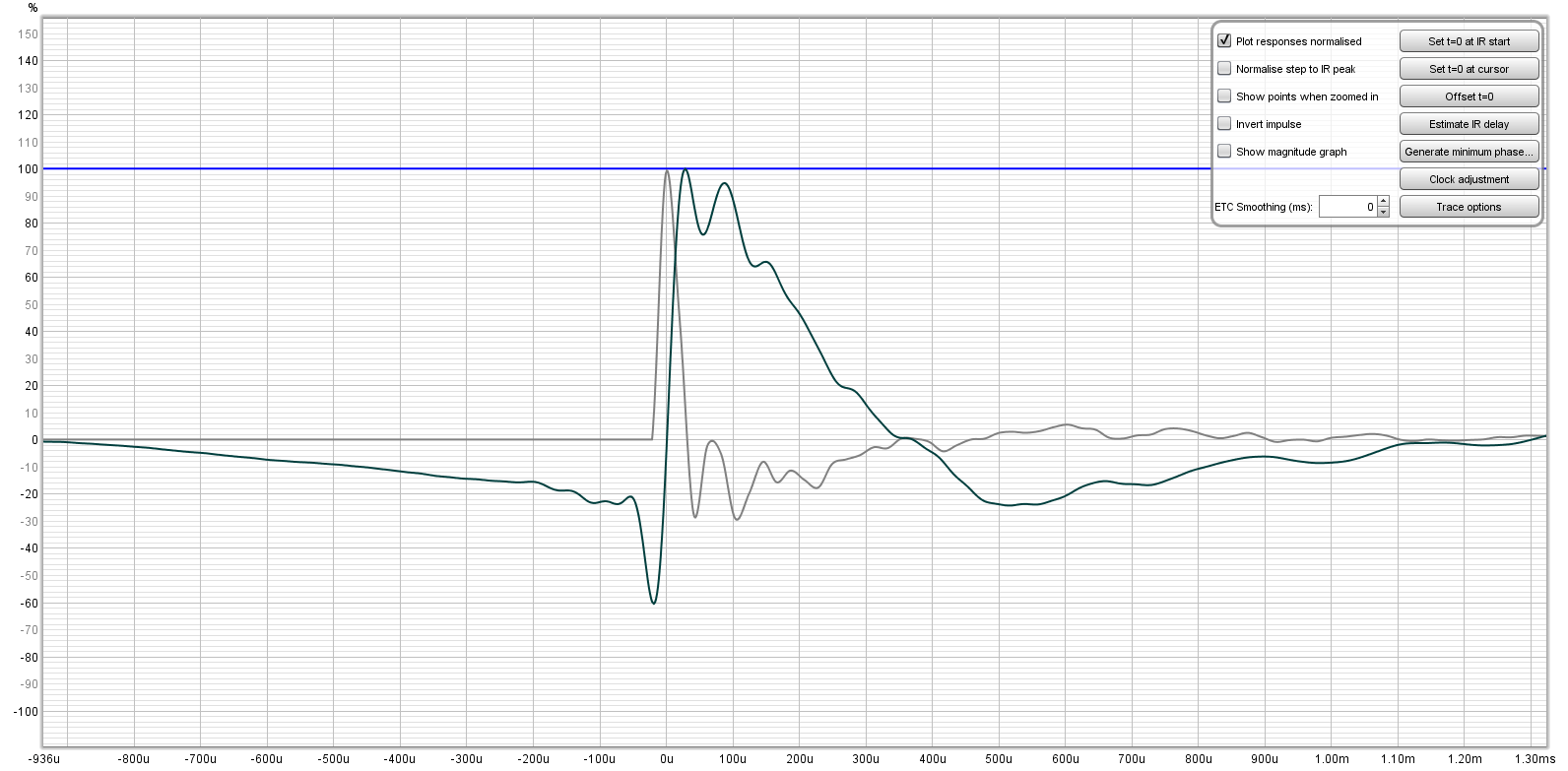

ok, I have done lots and lots of testing and can see the error of my ways: listen to hifijim. He's been telling me to XO at 3000hz many times with the t25b.
What I was missing was the connection between the SD and the group delay. My first XO was all about keeping the drivers away from each other and locking down the phase. I did not know about the GD and how much it would shift. The t25b makes a 2000hz that is 0.09ms behind the 4000hz. This really mucks up the decay and turns my edge radius into a horn.
My new rule is to not push drivers past the SD. The bliesma t25b should be -6db down at 3000hz based on the SD. The eton should be -6db at 500hz. So with all that in mind, I made some new XO;s and I now like my t25b+eton setup. All I am doing is using the SD number and looking frequently at the 1/2 WL. This is the start of where time breaks.

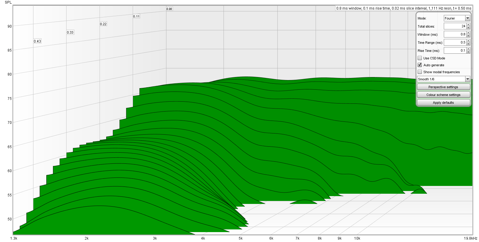

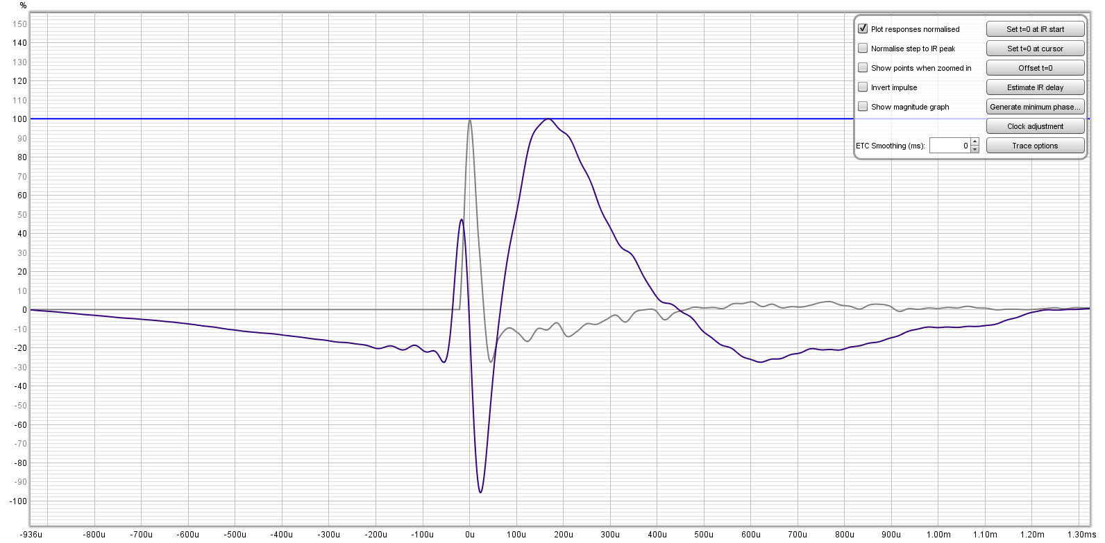

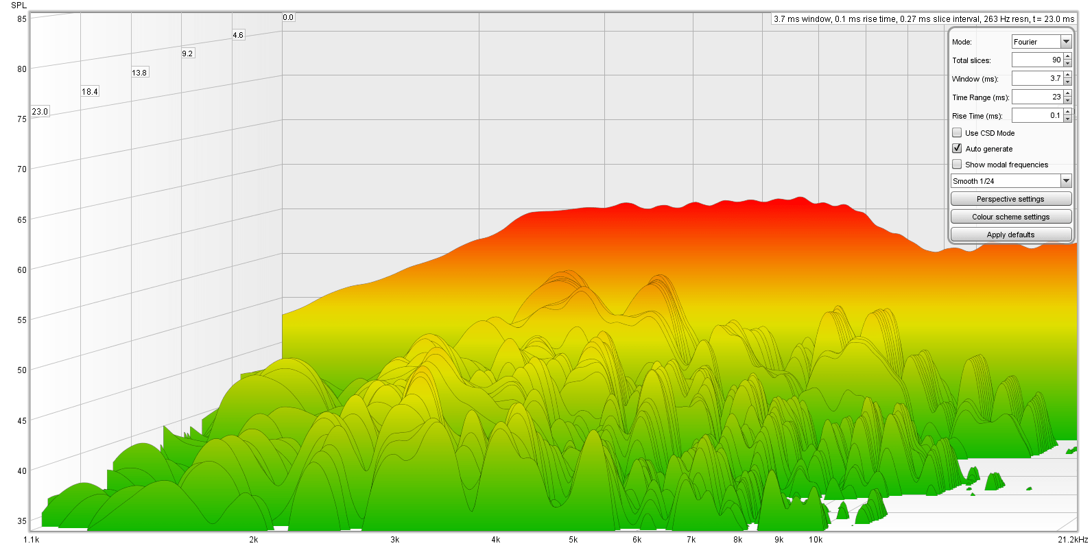

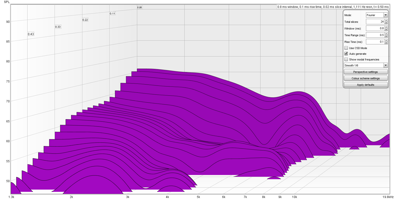

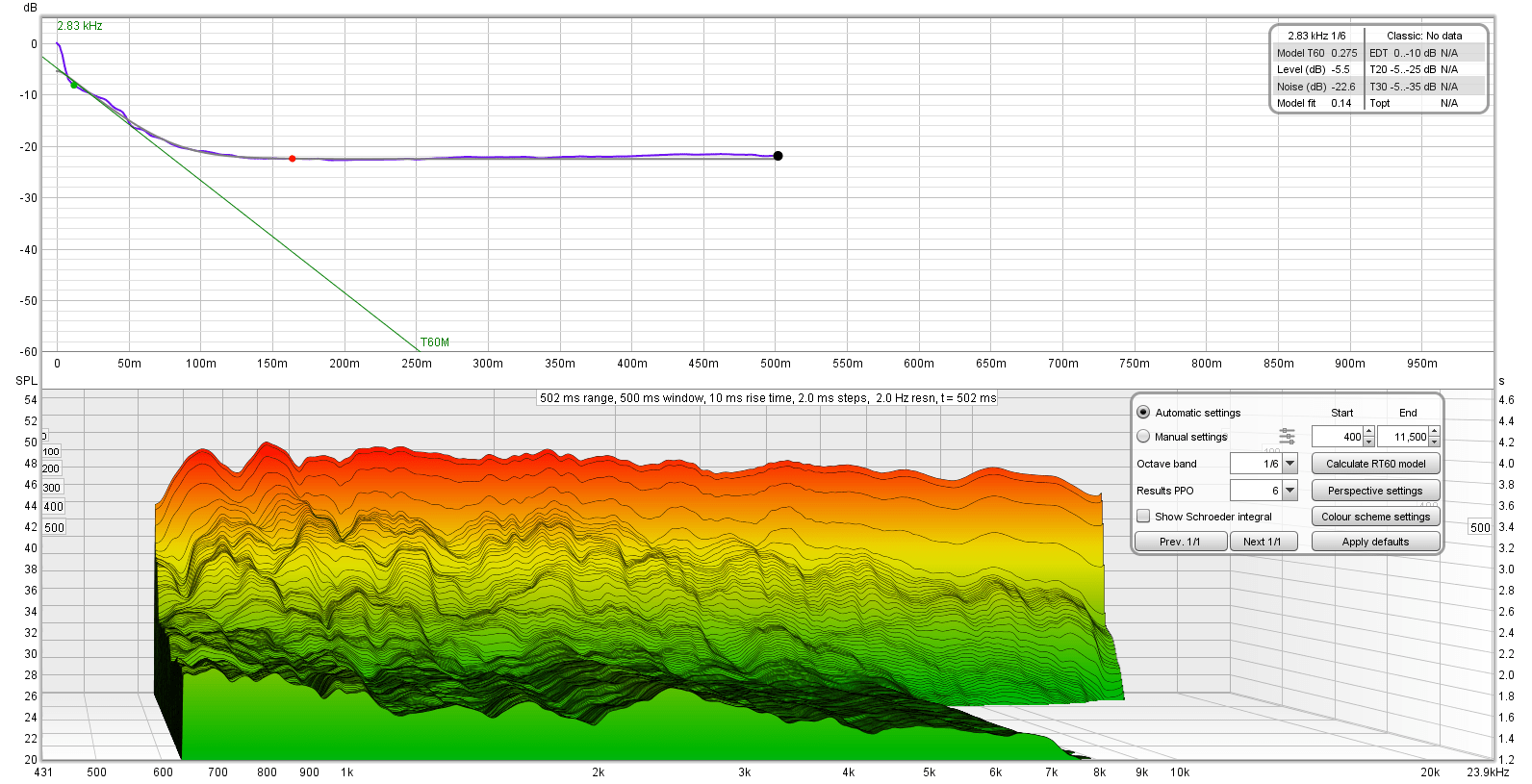

GD/wat no baffle t25 on axis to the tweeter.

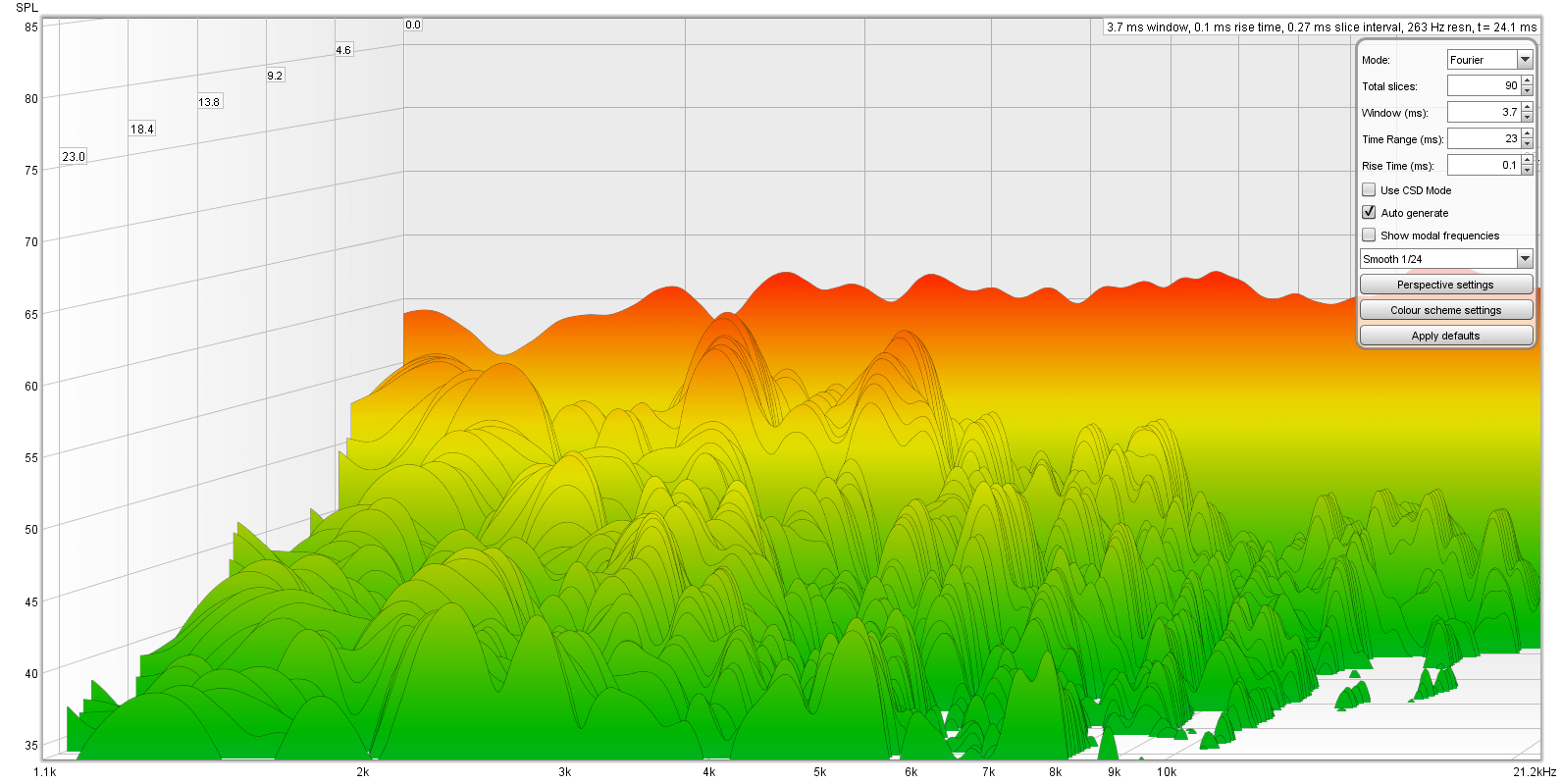

GD/water with a baffle + 44mm edge.

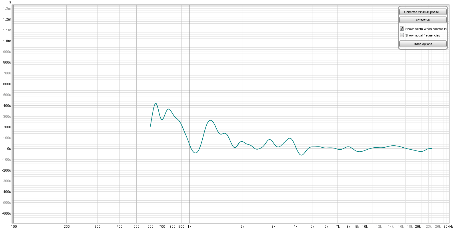

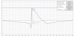

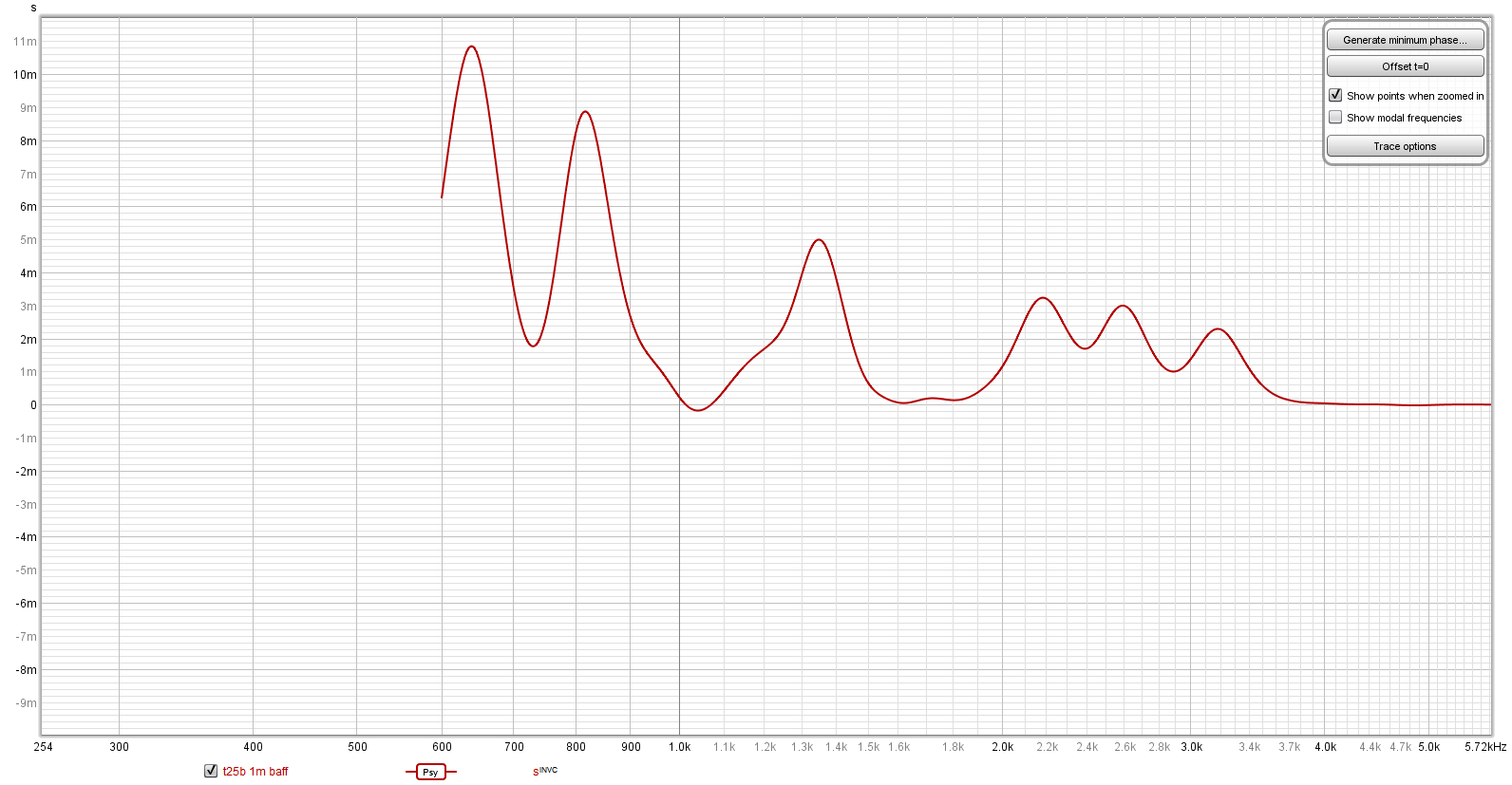

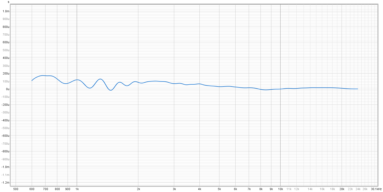

I have noticed in the REW measurements that the time was off but did not think it mattered. This is a little flawed comparison but the audax and t25b are at 1m and the rest are a little closer. The audax is the only one with eq. I also level-matched all in rew so there were not all taken at the same SPL. I wanted to see how fast a driver can make a frequency and decay. The audax ti can make a 2khz more in time than a t25b- maybe due to the grill on the t25b? The slices are all the same to show the speed of the decay.
wat_dsm50_noeq.pngwat_ja0801_noEQ.pngwat_t25b_noEq.pngwat_audaxTi_EQ.pngwat_phl2460_noEQ.png
Note how the dsm50 with an SD of 20cm2 can instantly make frequencies while the tweeters are out of time.
I started out making 2 new XO's based on an ideal sim and then made a 3rd using the second order to hear what a large spacing sounded like.
These measurements where done with the speaker with the baffle. SO= second order, FO = first order.
These were all on-axis to the tweeter. Compare that GD to my OG xo:
My focus is only on 1khz-10khz right now but the new XO based on the SD reduced the GD.
