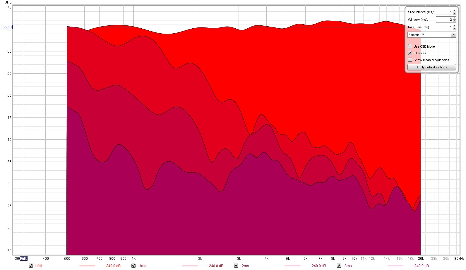

Dome decay rules!
The room is excited way more by the dome shape... the room is the most potent deterrent of accuracy in a lot of cases.

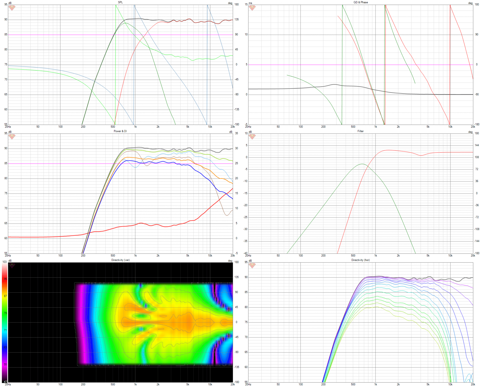

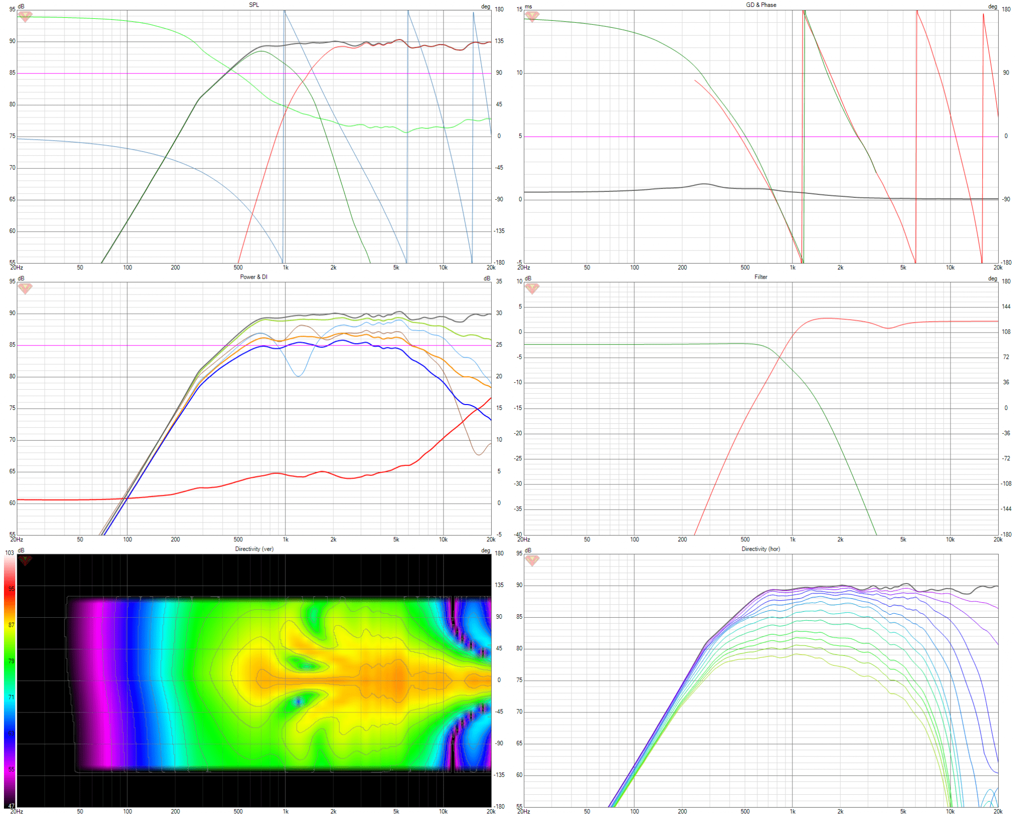

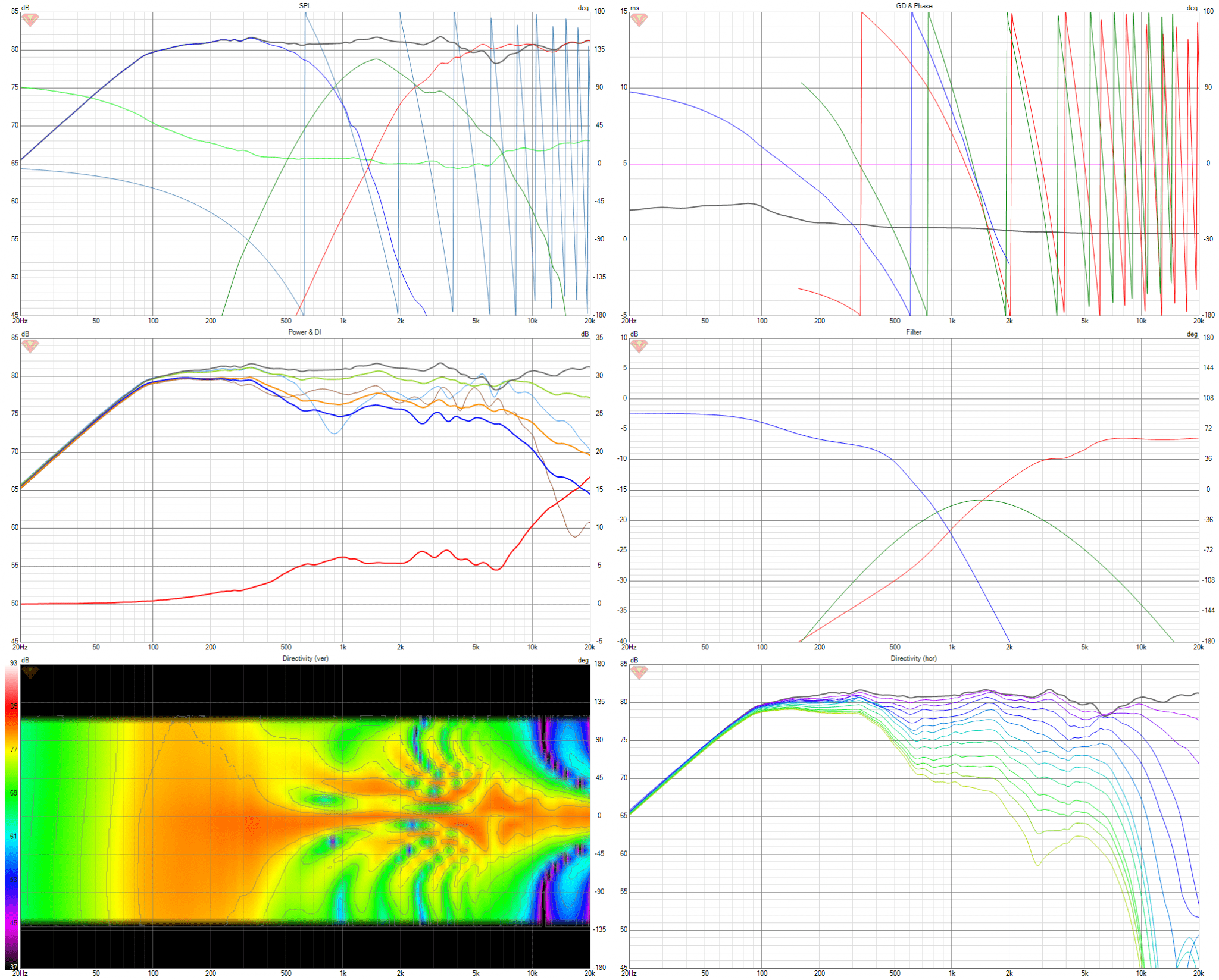

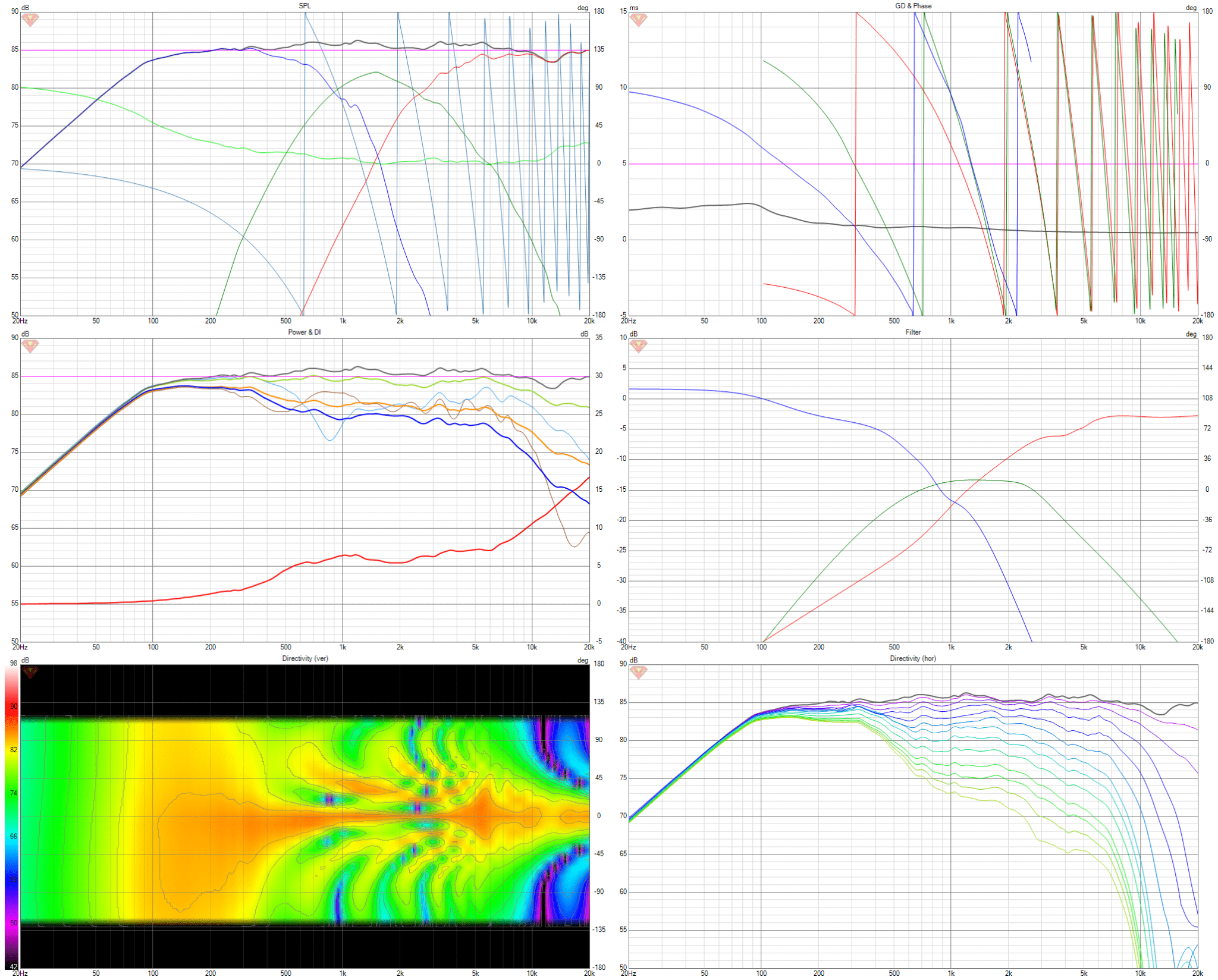

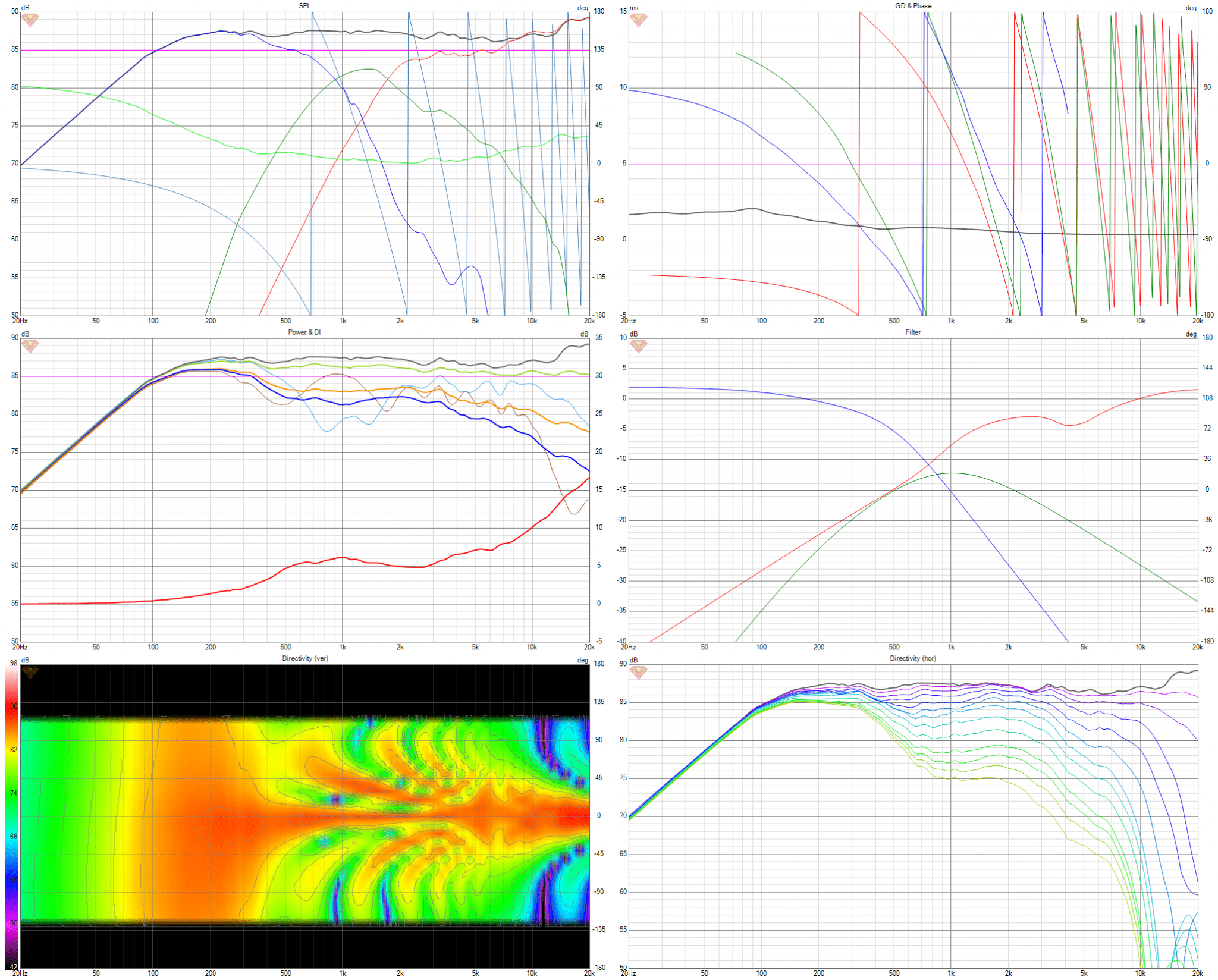

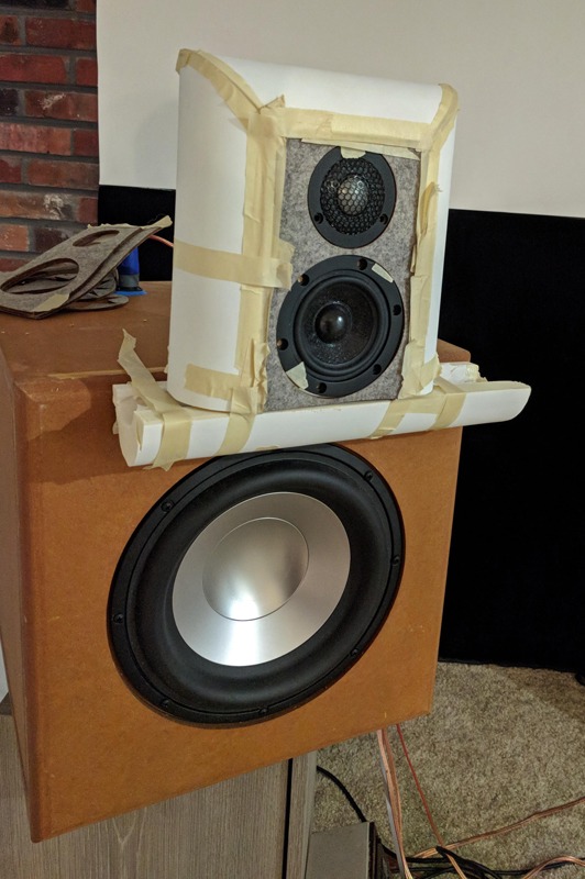

@camplo The 2d sim is just a simple view to remove complexities for comparisons. I get your point- why compare when the room is at play? I'd argue it all adds up. I still have (3) 3ways next to each other in mono. I can tell when the floor woofer is playing vs the one that is 2ft off the floor. I can hear baffles.
