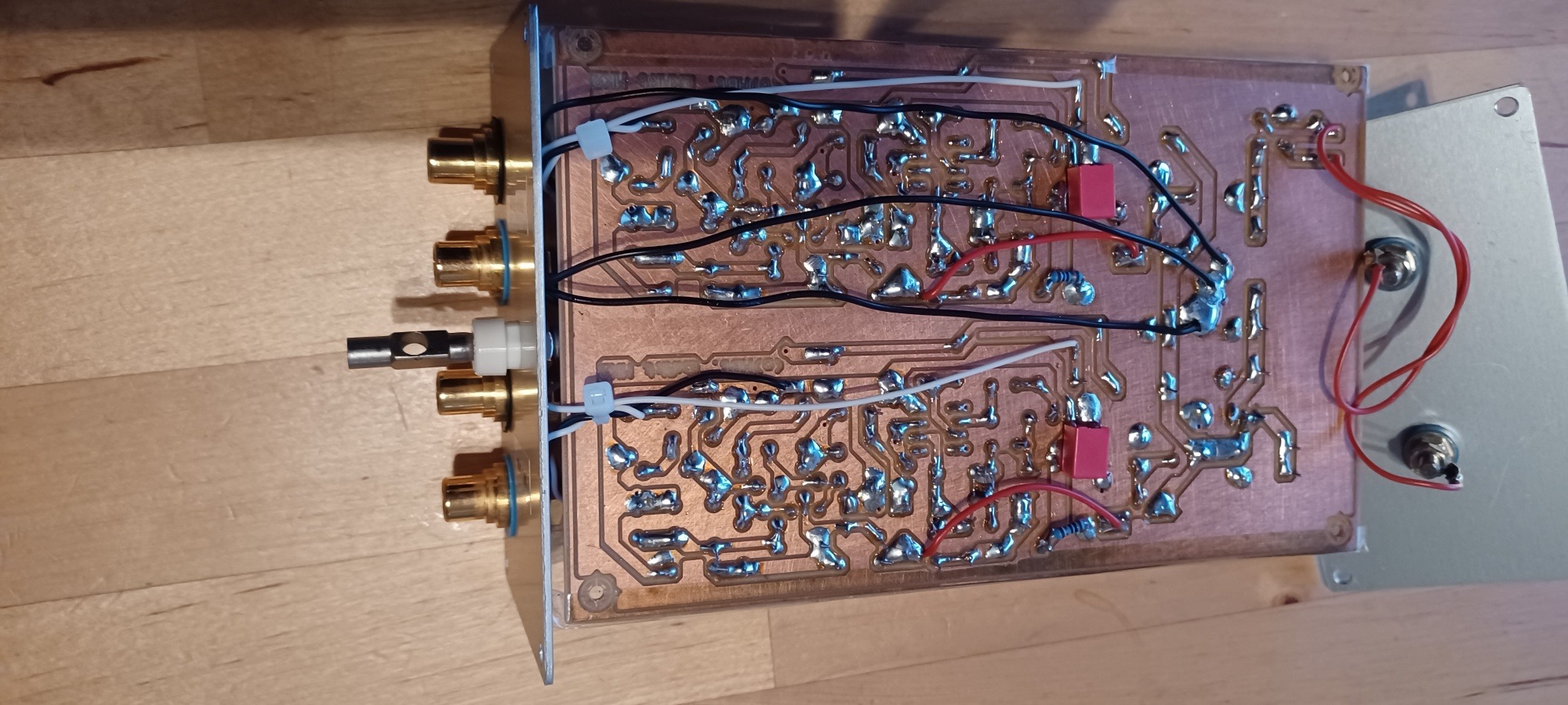

I guess breadboard style for a first shot with a 1m distant power supply should do the trick.Do you have something like the picture in mind as a test setup?
There are other DIY-style structures in my photo album.
Mounted on a wooden board it's the most fun - I used the kitchen extensively, until my first analog oscilloscope complained about the frying fat.

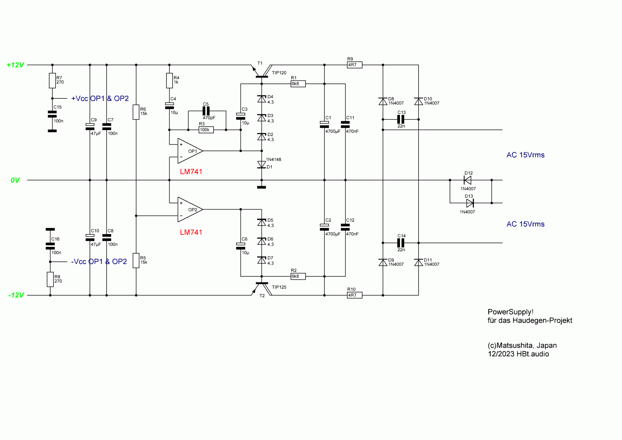

"Das Netzteil, ein Regler"
You can really go wild with the power supply unit, usually it doesn't do any harm - but it doesn't help either.
That's why we reach boldly into the component box and discover the ancient LM741.

Yes, indeed! It seems to me the (positive) regulator op-amp inputs have been mixed up!had disastrous consequences

That's right, thank you for your advice. Obviously, OP1 must also be in nfb-mode. I mirrored the symbol in a hurry. Please connect pin 3 to the reference potential 0V.Yes, indeed! It seems to me the (positive) regulator op-amp inputs have been mixed up!

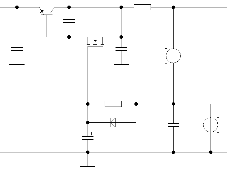

If you choose the hard (complex) away and set the numerator to 1, then the denominator should look like a small catastrophe:
R1/R2 + C2/C1 + 1/(1+omega^2*T3^2) +j[ 1/(1+omega*T3) + omega*T1 - 1/(omega*T2) - 1/(omega*T3) ]
With
T1=R1*C2 -> 1 msec
T2=R2*C1 -> 246 µsec
T3=R2*C2 -> 82 µsec
Please check for correctness, I've just scratched it quickly into the rocks - the meddlers are already looking at us suspiciously. Careless mistakes can therefore not be ruled out. And they are already very easy to make here.
F(jOmega) = 1/ denominator.
Try it with Laplace, that works more reliably. I have suggested R1=10kOhm, R2=820Ohm, C2=100nF, C1=300nF. It should fit with the normalized RIAA response curve. You can also solder the divider to a breadboard and measure the amplitude response. I think, matlab will solve this for us.
In a substitute source consideration, R1 is parallel to the cross branch.

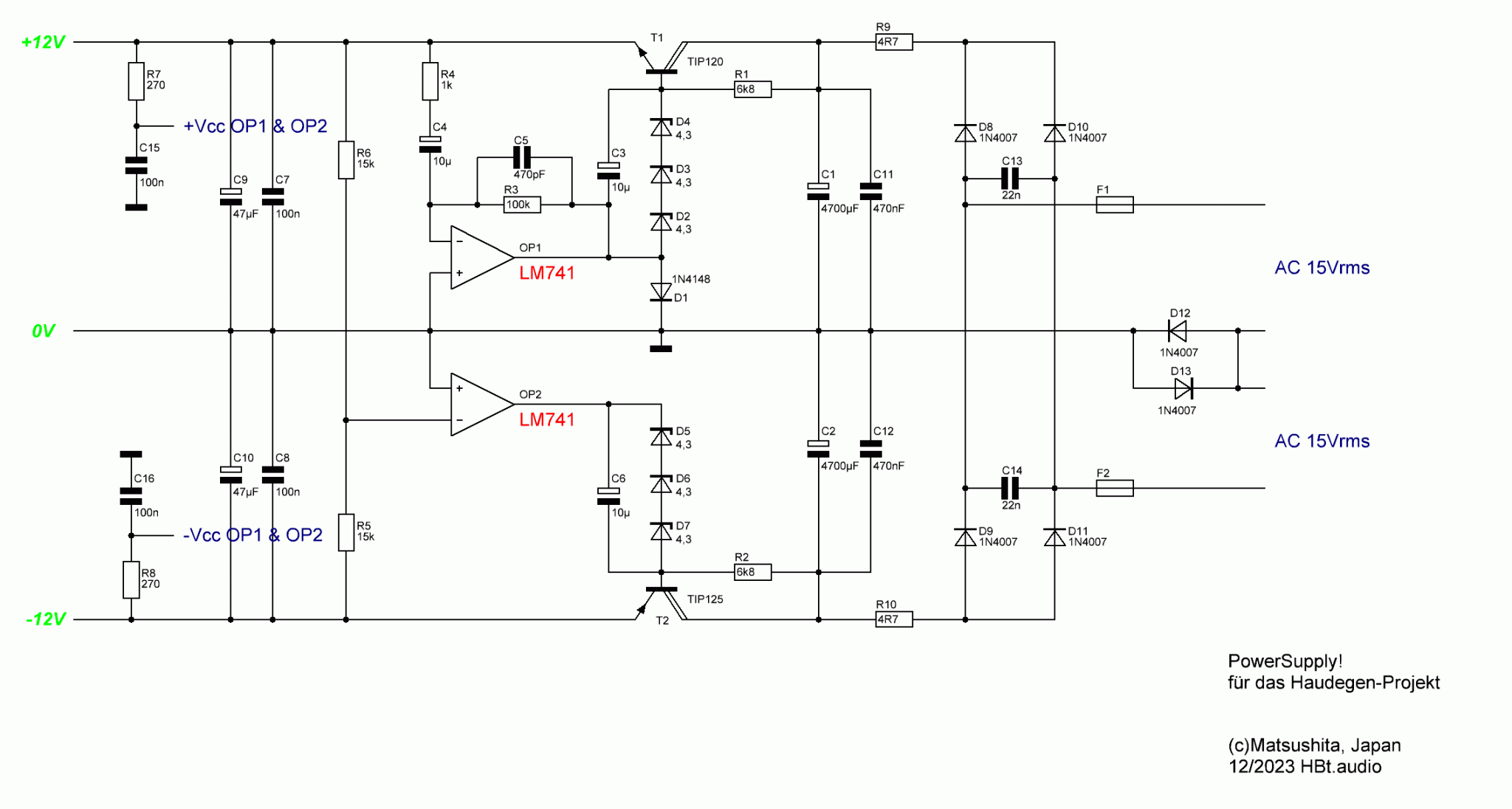

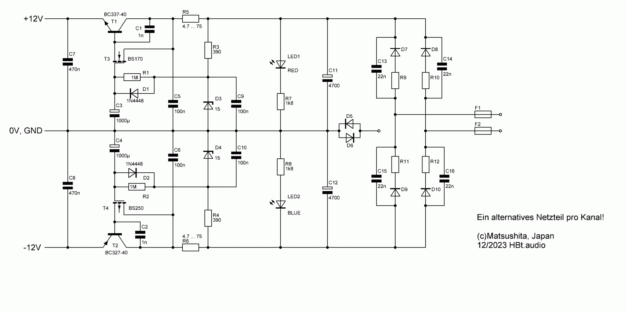

For the current EQ project, I'll add another power supply option, namely the apparent battery. Personally, I would prefer a completely normal story with an LM317, 337 and perhaps a filter, the capacitance multiplier.
As for the power supply, you can realize it according to your own taste. +/-12Vdc.
es war so abgemacht..."
Our sad heroes now sang to themselves every day, but it didn't help. Enough of the story: the daily life of an employee in the world of Rotary (for now).
PSU 2:
We simulate one battery per channel, i.e. we look into a huge cookbook ... Double mono PSU for our EQ. The most important detail is on board, the lighting system, two LEDs.

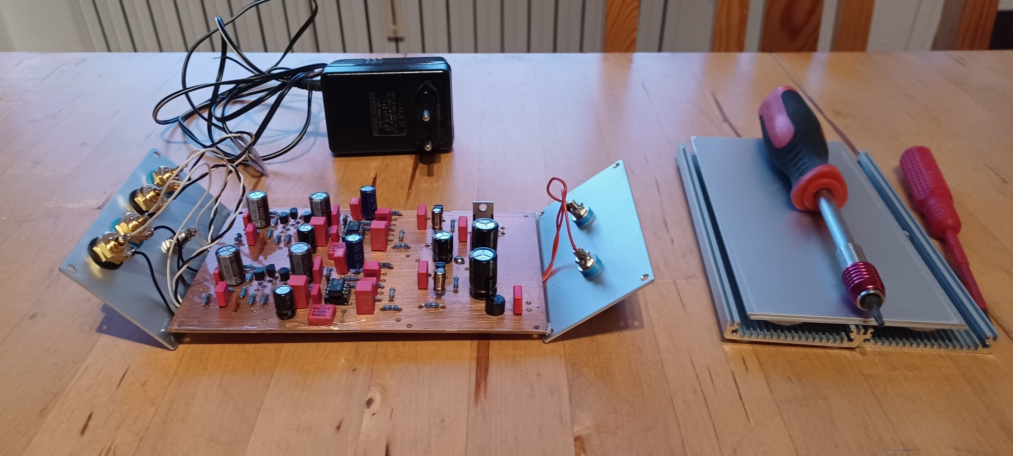

Pictures say more than words
This is what a final prototype could look like, this has been my favorite equalizer for several years. A discrete preamp amplifies and adapts my MC system to the following active EQ with SSM2134. My last two original PMIs. Realized with standard components, the special focus in this development was on completely low noise and exact compliance with the RIAA reproduction standards.
Dimensioning of a power supply unit
If our EQ requires a balanced supply of 15V dc and only draws 60mA dc current, then we can do a very simple rollover.
U * C = I * t
t=10ms
I=(60mA plus reserve), we define the reserve with up=sqrt(2)*2Vrms=2.83Vp and a maximum load of illusory Rl=33Ohm (headphones?): 60mA+86mA=146mA. Let's give the 7815 fixed voltage regulator another 5mA and generously set I to 150mA.
In the equation, the U stands for the ripple at the charging capacitor directly behind our rectifier bridge. With a bit of luck, our voltage regulator will reduce this sawtooth-shaped voltage down to 1/10000. For an SNR of -70dB and a 2Vrms signal, our voltage before the regulator should theoretically be superimposed with 6Vrms.
Let's calculate a first C = (0.15A * 10ms) / 6V = 250µF. And without the 7815 it would be almost 3F. A voltage regulator is absolutely necessary. If we simply turn the tables once, we can estimate the ripple with a given charging capacity: u = (0.15A *10ms) / 1000µF = 1.5V ... rms or pp is not decisive for the ripple.
We therefore set the C to 1mF. I guarantee that we will never measure 1.5V.
The solution: 15V our rails + 3V regulator difference + 1.5V ripple + 1,4V diffusion voltage of our rectifier = 21V. Divided by root 2 equals at least our secondary voltage of the mains transformer = 15Vac.
P or rather S = U * I, 15V * 0,15A = 2.25 W or also know as VA. Two windings, times two -> ending up 5W or even 5VA-Type should work for one channel.
For the current Pearl project, I'm guessing an oversized 30VA toroidal core.
Assuming that our 7815 perhaps only reduces the ripple by a factor of 1000 -> u_ripple is now 1.5mV and our two OPs do the same for us, then in the very worst case we would now be at 1.5µV. 20*log(2V/1,5µV)=122,5dB.
Isn't that crazy? 1mF and a 5VA transformer, that's all you need.
In my EXakt_MK2 the charging capacity is 2*1000µF in PI configuration, with one LM317 for both channels together.
With 4m7F you are completely carefree. And an encapsulated 30VA toroid is heaven.
I can't say whether everything is right (here), because Haudegen is already fast asleep - with the good air today 😉.
Our Haudegen-Project is content with +/-12Vdc and doesn't want to drive headphones either.
