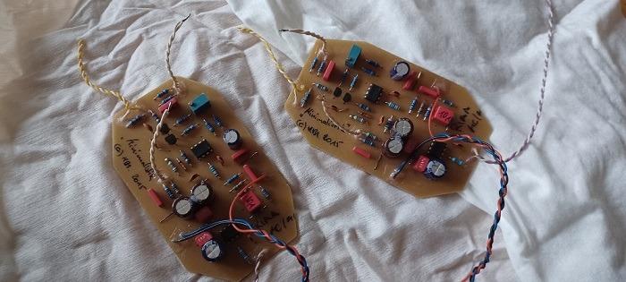

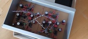

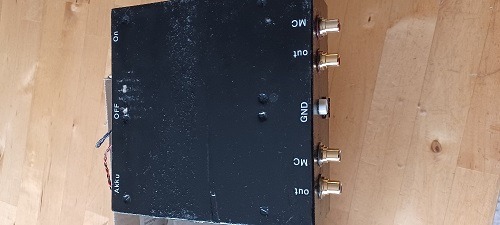

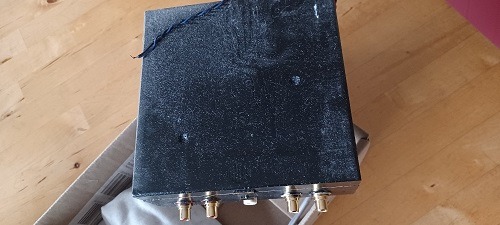

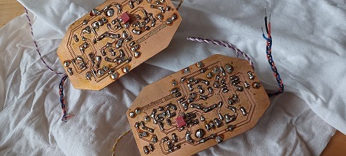

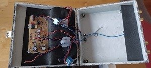

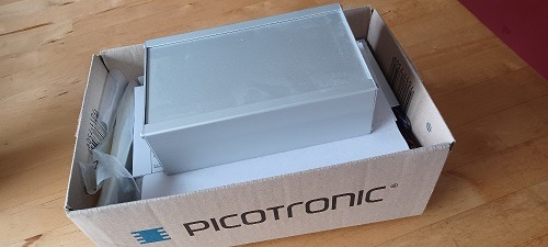

Another dusty box,
with the remains of the first "Minimalist" in a wooden box with inner layers of aluminum foil, copper foil and a special coating with iron particles.
Unfortunately,
there was a problem with the battery charging circuit and the circuit boards were stuck in their screw connections and spacers and could only be broken out - which is why the circuit boards now look a bit strange.
What else can you say about this? This is an illustrative example of what my test circuits often looked like in the past decade: quick and dirty!
The breadboards are stacked up cardboard by cardboard ... maybe a photo one day.
HBt.
Unfortunately,
HBt.

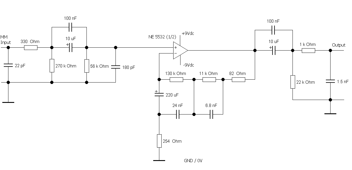

I need to sum up the most important parts but here it is: Oread MM Phono Pre
Let's see how she's evolving and if she ends as the nymph we are expecting or a drunk dwarf who needs a shower 😉
I think, there was still the question of a "reading glasses" in front.
This is really a sensible thing (clever decision) to do:
Our Op-amp sees now the same (source) impedances at its inputs and a perhaps not quite sufficient open loop gain is raised accordingly. Such a configuration can not only be designed with particularly high impedance (jFets), but also with very low noise.
Bipolar or unipolar, it depends ...

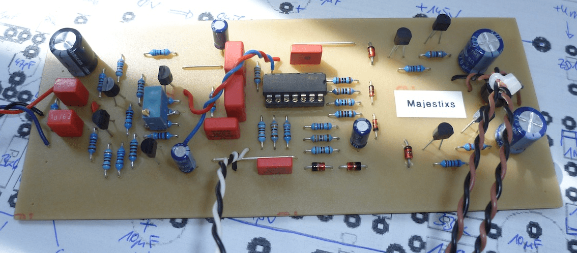

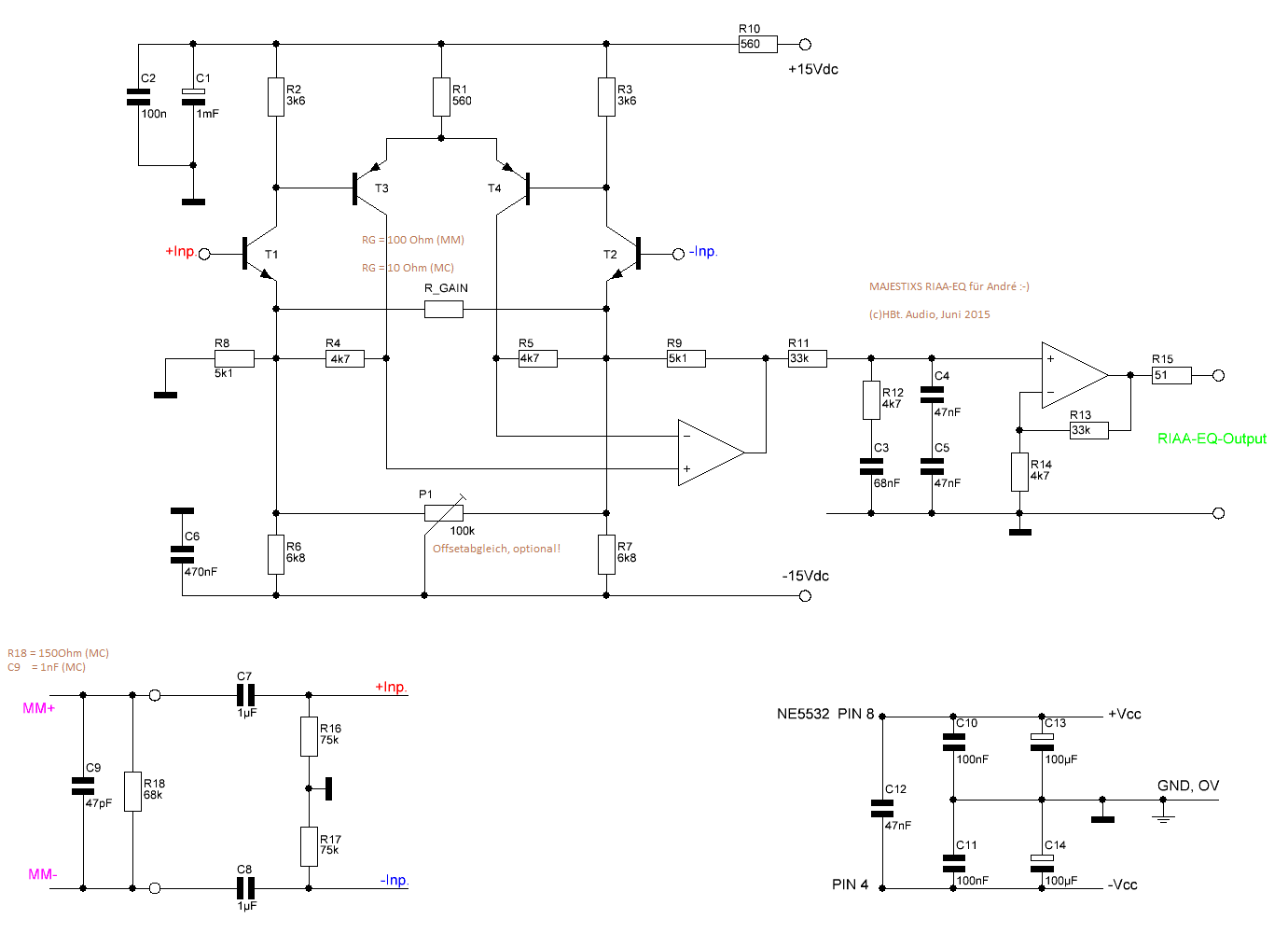

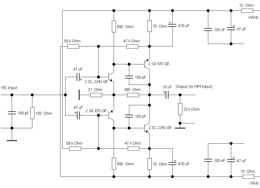

In the component / collection box,
just for fun
An instrumentation amplifier with BC550C and BC560C as the first stage ... completely intuitive, a birthday present.
just for fun

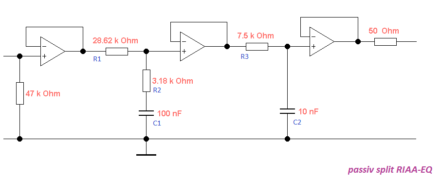

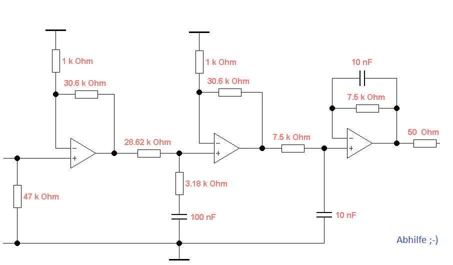

Networks can also be split up:
H(jOmega) =[ 1 + jOmega*R2*C1 / 1 + jOmega*(R1+R2)*C1] * [1 / 1+ jOmega*R3*C2]
with R1=9*R2 it's
very simple and the time constants are known also!
with R1=9*R2 it's
Yes, it's the great grandmasters version 😉.
Simple calculation and best possible approximation to the ideal EQ, but no amplification, only attenuation - what do we want to do now to remedy this shortcoming?

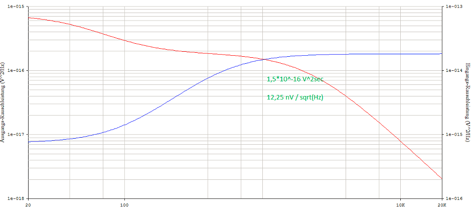

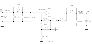

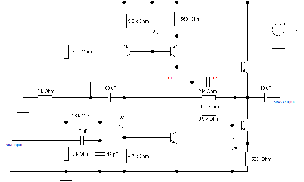

After all, an unweighted SNR of 78dB is not even that bad - bw=20kHz, with RIAA and A-weighting it is better then 88dB - >that is the (normal) game 😉.
OP-Amp is NE5534
Disclaimer
The circuit shown is only a PRINCIPLE, a simplified schematic!
OP-Amp is NE5534
Disclaimer
Now there's a fairly noisy preamp with its series resistance of 36k (24nV/√Hz), and it has a gain at 1kHz of -20dB too 🙂
Don't exaggerate too much, it's not that bad after all.
Oops, I misread the circuit due to the unusual way the feedback network was drawn - didn't see the gain of the first stage.... I recommend drawing ground at the bottom, not the top - otherwise it looks like the supply rail. You can trip up speed-readers of circuits if you ignore conventions like this.
