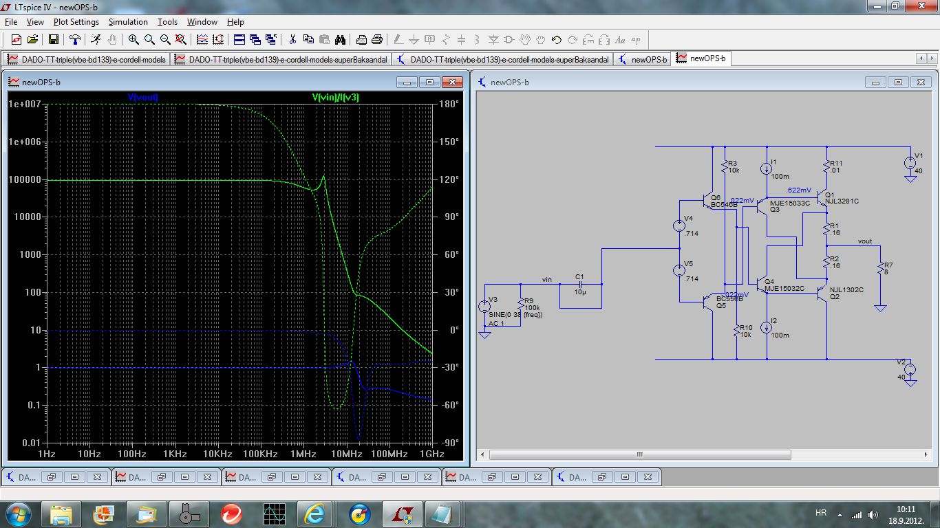

Harry probably meant by 'slow' the long turnoff time of a CFP BJT OPS.
Well, there is that. I was actually talking about small-signal bandwidth but it turns out I was wrong! 😱🙁😕😱 This opinion was based on simulations I performed a long time ago; clearly I did something wrong or my models were flawed. I've just done some more simulations in LTspice using my and Bob's transistor models; I'm confident these are giving true-to-life predictions.
Yes, but I already clarified that my plan is NOT CFP output transistors.
It is the use of a CFP [pre-driver + driver] to drive an EF output.
As opposed to 2 cascaded EFs to drive the EF output.
Adequate bias means that effectively the CFP is class A so I don't see a problem.
Yes, I always knew you were talking about using a CFP as a driver, not as the final output. However, when using the CFP as a driver, there is no reason why it has to be biassed in class-A. Class of operation depends on the bias voltage and the value of the resistor joining the two halves' (+ve/-ve) outputs.
So here's the results of some simulations I've done. I've compared four different triples: two EF triples, one where the three stages operate in class-A, class-A and class-B and the other where the three stages operate in class-A, class-AB and class-B; and two [CFP+EF] triples, one where the CFP is class-A and the EF is class-B, and the other where the CFP is class-AB and the EF is class-B. Here is a pdf of the simulation schematic, the EF triples are up top and the [CFP+EF] triples are below. In both cases the more heavily biassed (in terms of current in the driver stages) configurations are on the left.
Here is a pdf of the small-signal analysis showing input impedance of the four configurations in the top pane, and frequency response in the bottom pane.
Finally, LTspice predictions for THD-20k, using a 4R load and 40 V peak output sinewave, and the first 10 harmonics for the calculations:
Class-A, class-A, class-B EF triple: 0.078 %
Class-A, class-AB, class-B EF triple: 0.081 %
Class-A, class-B [CFP+EF] triple: 0.068 %
Class-AB, class-B [CFP+EF] triple: 0.067 % (yes, lower than when the CFP stage is class-A biased; however please note that the voltage bias at the input of each configuration hasn't been precisely set to achieve exactly the same quiescent current in the final EF stage across all four configurations)
Nice to learn it wasn't just my failure to understand and nice to have cleaned up an error.
... when using the CFP as a driver, there is no reason why it has to be biassed in class-A. Class of operation depends on the bias voltage and the value of the resistor joining the two halves' (+ve/-ve) outputs.
I should have been more explicit earlier rather than just written "adequate".
So here's the results of some simulations I've done...
Class-AB, class-B [CFP+EF] triple: 0.067 %. ..
Thank you for that. Trends are mostly as expected but excellent to have quantitative data.
There seems no point in the low bias versions, the hi bias EF3 is both faster AND flatter.
So it's hi bias versions - CFP+EF versus EF3.
The CFP is just a little lower open loop distortion but considerably more extended hi frequency response than EF3.
The extended CFP+EF response obviously offers the possibility of a faster feedback loop to lower the distortion even more but the peak is a bit of a worry. No wonder they have a reputation for stability problems!
It would be nice to actually exploit that peak, perhaps it is possible to use it to put in a Bode step. I will think about this, do you have any ideas or references for this?

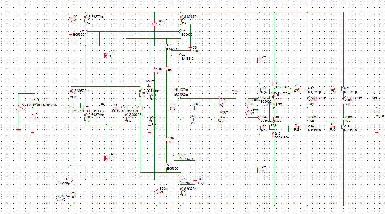

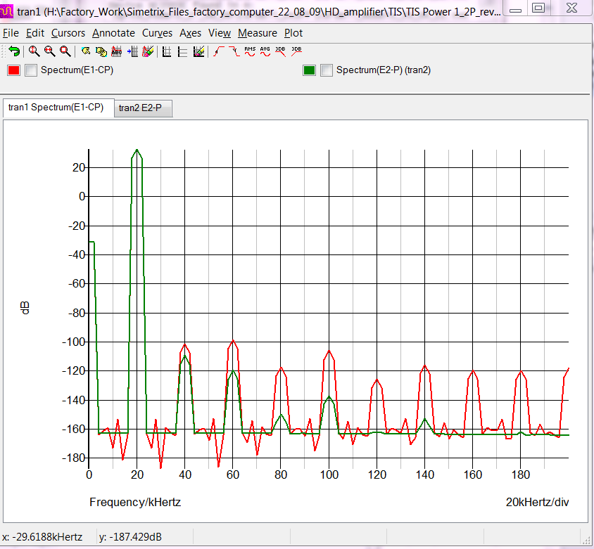

Hello Harry,
You could predict the results. The open loop output stage dominates THD.

Hello Harry,
Regards
Arthur

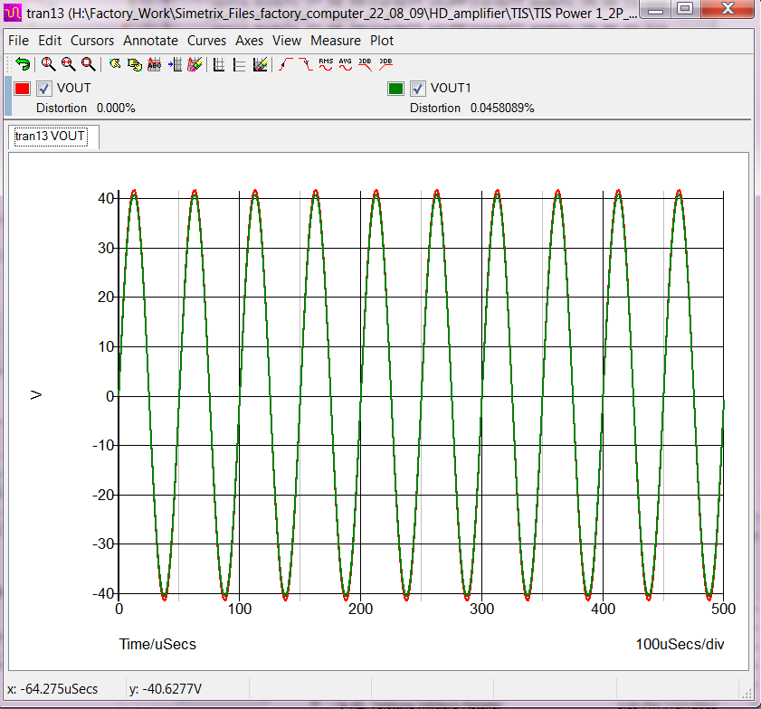

Thanks Arthur. Sorry, should have been more clear: same test, but without the ideal buffer. I'm trying to get an idea of how much the input impedance of the simple output stage upsets the TIS front end.
Although now I think about it I'm wondering if that's a flawed test anyway. I'm still trying to get my head around why the THD is quite "high" for the complete amplifier as shown in your post #103. At first one might say that it's because the simple output stage doesn't have high enough or linear enough an input impedance so is upsetting the front end, but then you add the ideal buffer and the THD doesn't change. To me, this suggests that the TIS isn't being upset, there's just not enough loop gain to linearise the output stage.

Hello Harry,
If you load the TIS output with a feedback network as it stands it loads the output of this stage too much causing much higher distortion than if there was a buffer there, put another way a buffer of some sort is needed to handle the lowish impedence of the feedback network.
Am I missing something in the way you want this sim setup.

That's why I started wondering if the test was flawed. You could use an ideal buffer just to drive the feedback network; however you do it the feedback will reduce the TIS output impedance to make it more tolerant of loading.

Hello Harry,
I put an ideal buffer between the Tis output and feed back network, and then unbuffered TIS driving open loop output stage (Red FFT is THD spectrum) , but I also added an additional ideal stage between the open loop output and TIS output as a reference point (Green FFT is this spectrum).
The plots clearly show how the input stage of the output affects the THD of the TIS stage.
