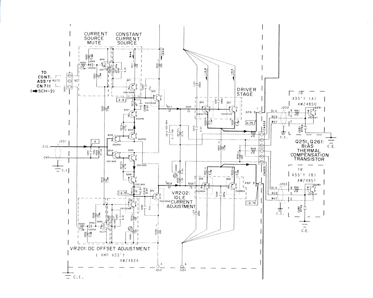

Here are the schematics. I was wrong about the manufacturing date though, got some more info via Pioneer, the first amps sold using this outputstage was in 1982. Note their are six pairs of LAPT output transistors driven by this stage which are not shown.

The driver is composed of two transistors in parralell to achieve higher bandwith and lower device capacitances at optimal bias point.
Presumably you are talking Q25+Q27? Device capacitances depend upon voltage across the relevant junction rather than current flow, here the relevant junction is c-b. So, placing two identical devices in parallel will give you slightly under double the capacitance, not lower capacitance. (current per device will be halved; Vbe will therefore be lower for a given standing current, very slightly increasing the c-b voltage drop and reducing an individual transistor's Ccb; however, now there's two transistors in parallel and capacitors in parallel add.)
Maybe I shoud have explained, two devices used in parralell instead of one device for the same SOA. The advantage is that two lower Ic capable devices have much lower capacitances even when used in parallel than a higher Ic capable part and then their is also the advantage of FT. Compare the device capacitances of say of two 2sa1837 in parrallel to 1 onsemi mje1503xx series driver. When using transistors as emitter followers I find the Cbe of much more importance than Ccb.
Ah, ok.

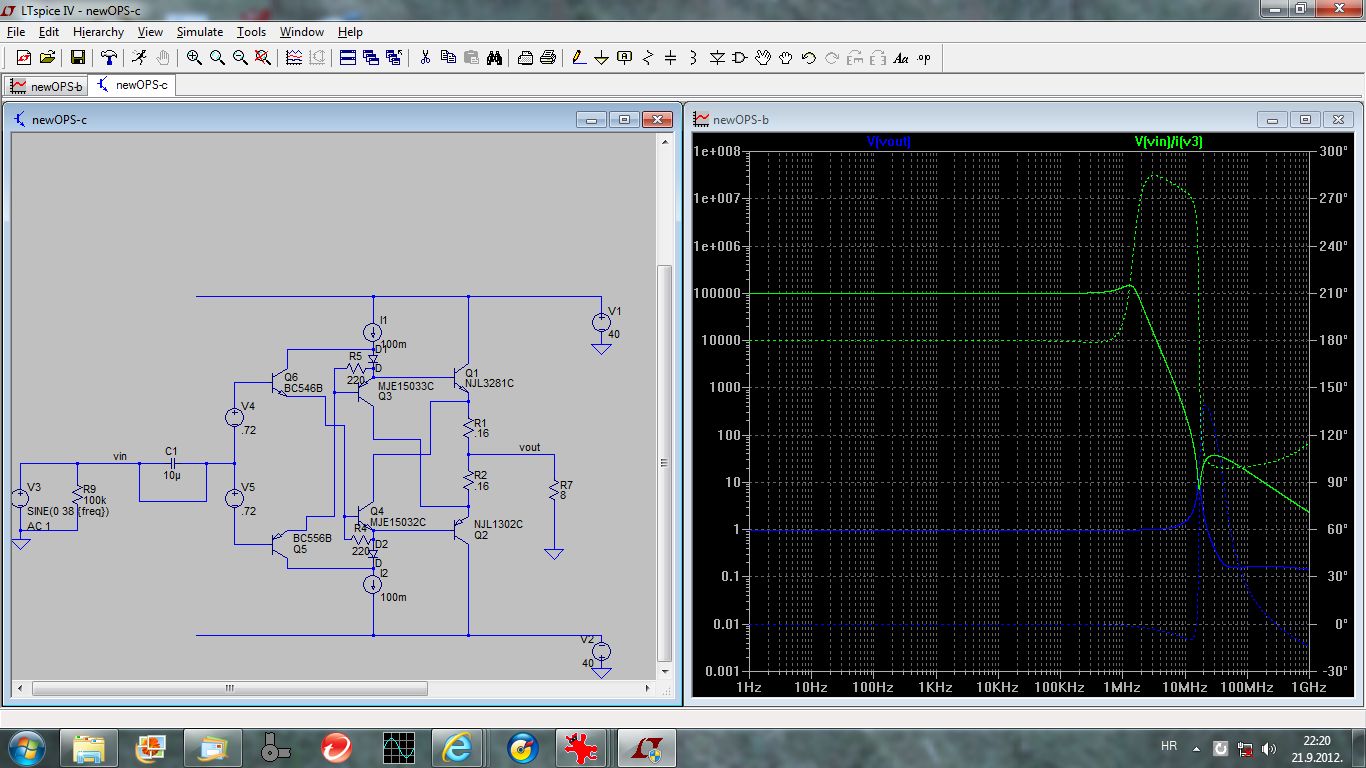

Do you mean like this? Still the same input resistance and a nasty peak at 20 MHz, distortion a bit higher.

Dadod:
If those are ideal diode models, check they actually have .68V breakover.
The resonance peaks kind of go ith multi-cascode output stages, because cascoding adds positive feedback paths. For one thing, those bulky MJE1503x drivers are super-overpoered. They ill never sink more than 100mA, and never see a Vce over .6V. Problem: overpoered BJT's have bad lo-Vce behavior. In this position these drivers ill have huge parasitic capacitance and possible Vcesat glitches.
Find some higher-performance drivers. The 2SC4793/A1837 ould be great, so ould the MJE253/243. They ill only dissipate 200m, so you could perhaps even use some TO92's here, as long as they are fast and linear to 100mA.
After you have better drivers, see hat the resonance is like and e can probably do something about it.
The distortion ill alays be bad because you are measuring voltage distortion. There is not much you can do about that ithout using a different circuit. A more meaningful measure of distortion for your circuit ould be input current distortion.

The BJT tests ere only to help me get a sense of scale; I agree they're not very useful. They performed their function ell didn't they?
