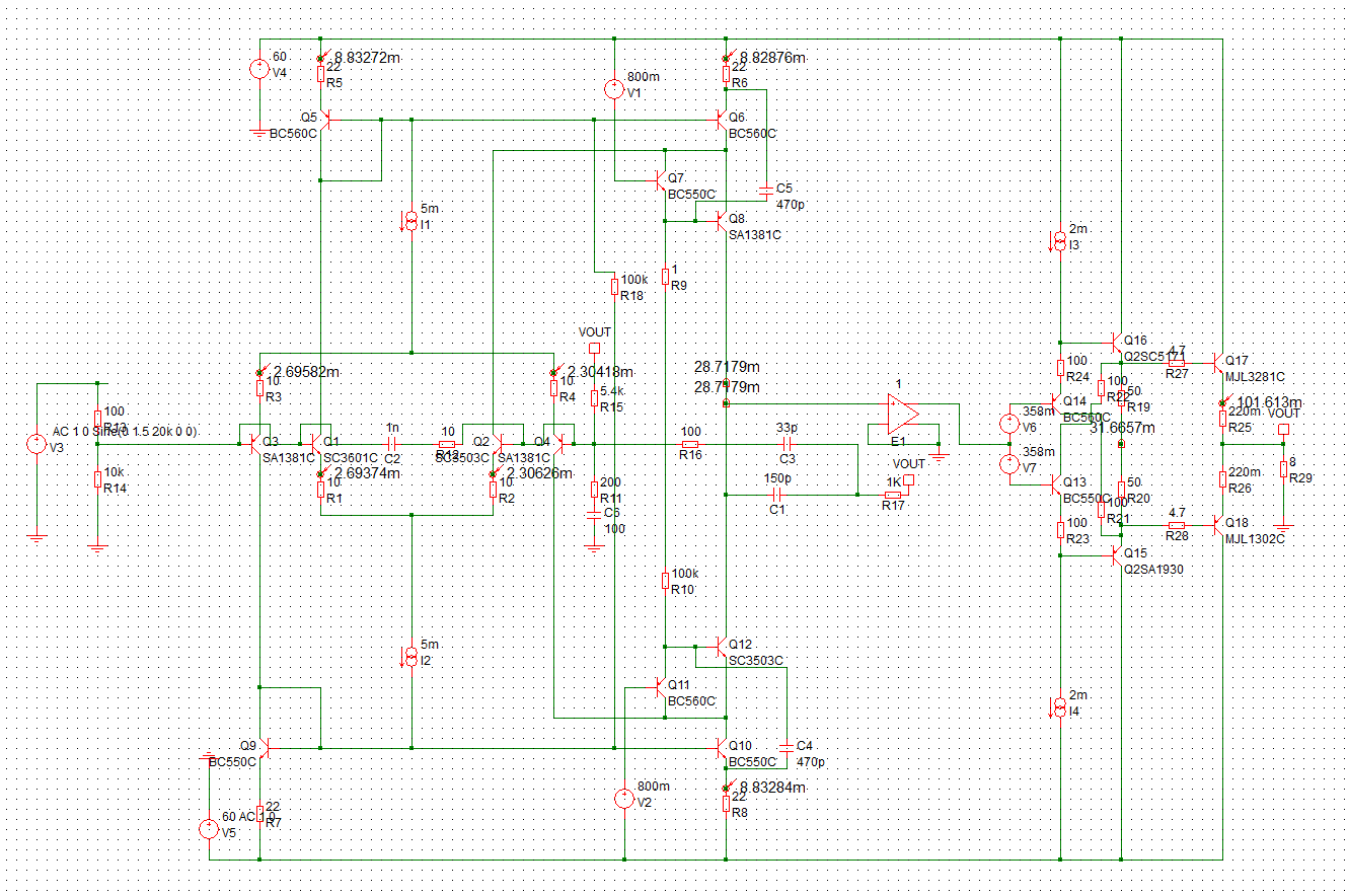

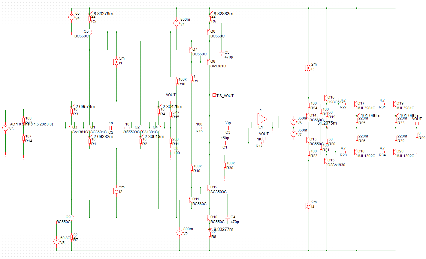

My previous sims where with Fairchild models predrivers KSC2690 and KSA1220, and Sanken supplied models of the 2SA1216 and 2SC2922, all other models are Cordell derived types.
Thank you for your work on the 2SC5171/2SA1930 models attached are some sims using them with (Cordell models) MJL1302C/MJL1302C. I also included simulations showing an additional ideal buffer between the TIS input stage and diamond EF output stage which provides perfect loading of the TIS stage and I think the results speak for themselves.
Arthur
Thanks for your efforts Arthur; most intriguing! Looks like different transistors make near-as-damn-it no difference, and the addition of an ideal buffer also makes no difference. Presumably this means the triple isn't upsetting the performance of the front-end but we're merely seeing a limit on the performance of this type of output stage? If this is the case I'm surprised that this is nearly 0.003%; I would have expected somewhere between 1 and 10 ppm (although I haven't seen a loop-gain plot so is loop gain from 20 - 100 kHz just not that high?). What happens if you add a second pair of output devices?

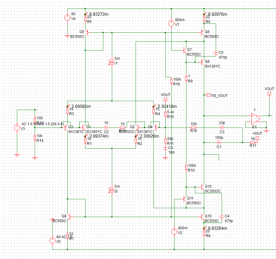

Could you also probe the output of the front end (i.e. the node joining Q8 and Q12 collectors) and calculate distortion at this point?
Hello Harry,
See attached schematic and THD plot.
Regards
Arthur

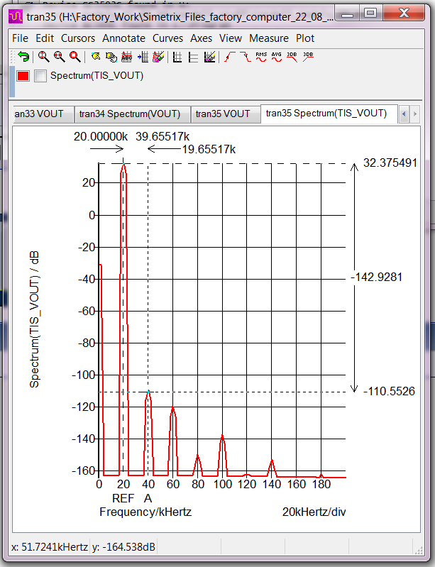

oops! I wasn't thinking was I? To linearise the output stage, a pre-distorted signal must be applied at its input. So when negative feedback is working, we would expect the front end to have a distorted output!

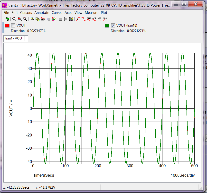

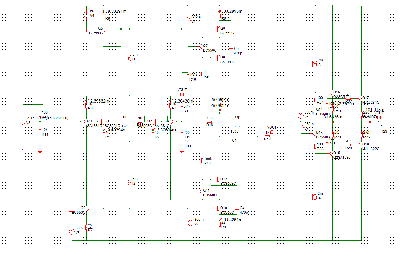

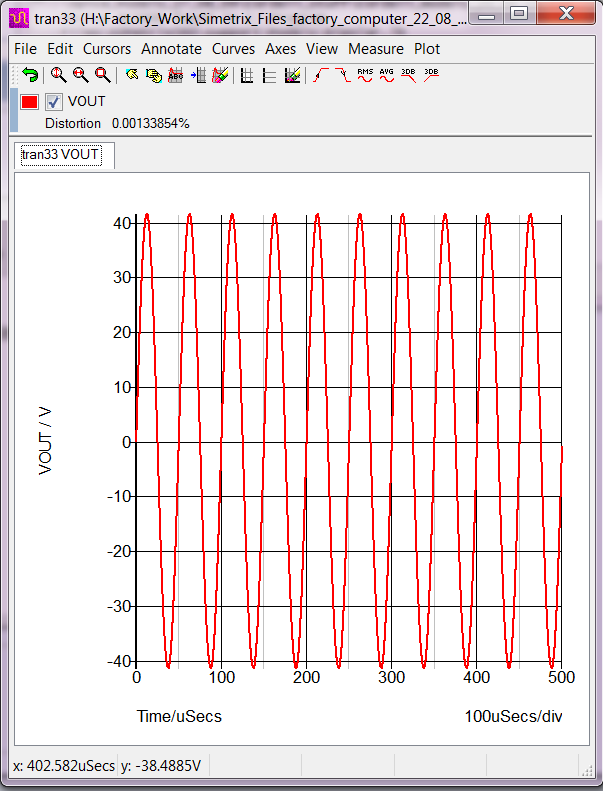

THD with 2 pairs.
Hello Harry,
Even when I load the TIS_VOUT node with 100k it has very little effect on the THD at the output across the 8R load.
Attached is the THD simulation with 2 output pairs.
Regards
Arthur

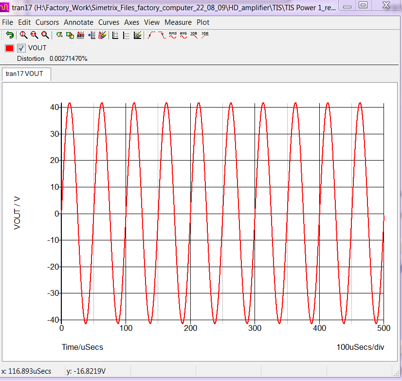

Hello Harry,
Regards
Arthur
I had to rethink too.
To see the distortion of the superTIS we need to take the feedback from the superTIS output.
Will need to be buffered but that is easy, can we see that, Arthur?
Best wishes
David
PS
Pheonix said:Even when I load the TIS_VOUT node with 100k it has very little effect on the THD at the output
Perhaps my concern about the load on the superTIS has been based on a faulty assumption all the time.

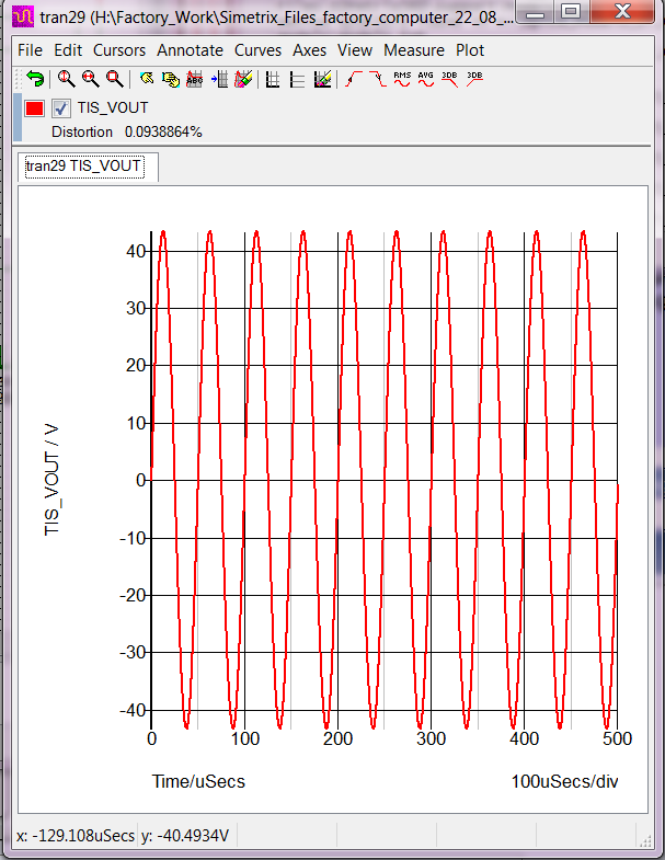

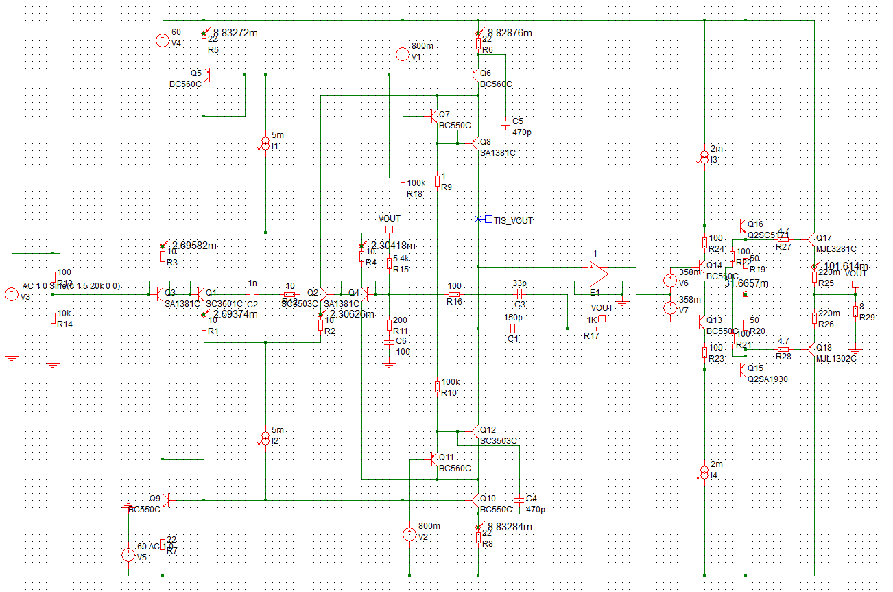

TIS THD with ideal ouput stage
Hello Dave and Harry,
The TIS stage by itself has very low THD its fair to say that the main source of distortion is the conventional diamond EF output stage. Even the simulation with the addition of the ideal buffer between the TIS output and conventional output made a very small difference and I don't think its worth the effort.
Regards
Arthur

Hello Guys,
What I find interesting is how linear the stage actually is with the Baxandall super pair. I too thought that the reason the Baxandall folded cascode worked so well was because it had such high output impedence and hence high gain, but the Baxandall super pair makes a very linear transistor stage by (to quote Edmond) removing nonlinear impedances: Cob and Early effect.
By simulating I think it is fair to say that you need an error corrected output stage to get the best out of the TIS input stage.

Thank you for those simulations and to Harry for resurrection of the issue. Very instructive about the role of the OPS.
I now feel closer to finalization of my amp.
Any comments from you or Harry about my rationale for a CFP + EF OPS?
