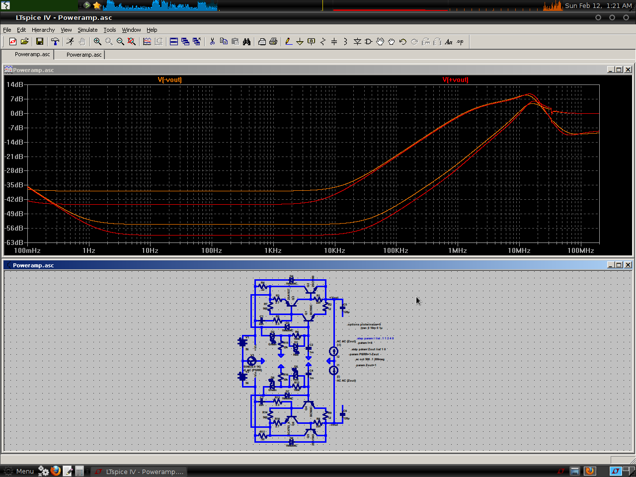

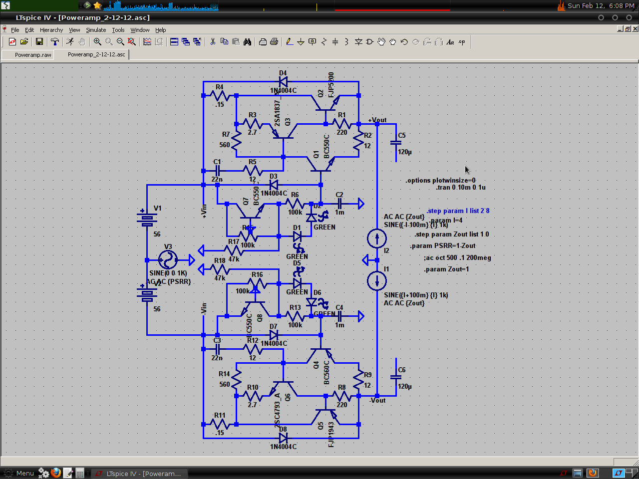

Dave, in my high-current K-multipliers I have had success ith shunt compensation. An L/R could probably be used helpfully but I did not ant to radiate. The idea is to use degeneration to limit Gm hen current is high, so that the Ft's of the transistors are more consistent and thus more responsive to hichever compensation you choose. Bummer, I kno. But it orks best out of anything I have tried in simulation, and is also still nicely fast.
Because of the high currents involved, usually large film capacitors ould be needed to stabilize a CFP any other ay, and these ould ruin distortion, sitching behavior, input impedance, speed and so on. L/R combos might be more useful but again there is the radiation issue.
Upper pair curves are output impedance, loer curves are line rejection. Another important thing about this compensation is that it has minimal impact on line rejection.
It is important to note that the CFP output stage has a "distended" tempco. This is because the Vbe and Hfe tempco of the outputs is mirrored in the Vbe of the drivers, in addition to their tempco. If e define tempco in "diode" units, e find that this gives us a fractional tempco, hich means thermal compensation may be very difficult to achieve ithout over or under compensating. This is problematic because e certainly don't ant thermal runaay and e also don't ant our bias to creep don and cause nasty sitching. There be beasts in the ater.
