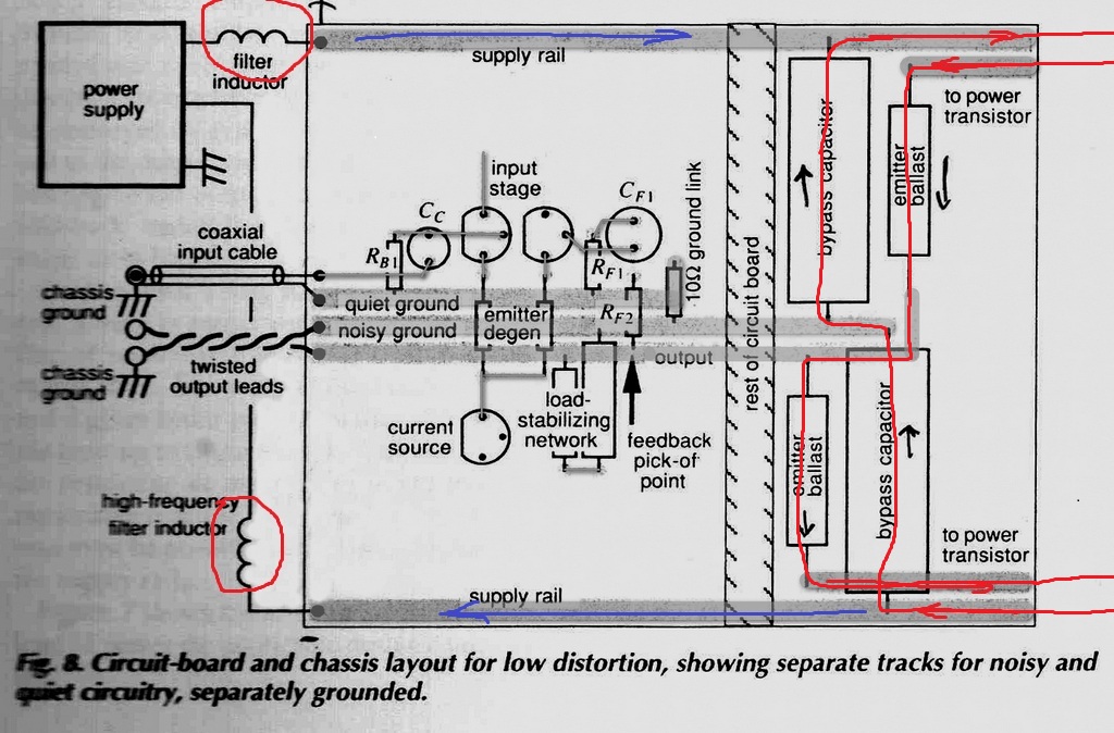

But I think that something is wrong with this approach, the current though the cap is not even close to the current trough the emitter resistor. Were is power line current??
Damir
Hi Damir,
Nothing wrong with his approach. The basic principle is sound. The only thing that's wrong is his example/implementation. Forget that one, but don't forget the lemniscate trick.
E.
lemniscate trick

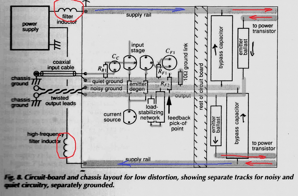

Hello Damir,
My take on the Lemniscrat trick is attached , the current in the paths highlighted travel in opposite direction and the tracks are close together reducing the loop area.
Arthur

... but how to place the emitter traces of the output transistors on top of (or underneath) the collector traces I am out of ideas. Is that so impotant as emitter currents are low distortion music signals???
Damir
This is where you need the second layer of the board. The return track can be laid out directly on top of the power track. So the current starts from the centre and runs out to the output transistor collectors, comes out the emitters and thru the emitter resistors into the output trace that return to the middle. Should even be possible to use the emitter resistor to mostly compensate for the collector to emitter offset that Edmond noted in an earlier post to me - #876 .

Hello Damir,
Arthur

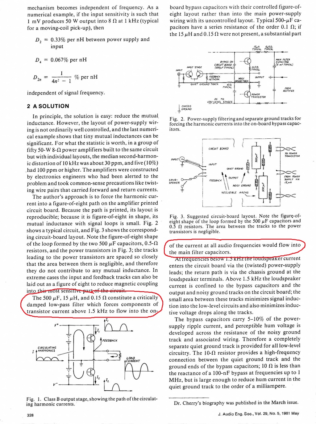

Hi Arthur,
Thanks for your help. I think, after careful reading, I understand it better. Important think is in the inductances toward PSU. Abowe 1.5kHz the current flows as Charry says, but bellow it flows inthe lines toward PSU, look blue arrows.
Damir

Hello Dave,
To the right of this diagram these two tracks connect to wires which are formed to figure eight and lead to the output devices this is (I think) the lemniscrate trick. The original amp in this article mounted the output devices away from the PCB.
My reading of the input inductor (L) in combination with the C(500uf) and R(for damping) makes 2nd order low pass filter which is used to filter off all high frequency harmonics 1.5Khz and above.
Regards
Arthur
Hello Dave,
To the right of this diagram these two tracks connect to wires which are formed to figure eight and lead to the output devices this is I think the lemniscrate trick (I think).
OK, I may have misunderstood what you meant. The emitter resistors and bypass capacitors connections do form a lemniscate shape - but the currents are quite different and so will not cancel well.
