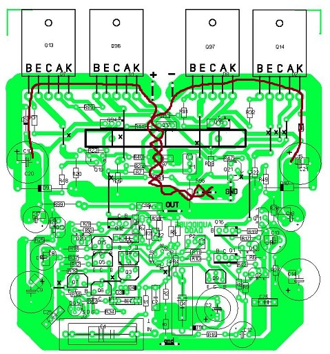

This is improved Layout for the same TT amp and it's single side PCB. The OPS grounding are made on the back side with the wires following + and . trace and then as twisted pair connected to GND. Now it is easy to make twisted wires connection from the middle of the OPS part of the PCB to the PSU.
Please comment.
dado

Don't take the NFB back to the Power Ground.
The +IN & -IN pins of the LTP (or other inputs) measure the Signal.
That signal comes in via the chassis located input socket (RCA, DIN XLR etc.).
The signal hot and the signal return are the two points/inputs about which the amplifier tries reproduce a copy at it's own output.
Give the amplifier the best chance it has of reproducing the input signal by connecting the input socket to BOTH of the amp inputs. That requires one to couple the NFB lower leg to the signal return, not to Power Ground.
This is similar to my approach as well. If you take the input ground back to the common ground directly from the input connector, then you will be creating a large loop - and given the sensitivity (its the input), are likely to get noise. The loop is in effect in series with the input signal in this scenario. My signal ground has the input, feedback and front end filter all joined together at the front end of the amp on the PCB, and then this connects to the board ground, and then back to the power supply ground. I have a 3.3 Ohms resistor in between on the amplifer board between the signal ground and the board ground. The 3 way input terminal block allows me to bypass this 3.3 Ohm resistor with a wire link back to where the board ground exits via a terminal block, but I found it made no difference, so the link is not fitted. I guess the correct thing to do would be to replace the 3.3 Ohm with a link but I have not gotten around to that.

Dadod,
no, not front end decoupling.
Output stage decoupling comes in frequency variable forms.
Electrolytics for medium frequencies where longer traces with attendant inductance are not too much of a problem. Your traces are still far too long for MF decoupling.
The output stage also needs high frequency (HF) decoupling, usually provided by small ceramic capacitors with extremely low trace lengths, of the order of 10mm, for the total loop length from drain/collector to cap to decoupling ground to power ground and then to the opposite polarity via the second cap.
I can't see the HF decoupling.
Long traces defeat HF decoupling.
If you have ceramics across the MF decoupling caps, located at the end of 3cm or 4cm traces, then they are completely useless.

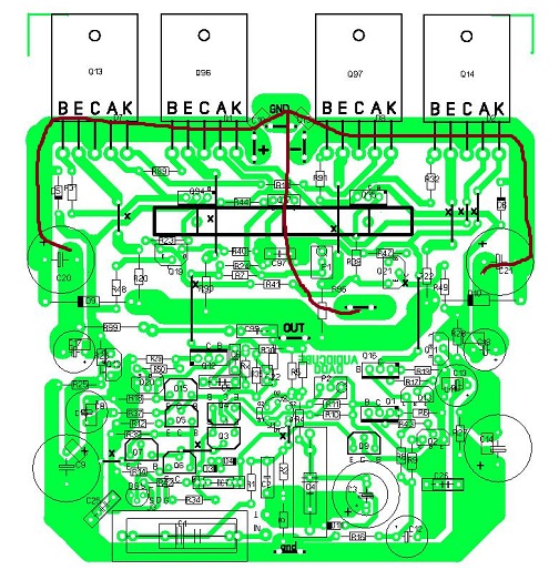

AndrewT,
I put ceramic caps just below the big elcos. I kept PCB board with the same dimension as before (the box restricts increment of the PCB). Where are the best places to put ceramic caps in your oppinion not changing the PCB dimension?
dado
This could be better, what you think EndrewT?
This is last one, I will proceed with next Layout in my TT thread.
dado
When you say "my TT thread", do you mean this one?
That looks a good place for the ceramic decoupling capacitors* but only if you place the emitter traces of the output transistors on top of (or underneath) the collector traces and bring the zobel ground to the ceramics' ground connection.

Thank you Harry,
I am to sure what type I use as here in Croatia they don't say exactly what type is, but I think is X7R or X5R. According this document X7R should not lose so much: http://www.wolfsonmicro.com/documents/uploads/misc/en/WAN0176.pdf
When I said TT thread I meant this one: http://www.diyaudio.com/forums/solid-state/182554-thermaltrak-tmc-amp.html as this is my working amp with PCB as shown before I tried to improve it. Other TT thread is new amp with high high current C multiplier on the same PCB board and the layout is not ready yet. I hope I will learn wrom this discusion well enough to design better layout for that amp as PCB dimesion is not restricted.
You said to put in parallel with ceramics, series RC. What value for C and what kind? I use 0.1u for ceramics.
Dado

Hi Harry,
I often like to make sure there is an electrolytic somewhere on a line that is bypassed with an electrolytic to prevent resonance, since the ESR of the electrolytic helps damp any resonance, especially among ceramics separated by trace inductance. I've never seen a resonance problem between an electrolytic and a ceramic.
Bob
