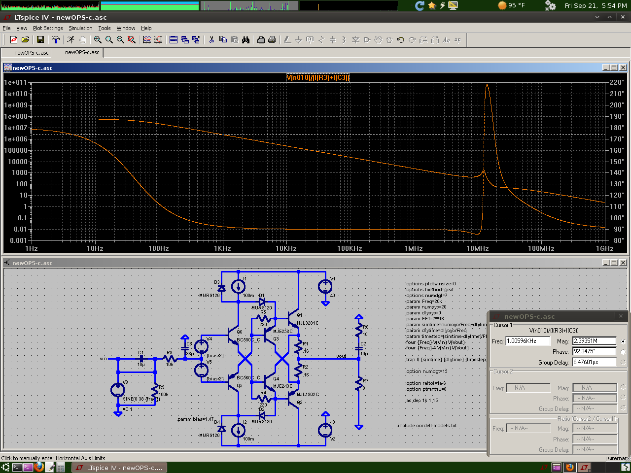

Has anyone seen this front-end before?
Dadod, you did not exclude the 100k resistor from your input impedance measurement, so the graph did not tell us anything.
This arrangement is extremely unstable. It as oscillating into saturation, hich is hy it did not ork. I got it stable by shaping the source impedance. It ill need some compensation netorks to eliminate the resonance and positive feedback. I haven't tried base stoppers.
Graph shos input impedance.

Dadod, you didn't exclude the 100k input resistor in your input impedance graph, so it didn't tell us anything.
This circuit is extremely unstable. Because of this it ould oscillate into saturation and ould appear to not orking. I stopped the oscillation by shaping the source impedance, but the circuit ill need some compensation netorks to eliminate the resonance and positive feedback. One concern ith this circuit is that the drivers have very lo Vce - I don't kno hether it ill ork okay in real life since the models don't have quasi-saturation.
The graph shos input impedance.

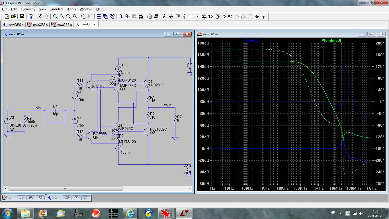

Still doesn't ork Andre.

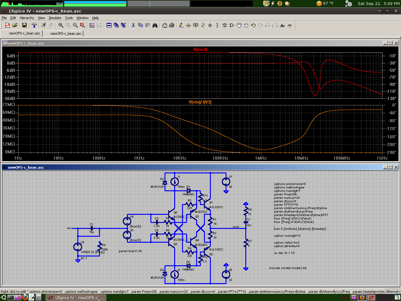

I ould not go above 2.2R base stoppers for the outputs, that is simply my preference, but I did find this helped oscillation somehat.
There is still something strange ith your input impedance chart. Check that the Ie (not emitter resistors!) of your outputs is 100mA.
I used 10 ohm base stoppers for predrivers not for the output.
It is 100mA for the output transistors not emitter resistors. I have put this OPS together with my input stage in an amp (simulation) and it does not oscillate but behaves very strange. I switched back to my previous OPS and it is OK with it, no oscillation and it works quite OK.

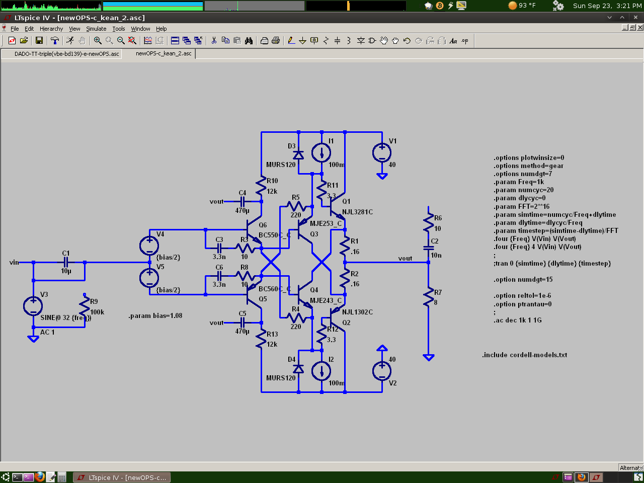

Your output frequency response still indicates that your circuit is oscillating (upturned phase). In a real amp it may ork because the output stage has a high source impedance, but it ill still have the resonance and positive feedback problems hich ill limit it's stability.
This is another example of one of those circuits people tend to dismiss as impossible because they don't kno of any ay to stabilize them... An RC snubber in just the right place can do amazing things. Try this Dadod.
Also notice I rearranged the circuit a bit. It provides the same benefits, but this time the RF current loops are smaller and less convoluted. I like this arrangement better.

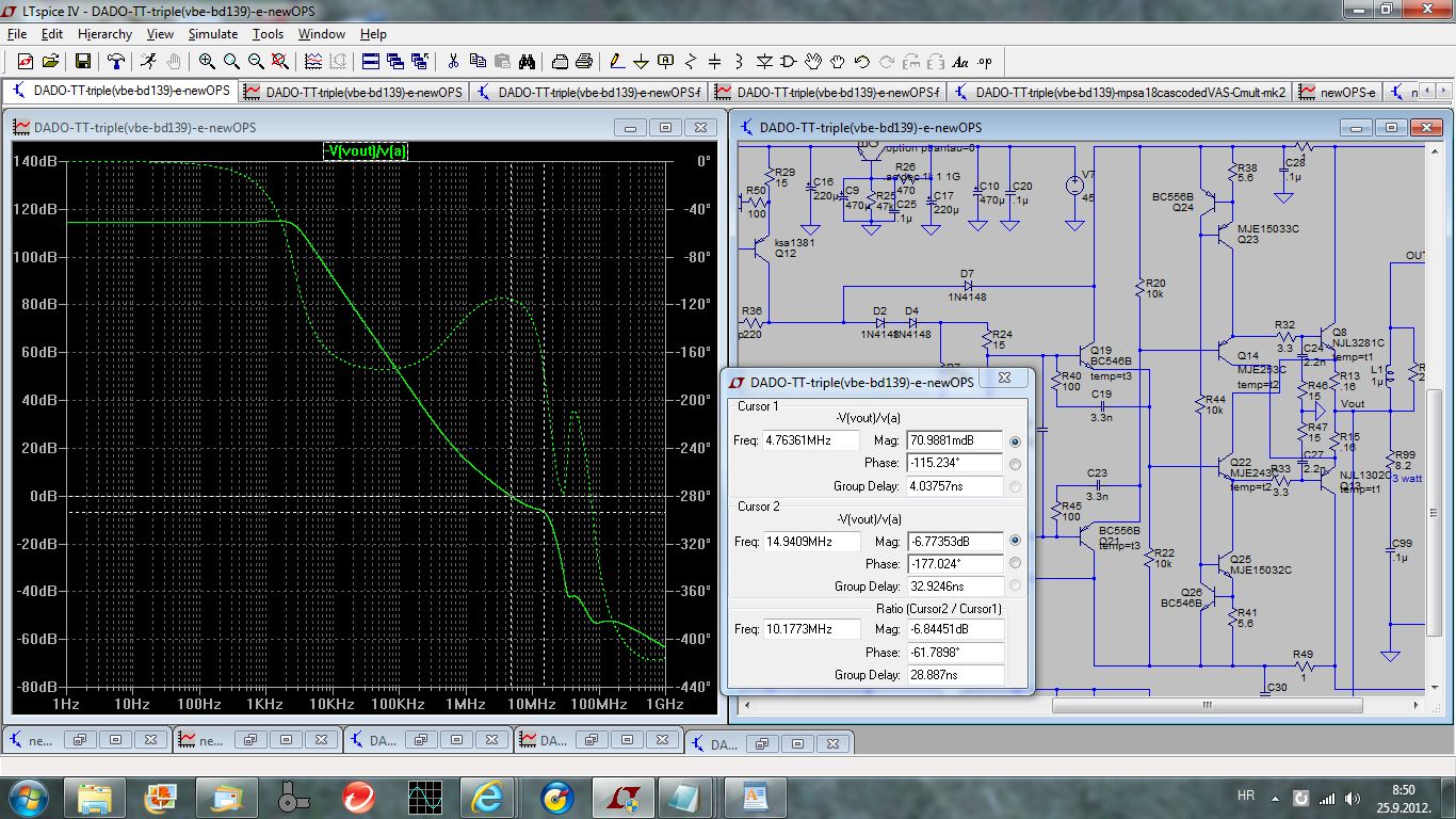

I wanted to simulate this OPS behavior i GNFB. I just used my old amp's input stage and the diodes in the power lines are left over from it, but it does not influance main goal, to show how stable is the OPS in GNFB amp.
You are correct about R44, it was way to high, now it is 10k(dissipation isnot a problem) and CCS works better, but the main problem is high peak at 9MHz. It could be tamed the with the RC at the output transistors bases.
Can you show the schematic of that yours amp prototype, or OPS only?

Changing Q23 and Q25 to MJE253/243 ill partly help the 10MHz spike. You may also try collector resistors on these transistors as a clever ay of inserting damping. You can see it this ay: the VAS output impedance has more than 90 degree phase shift. The OPS input impedance also has more than 90 degrees phase shift. This is because in both cases, capacitors are bootstrapped. Much of the amp's stability characteristics are determined by this junction and if the combination of the source and input phase gets too high, you get a local oscillator or at least a troublesome resonator. This is a big Caveat Emptor hen it comes to using bootstrapping and cascoding to eliminate parasitic capacitances; you only eliminate them at audio frequencies - at RF they become sources of phase dismay.
Other than that I ended up increasing the RC values to 68n/.33R to try and get rid of the 10MHz spike. This asn't very satisfying.

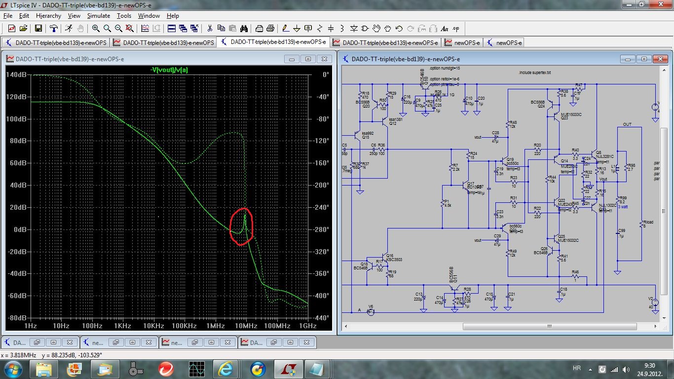

Here is my last incarnation of the amp with new OPS. THD20k is 0.81ppm at 70 W on 8 ohm.
I am not completely satisfied with the Gain Margin and how the phase twists around 15 MHz.
I simulated the CCS with MJE253/243 instead MJE15032/15033 with no differences at all, so I keep the more powerful pair here as the power dissipation go up to 9 W on the CCS. I tried MOSFET CCS with DN2540 with similar result.
Big question here is how to go for more output pairs??
I did not scratch thermal stability yet.

100mA max base drive for the outputs, means 10A max output for an Hfe of about 100. So an extra pair can still make use of the measely max 100mA drive since the outputs lose Hfe after 6A. But after 3 pairs or so you ill run out of drive at max volume; then you ill need to increase CCS current or add an extra pair of drivers.
