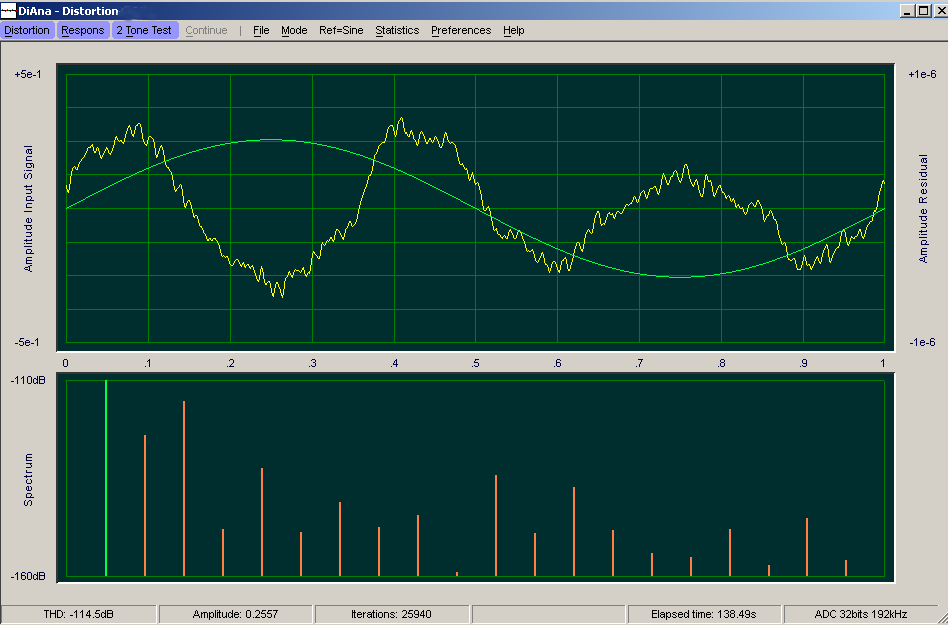

Hi Edmund. For months I have been working with my own new computer and haven't has time for much else. It's an AMD FX8350 with an SSD. I'm hoping I won't need to upgrade for a long time. I already had the PSU, case and all peripherals, so I didn't break a leg. I wonder what you got?
Your Diana software is something I think I'd really like to have, but I'm using Linux, exclusively ever since my HD died. Would you be willing to make it fully compatible with Wine? That is what Linux users run windows programs with.
I myself have been working with programming. I'm starting with assembly. It's the only language that doesn't massively confuse me. My latest endeavor:

What is the cheapest soundcard you could recommend? A very good friend bought me a Xonar DX; is there something better for the price?

Nice to hear from you again. I upgraded my PC about the same way, though with an Intel i-5 3570k CPU (just as fast as a FX8350) and a MSI B75A-G43 motherboard. I'm telling these details, because it might be important to other people who own a (legacy) PCI sound card. Many modern motherboards are equipped with a Z77 chipset, which provides no native support for old fashioned PCI cards. So what's the problem? Many of these motherboard do have PCI slots as well. But... these slots are interfaced via a buggy 3rd party chip (ITE or Asmedia) to a PCI-e lane. This doesn't work with time critical sound cards. You will get dropouts. So just buy PCI-express sound card, problem solved. No! Many professional sound cards (a Lynx L22, for example) still have a PCI bus. So I opted for the B75 chip set (targeted at small businesses), which does support PCI natively.
I'm sorry Keane, you are asking too much. I simply haven't the time to install Linux and Wine and test DiAna under yet another OS. Besides, DiAna isn't finished yet, and it takes already a lot of time to test and debug it under XP, W7, W8 (32 and 64 bits) together with bunch of different sound cards. I also have to write the documentation. Debugging this kind of software takes an awful lot of time. I was confronted for example, with a dropout that happened only once in 5 hours or so. It appeared to be 'race condition'. I solved it with a mutex, but this single bug cost me already 1 week!
Nice, hardcore programming. I like that.
Regarding graphics, I also would do it in assembler (and I did, years ago). For a FFT and that kind of stuff, I would program it in C (not C++, or C#, etc)). Almost just as fast and much easier. Have a look at "Numerical Recipes in C" (http://www.nr.com)
A few month ago I bought a comparable card, a Xonar Essence ST, same brand and designed by the same guys: Creative Labs. Please don't touch it. Everything form Creative is cheap consumer cr@p and their software is the most disgusting bloatware I have ever seen. Their ASIO driver doesn't work, neither with DiAna, nor with other software which needs an ASIO driver.
Actually, there ain't no cheap sound cards which are suitable for measurements. I own an old ESI Waveterminal 192X. It only performs reasonable after I've replaced some op-amps, resistors and capacitors for better ones. From the same brand you might buy an ESI Juli@. Bob Cordell has one. Ask him about his findings (though, at the moment he is very busy!).
If you want to measure distortion in the ppm range, choices get very limited. As a matter of fact, only stuff from Lynxstudio I can take seriously. This was the case ten years ago. Today, odd enough, it's still the case. Regrettably, a Lynx is rather expensive. You might, just as I did, buy a 2nd hand one on ebay.

The official specs of the Xonar are over-flattered.
The official specs of the L22 are under-flattered.
As for the Xonar, I can't measure right now (as I've sold this card as soon as possible), but regarding the L22, the distortion of the ADC and DAC together at 1kHz is 2ppm. See pic.
The truth is grave, as always. On Linux, I have to use open-source drivers developed by independent hobbyists. I wonder if the linux drivers work better? Wine emulates DirectSound and Wave Out; do you use a different interface? I actually discovered while messing around that Wine did better at some sound-related task than when I actually used the original windows library. I think I lost that info when my HD died though.
