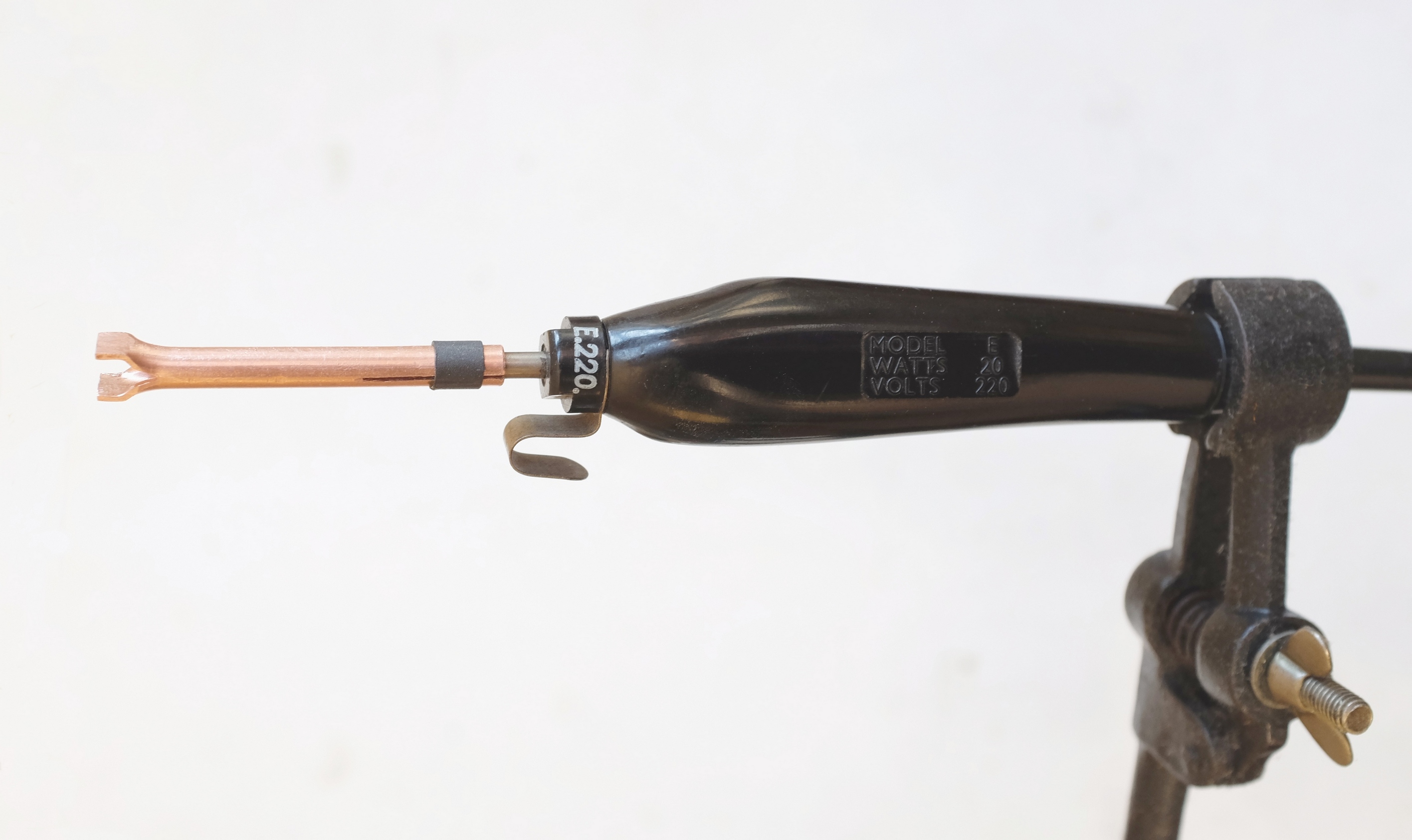

And so I did, made from a piece of 4/6mm copper oil tube and fitted on a 50 years soldering iron* (see 1st pic). Before modifying a L22, I will first practice on an old sound card (from Creative Labs of course, what else are they good for?🙄)
The picture was taken with my new camera, of course also a 'snobbish' one: same performance as a Leica M9 (though 1/7 of the price). So which one is it? Have a look at the 2nd pic. The connoisseurs among us will (and should) recognize it immediately.

BTW2, the SO8 desoldering tip works fine and no variac needed, just pull out the mains plug when the tip is hot enough.

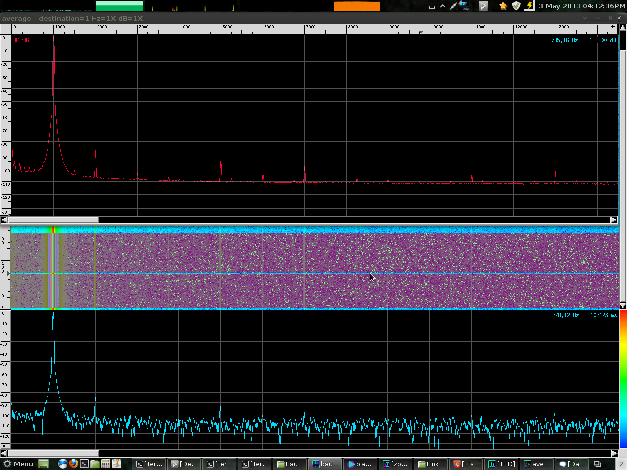

Here is the result from my onboard Realtek audio, going through a feedforward EC buffer of my design. It's better than the Xonar DX. Interestingly, this comes from an Asus M5A99FX Pro R2.0 motherboard. Same manufacturer of the Asus.
5th harmonic I think is a software error cause by Audacity or the drivers.
Baudline is the software I'm using. It is incredible.

Very interesting results. So the THD @ 1kHz is about -85dB. BUT.. is this figure dominated by the distortion of the ADC/DAC or by the EC buffer? Where can we find the schematic of your EC buffer?
Why do you think the 5th harmonic is an artifact?
One more question: What was the sampling rate and measurements bandwidth?
E.
E.

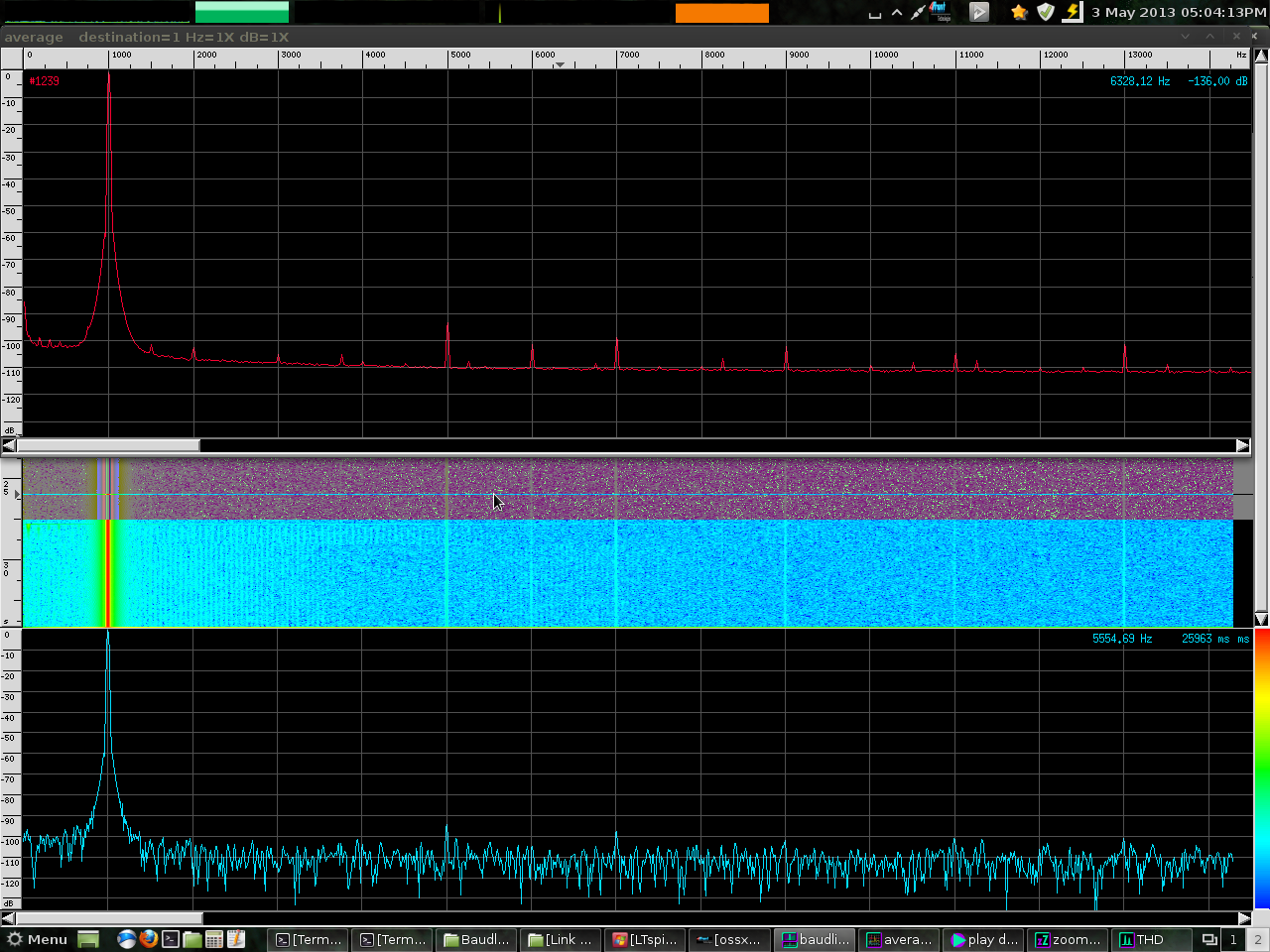

Sampling rate is 192KHz. Attached is a picture of the pure loopback test with a 5 inch cable.
5th harmonic was a lot worse when Audacity was at 96KHz. I switched it to 192KHz and it lowered significantly. The 6h harmonic wanders up and down regularly, which would seem to indicate sample conversion artifacts.
The Xonar was almost usable with the 5 inch cable but when I hooked it up to the few meters of cable to my bench, 2nd harmonic got significantly worse. However the left channel had H3 at -75db, which seemed to be a defect for that channel at both line in and output.
