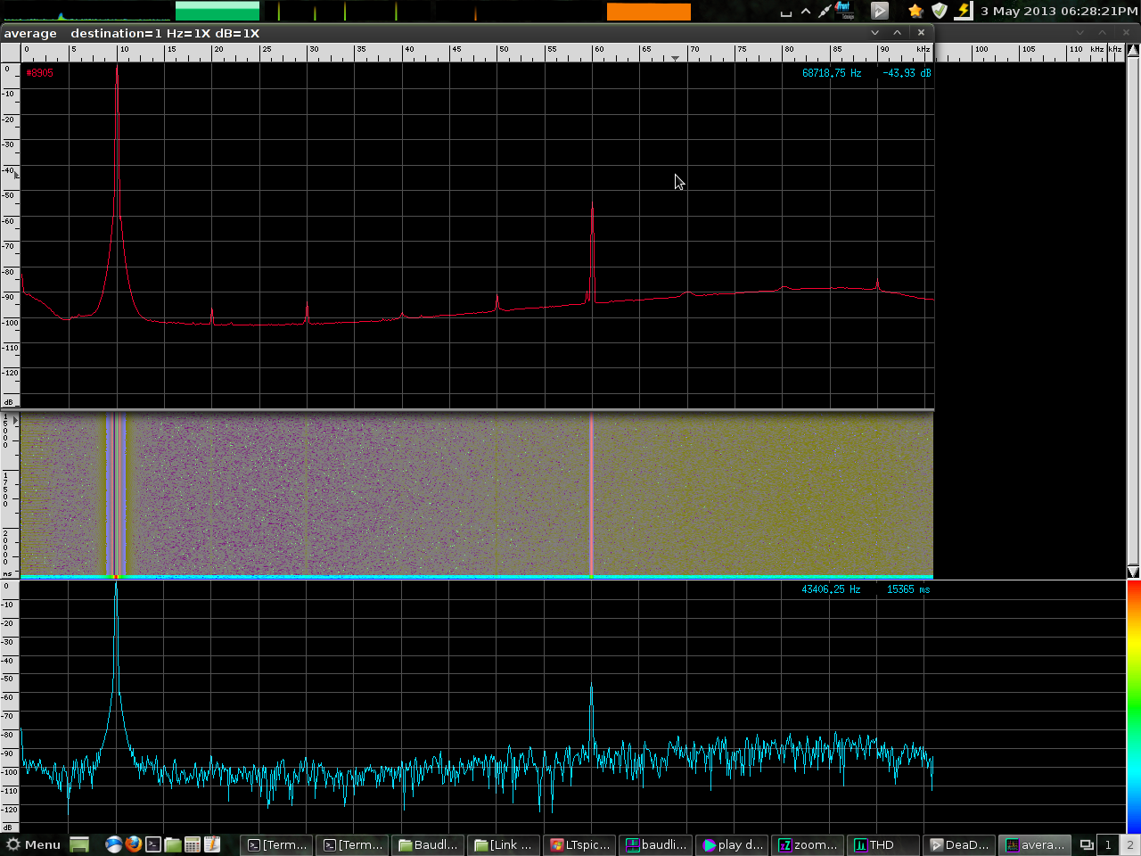

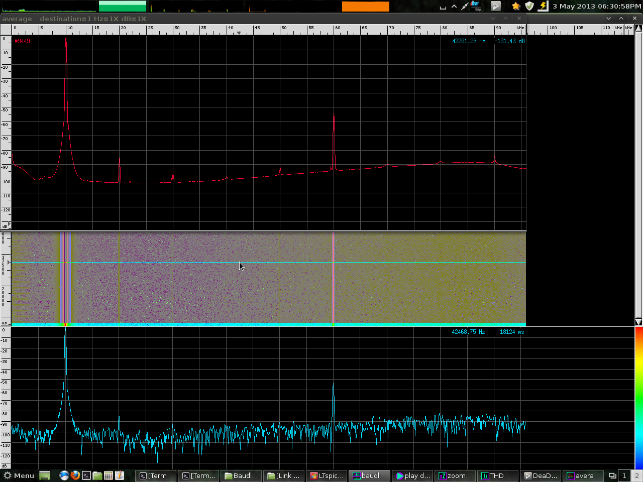

Here are the tests with and without the EC buffer respectively. And a very strange peak (harmonic?) at 60KHz.
So as I expected, with such a simple circuit and fast transistors, frequency doesn't really impact performance even when the output is loaded by an IRF250 gate. My current listening amp is an IRF250 biased at 500mA. That has to do until I have an idea how I want to design my next discrete amp.
Maybe this 60kHz peak comes from a switching regulator. OTOH, the spectrum from post 1125 doesn't show this peak. Weird.😕
The chart in post 1125 doesn't show 60KHz. I think it may be from my CRT monitor. My resolution is 1280*960; 60Hz*960=~60KHz. But the peak is conspicuously aligned to 60KHz. I will investigate, eventually.

The EC stage is biased into class A at 10mA by a 1k resistor. So it is basically unaffected by any load impedance over 5k. Its output is fed into the gate of the IRF250 fireball (for speakers), which is its own construction. If I want I can bypass the buffer or I can listen to the buffer with headphones without the IRF250 amp.
I'm measuring the EC stage on it's own; I really am not very interested in the measurements of the IRF250 amp, so I haven't actually thought about measuring it.

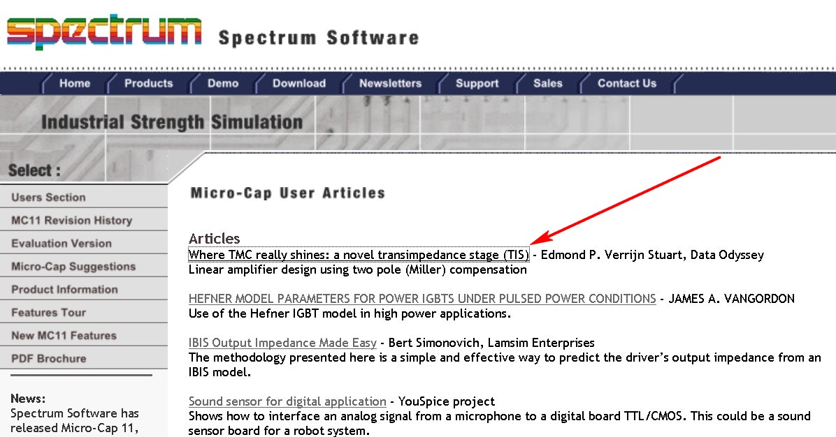

Or did you just send in a user article and had it approved for publication on their site?Clearly, Micro-Cap is watching me: 😉
(Courtesy of Stein who told me about it)
I'm very with you! To me this has always been a hint at instability/erraticness in the schematic. Opamps can make it more suspectable to convergence problems. Simple fixes I noted amongs them was putting proper compensation across opamps, sometimes inserting a resistor in the inverting input lead from output (in case of a unity gain configuration) and a comp cap across. Base/gate stoppers can be another impactless fix.Hi Arthur,
