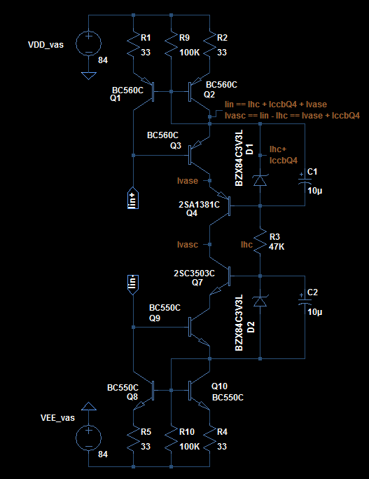

The Baxandall cascode can be better than the Hawksford because it doesn't send the cascode base currents through the VAS. But yes, depending on how you use them. there isn't always a big difference.
@Keantoken,
I've now mocked up the output of my VAS which shows how the Wilson mirrors and Hawksford cascode are tied together. I think these two wired up together like this form a very strong combo.
In this picture, I tried to replace Q4 and Q7 each by a Baxandall super-pair. And in this configuration, these didn't offer any improvement THD wise.
I've also tried to include current flows, though I've omitted factoring in base currents. I hope you can make sense of it. And perhaps you could tell whether a BSP should be advantageous here or that it indeed doesn't matter? All currents are summed back together when they go back into the mirrors. The cascode reference is actually a split-rail, taking a fixed current from the mirror outputs.
If I did something wrong, or drew wrong conclusions, just tell.. I can handle that 😉

Using a super-VAS only make sense if the VAS was already the main source of distortion. If not, then changing the VAS will hardly change anything. It could be that the VAS load is the main source of distortion, not the VAS itself, so it's contribution is swamped. When I have a question like this I have to go through several steps of verifying where exactly the distortion comes from, so treat my response as my best guess, I guess.
I tested the VAS with an ideal OPS (infinite input Z) to exclude any loading contributions. Would you agree though that the ccb of Q4 and Q7 are recirculated as it would be with a non-mirrored VAS using a superpair?

When you run the VAS with a perfect output stage you eliminate a source of VAS distortion. The OPS input voltage is nonlinear, and this nonlinear signal leaks through the VAS. This is the source of distortion that the Baxandall cascode rejects better than the Hawksford. So it makes sense to me that the Hawksford would perform better because of the way you tested it, which isn't realistic.

I'm sorry, I have trouble understanding how this mechanism would work, could you perhaps illustrate how does 'this nonlinear signal' leaks through the TIS exactly?
Provided the LTP is properly linearized and the TIS isn't loaded with a too low impedance one would expect the TIS to generate the bulk of the distortion.

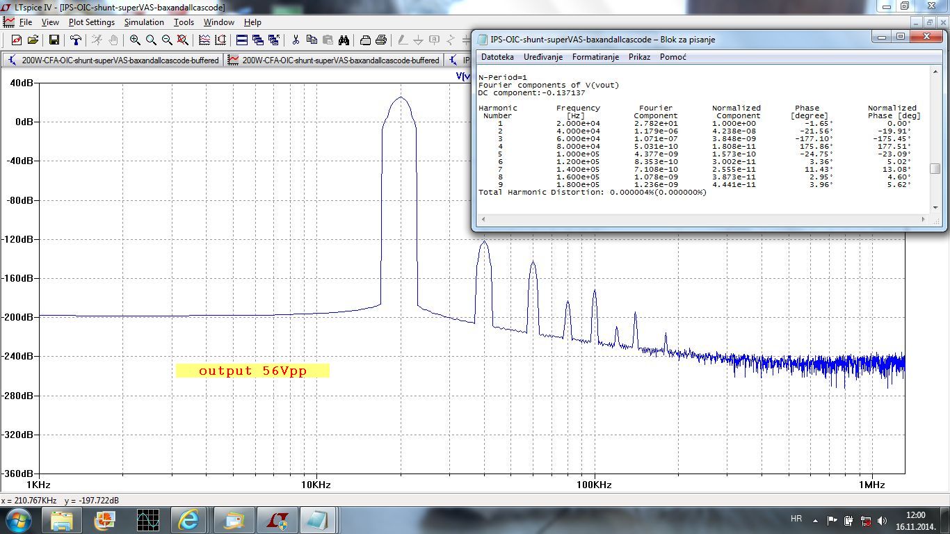

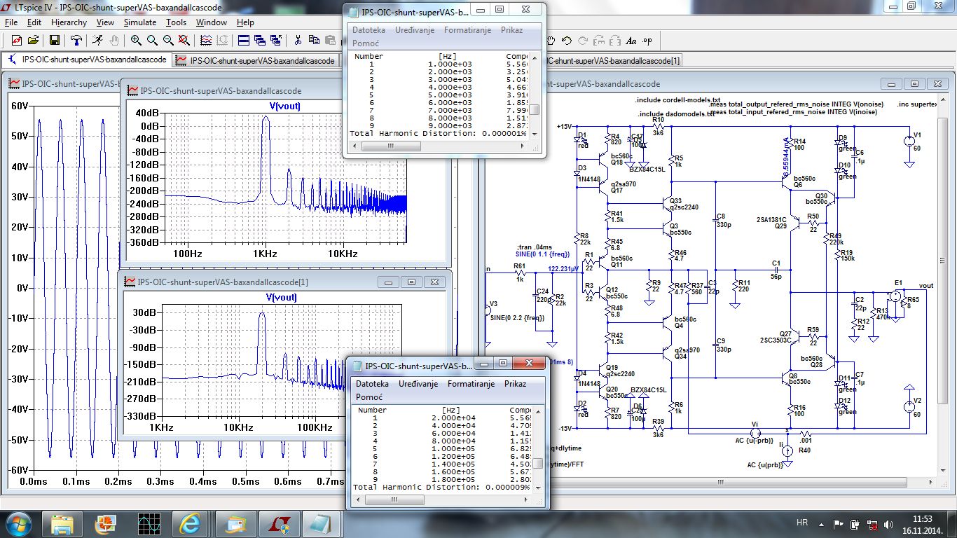

This IPS is a good example how low THD can be with ideal OPS. It uses "super-VAS" and have Loop Gain of 150dB at 10Hz and Open Lopp Gai close to 180dB. Is quite hard to tame the super-VAS, without cascade base stoppers and caps across the bias LEDs it oscillates. It is very sensitive to a output load, and to find good OPS for it almost impossible.
It shows almost no distortion at max output level. I simulated it with the standard EF triple and distortion goes up dramatically, and this is not OPS induced distortion only but the VAS distortion provoked with not ideal VAS load.
THD20k at 56Vpp at the output of the IPS is 0.000004% and goes up with the OPS to the 0.000341% and at max output to the 0.001983%, still good result but far from the super VAS potential.
