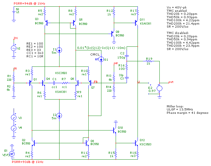

I did just that. See fig.17: SuperTIS + Bod Cordell's HEC output stage.

high Z & phase margin
- I expect best performance would had with error corrected/local feedback output stage giving high input Z, gain close to 1
Hi JCX,
Your absolutely right. As a matter of fact, it needs a very high input Z. Driving for example Bob's HEC-OPS directly (i.e using Bob's Q20 & Q21 as pre-driver ), yields less favorable results. But... using a separate pre-driver, configured as diamond buffer with bootstrapped collectors, works nice: THD20k = 3.1ppm (without TMC). See fig.17.
will be interesting to see stability with all of the nested feedback around the output Q.
Indeed, that's another point of concern. The amp of fig.12 for example, has a phase margin of only 50 degrees (seen at the output). Seen at the input it's much better: 94 degrees, but it is the lowest value that counts. So I definitely have to improve this figure, at least to 60 degrees.
E.

Indeed, it's problematic to do it with a conventional circuit, as too many stages are enclosed by the Miller loop. It will result in too much gain and too much phase shift. Perhaps one can tame such an arrangement by means of an additional massive lead-lag compensation, but most likely that is counter productive.
It's not obvious to me why it would be much worse with the conventional circuit. The IPS is identical in both. From the pre-driver onwards it is also (for comparison) identical. The difference is a Baxandall pair compared to, say, the usual VAS pair with the emitter follower before the CE.
If simulation results are very different I'd appreciate an explanation of why.
And if there is too much gain then perhaps it could be used beneficially via nested Miller compensation rather than create problems with massive shunt compensation. That's my main query. The differences in alternative shunt compensation placements is educational but for a fall-back option.
Best wishes
David.

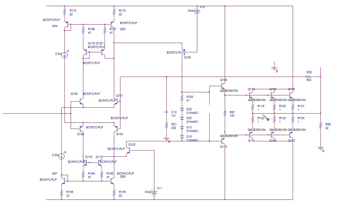

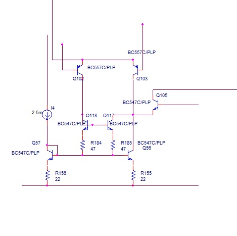

Any thoughts abt adding an inner current mirror to the long tail pair?

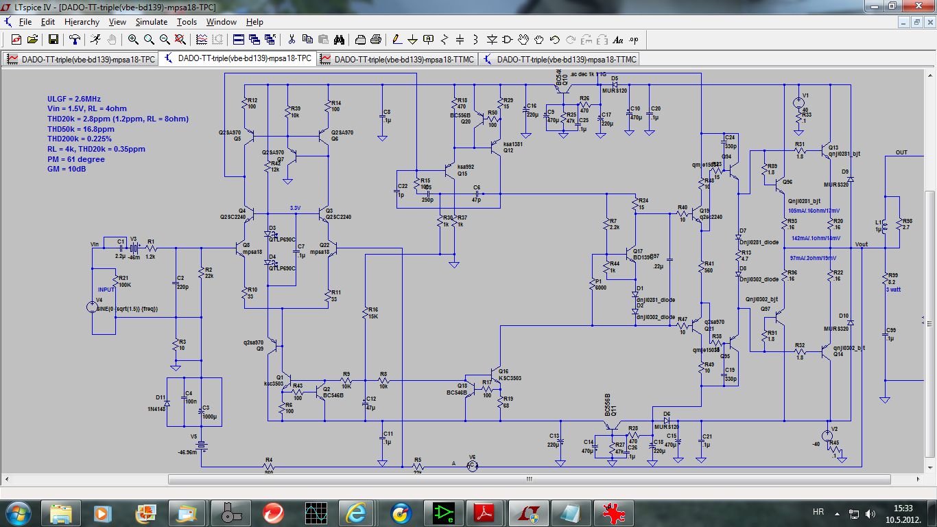

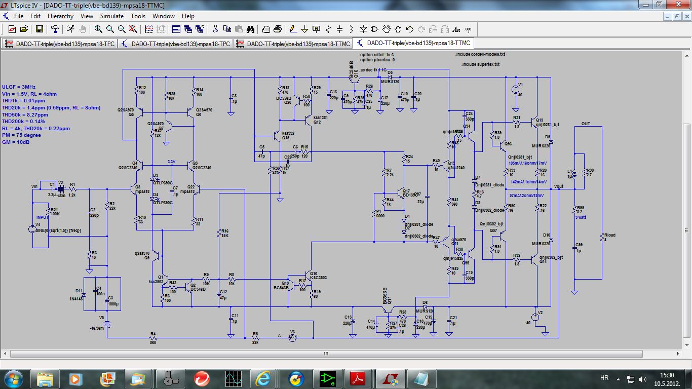

To get such low distortion or very close to it it’s possible with much simpler schematic if nice and eyes catching symmetric design is not a paramount.
As there is no perfect amplifier, D Self called his design “blameless” and I like his approach very much. He was not using a Triple Output Stage and Two-Pole Compensation. If we include those in the circuit a distortion became very low and with some better input stage we are there.
I like Edmond circuits a lot, specially his Auto-Bias circuit(I hope I will find a time to implement that in one of my next amps) but the circuit became so complicate that layout PCB design is not DIY any more. It will be very nice to have Edmond’s designs put in practice and hear the listening impressions.
Here I have two much simpler amps, one with TMC(bridged TMC actually, and could we call it BTMC) and one with bridged TPC or BTPC with distortion very close to the Edmond’s TIS + Auto-Vias II amp.
dado
Hi Damir,
Indeed, you circuit is unmistakably simpler, in particular the output stage.
(though the input stage is of comparable complexity, 15 versus 18 trannies).
Yet THD levels are on the same level. Several factors account for this:
1. An BJT OPS produces less distortion than a MOSFET OPS.
2. An auto bias circuit produces more distortion, due to modulation of the bias voltage.
3. The transition frequency of you TMC circuit is a bit higher.
I believe these are the main factors that should explain why your simpler amp performs so well.
I don't harbor any illusion that my amp will sound special. Maybe it will sound uninterestingly or even dull,
because a good amp (read: neutral amp) amp has no particular sound at all. :D
E.

Since seeing only a (small) part of the circuit, I don't know what to think about it. Could you provide a complete circuit, please?
Also, I like to hear what the purpose is of the inner current mirror.
E.
Change of input gm, and in these inviromental frendly times reduse power consumtion just a fraction ;)

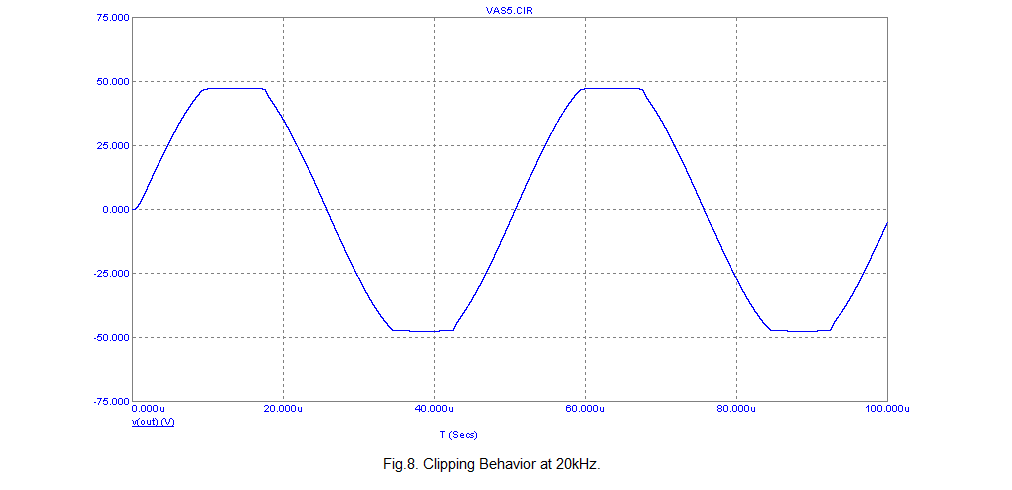

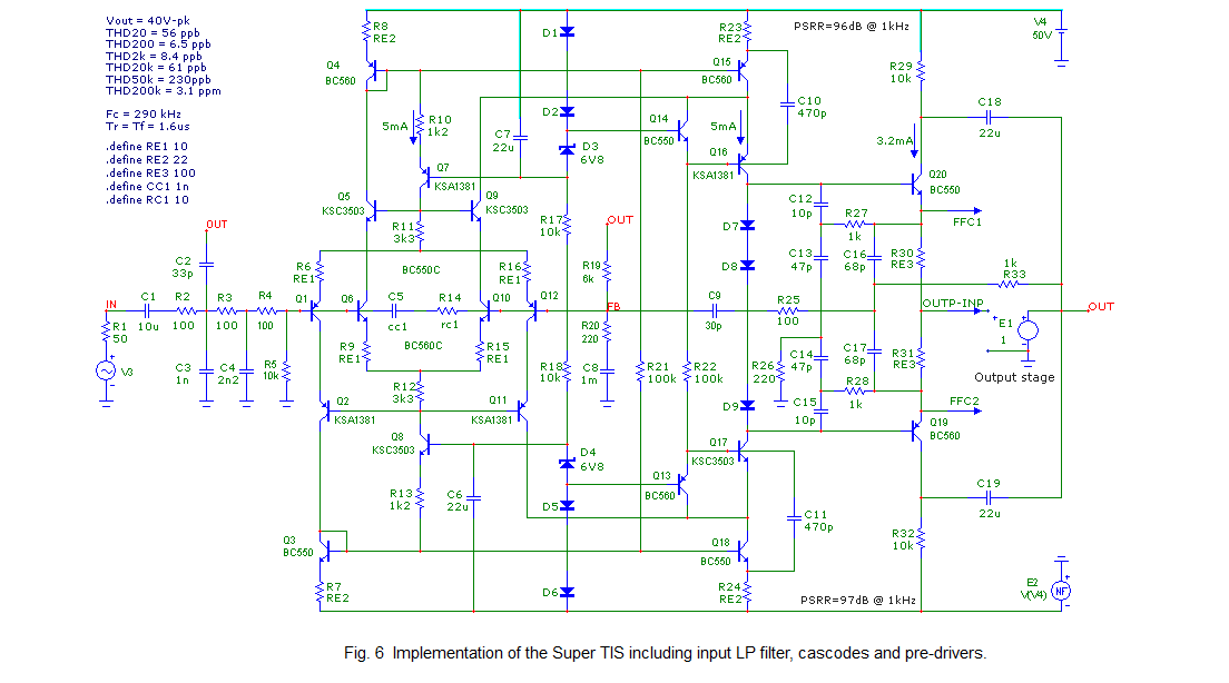

20 Khz clipping response
Hello Edmond,
On your website you post the following graph, I was wondering which actual circuit schematic you used to generate this was it fig 6.
The reason I ask is my clipped waveform sims are not as clean as yours.
Regards
Arthur
