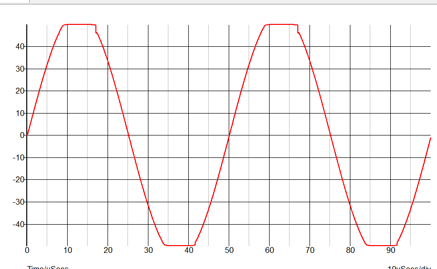

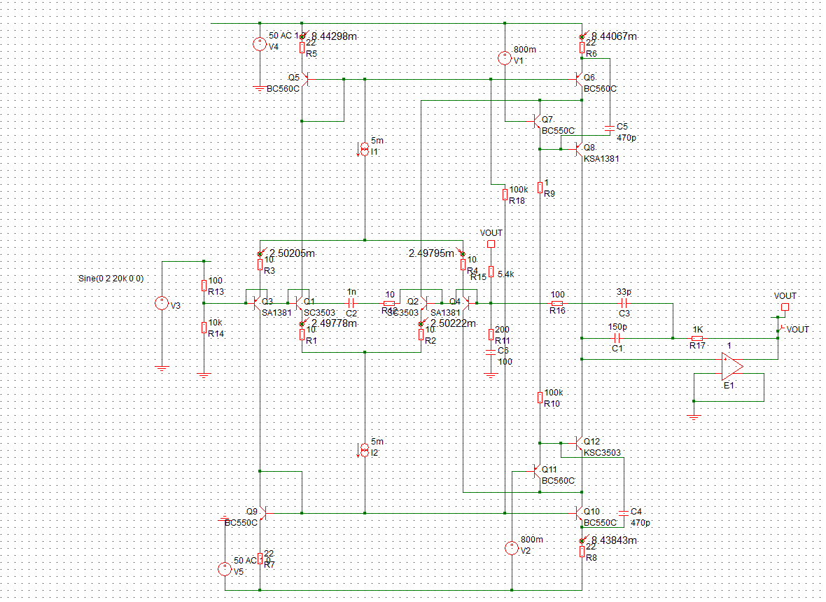

My Clipping simulations
Hello Edmond,
Attached is the circuit I used for the 20Khz simulation (its your barebones figure 5 circuit).

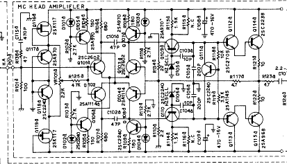

Funny that Luxman should be mentioned, The Luxman M-05 and C-05 preamp used circuits less refined but along the lines of whats being discussed here. See attachments first M-05 poweramp then C-05 preamp

Since the circuit is fully symmetrical the lack of symmetry in the waveform suggests a model problem. What models and simulator did you use?
This assumes that your schematic is correct.

At the least the KSA1381 model looks suspect. Some parameters are stated to 5 place accuracy while others are just round number defaults and some aren't within cooee of reasonable. For instance the VAF is way too low and RB is about 100 times too small. It doesn't inspire confidence. Bob Cordell has better models for this and the 3503 too.

Hi Arthur,
Try using the KSA1381C and KSC3503C models from my site at CordellAudio.com - Home.

clipping
Hi Arhur,
I seemed that the RCO = 50.1187 parameter in your KSC3503 model is the culprit. This parameter, together with QCO, VO and GAMMA has something to do with modeling of quasisaturation, see: bjt spice parameters - Google zoeken
If you comment out RCO (and the other three parameters), clipping looks fine.
Also VAF=100 in the KSA1381 model is too low. The real Early voltage of a KSA1381-E is about 400V (@ Ic = 5 ... 15mA)
edit: and the real Early voltage of a KSC3503-D is about 700V.
E.

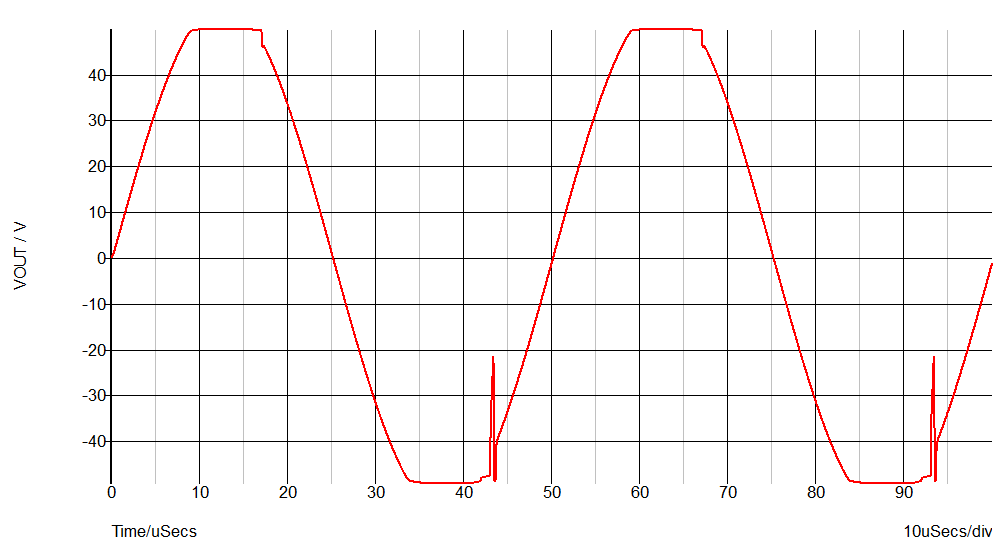

spike
Hi Arthur,
The quasi-saturation parameter QCO of the KSC3503 model is way too large: 0.05 Coulomb. I don't know what a realistic value would be, but below 1pC the spike is gone. The best way for determining QCO is a fit on a f T values under quasi-saturation conditions.
E.

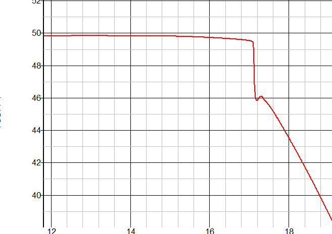

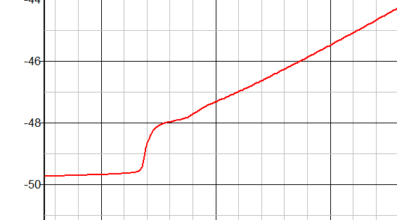

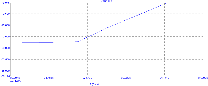

Hello Edmond,
Attached is the waveform with models modified as you said. This may be a bit mental on my behalf but I have posted the tops and bottoms of the waveform to show a zoomed view of the recovery.
Do you have the same bumps in you waveform.
