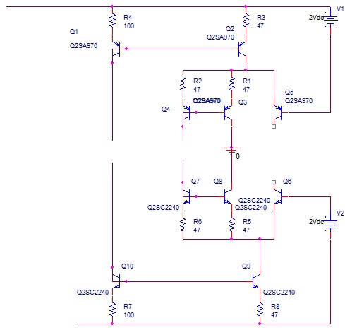

Has anyone seen this front-end before?
Sorry to realize that you dont like the control loop. But that can bee deletet...
cheers
Ronny
Hi Ronny,
Nothing wrong with a CMCL, but I rather prefer an apples to apples comparison (thus without using a CMCL).
In this respect the circuit you have put here would have been more appropriate. But again, THD20K of that circuit is much more higher. Probably, (partly) due to the local feedback via R89 and R91. However, when I disabled the local feedback, the VASes start a fierce fight, resulting in an enormous distortion. Apparently it's caused by unequal gains of the LTPs (or VASes?). With C9 = 85pF and C10 = 115pF the fighting has almost gone. It also has gone when I replaced the Miller compensation by an 'input inclusive compensation' (by means of only one capacitor, though in that case you also need extra lead-lag compensations between the drains of the jfets).
BTW, are you sure your latest schematic is correct? It doesn't work according my simulation (I got a huge distortion; fighting VASes again?).
E.
Not so sure I understand some similar issues on your website.
In Fig 1a to 1c. the TIS is shown as Ai=-10k.
Since it's a TIS should it not be defined by its impedance?
Minor proof corrections. In the "OMC versus TPC versus TMC" section you have drawn a 4 stage model but the text assumes only 3. Better to say that TPC benefits all stages while TMC does not help the IPS. Also you define CMC as Conventional Miller Compensation but use the abbreviation of OMC (Ordinary Miller Compensation I expect). OMC is better since CMC looks too like CMCL.
Best Wishes and more comments to follow!

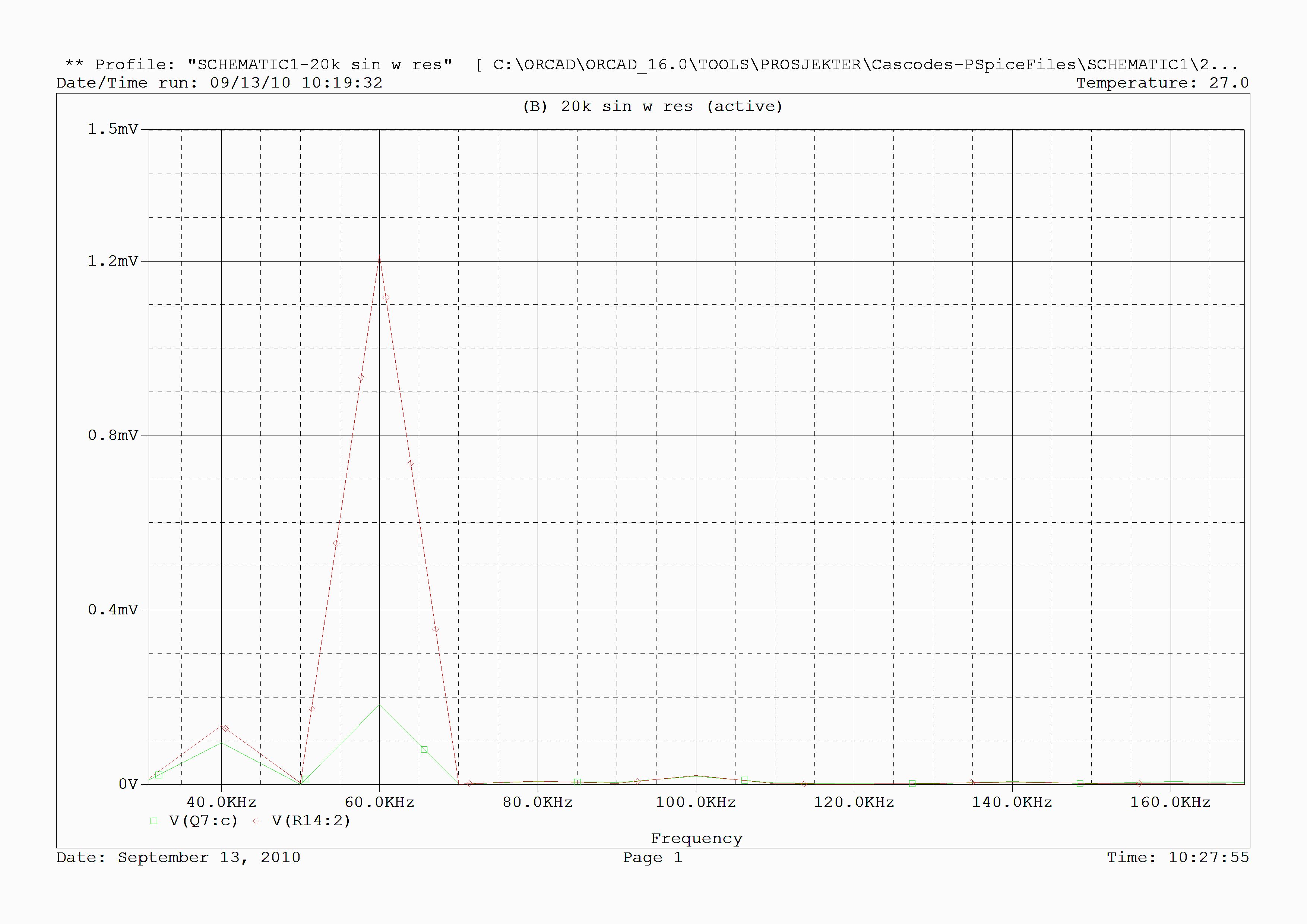

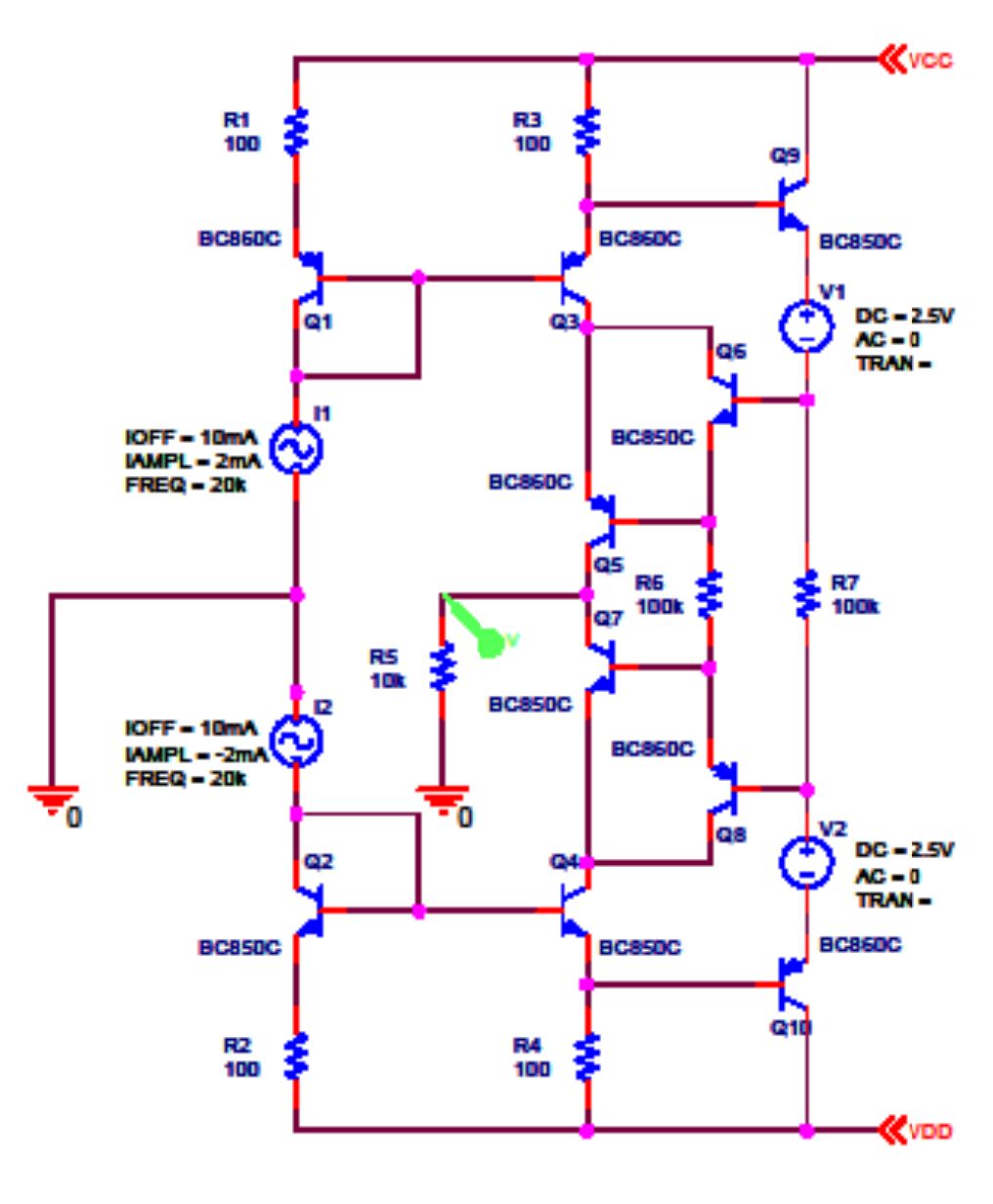

Two years ago, the same guy analyzed and measured a bootstraped Baxandall pair version, on the now defunct diy-audio-engineering forum (sorry, I don't have the permission to post the schematic). The VAS distortions were also vanishing low (even lower than what Edmond is showing here), but here it's Edmond's output stage that allows going into the ppm range. Without the autobias output stage, the results are not hugely better than a standard Blameless. That's because the standard EF output stage distortions are orders of magnitude larger than the VAS, anyway.
That's right; (as you might remember) we compared different cascode circuits.
This is a comparison between a Hawksford / Baxandall cascode and a bootstrapped Hawksford / Baxandall cascode.
As you can see in the first pdf the Hawksford / Baxandall cascode oscillated (at about 20MHz), I had to put in a resistor to tame the oscillation. (Second pdf)
As you can see from the comparison between the two (third pdf), the bootstrapped cascode has a lot lower distortion products.
Cheers
Stein

Hi Stein,
Thx for the additional info. I wasn't aware of syn08's sims of the Baxandall VAS, as I requested Andy to annihilate my membership of the diy-audio-engineering forum (for obvious reasons!).
There's one thing I really don't understand. Regarding pdf no. 1, right schematic. This one oscillates at 20MHz, while the left schematic does not oscillates, right?
So, for heavens sake, why has the base current of the 'helper' trannies (Q18 & Q18) also been recycled?! A double recycling to squeeze out the last ppt of distortion? :rolleyes:
Regarding the left schematic, what are the EF followers Q9 & Q10 good for? Why not simply tie bases of the 'helper' trannies to a fixed voltage, as is done in the SuperTIS?
E.

Hi Stein ;)
Finally VAS-transconductance stage treated as deserves it. Very much like bootstrapped cascodes, will test and implement in next amp. :up:
BTW, is this your idea or it was patented already or else? :rolleyes:
:cheers:

Hi Ronny,
Please, show us how to do that without degrading the gain of the LTP-VAS combo (and without using a CMCL, of course).
See this comment for a numerical example.
E.
Hi Edmund thanks for not humilliating me.
I see the problem about current fighting, and oscillating loops when too long.
Splitting them and the feedback makes the resistor values S1 and S2 interesting in circuit perspective.

RFI
I agree with your concerns about re-introducing the VAS-VAS fighting issue when using a complementary double VAS. I have never been convenced, at the end of the day, that a fully complementary IPS-VAS was superior to a push-pull VAS using a unipolar input stage (see, for example Figures 7.14 and 7.15, or Tom Holman's APT power amplifier).
To me, the value-added of the full-complementary IPS-VAS is that it is just a convenient way to achieve and drive a push-pull VAS. The main benefit lies in using a push-pull VAS, and the complementary IPS is just one way to achieve that. Its graphical symmetry also looks cool on the schematic, however. Its big disadvantage is that with virtually all such arrangements, you must have P-channel and N-channel dual JFETs if you insist on having a JFET input stage (which is what I always prefer). Note, however, my approximation to the complementary goal using only N-channel JFETs shown on page 143.
Bob
Hi Bob,
As for the SuperTIS, 'its graphical symmetry [not just] looks cool', but it also performs very cool. :cool:
Putting JFETs in the input stage (in case of this front-end), is the worst thing one can do. So, the fact that complementary P-channel and N-channel dual JFETs are hard to get (not to say unobtainable) is rather a bless than a curse.
I've just complemented my website (at the bottom) with distortion and RFI sims of a few front-ends with a BJT respectively a JFET input stage.
I'm sure you will like it. ;)
E.
