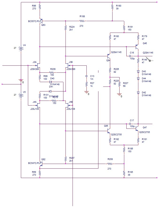

Hi Edmond
This long name is inconvenient, but shows the way to define what each component of the whole circuit gives to excellent performance.
1.We can exclude “complementary configuration” by connecting bases of Q1 and Q6 to the ground (I mean Fig.1 on http://home.tiscali.nl/data.odyssey/Super_TIS.html).
2.We can exclude “fully cascoded” by connecting collectors of Q5 and Q6 to +50v and -50v.
3.We can exclude “super pair” by connecting bases of Q10 and Q11 to V4 and V5 (1.5v).
4.We can make combinations of 1,2,3, each time measuring THD20k.
Would you like to do this?
With best wishes – Mir
Hi Mir,
See below for some distortion figures.
Original circuit: THD20 = 51ppb.
Ad 1: THD20 = 108ppb.
Ad 2: THD20 = 77ppb.
Ad 3: THD20 = 16,631ppb.
Ad 1+2: THD20 = 244ppb.
Other combinations make no sens as modification nr. 3 produces much more distortion anyhow.
Bottom line: It's the Baxandall/Dimitri cascode that contributes to the largest amount of distortion reduction.
E.
Hi Edmond
Thanks for such a bright demonstration. Having no access to JAES papers, I was surprised.
Thanks one more time - Mir

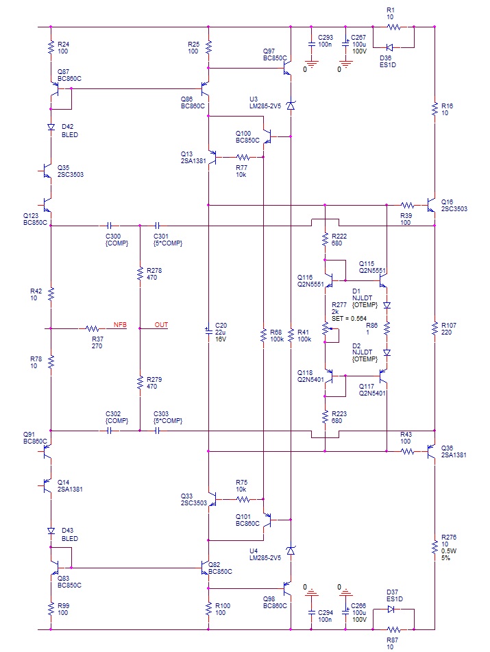

Edmond's excellent website inspires many more questions to help understand better!
Thank you David.
1. To allow a fairer "apples to apples" comparison cannot the Input Inclusive Compensation be applied to the conventional circuit too?
It seems this would reduce the load on the IPS just as in the SuperTIS, and eliminate the duplicate Miller loop paths, also as in the SuperTIS
Or is there some reason why it is so effective on Edmond's circuit but problematic on the conventional one?
Indeed, it's problematic to do it with a conventional circuit, as too many stages are enclosed by the Miller loop. It will result in too much gain and too much phase shift. Perhaps one can tame such an arrangement by means of an additional massive lead-lag compensation, but most likely that is counter productive.
Regarding a fairer "apples to apples" comparison, I believe it's as fair as can be. The only thing I've changed is shifting the frequency compensation one stage to the 'left' and replacing the VAS by an EF stage (i.e. pre-driver). So the number of gain stages as well as total current gain are kept equal.
2. To compensate the main compensation loop of IIC, Bob Cordell notes (p177) that it may be possible to have nested Miller compensation on the (so called) VAS. This is attractive in theory, since it should provide similar benefits as ordinary Miller compensation over shunt compensation. However in his own benchmark amp he does not use this method or the PLIL across the inputs of the SuperTIS, but a series RC across the LTP collectors. Any comments on the 3 choices?
A quick sim of Bod's amp revealed that a series RC across the LTP collectors works best, while put on the input of the LTP yields a lower phase margin. Why that is, I don't know yet and should be subject to further analysis.
As for the superTIS, you don't have any choice: The only nodes that are available for an additional compensation are the LTP inputs.

Thank you for the comments. Some of the context for the query is that I probably spent too many years at university and I am bothered by the lack of a cannonical model of multi-loop feedback. That is, there is no consensus model comparable to the Black model of one loop feedback with understandable maths and a nice picture. So there are interminable debates and few conclusions.
So I try to develop at least a few principles to aid the creation of a new amp. Just as Hawksford talks about "recycle of base current", it seems that "recycle of feedback" may be broadly applicable. Hence Miller compensation as a specific example and the non optimality of shunt schemes in general.
Another principle is to determine feedback loop parameters uniquely. Not ill-defined, like the famous Slone amp or over-defined, where there are conflicts when two, inevitably imperfectly matched, components try to set the one value.
Ordinary Miller compensation of a one-sided VAS respects both.
Ordinary Miller compensation of a push-pull VAS breaks the second.
MIC is a clever way to apply both principles to the main compensation loop of a push-pull VAS. With the consequent benefits you mentioned.
Even if that's not the way you considered it, it seems that when the principles are correct the improvements just fall into place naturally.
But current schemes break one or the other principle for the inner loop.
Your shunt scheme is the simplest and very natural but I wondered if the "recycle feedback" principle may be even better.
I suspect that the same reasons that make the theoretically non-ideal shunt scheme perfectly OK in practise would also apply to the (different) non-ideallity of a nested Miller scheme too.
Some op amps use nested Miller schemes which implies it can work well but I don't know the details. Can you comment?
Perhaps there is a way to observe both principles? I can't think of it myself, ideas appreciated🙂.
I suppose my third principle is that a symmetrical output is likely to be most simply done with a symmetrical circuit and Edmond's circuit appeals to that idea.
I know it's not your preference so I won't bore you, because I have already perhaps written too much and I assume there have been discussions in other threads. (I try to read them so as not ask newbie questions but there's a terrible lot!!)

Hi sir, im not convinced that the vas-vas fighting issue can be compensated for or designed away.Hi David,
Thanks for pointing out the post involved. That is an interesting point you make. At the time I did my MOSFET power amplifier with error correction I probably just didn't think of trying Miller compensation for the local loop formed by the Miller Input Compensation. My main focus at the time was on the two benefits of MIC, namely greatly increased slew rate and a compensation scheme that had both ends of the compensation capacitor referenced to ground, rather than one to ground and the other to a rail.
Also, because the circuit nodes are balanced at the location between the input stage and the VAS, it seemed more straightforward and appropriate to use a differential R-C shunt to achieve the inner loop compensation. I also felt this was OK because the unity gain frequency of the inner loop can be much higher than that of the global loop, so its effect would be less intrusive anyway.
I agree with your concerns about re-introducing the VAS-VAS fighting issue when using a complementary double VAS. I have never been convenced, at the end of the day, that a fully complementary IPS-VAS was superior to a push-pull VAS using a unipolar input stage (see, for example Figures 7.14 and 7.15, or Tom Holman's APT power amplifier).
Bob

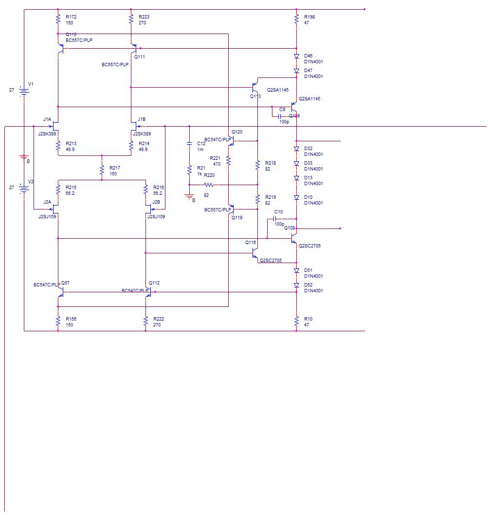

Quad vas:
The sum of the topside currents and bottom side currents, AND that the sum of the output vas transistor currents are constant, it also means that the "unused" two currents of a quad vas is constant and can be the local feedback monitored to stabilize the vas fighting issue.
Cheers
Ronny
Come on !Come on. You don't have to build that thing in order to prove that the super TIS solves two known issues at once that plagued a fully complementary front end. These issues are (or better: were):
1. An ill defined quiescent current of the VASes (see the Randy Slone amp)
2. The issue of the so called 'fighting' VASes (caused by unequal gain of top and bottom VAS and/or unequal compensation caps).
E.
1. This is a matter of design.
2. the vas fighting is not realy a big problem.... or unequal compensation caps may .
Cheers
Ronny
Come on !
1. This is a matter of design. [a well defined standing VAS current]
Hi Ronny,
Please, show us how to do that without degrading the gain of the LTP-VAS combo (and without using a CMCL, of course).
2. the vas fighting is not really a big problem.... or unequal compensation caps may .
Cheers
Ronny
See this comment for a numerical example.
E.

Hi Ronny,
E.
Well....
I said: and without using a CMCL, of course
edit: BTW, compared to the SuperTIS, THD20k of that circuit is about thousand times higher and the slew rate ten times lower.
Sorry to realize that you dont like the control loop. But that can bee deletet...
cheers
Ronny
And if you ignore the servo (which is obviously wrong):
http://www.diyaudio.com/forums/soli...s-blowtorch-preamplifier-934.html#post1609863
Two years ago, the same guy analyzed and measured a bootstraped Baxandall pair version, on the now defunct diy-audio-engineering forum (sorry, I don't have the permission to post the schematic). The VAS distortions were also vanishing low (even lower than what Edmond is showing here), but here it's Edmond's output stage that allows going into the ppm range. Without the autobias output stage, the results are not hugely better than a standard Blameless. That's because the standard EF output stage distortions are orders of magnitude larger than the VAS, anyway.
Got it, see attachment.
- Has anyone seen this front-end before?
