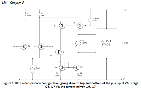

Of course, I know of this circuit, though under a different name. I thought, erroneously!, it was named after Borbely. This circuit differs in many ways from the super TIS. The NPN/PNP combination you mentioned for example, serves a different purpose. Digging further into the links, I found this schematic of the Lender VAS. 🙄
Next, I decided to have a closer look at the origin of this incorrect implementation, and stumbled on a folded cascode configuration (see below). This circuit comes more closely to the super TIS. However, the author dismissed the idea:
'Firstly, there would appear to be a lack of overall open-loop gain because the common-base stages Q4, Q5 do not give any current gain.'
It's precisely this 'lack' of gain that makes the super TIS stable! (at DC and HF)
'Secondly, there is no obvious way to apply the Miller dominant-pole compensation that is so very useful in linearizing a VAS.'
Oh really? Apparently, the author has never heard of an 'input-inclusive-compensation '. :tongue:

Hi Edmond,
I know Yamaha uses them in a completely different (traditional) way. It was just because Baxandall pairs are almost never used in commercial designs and some discussion arose about stability issues, that I wanted to show these applications of the Baxandall pair.
BTW Already in 2004 these stability issues were discussed on this forum, both as TIS (VAS) and as cascode stage: http://www.diyaudio.com/forums/solid-state/25172-baxandall-super-pair.html#post293504. But going through that thread I just saw that also Yamaha's use of it was already mentioned.
Cheers, Steven

Yes. The compensation described as input inclusive compensation by Self in linear audio is simply phase lead compensation with the output stage excluded.
I already expected you would call it 'lead compensation' (I still remember the discussion about the compensation of Bob's HEC amp), but what's wrong with calling it 'input-inclusive-compensation'? In fact, the compensation loop does encompass the inverting input of the IPS. So.....
PS: Given the context of post 123, I think it was more than appropriate to use D.Self's own terminology. 😀

Actually, I termed it Miller Input Compensation. So-called input compensation has been around forever, and has always had the property that it did not impair slew rate. I employed MIC in the early 1980s because it also does not impair slew rate and it does not reference either side of the compensation capacitor to the supply rail.
It is wrong to describe MIC as lead compensation, as Edmond has explained. MIC is fairly well-described in my book.
