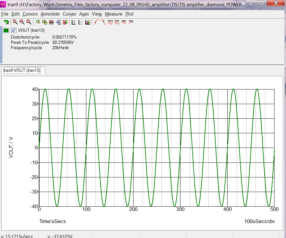

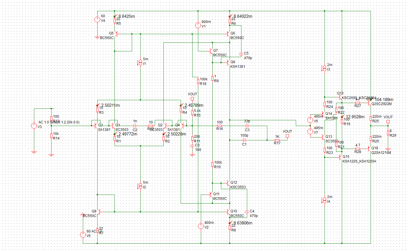

TIS with simple BJT output THD Sim
Hello Edmond
I did some some THD simulations with circuit attached and into 8R 20Khz I achieved 0.002% THD at 80V PP.
I must confess this seems to me a little bit high with the TIS input stage. Have you done sims with a simple output stage what sort of results do you get .
Regards
Arthur

Hello Edmond
Regards
Arthur

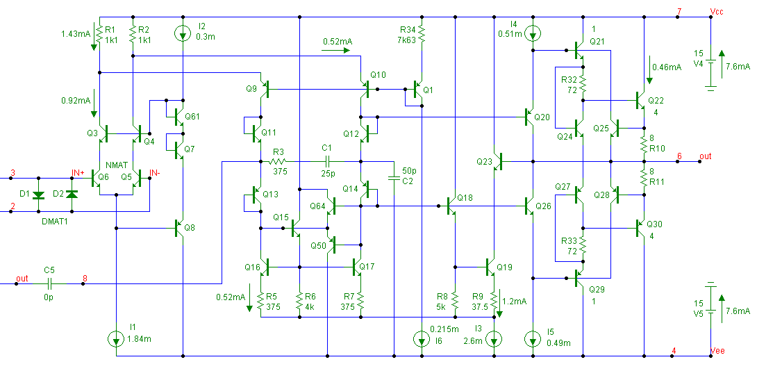

AD797
In answer to your actual question- No one has mentioned the AD797. Is this not a bit similar? I have only ever seen simplified circuits of that op-amp and they had no Baxandall pairs but it has plenty of open loop so some of the schematic "transistors" are perhaps physical pairs.
David
Hi David,
Although I wasn't inspired by the AD797, it just happened that basically both circuits share indeed the same philosophy: only two stages with high gain and folded cascodes. On the other hand, there are also big differences: apart from Baxandall super pairs, no floating current mirror and a totally different frequency compensation.
See below for more details of the AD797. Regrettably I don't have accurate models of the transistors.
E.

Hi Edmond
Congratulate you with inventing and introducing relatively simple circuit with superb linearity.
I think it can become a standard for the years.
But why do you call it “transimpedance”? Common base stage is not transimpedance, even if you use a super pair instead of a single transistor, and the whole circuit is definitely transconductance (98 mA/V).
IMHO, it can be called something like “an LTP loaded with current mirror fully cascoded with super pair in a complementary configuration”, where “fully cascoded” means your combination of conventional and folded cascoding, that I’ve never seen before.
This long name is inconvenient, but shows the way to define what each component of the whole circuit gives to excellent performance.
1.We can exclude “complementary configuration” by connecting bases of Q1 and Q6 to the ground (I mean Fig.1 on http://home.tiscali.nl/data.odyssey/Super_TIS.html).
2.We can exclude “fully cascoded” by connecting collectors of Q5 and Q6 to +50v and -50v.
3.We can exclude “super pair” by connecting bases of Q10 and Q11 to V4 and V5 (1.5v).
4.We can make combinations of 1,2,3, each time measuring THD20k.
Would you like to do this?
With best wishes – Mir
PS. A short name may be “Stewart Audio Front End” (SAFE) – like “Baxandall Super Pair”. S may also mean “super”.
suitable name

Hi Mir,
Thank you!
And perhaps even the end of the ubiquitous (and boring!) blameless topology. 😀
Regarding Q7...Q12 in isolation, you are perfectly right. It is a CCCS with a (current) gain of just 1.
On the other hand, since the output of this stage is tied to a (well defined) impedance, the final output signal takes the form of a voltage source (well, at least, that's the intention). This is even more true for the 2nd figure (the emitters of Q19/20). So, in this respect, we might call it a TIS.
Please, look here for a further discussion.

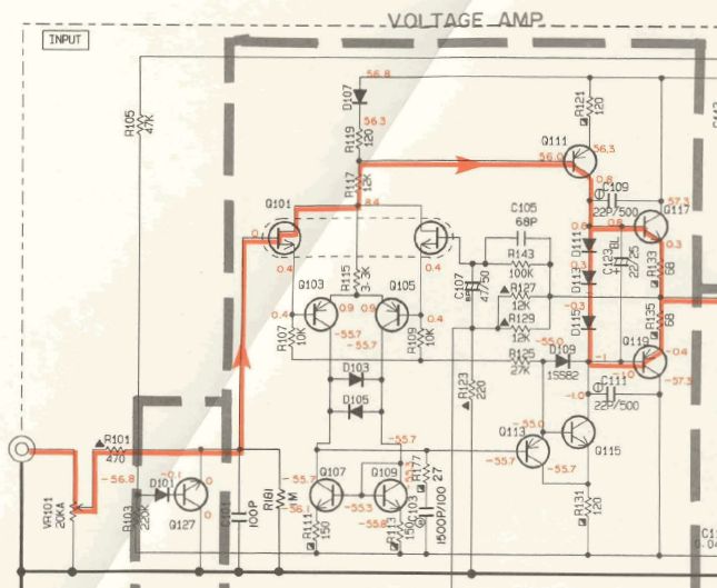

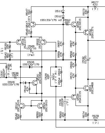

Hi Edmond,
Nice circuit!
I think I have seen the Baxandall super pair only be used in commercial amplifiers from Yamaha, such as the MX2000, the XP1000/2500/3500, the XS250/350...
Steven

Hi Edmond,
Nice circuit!
Thank you Steven.
Steven
You're right, these amps do contain Baxandall super pairs. However, in this case they are used differently: as a TIS (or a VAS or CCCS if you like) which also provide current gain. In case of the "Super TIS", the Baxandall super pairs are use as cascode, which provides no current gain (just 1x). Here, it's the next stage (pre-driver) that provides the current gain.
BTW, I get the impression that among the established audio guru's nobody realizes/recognizes the far reaching implications of moving the gain to the next stage.
E.
