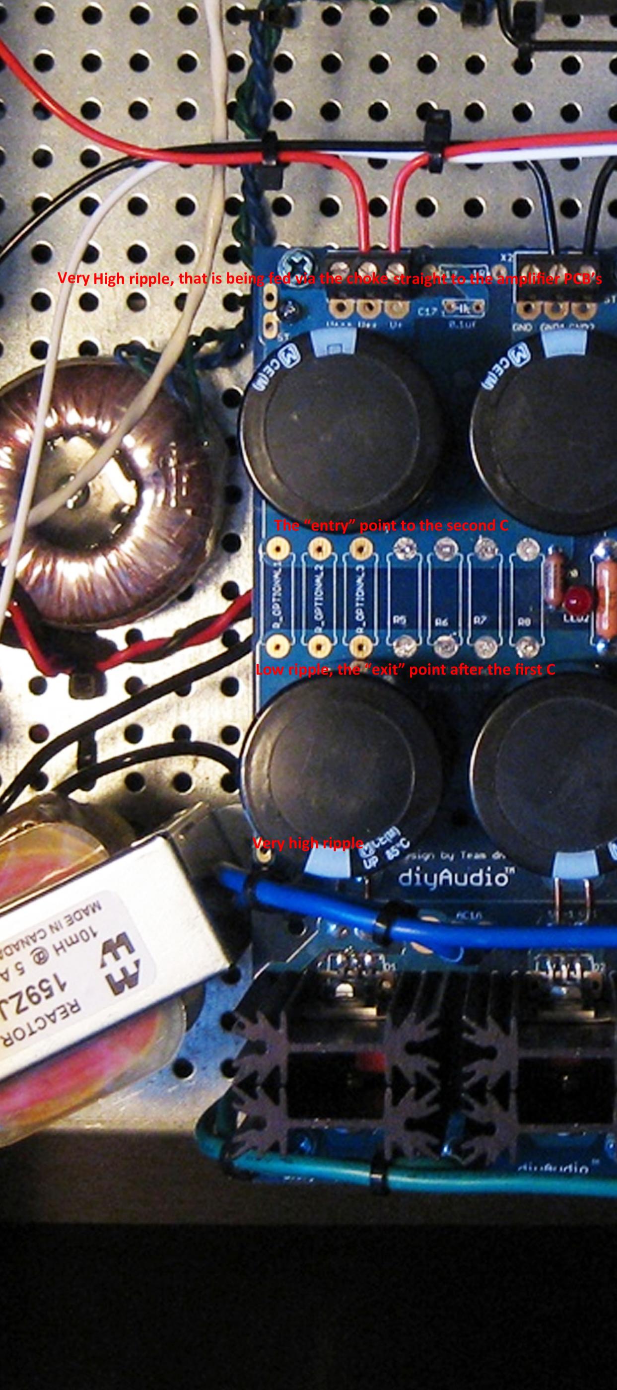

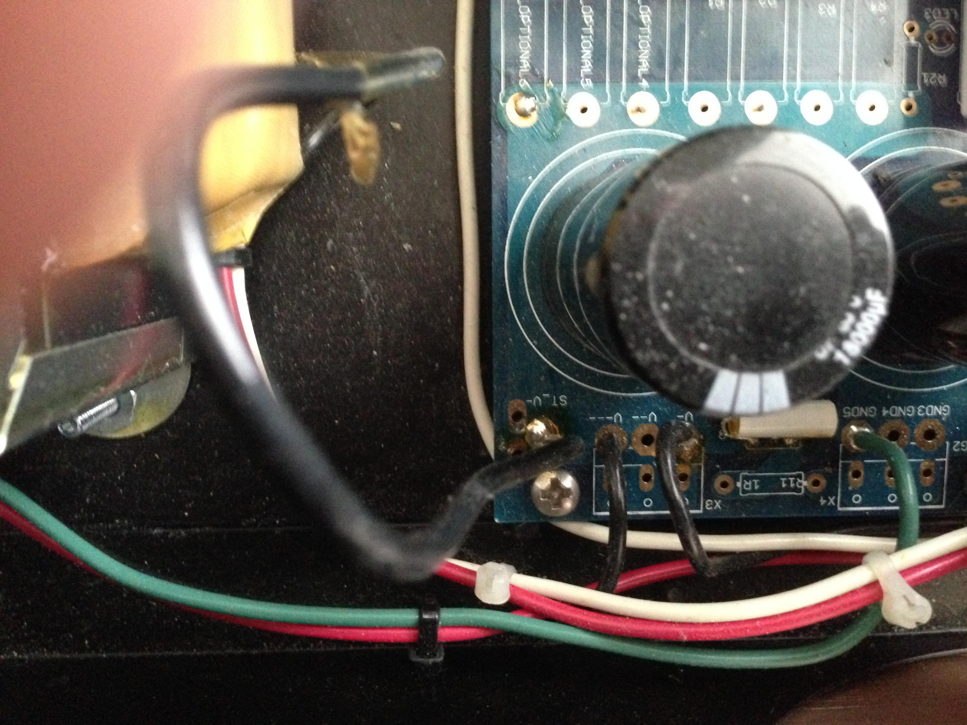

Well i put mine into the "largest non used holes" without have to drill or bodge my supply in any way.
FYI - If you don't understand what somebody is trying to explain to you, ask for clarification. #dontbeanasshole
God, you have to love them...

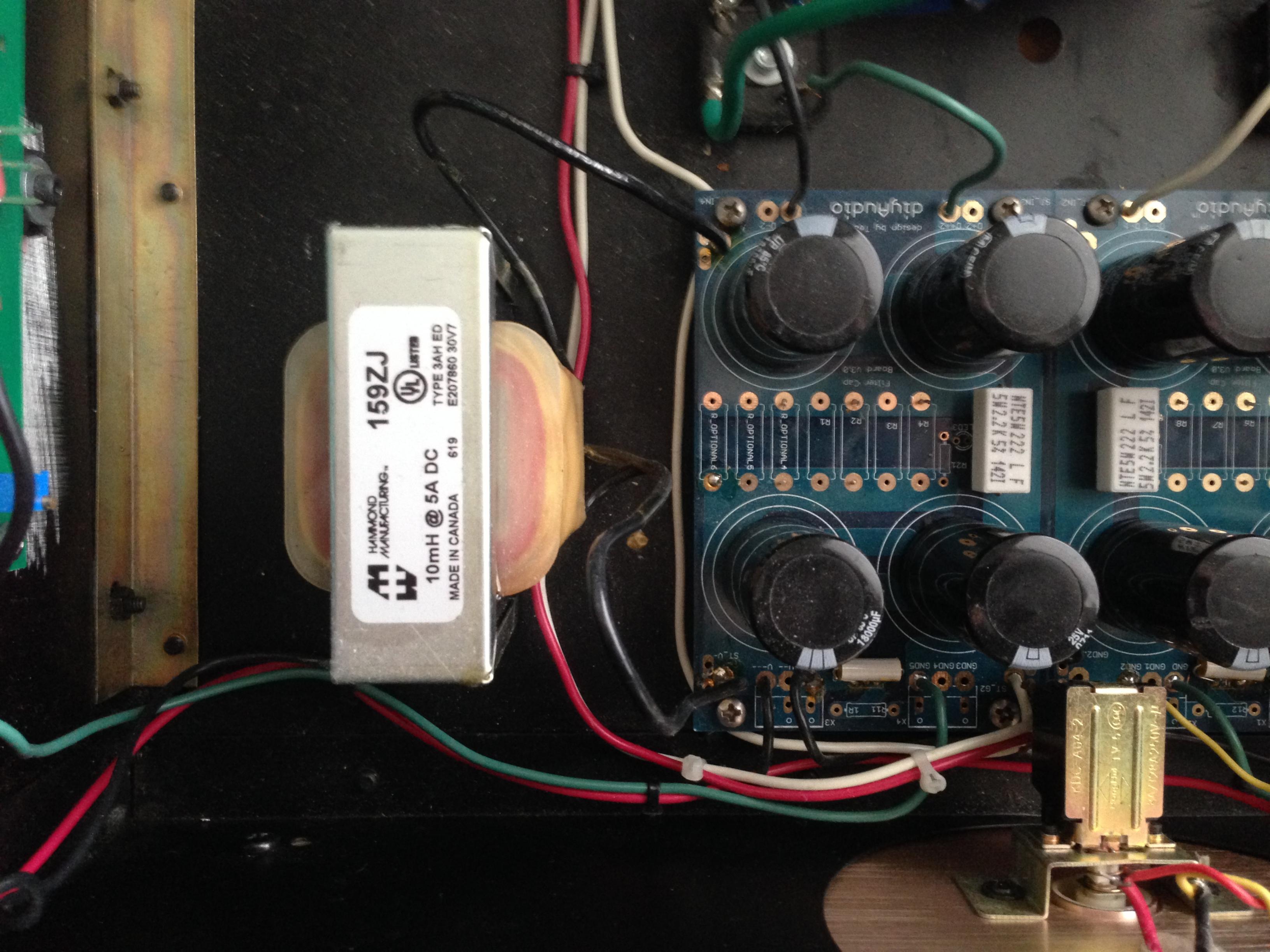

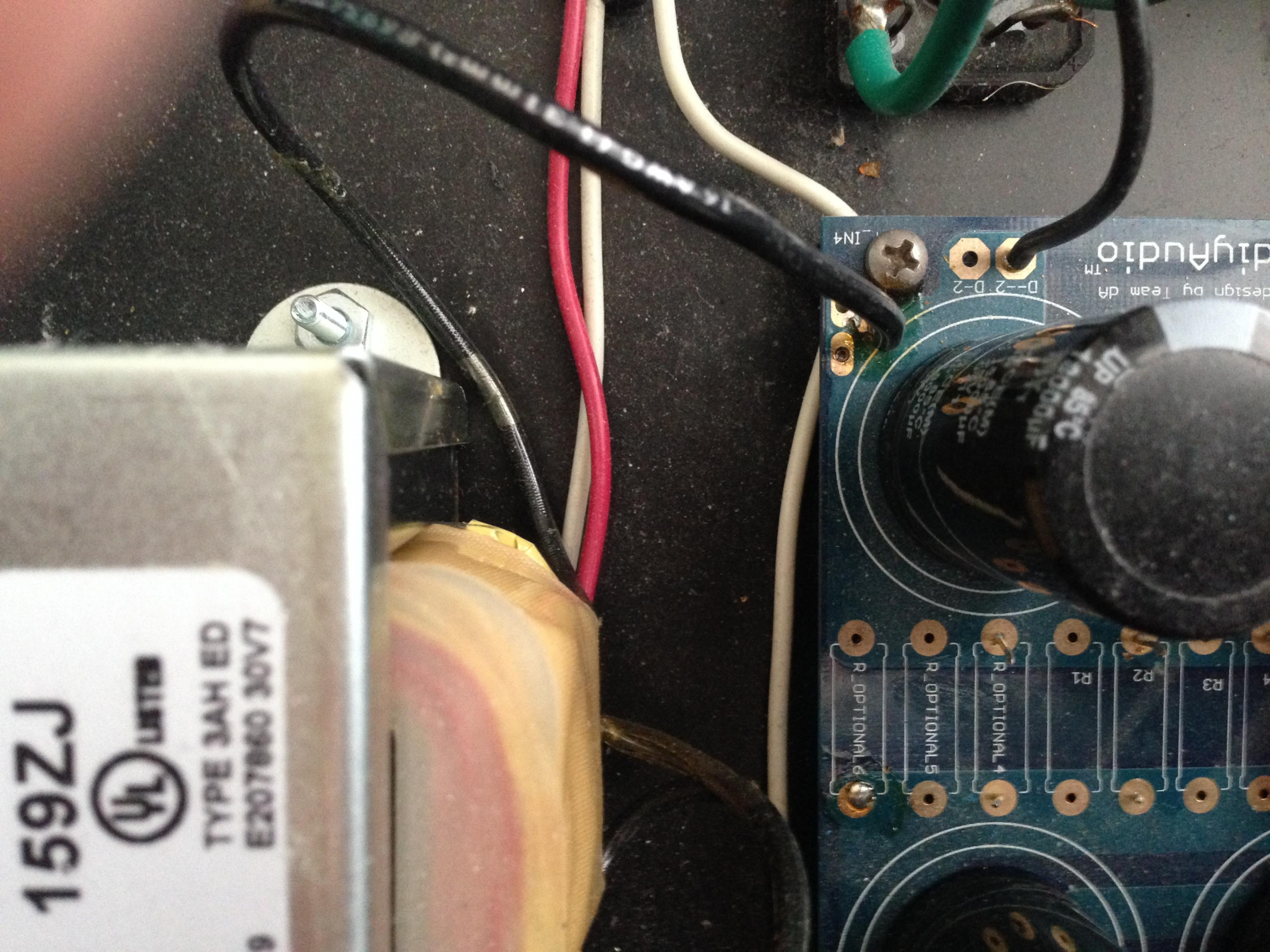

You picked the wrong spots to solder the choke, you Einstein. You picked the dirty/noisy part of the PCB. Do you have any idea how the currents flow on that power supply PCB?
The choke should be soldered where the resistors are soldered - this is where the DC current is clean (after the first C) - no ripple, compared to the spot that you chose which has all the ripple coming straight from the bridge rectifier diodes. Your choice takes the dirty current and feeds it, via the choke, straight to the second C; it's like you omitted the first C.
The other side of the choke is then fed to the entry side of the second C. In this case, you would have a proper CLC that will actually properly reduce the ripple and HF noise, so that you end up with the lowest possible noise figure.
I did not really check what you did with the other side of the choke... my bet is that you also fed the other side of the choke to the wrong side of the second C.
So, the first suggestion by oreo382 did not make any sense to me...his rude comment stunned me... because I could not even imagine that anyone would do what he is suggesting, and what you had actually done.
However, you were both so eager to make a derogative comment when in fact, you have no idea how the chokes should be properly implemented, and how the current feeds to the chokes should be maximised by:

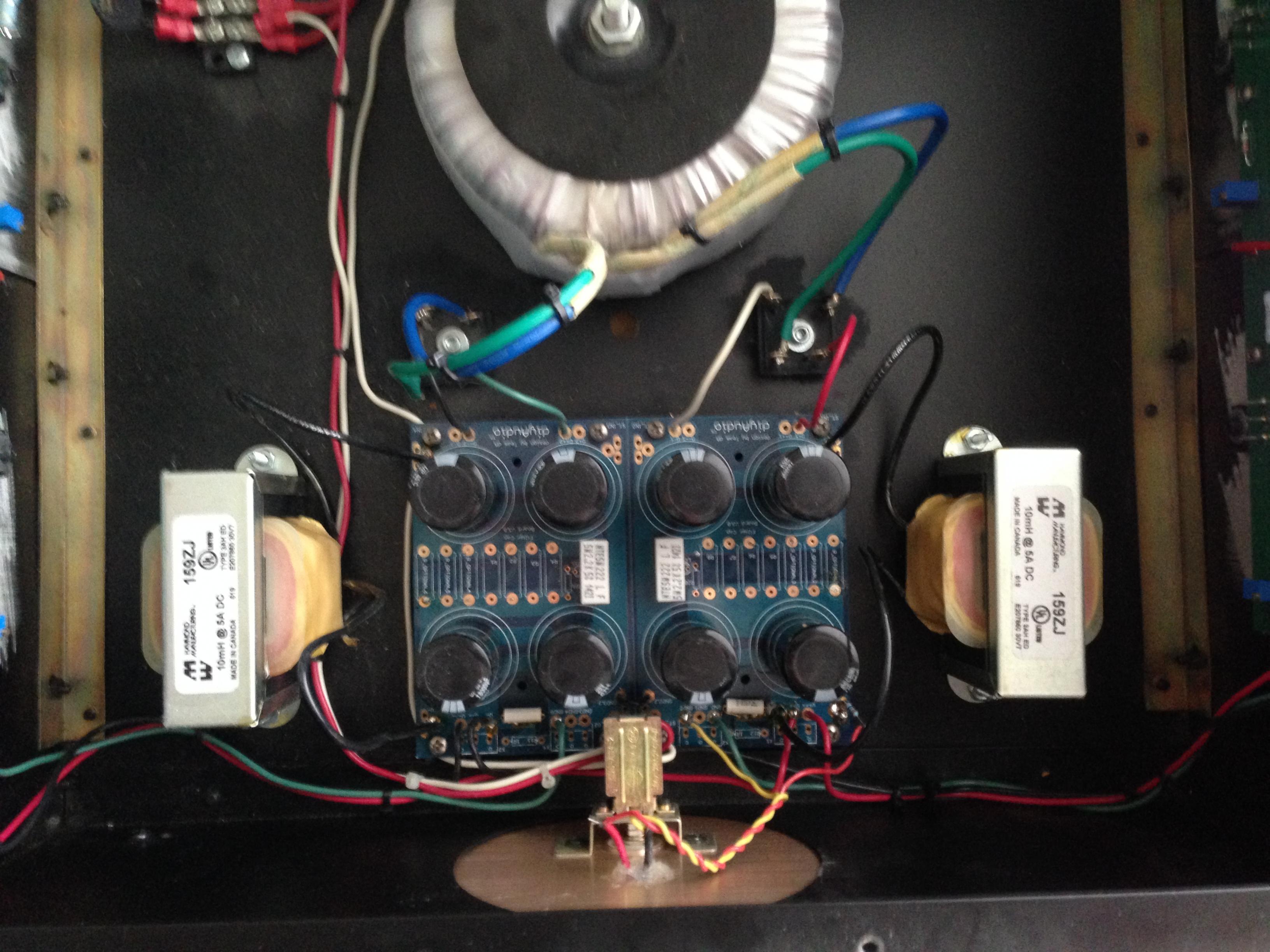

Here are pics of MY build,the one you don't think I own.I can attest my ripple is around 3mv measured with a TRMS Fluke multimter.As far as "dirtiest" place to solder the leads you should try it before making unsubstantiated claims.I can attest there is absolutely NO noise on my build,the "background" is about as black as you can get.By the way,nowhere did I say solder the leads into small resistor holes,I said unused holes as you can see in MY build.

I see you have some space left to install a choke that will really take it to another level.
Just a few weeks ago my friend changed the 200mH 2,5 A 1ohm chokes in the CLC power supply in the Hiraga i build for him 28 years ago. Now he uses Lundahl LL2771 700mH 2A 2,8!!! ohm. These chokes probably wont fit but you can try LL2733.

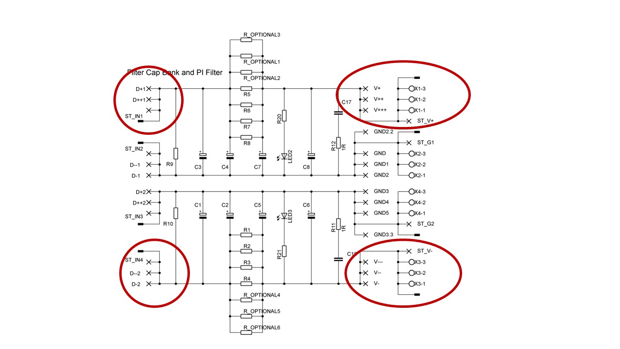

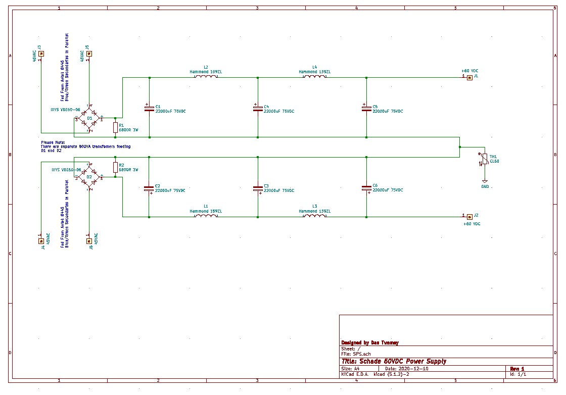

Extreme_Boky - You seem to be in a teaching mood. Could you explain how the points I've circled on the schematic are electrically any different than soldering to the resistor eyelets and to how Oreo382 seems to have implemented theirs? I was planning to do it the same way.

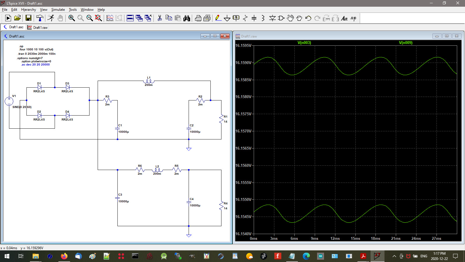

Here is an analysis I made with LTSpice. I used a simple model, but I think that it represents the two scenarios discussed. There is little difference between the two results.
I just wanted to look at the two cases from an analytical viewpoint. Please feel free to comment on the validity of the modelling. I am not an EE and I am always trying to learn more.

Compering the schematic diagram, and the PCB layout are two completely different things.
The way you are planning to use the chokes is simply wrong, especially when the PCB is exposed to large constant currents of some 4A give or take an amp. The dirty current will bypass the capacitors (both!), and will flow from the rectifier diodes, through the choke, straight to the AMP PCB's. The micro resistance people are talking here has to be taken within the context of LARGE CURRENTS. These currents will choose the easiest path to go from the rectifier diodes to the short - which is output MOSFETs biased in class A, in this case. The C filtering will do some work, but not really much at all. The capacitors need to see the full 4A current run through their windings, to be able to reduce ripple.
So, the current should run through the first C first, where the ripple will be reduced. THEN, through the choke that will further reduce the mains ripple and HF garbage, AND THEN through the second capacitor, that will filter-out the remainder of the ripple. The power supply PCB has catered for this in its design. This is why the chokes should be connected where the resistors used to be.

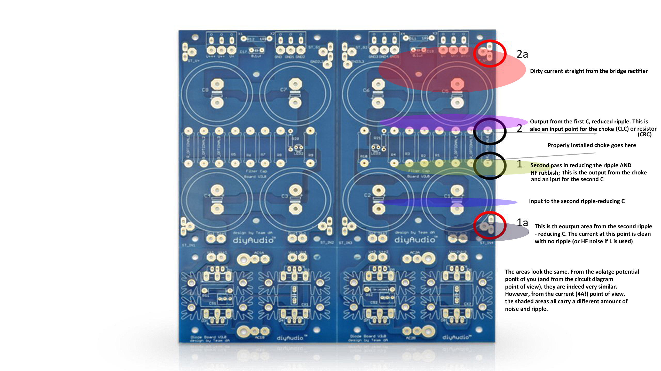

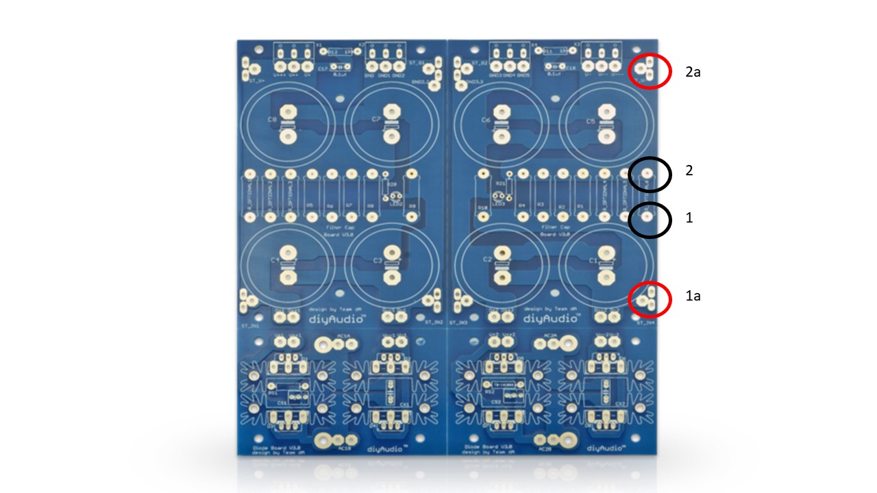

I could not find a great pic, but just in case there is a misinterpretation of what I was getting on about, I made one. This is what I'm talking about. Comparing 1 and 2 to 1a and 2a. Where did I go wrong?! It's got to be something so obvious that I'll hang my head, but now I'm brain fried (clearly).
The capacitors have to be given a chance to conduct a full amount of current (around 4A) AND filter out (short) the ripple to the ground (common)
The incorrectly connected choke will prevent the above from happeneing.
Have a look...
