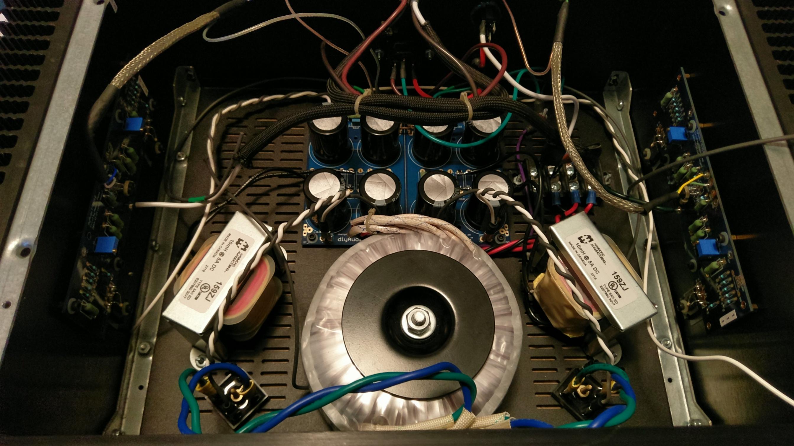

Fitted the 159ZJ into my F4 and so far so good. voltage measurements with .1ohm resistance was +22.7v / -22.7, and with the chokes it is +23.2v / -23.1v which is just fine.
I could convince myself the low frequency response sounds better defined and less muddy, i.e. when listening to the riff of a bass player in a song. But then again, there is that "confirmation bias" phrase nagging at me.
They fit, they work, and there is no noise issues so i am calling it a success.
I just put the same chokes in my clone F7 and I agree with the comment about the bass.More authority for sure.

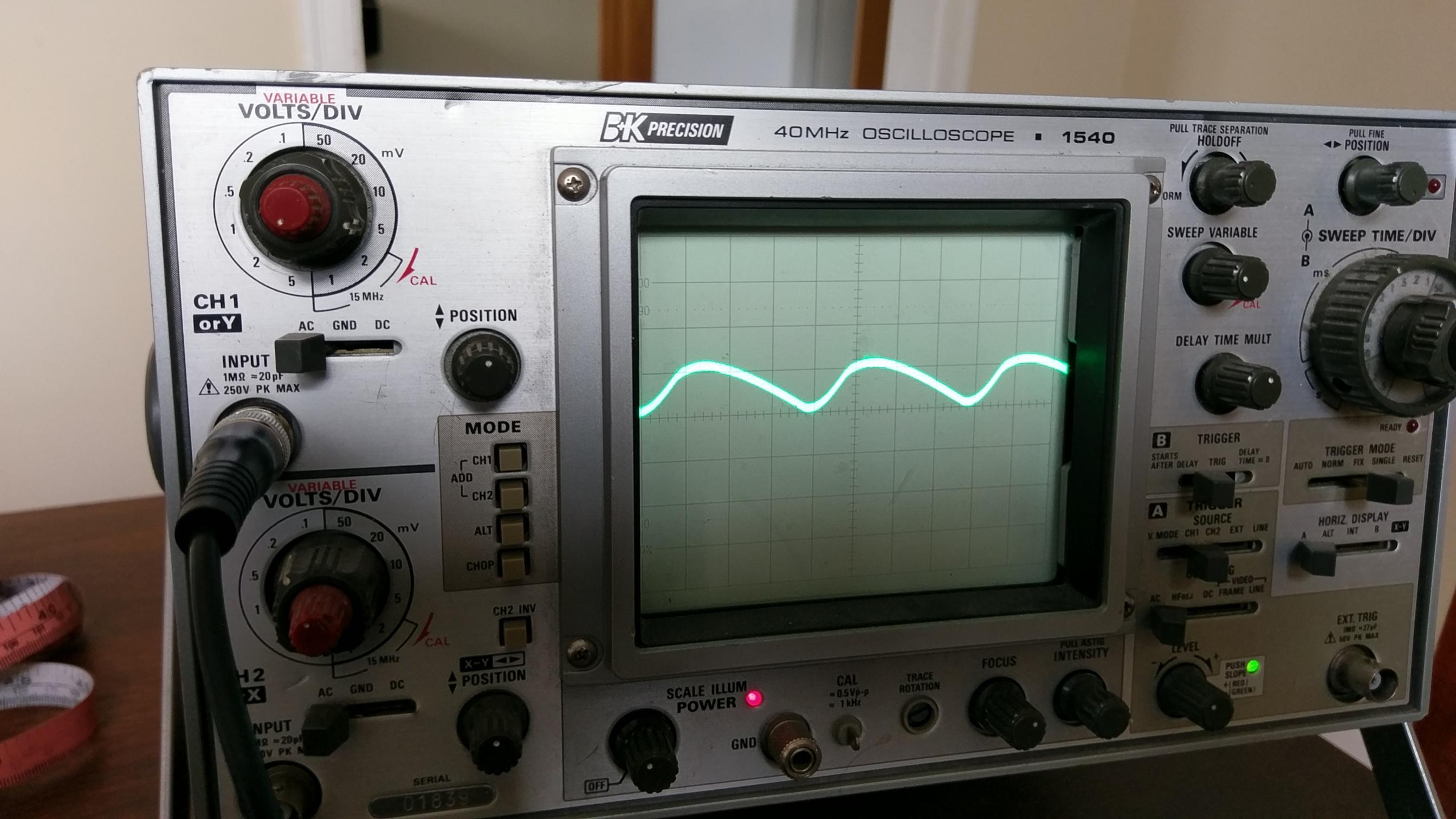

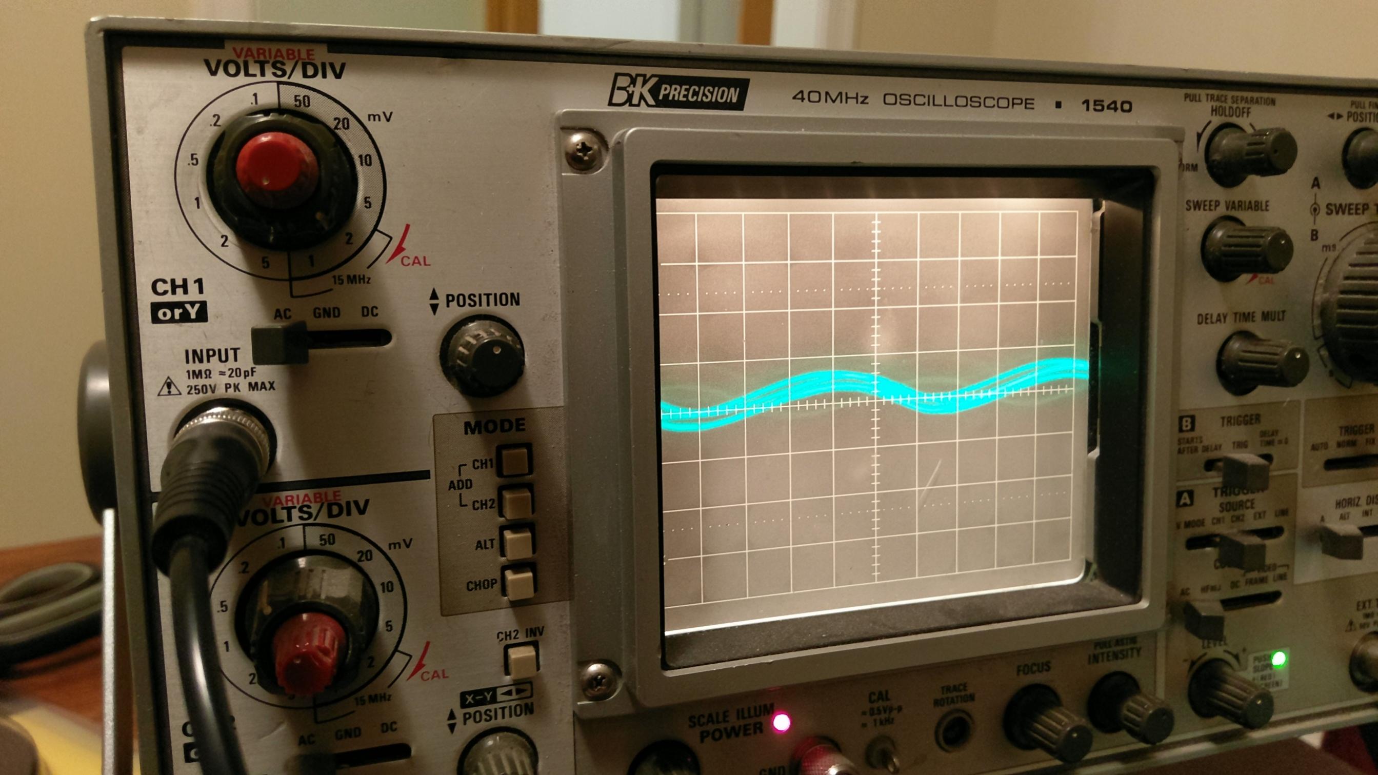

159ZJ upgrade done to my F5s a few months ago.
Previous CRC measured about 50mV of ripple and has the triangular peak as mentioned. After the upgrade ripple dropped down to 2mV or so and was tough to capture. The shape is more rounded with reduced HF noise component.
Can confirm after 3 months of use there is a definite change in sound. I did this upgrade to a pair of F5 that I use in an active setup for mids and tweeters. Detail, extension, smoothness have all increased. I am more frequently getting surprised by a soundstage that is well beyond the sides of my speakers with great depth. 98dB midrange which I could noticeably hear several dB decrease in hash, 120hZ hum and noise when ear within an inch of the cone. Now have the blackest of backgrounds, the noise floor of my room is higher and acoustic cues on the record pop out with much greater ease.
For the cost and time this is a very worthwhile and all my future Pass builds will have choke filtering.

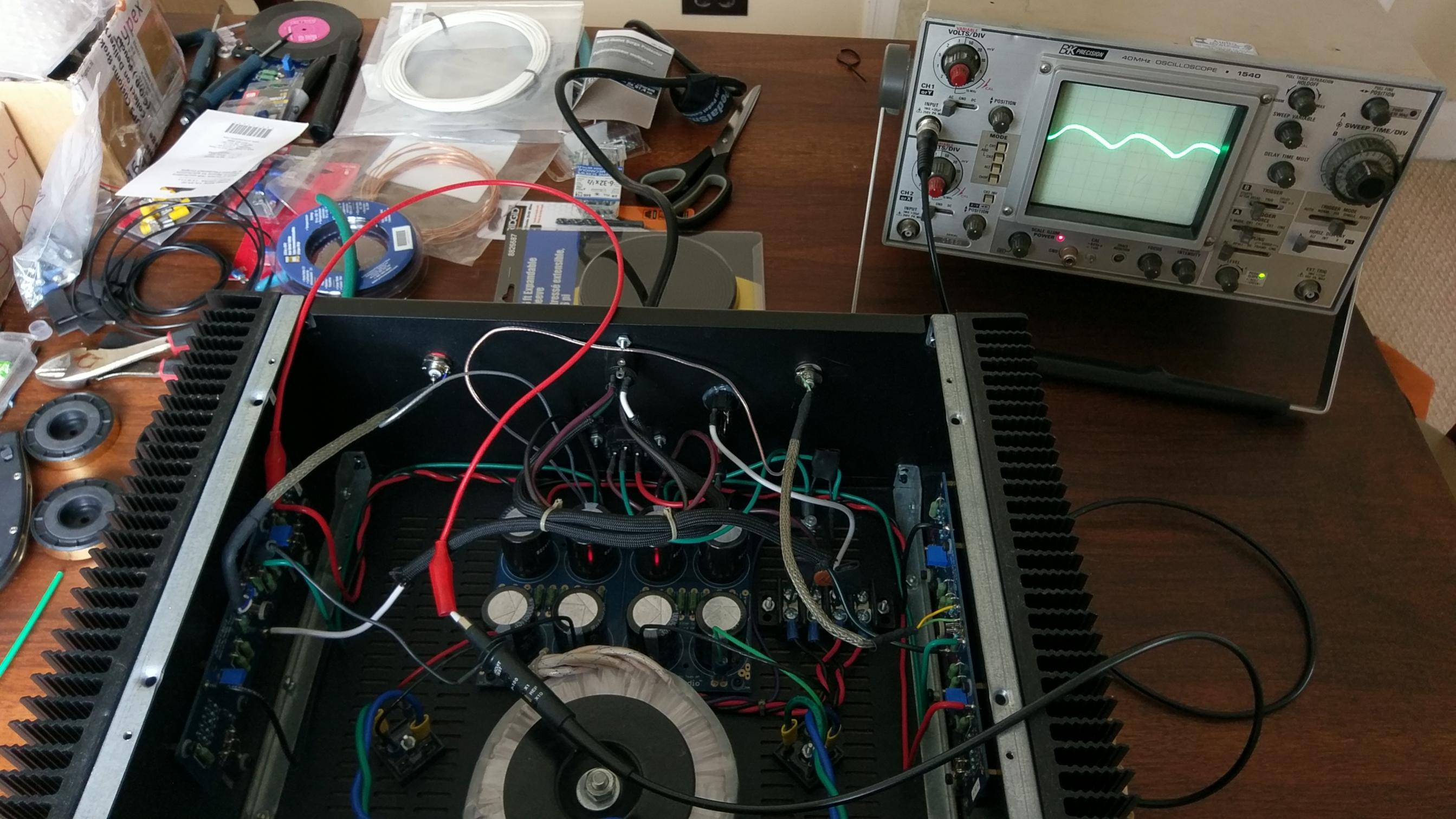

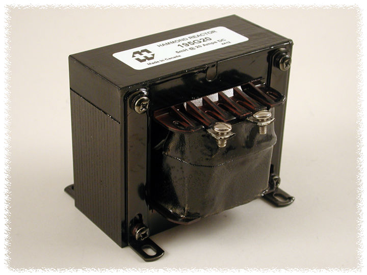

Got a bit crazy and decided to try the Hammond 195G10 (5mH @ 10A) which, due to size, means moving to a 400mm length case. I'm a bit worried that EM radiation from the chokes may interfere with the Jensen transformers on the amp boards though, so I've also got iron covers for them in the hopes of mitigating that.
Is measuring the ripple with a scope just a matter of connecting the probe to either the positive or negative rail and the ground probe to the 0V?

Yes, measuring the ripple is as simple as that. When I tried to measure ripple after the chokes were in I had a hard time getting the scope to trigger on the wave. Also had to go to my lowest setting on V/div.

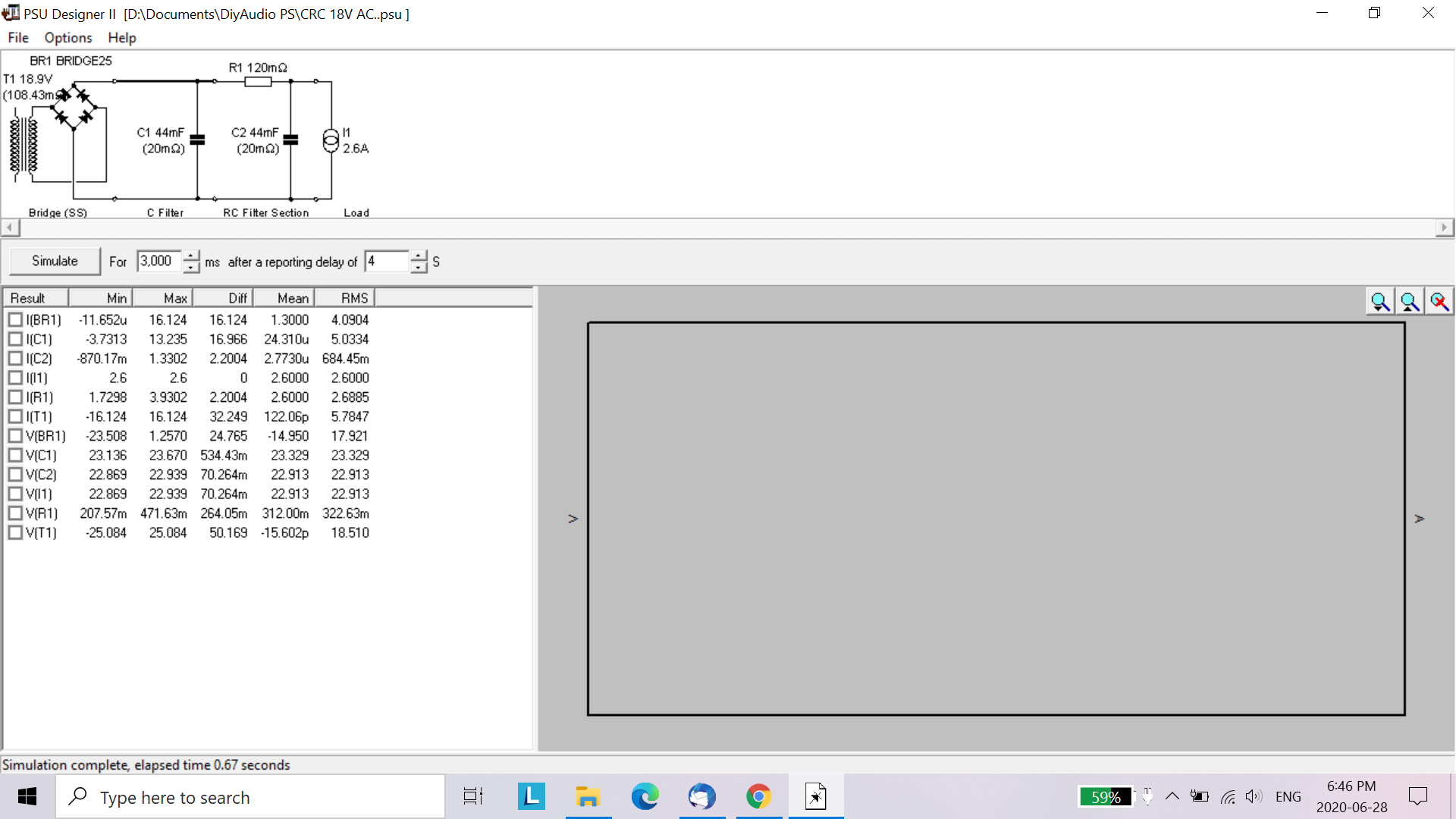

In my push-pull amps I build with CRC supply, with 44mF - 0.12R - 44mF. With my single ended amps I build with CLC supply, with 44mF - Hammond 159ZJ - 44mf.
The Hammond 159ZJ is 15mH 0.16R.
PSU Designer simulations show for CRC the ripple is around 70mV and for CLC the ripple was about 2mV. Results may vary depending on the capacitor ESR and current demand.
The CRC 70mV was for 2.6A. For 1.8A, the ripple was 50mA . For CLC, the ripple was also reduced, to around 1.3mV.
Of course these are simulation results but the real life results will be in the same range.

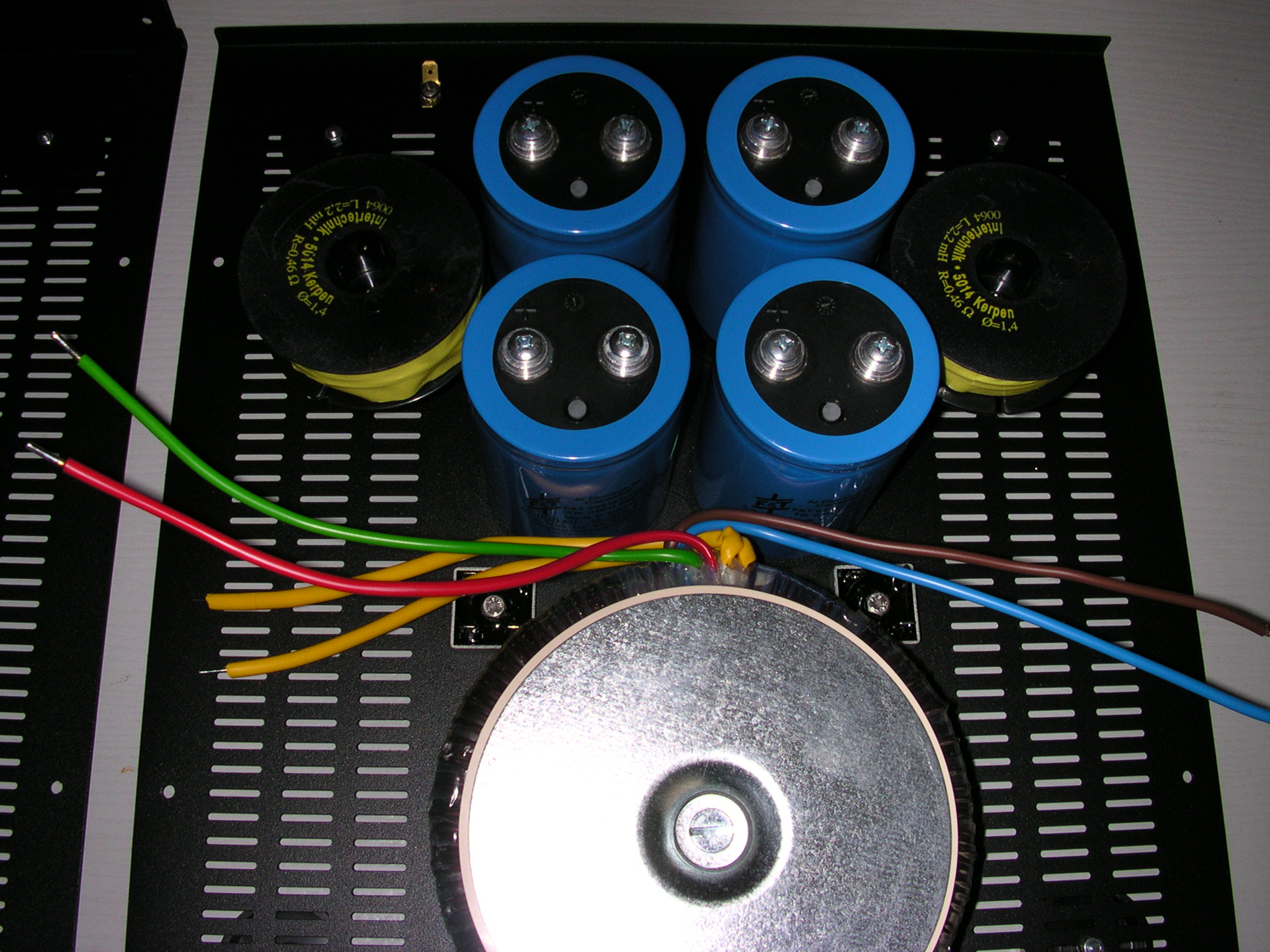

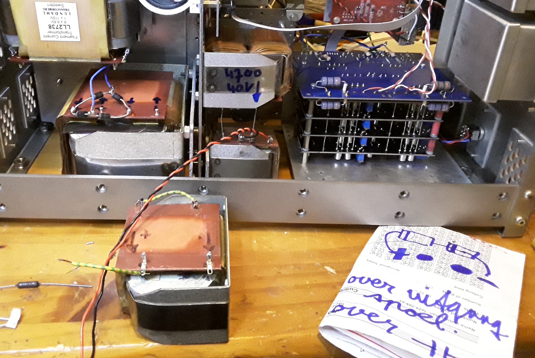

Hello,
As you can see the proof of the pudding is in the eating.
Use of Lundahl chokes with a load around 1A ( a DDDAC with shunt supplies integrated on the boards) Chokes close to the actual circuit ( the biggest choke used as a choke input) and the DDDAC output transformers on the right side of boards.
Good luck with the 2 mH chokes.
Greetings, Eduard
