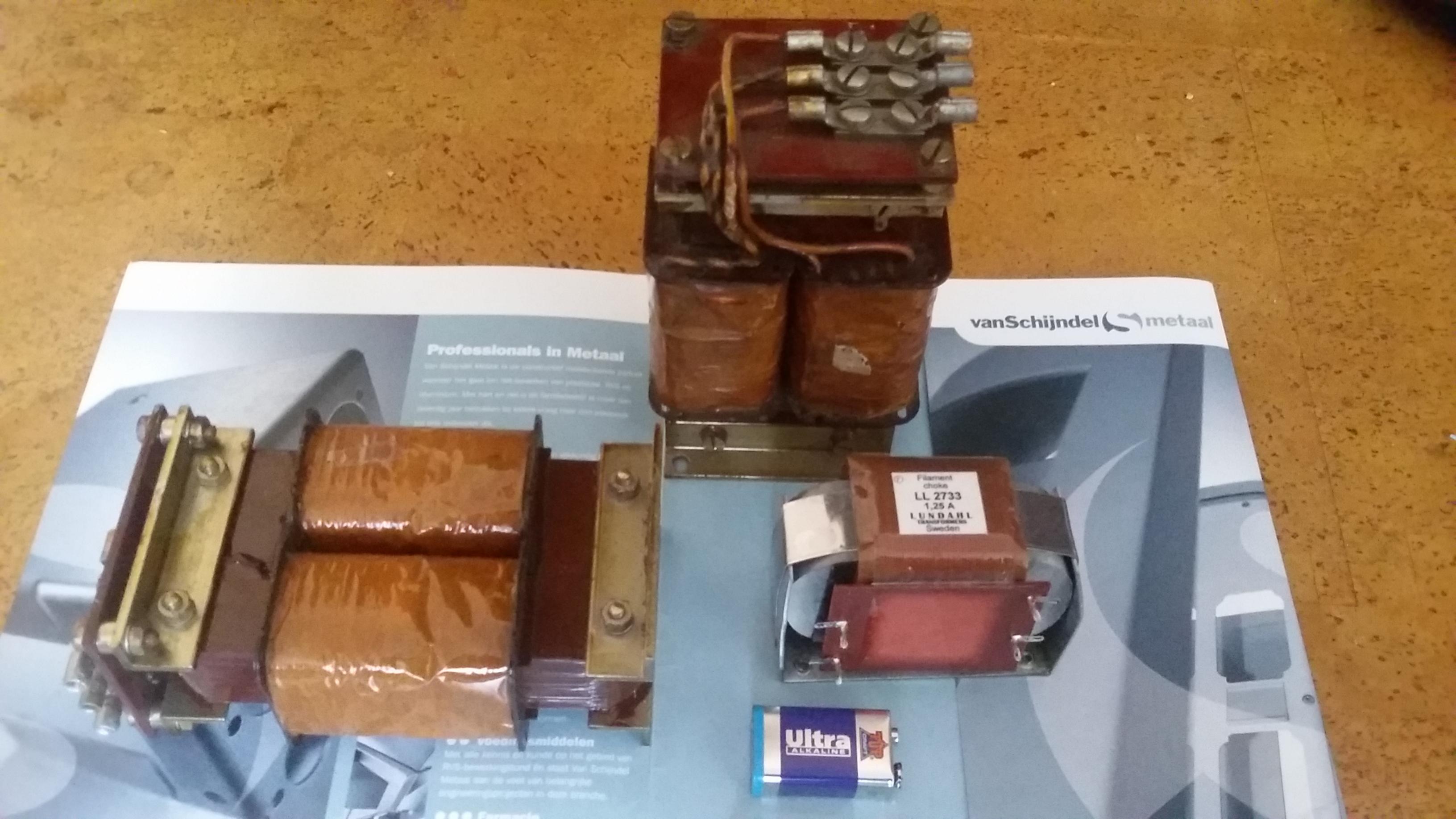

Just some chokes that could be used in higher current applications. The lundahl is 1,25 A rated model is available with less mH and higher current. In the Pass amps the voltage across the choke is not big so current can be higher . See the attachment I did post before.
The two big Telefunken chokes have more mH than the lundahl. Higher current capability. They were cheap, about 30$ but I think there is no stock left.
Greetings, Eduard

Hello,
Did ask a friend in Italy if he already did use or test the big Telefunken choke i send him a few months ago.
Also did ask the shop where i did buy them about his actual stock.
If the man in Italy they are better than the Lundahl ( he has both models shown in my picture) i will of course buy some more for future projects.
Greetings, Edward

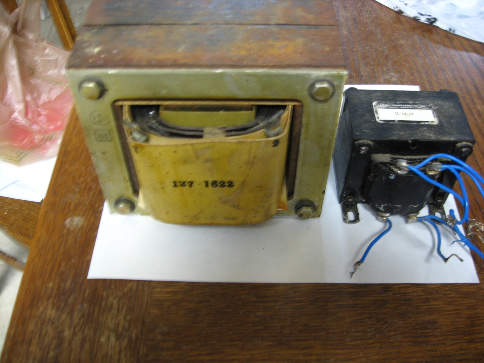

These are a couple of 4.8 mh chokes I have. The small black one has 2 independent 2.4 mh 12A windings so can be used as a 12 A 4.8 mh or as a 24 A 1.2 mh inductor. Now I can't find any data on that slightly larger 4.8 A choke but at 31lbs I hope I never drop it on my toe !

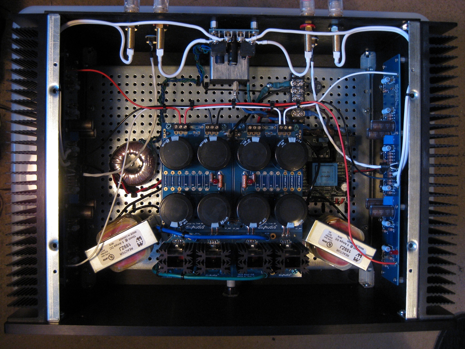

Fitted the 159ZJ into my F4 and so far so good. voltage measurements with .1ohm resistance was +22.7v / -22.7, and with the chokes it is +23.2v / -23.1v which is just fine.
I could convince myself the low frequency response sounds better defined and less muddy, i.e. when listening to the riff of a bass player in a song. But then again, there is that "confirmation bias" phrase nagging at me.
They fit, they work, and there is no noise issues so i am calling it a success.

Since the F4 has no gain maybe it's less critical? Not sure what people around here think of the PSRR of the F5 but I've seen comments that it is not so good. F4 may react differently. Also, maybe it's just me, but I noticed more of a change in the high end...cymbal decays, etc vs. bass.
