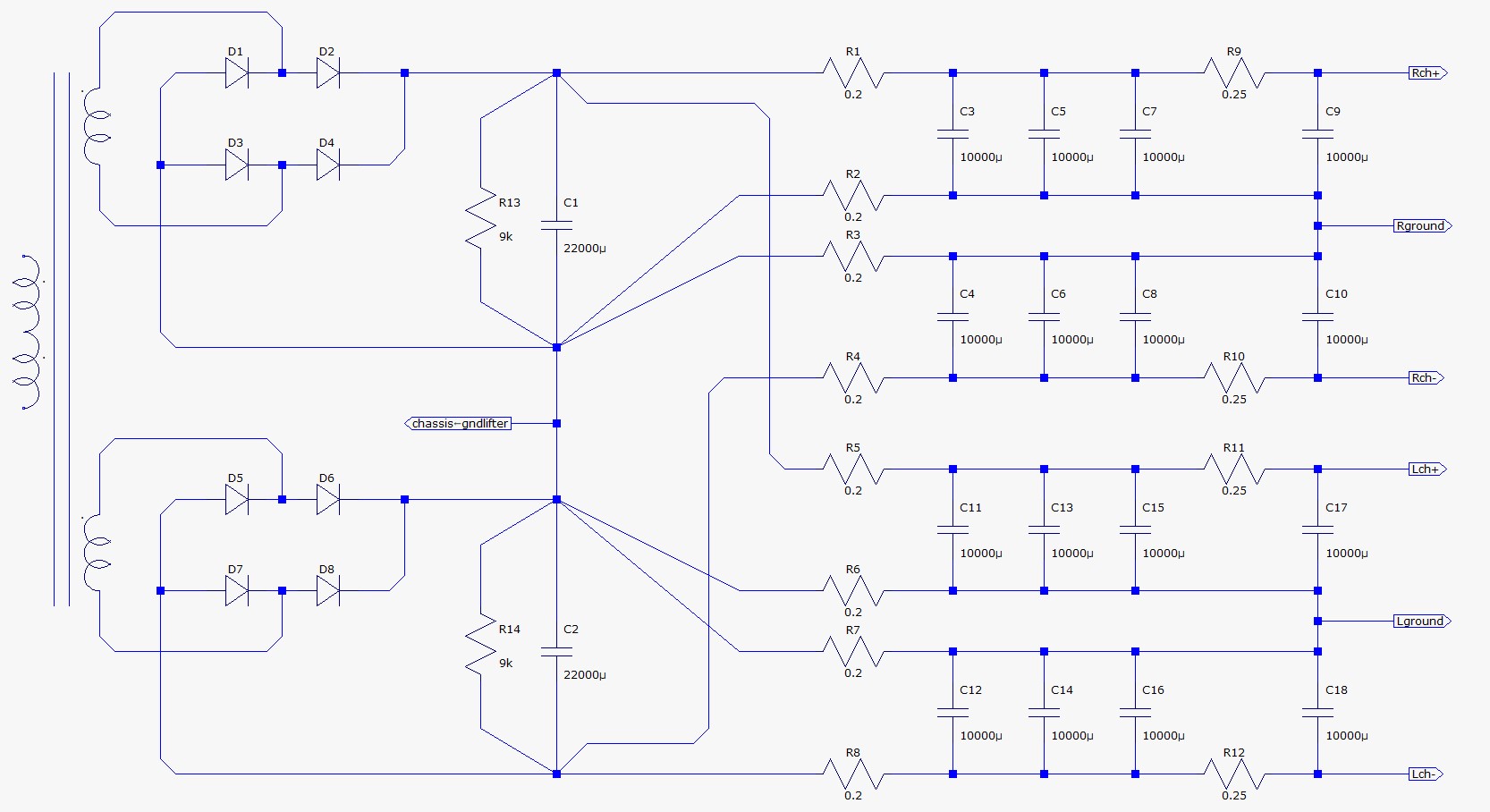

I've built some amps in the past, but I'm about to build my first class A amp.
I'm aiming for a +/- 24 volt., 1 to 1.3 Amp as I think that will be enough heat for spanish temperatures.
I'm putting together a PSU for this that I would like to share and hopefully have some feedback on.
Don't know weather to start a new post, but I'll post it here for the sake of the chokes.
The PSU is looking like this:
Some people seem to think that common trafo will give a more coherent sound stage.
R2/3/6/7 is there to separate a bit, the Rground and Lground from each other and the first capacitors.
I did ask Bob Cordell about these. His answer is here.
I guess that with eduard's suggestion here on Lundahl's dual core chokes, that the two coils in one choke would take position of R1 and R2.
My thoughts are to replace R1/4/5/8 with chokes.

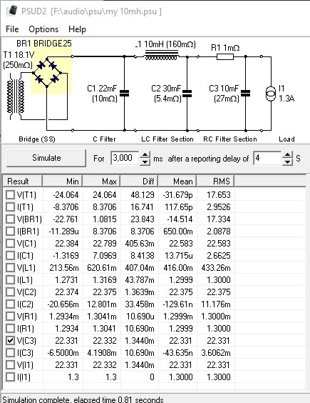

I have done some simulation in PSUD2.
This is not all correct as C1 would have 2.6A load

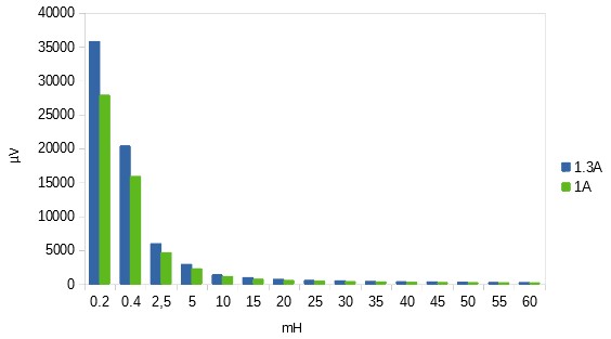

I have made some graphs to show the simulated influence of the chokes
The first 2 are 0.2Ω (which is fairly common) and 0.4Ω which is the R1 R2 configuration above.

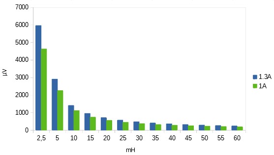

Then starts the 2.5mH up to 60mH.
If we take away the 2 resitor poles we get this.
For this particular circuit / values it seems like 20-30mH is more or less the point of diminishing returns.
So, if we put 30mH chokes in these positions, will there be any influence on bass transients.
My guess is that with class A currents and 40.000µF after the choke, this is a non issue, espessially with high efficient 8Ω speakers.

See my post #54. I have built single ended Class A amplifiers with that power supply and they are quiet with 103dB speakers. I believe the ripple is around 2mV or so according to simulation.
Your simiuation with a higher inductance and higher DCR choke resulted in 0.5mV ripple. Is that level of ripple necessary really necessary? The higher DCR is a disadvantage. If you worry about bass transients, low DCR is better than high DCR.
Low ESR is not a problem for regular CLC and CRC power supplies. Low ESR capacitors can handle ripple better in terms of better filtering and less temperature gain.
I believe one advantage of dual mono is that it is easier to control hum that may be there if the power supply is shared by two channels (cross channel noise).

Inspired by Ben's simplistic psu in post #54 (thank's again) and bemused by my own ability to overthink and complicate, I have done some more simulations in PDUD2.
I have found the following:
L1 = 15mH (250mΩ) R1 = 0.25Ω ripple = 0.487mV @1.3A load
L1 = 15mH (250mΩ) R1 = 0.001Ω ripple = 0.892mV @1.3A load
L1 = 10mH (160mΩ) R1 = 0.001Ω ripple = 1.344mV @1.3A load
L1 = 10mH (160mΩ) R1 = 0.001Ω ripple = 2.597mV @2.6A load
Looking at this and wanting to reduce the supplys DCR for better dynamic loading, I now think the Hammond 159ZJ @ 10mH (160mΩ) is a better choice.

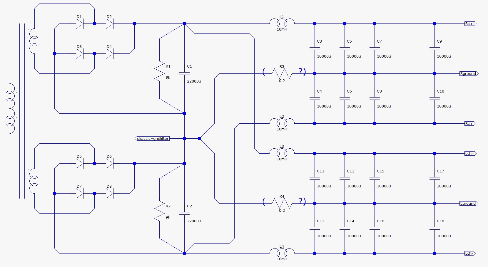

I have simplified my PSU to This:
I have removed the resistors before the last capacitor.
C9,C10 and C19,C18 is ment to be very near the amplifier boards.
R3 and R4 was ment to make a little distance between right and left earth, but they will most likely go as well.
I have in the past built with mono supplies, but this time I thoght I would try the single one and see if I can beat the hum deamon🙂

Ben; yes I am trying to isolate left and right supply and hopefully end up with a clean Lground (star) and a clean Rground (star) away from the noisy ground point between C1 and C2.
The diagram above show how I would do the actual wiring of the supply.
Please do enlighten me if this may not be such a good idea.
All the best.
I don't see a problem with with isolating the two channels of power. I think it is worth the extra parts and real estate required. The only thing that I question and you did too is whether the 0.2R is needed in the grounds of the two channels.
I would do two ground lifts though, at the left and right channel outputs.

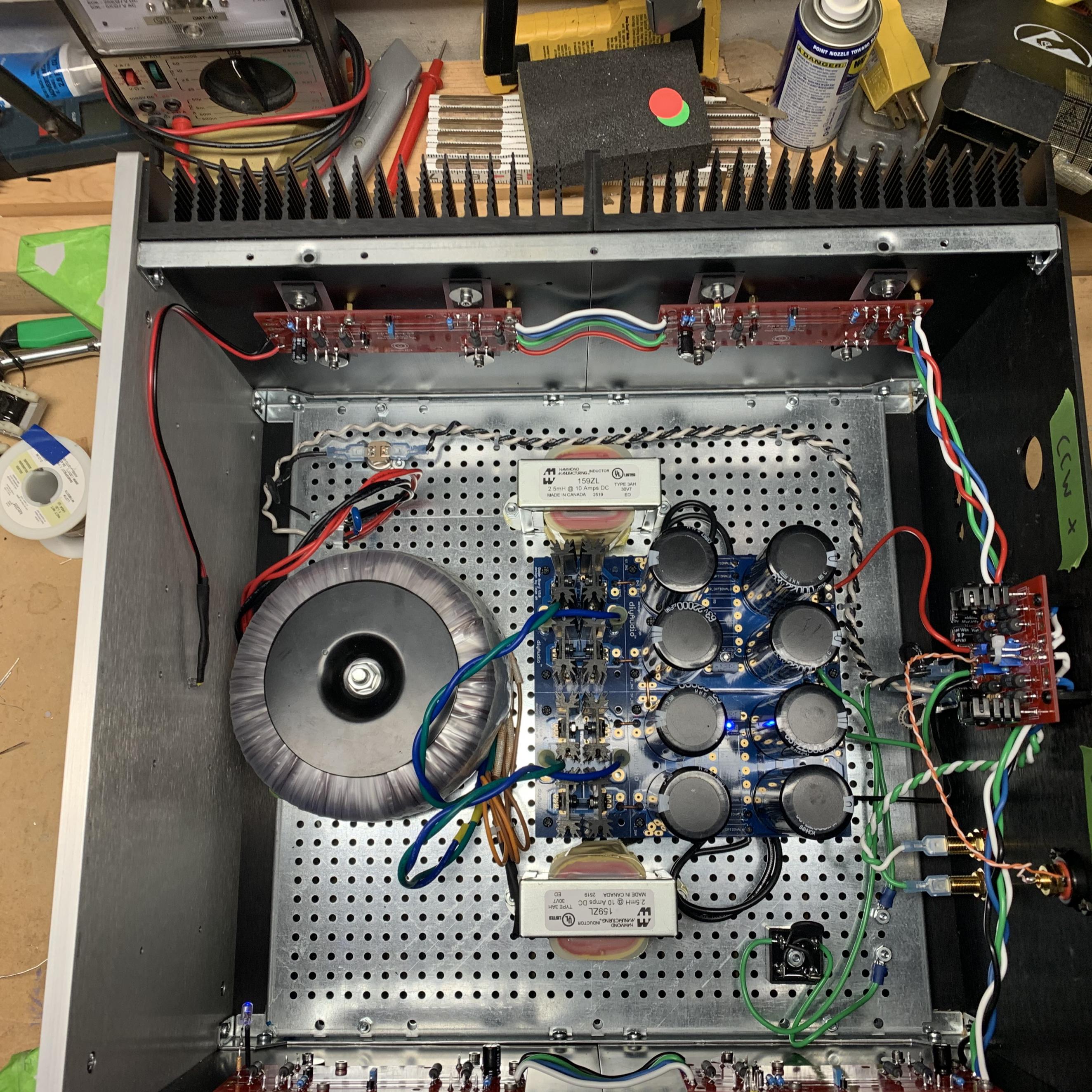

I'm getting close to utilizing my 10 yr-old pair of 159zl along with the diyaudio store power supply board, and I'm hung up on how to (excuse me for using the overly technical terms here) attach the big fat wires of the chokes to the little PC board holes. Does anyone have a good solid connection scheme to share? TIA - Pat

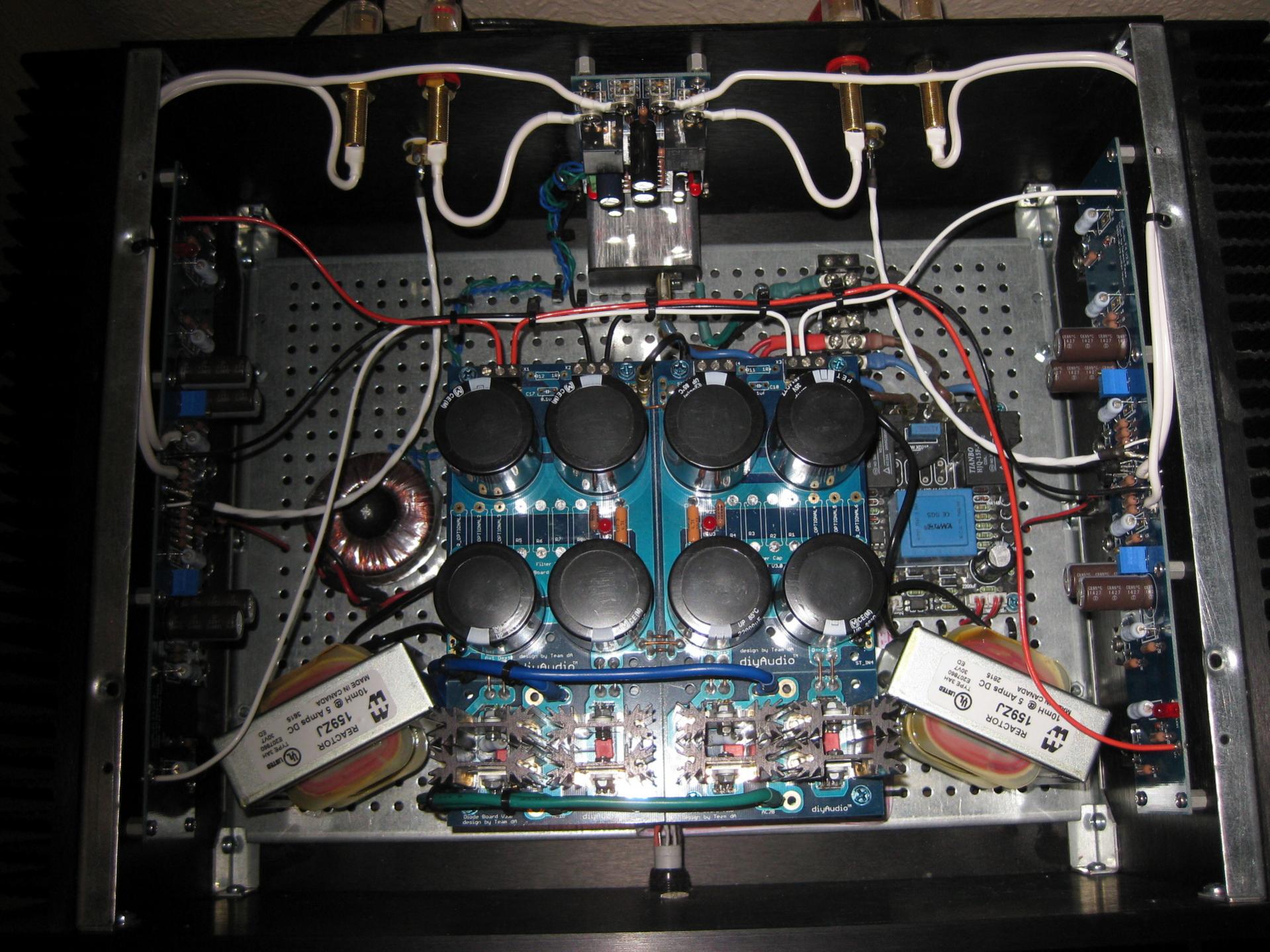

I did this with a pair of F5 V3 Turbo's last year. You can't see the details in the picture because I did the connection under the board.
What I did was drill the holes out a little where you would put resistors, bent bare romex into a U, and put the bent romex into the holes. I drilled the holes so the romex would be a very tight fit, so there would be copper left, and I recall making sure both sides of the board had a good solder connection. The end result was a set of "loops" that I could attach the fat choke wires to. I connected under the board for a clean look up top.

Thanks, that's kind of what I was trying, but with single cut off and bent resistor leads instead of Romex, and thus "hooks" rather than loops. You can understand my concerns about the robustness of the connection.
I've been looking at other possibilities, and there is this:
1780507 Phoenix Contact | Mouser
I'd use four of them, one before and one after the resistor span, for plus and minus supply sides. The 7.5mm pitch would give me two solder joints on each of the terminals to make a solid anchor point, and the terminals would accommodate the Hammond leads.
I've got time to think about it, and I'm really in no hurry to totally dismantle my working M2X to get it done. The assembly of the chassis was a bit ... fiddly, as I recall.
Just ordered 159ZL's.
I think the resistor eyelets are pretty sufficient in connecting both sides of the power supply PCB. I will "reinforce" this with short pieces of solid core copper wire (28 pieces required), that I will feed through each eyelet, and then solder at either PCB side. This will create a very high current-capable path between the first capacitor bank, the choke, and the second capacitor bank. The choke wire ends can then be laid flat on the bottom copper fills (I am planning o lay at least 15mm-long length), and then use good solder and my capable 80W soldering iron to finish the job.
I do have a slight worry, though... with the approach I outlined above, the series resistance that may be required to dampen the choke, will be virtually 0 ohms, and this could cause ringing. Maybe leave the full length of choke fly leads, i.e. not shorten the fly leads and use them (I think there should be at least 20cm of length there available) as a bit of series resistance? I want to avoid inserting the resistors here at all costs, if possible...
Look at the schematic of the ps board and use the largest non used holes,there should be 2 on each half that you can use.The choke wire is maybe 16 gauge?I used existing holes (can't remember which ones) and didn't have to solder in jumpers or other garbage,its not needed.

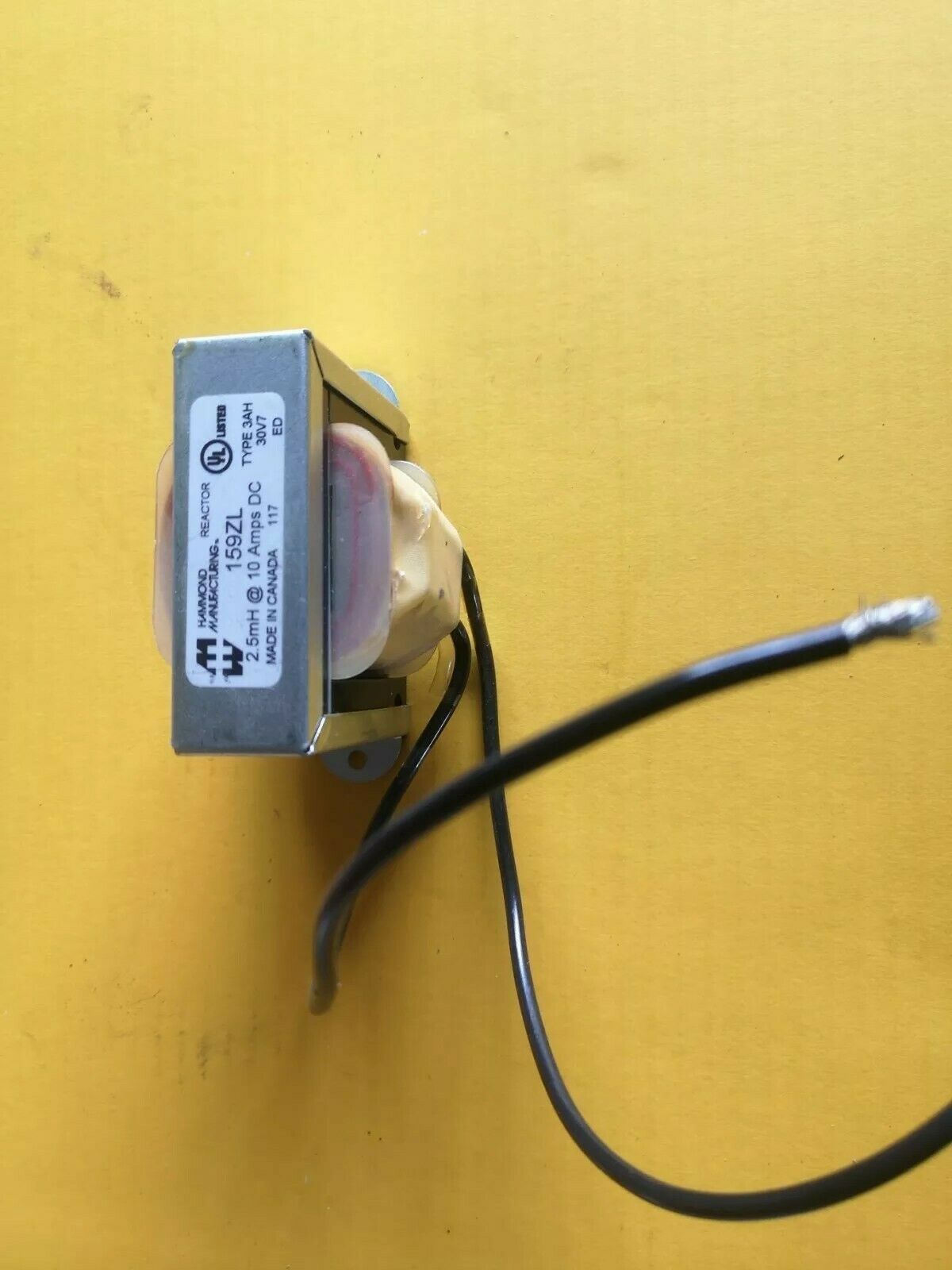

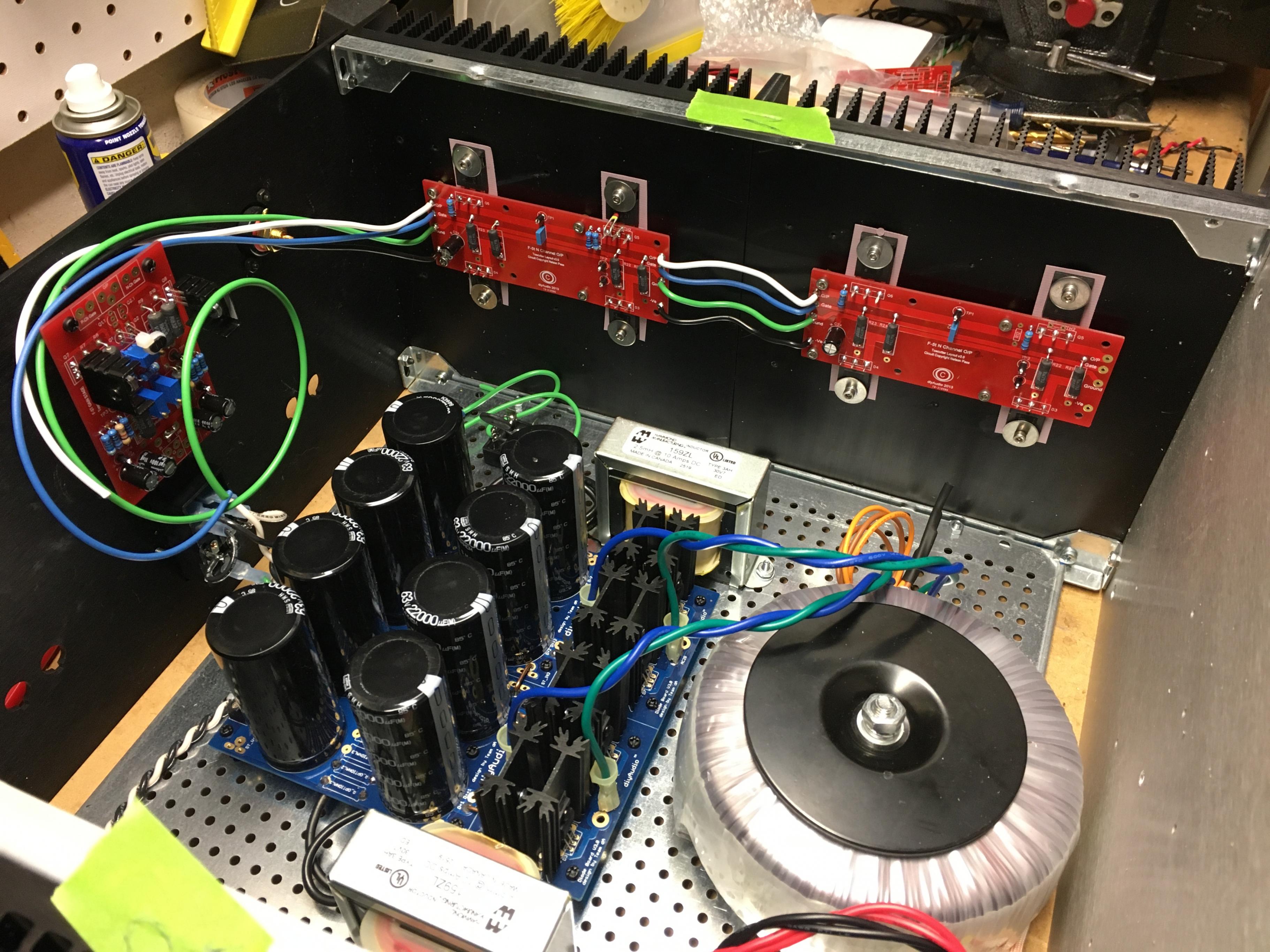

Well i put mine into the "largest non used holes" without have to drill or bodge my supply in any way.
FYI - If you don't understand what somebody is trying to explain to you, ask for clarification. #dontbeanasshole
