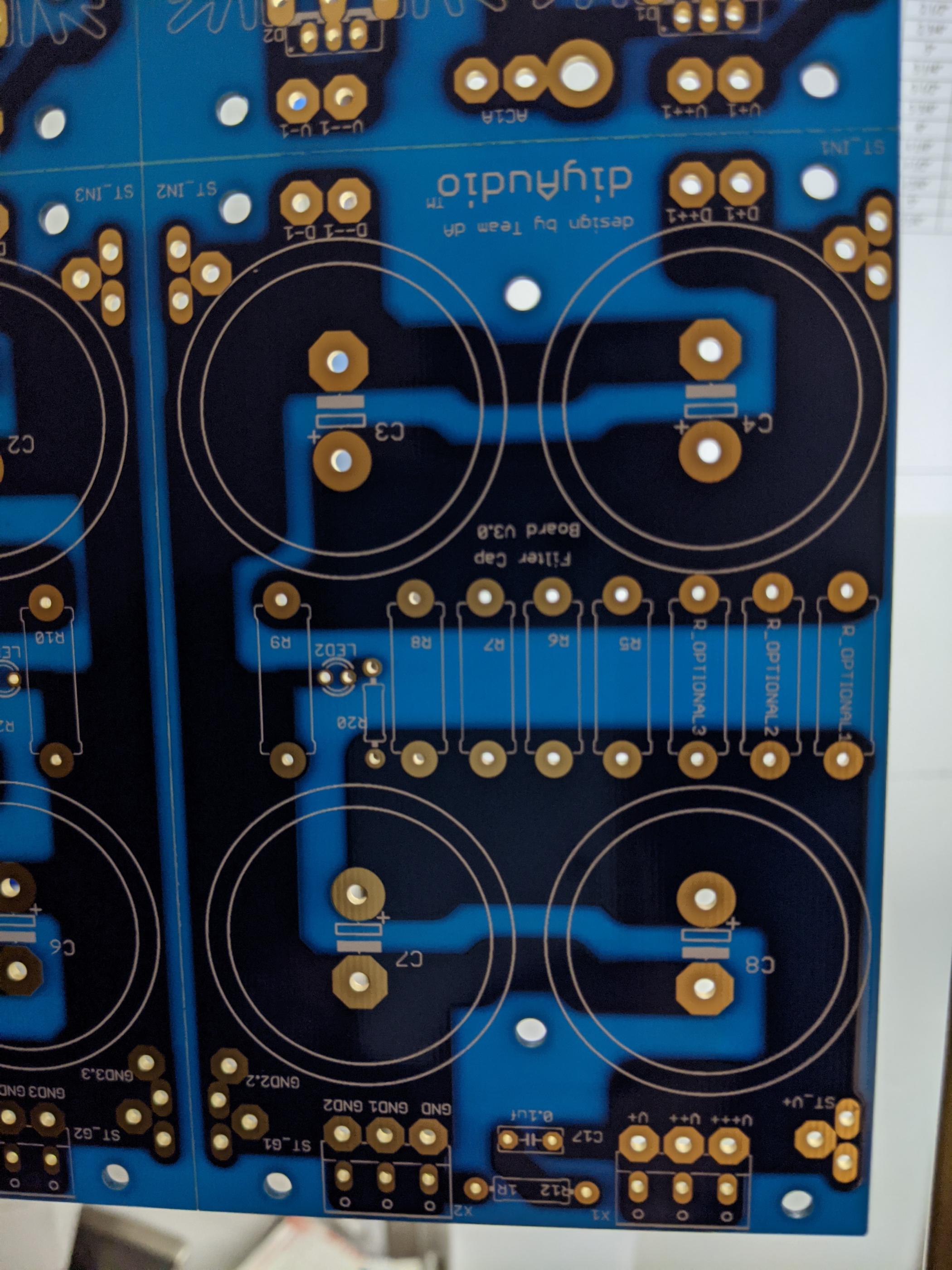

Well, by using hard-wiring, you are undeniable telling the current which path it should take. And, this is the best approach.
Your simulations can not capture what I explained in my last photo. A simulation is a great tool, but it does have its limitations. And it seems you found the first big one.
Compering the schematic diagram, and the PCB layout are two completely different things.
The way you are planning to use the chokes is simply wrong, especially when the PCB is exposed to large constant currents of some 4A give or take an amp. The dirty current will bypass the capacitors (both!), and will flow from the rectifier diodes, through the choke, straight to the AMP PCB's. The micro resistance people are talking here has to be taken within the context of LARGE CURRENTS. These currents will choose the easiest path to go from the rectifier diodes to the short - which is output MOSFETs biased in class A, in this case. The C filtering will do some work, but not really much at all. The capacitors need to see the full 4A current run through their windings, to be able to reduce ripple.
So, the current should run through the first C first, where the ripple will be reduced. THEN, through the choke that will further reduce the mains ripple and HF garbage, AND THEN through the second capacitor, that will filter-out the remainder of the ripple. The power supply PCB has catered for this in its design. This is why the chokes should be connected where the resistors used to be.
The above is basic stuff, anyone who laid out a good PCB design knows this. I started when I was in primary school many decades ago. Then I worked for a company that was making high-quality amplifiers 400W to 2000W (2kW) per side. I helped design them and worked in quality control and optimisation towards achieving better performance. This also included - improvements to the PCB layouts.

So in context of the CLC filter, location of the choke connection, and DC ripple, placing a the choke a few millimeters in front of the capacitor does not prevent the capacitor from charging and discharging. It is not the case that there is a continuous flow of DC current through the capacitor and it somehow filters the "dirty current". The capacitor just charges and discharges to fill in the dips.
Ben Mah: "It is not the case that there is a continuous flow of DC current through the capacitor and it somehow filters the "dirty current". The capacitor just charges and discharges to fill in the dips."
There is a continuous flow of DC current through the capacitors.
This is exactly why it is important to control the current flow by properly connecting the R (L), and by providing the little indents in the PCB tracks as I have done in the pdf. (Hence, it is better to use hard-wiring in this particular case, as I have already mentioned before).
The current will run through them (capacitors) in the exact same way as the current runs through the choke. The capacitors will decouple the rails by providing a short at ripple frequencies. The chokes will prevent ripple and HF noise by providing high inductance at those frequencies.
The capacitors will store the energy (voltage potential, with the ability to discharge that potential via their ESR). Once the DC potential is stored, the ripple will be decoupled to the common potential (ground). The cleaned-up voltage potential will allow the clean current to flow to the next section of ripple-removal (R or L).
And this can happen only if we force the current down the right path - through the capacitors.
This is exactly why we need to control and separate the dirty current flow, from the cleaned-up current flow.

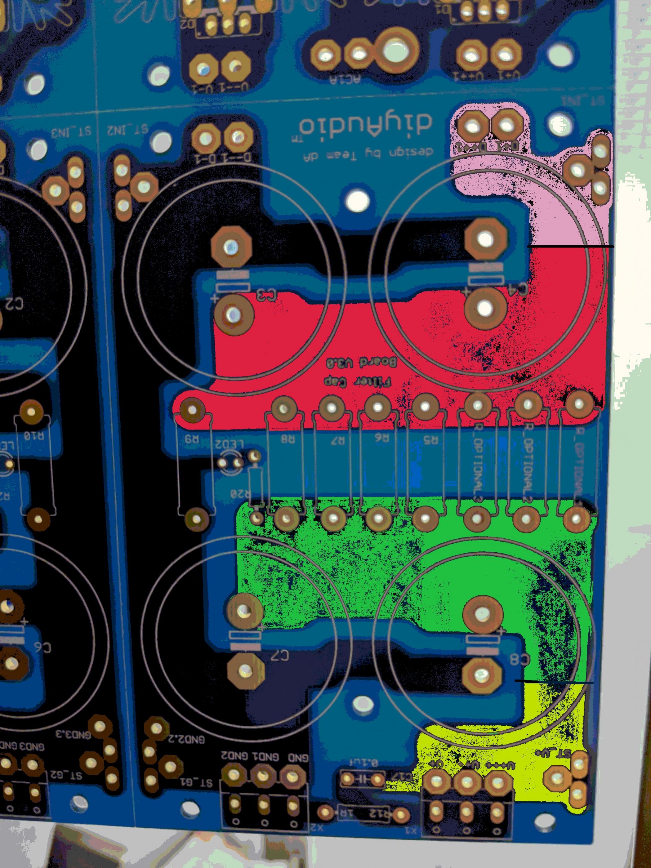

Even if I don't yet understand the "why", I want to make sure I understand Extreme_Boky's explanation. Others seem to be grasping it, I am not.
It seems like the statement is that within the same copper pad (is that the correct term?), that the flow of current can be different. We're somehow trying to force the current in a more "correct" and defined way through the choke by using a different set of pads on the same copper plane. I've done a quick job with a hacked color swap to demonstrate what I think is being stated. This is not my contention, it is what I am trying to absorb. So, if I've got it wrong, then I'll once again, just back away.
Instead of everything on the pad behaving "randomly, but the same", each area will behave in some "thoughtful" way from another area based on where they are in relation to other components physically and/or in the chain of the circuit and/or based on board layout. It's given that within a set period of time we have oscillations at different frequencies, otherwise there would be no ripple / noise. Ripple is just (for the sake of this discussion) lower frequency oscillations than "HF" noise. However, it seems that this noise is present at different areas and at varying levels within the same pad. Stated another way, the electrons don't randomly "move about the plane".
So, instead of the red area all having precisely the same characteristics when averaged over a finite period of time, what I think is being stated is that the (randomly chosen in terms of size) pink area behaves differently than the red area, and that the same holds true for the green and light green. Therefore, the choke should be placed correctly onto specific pads within the plane for optimum performance. So, if that is the case, there would seem to be an optimum set of resistor pads based on their placement on the boards.
Which ones and why?
Regardless of whether I understand the "why", is that what is being stated? Is there any literature I can read to grasp this further? It's not fair to ask everyone to keep trying to pound this into me. It's surely in a text somewhere. I hate it when something doesn't sink in. It nags at me.
Thanks for your patience.

I personally think wherever the current goes is not going to matter,there won't be a huge increase in "noise".If someone can show me thru actual meaurements specific to this exact circuit board that there is a difference then go for it.Otherwise don't lose any sleep over wherever you solder your choke.
There is no doubt that there are different results between using the two wiring schemes. The question is what are the magnitudes of the differences. One thing you can do is to wire one channel of the power supply one way and the other the other way and then measure the results. Hands-on experimenting is a good way to help learning. That is why science courses in schools use lab time in addition to lecture time.

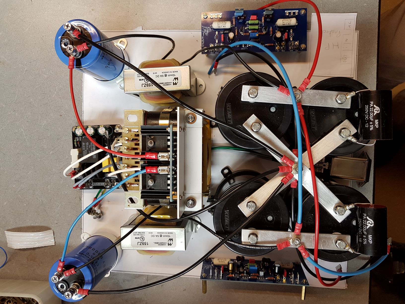

Hello,
In the attachment you see the connection of a choke in a CLC configuration in a Hiraga amp i found on a French website. I remember Jean Hiraga telling people to connect the '' output wire '' from the choke in the center of the bar between the last two caps. Not doing this could result in a light bzzz sound sometimes. Probably connecting the choke in the middle of the bar would create an equal situation for both caps. The first one they made had the choke and the circuit itself both connected to the same cap.
However now i read on this French side that there was another connection, I forgot but probably connecting the choke on one cap and the circuit to the other cap.
Anyway with these kind of circuits hard wiring like in the picture would make trying a piece of cake.
Greetings, Eduard
P.s Of course use a serious choke to me 10 mH is a joke once you heard one like in the attachment.

I agree wholeheartedly that lab time is critical to application and reinforces understanding. That's my wheelhouse, and I love it. I don't refute there is a difference or even that the magnitude could be meaningful in this application. What I've asked is why the difference exists. Extreme_Boky has provided an explanation. So how do we test it in the lab?
I like to have a proper experimental plan that can clearly lead to a conclusion re: hypotheses. I don't think simply changing the wiring between the two scenarios would lead to a meaningful conclusions to understand the underlying mechanism described by Extreme_Boky. That's predicated on whether I understood their explanation properly, which may not be the case. If I misunderstood, then clearly the underlying research question below would need to be re-worked.
Draft Research Question: "Why does one area within a copper plane or circuit carry current differently (and in a predictable and controllable manner with regard to 'noise') than another area of the same copper plane or circuit when a choke is wired between various points on the plane".
Fixed - Universal PSU V3 power supply board with my current caps, rectifiers, snubber, toroid, AC supply etc. and a Hammond 159ZL.
What independent and dependent variables could be used? What measurements would be most relevant?
