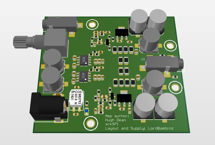

xrk971, can I use your schematic as a base for my owm design?
I would like to try to implement also a DAC directly on the PCB 🙂
Sure, please attribute the design to Hugh Dean and xrk971 on the silkscreen if you make your own PCB - and only for non commercial use.
No problem, i will post the design also 🙂

Hi Bambinz , its not a good idea to use USB to power your DAC+AMP combo as ground can be noisy.
In case of PCM1794 , you will need three other op amp for I/V conversion, i will recommend using OPA1642 or OPA1656 here but good old NE5532 does a great job. LME49721 can be used if you wanna go for USB power.
In case of CM6631 , feel free to ask me to customize the firmware if you need.

Maybe instead of the PCM1795 I will use the ADAU1761 that integrate a DSP, so I can add filter or other things. I've used it before for in a work project ( I am electronic engineer, but my field is not the audio systems)
The firmware CM6631A should be programmed? Now I search some info about this IC 🙂
Another candidate is the SiliconLab CP2114-B02, can reach 48kHz, 24Bit.

Maybe I will put only the DAC and an Analog input on the AmpPCB, and then the USB to I2S will be in another PCB, so at the beginning I can buy it.

I have finished to design the amplifier and the power supply! 🙂
Now I will develop the PCB 🙂 I will post it!
Instead of put mosfet at the output I have implemented a slow ramp-up on the supply. 🙂
Slow ramp up on supply works well too. I have used Juma’s cap Max circuit which ramps up over 10sec and prevents turn on thump. It suffers a 3-4v drop though.

I use this USB to I2S board in one of my DAC’s. It works excellent and has lots of features and hookup options. Also, you can keep the “dirty” USB power separate from the “Clean” Dac side by powering the board with an external regulated psu.

xrk971 I have used two LDO (One for the left channel one for the right channel) ADP7147 (High PSRR, low noise LDO regulator). In this LDO can be set the ramp up time by adding only 1 capacitor 🙂
I have used two LDO because to avoid unstability due to high capacitance!
In addition, where possible I have used 0603 component 🙂
