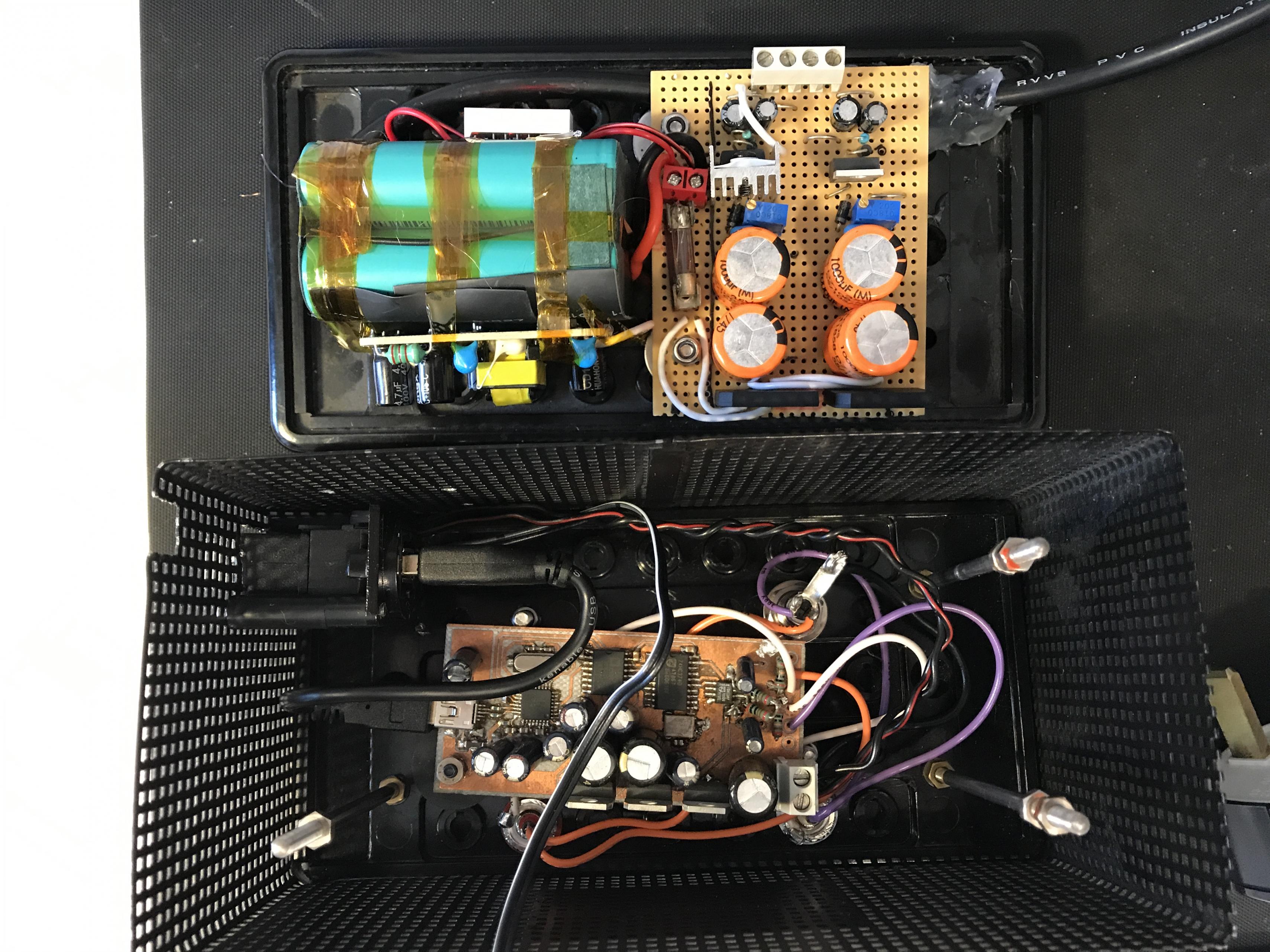

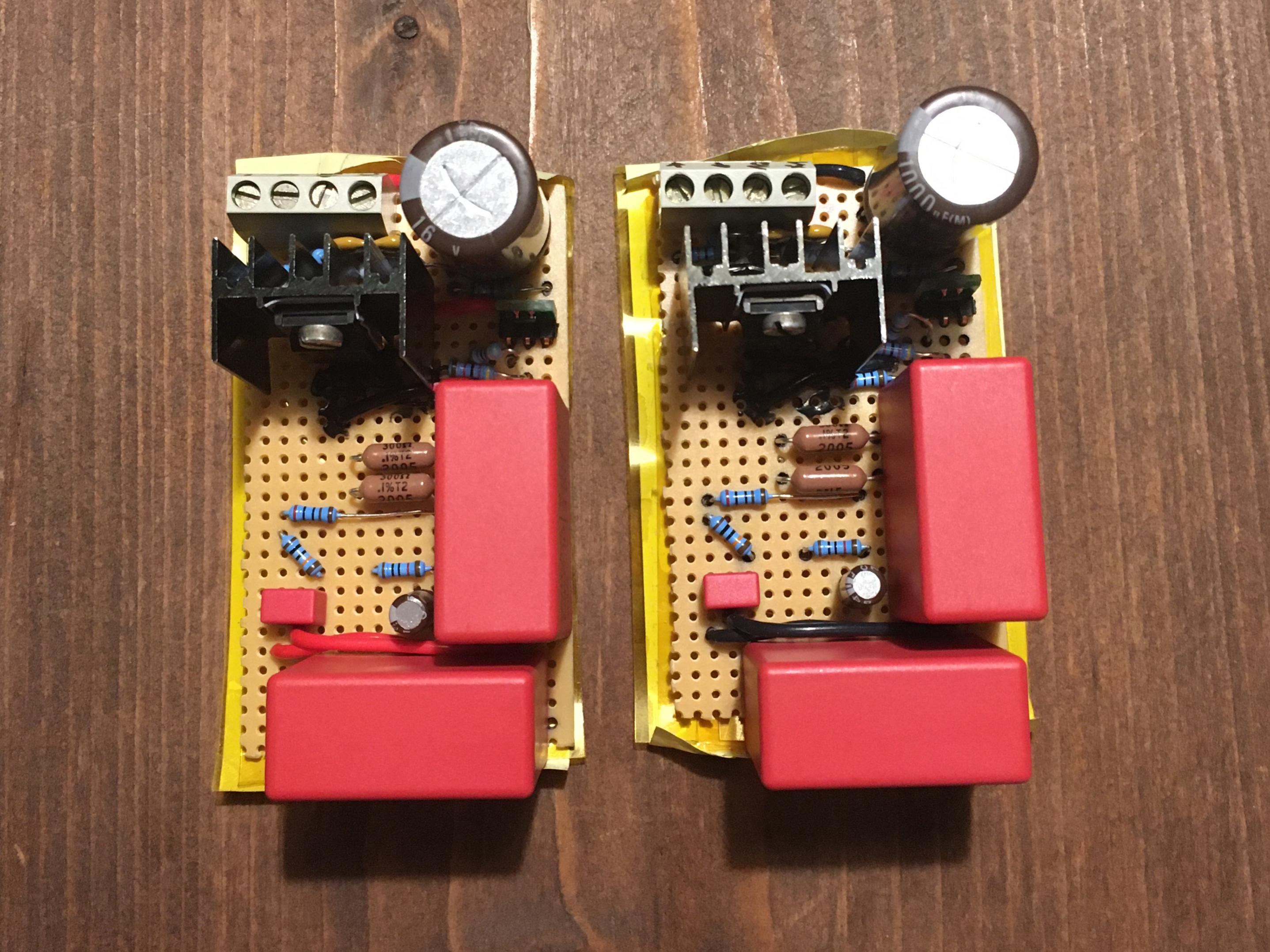

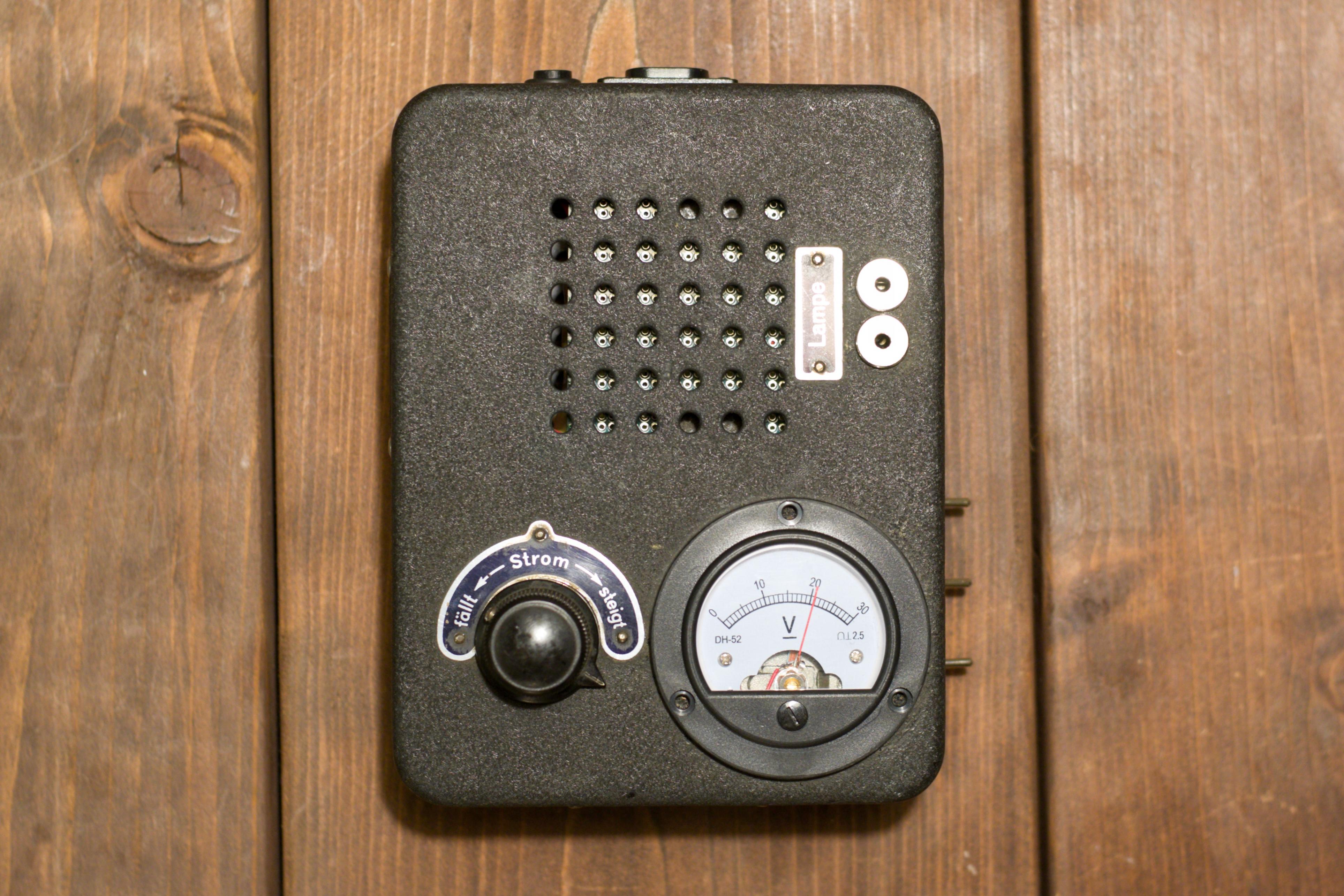

I decided to build my first ever headphone amplifier and after a thorough search on diyaudio, this looked like the ideal candidate. I had an enclosure that I wanted to use for the amp, so I started from the wrong end of the build and tried to fit everything to that enclosure. It was a real 3d puzzle and it even shaped the layout of the boards. This is also the reason why I could not use the Hakuin DBs unfortunately...

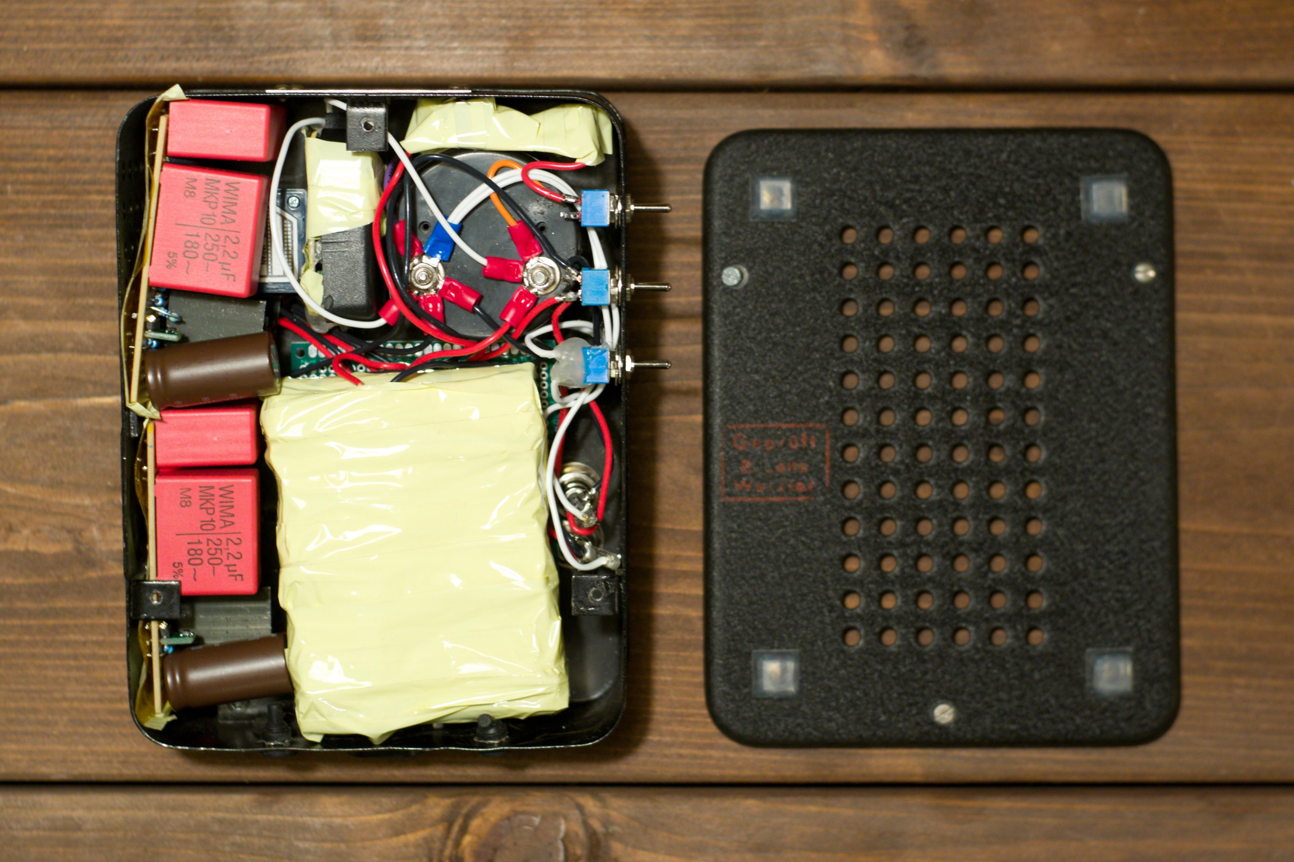

I went with 5s lipo battery as the power source. While the initial idea was to use a LDO regulator, I could not wait for the delivery and used a switching regulator that I had. I placed the battery charger into the case as well, so I only connect a power cable when I want to charge it. There are 3 switches, first one connects the charger to the battery as I thought I can disconnect the charger while listening, but I cannot hear any difference when it is connected so it may always stay on. The second one turns on/off the amplifier and the last one connects/disconnects the headphone socket to address the power-on thump issue.

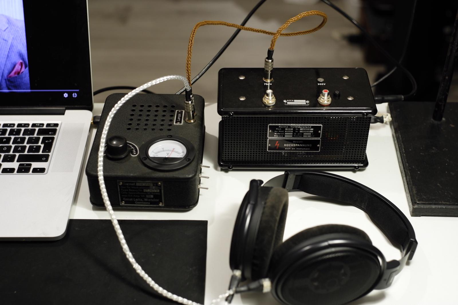

I am listening to this amplifier with Sennheiser HD6XX and a non oversampling dac (tda1387). I do not have anything to compare it against but it sounds amazing. Thank you xrk971 for the design!

Very handsome upcycling!
The second old black box is the DAC?
Now you need to upcycle some old headphones with new drivers!
Thank you Andersonix! Yes it is the DAC. Sorry if it is a bit off-topic but here is how it looks inside. I had originally built it with a power supply that has the standard AC transformer, diode bridge, capacitor filtering followed by a linear regulator. I was happy with it until I built this headphone amplifier. Then I started hearing the hum from the transformer at maximum volume. So I tested powering the DAC with batteries as well. Now the background is totally silent even at maximum volume.
