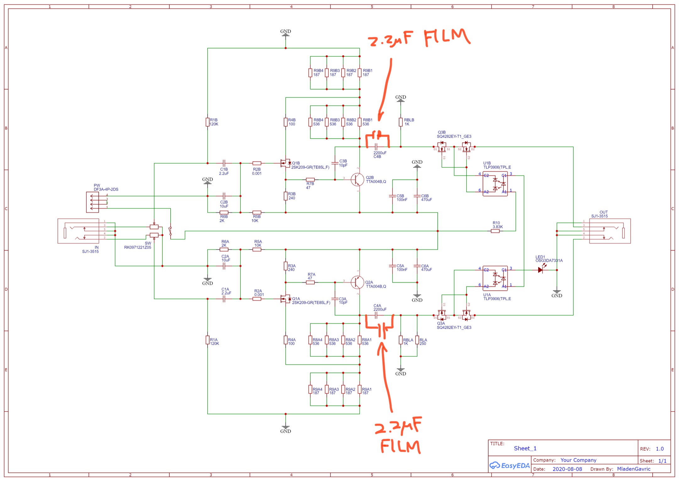

I'm a bit lost in translation on this one (english is not my first language):
Could you quickly scribble/doodle it on my previous attachment, please.
I would add 1uF to 2.2uF 50v Wima MKS (or MKP if you have space) across C4.
Yes that works, but might have excessive heat. 18v is fine for most headphones. If driving lower impedance headphones, increase current. But for the small on PCB heatsink, I would not go above 70mA.
