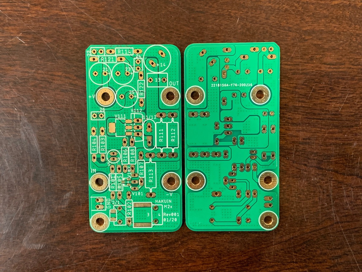

The Hakuin for the Yarra preamp motherboard has arrived:
It could be used stand-alone with a clean 18v to 24v PSU (or battery) and connect the inout and outputs and PSU directly to the bolt hole pads for the standoffs.

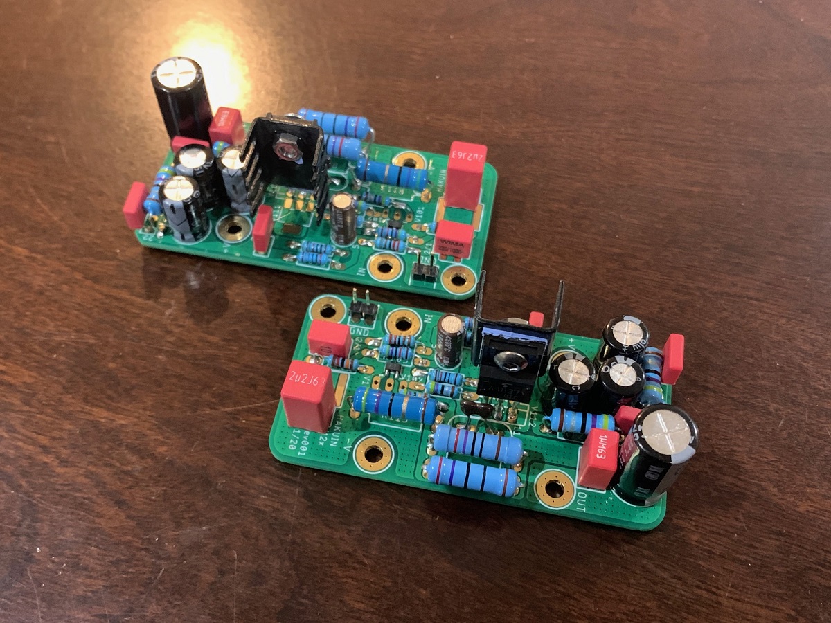

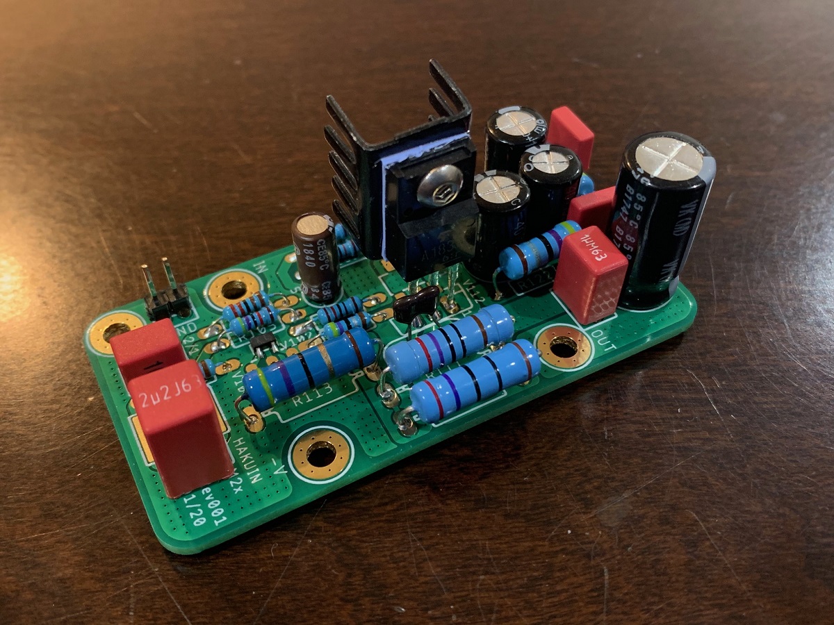

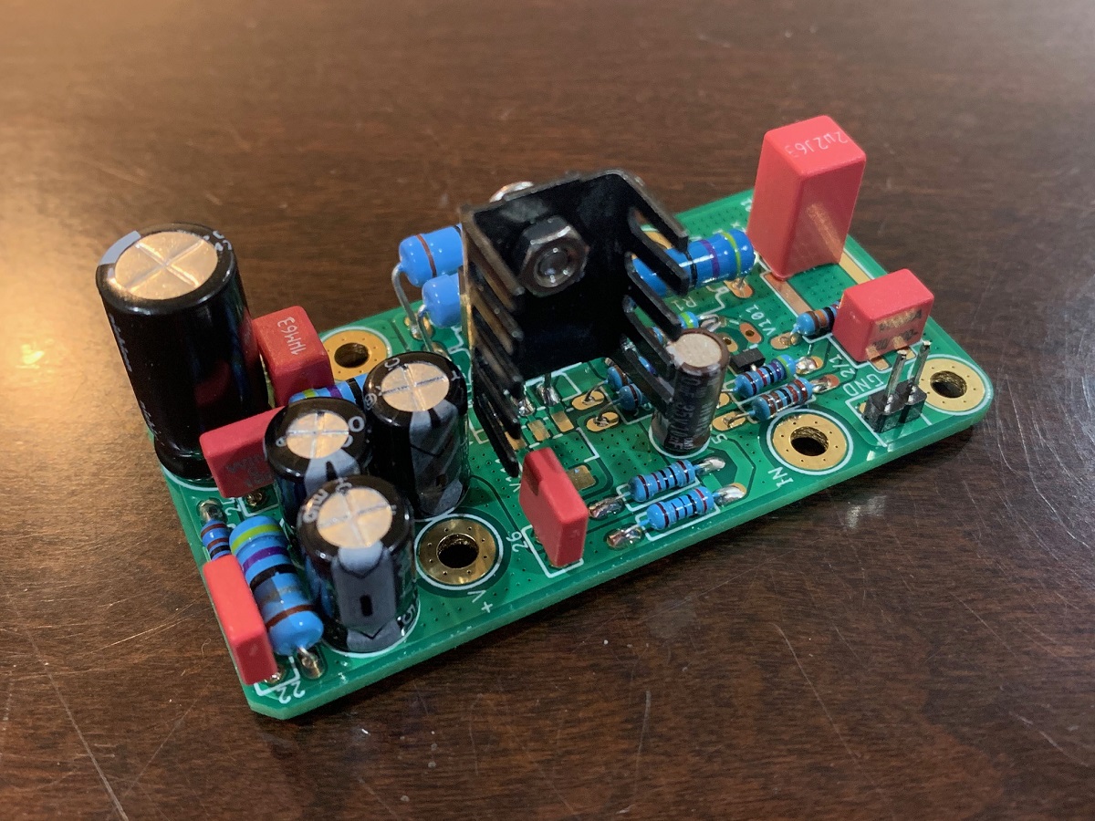

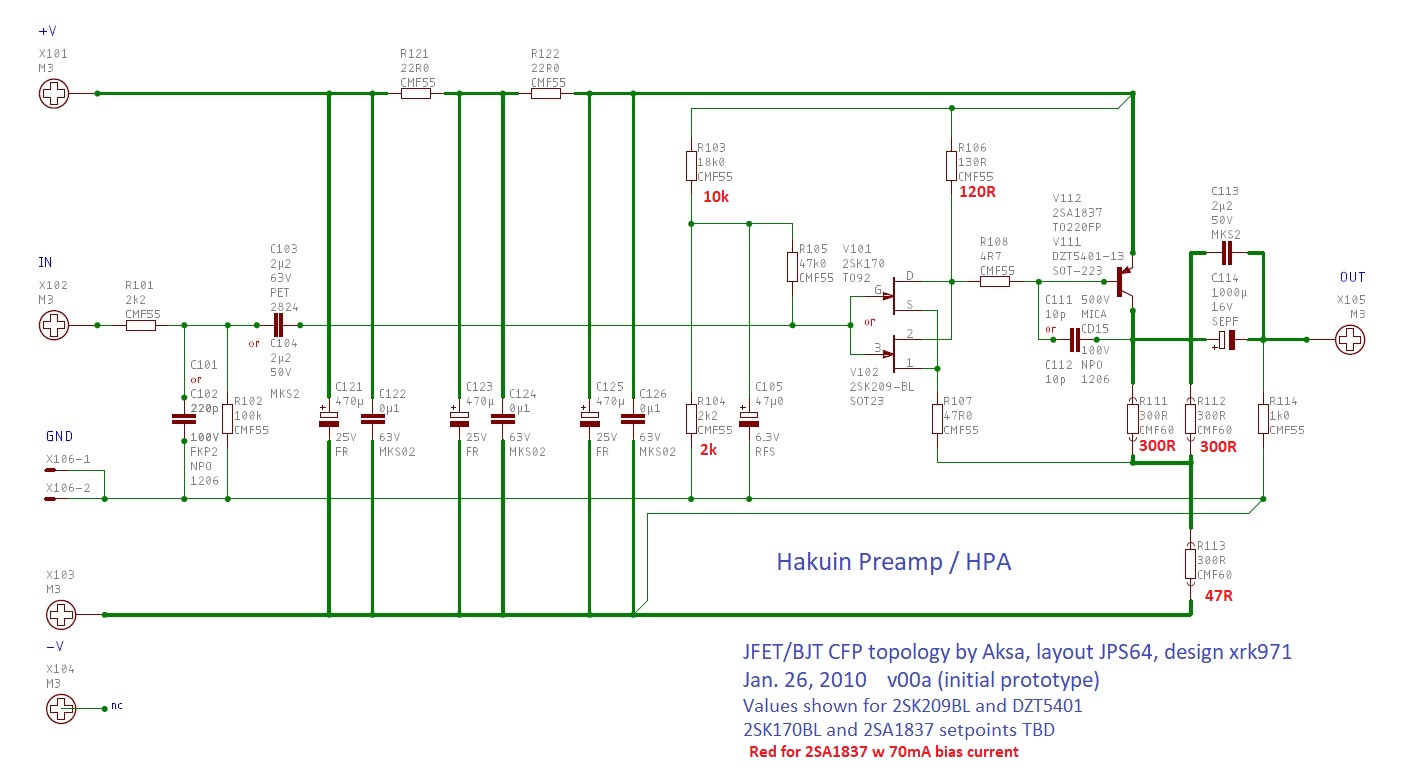

I just got done soldering this up. Will have to wait before applying power and listening as my Yarra bourd is being used with Melbourne for something else at present. I may just have to solder wires to it. I found out what the resistor changes need to be for the 2SA1837.
New resistor values for 2SK209BL with 2SA1837:
These will sell for the usual price of the Yarra DB's (please check on my shop). I can provide 2SA1837's as an option.
Good to see that I calculated the same values when I was playing with the Sim 🙂

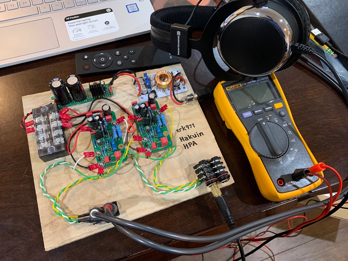

Hakuin DB's Verification HPA Build

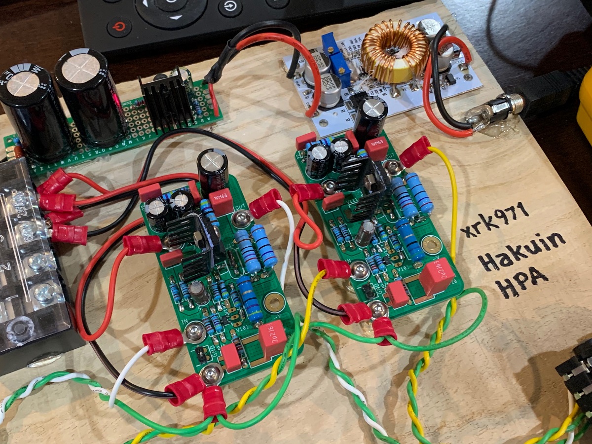

The Hakuin DB's for the Yarra have now been verified to work and it sounds great. Another headphone amp/preamp on a plank. Using a DC-DC step up and MOSFET cap multiplier (for slow ramp up) to get about 24.7v from a 12v linear wall wart. Getting exactly 24.0v at the amp after the on-board CRCRC. Bias current is 76mA and 14.3v at the collector of the 2SA1837. I did not have any 300ohm resistors so using 270ohms 2w, so the gain is a little less than nominal 11.6dB, but that's ok. Testing with 250ohm Beyer DT880's right now. Will test with the much more sensitive ESS 422H's later. There is still room to increas the bias current and maybe drop voltage to 18v. 2x130ohms (R111/112) and 22R (R113) would work well for circa 160mA bias current.
Well this amp really shines with ESS 422H’s. The bass impact and overall resolution is an amazing combination.

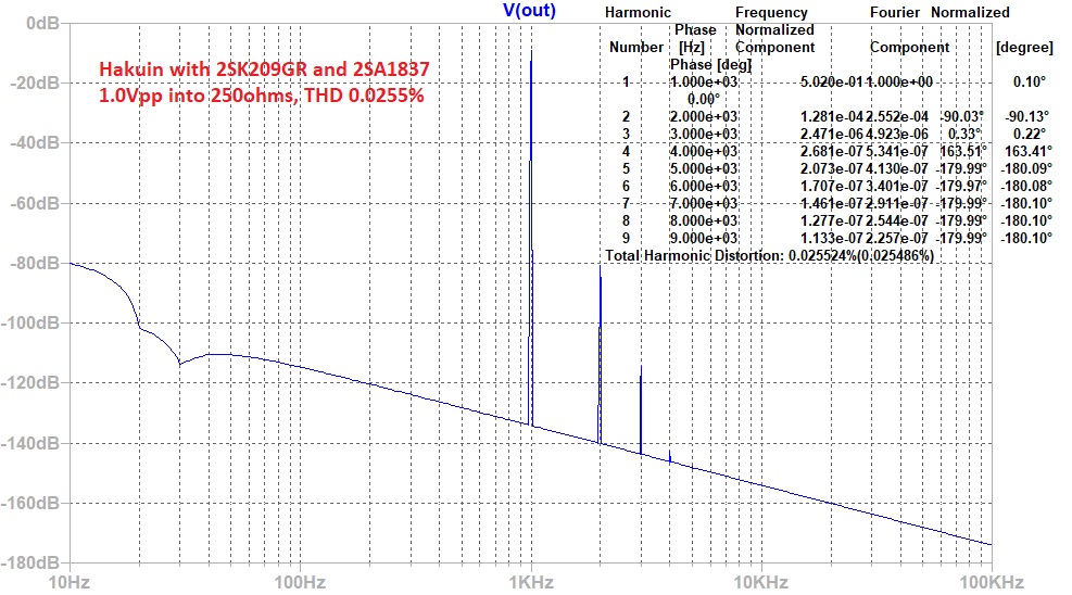

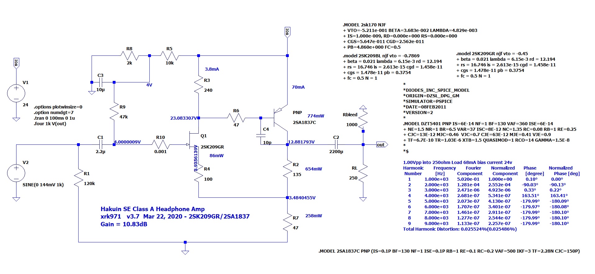

Here is the Hakuin LTSpice file. It has an approximate model for the 2SK209GR based on tweaks of Vto of the BL model to get Idss similar to what I measured. This was the approach recommended by Keantoken, who has since published a revised 2SK209GR model, but I have not had time to try it with the revised model. From what I have seen, the current model predicts the DC setpoints close enough for the BL version of the 2SK209.
