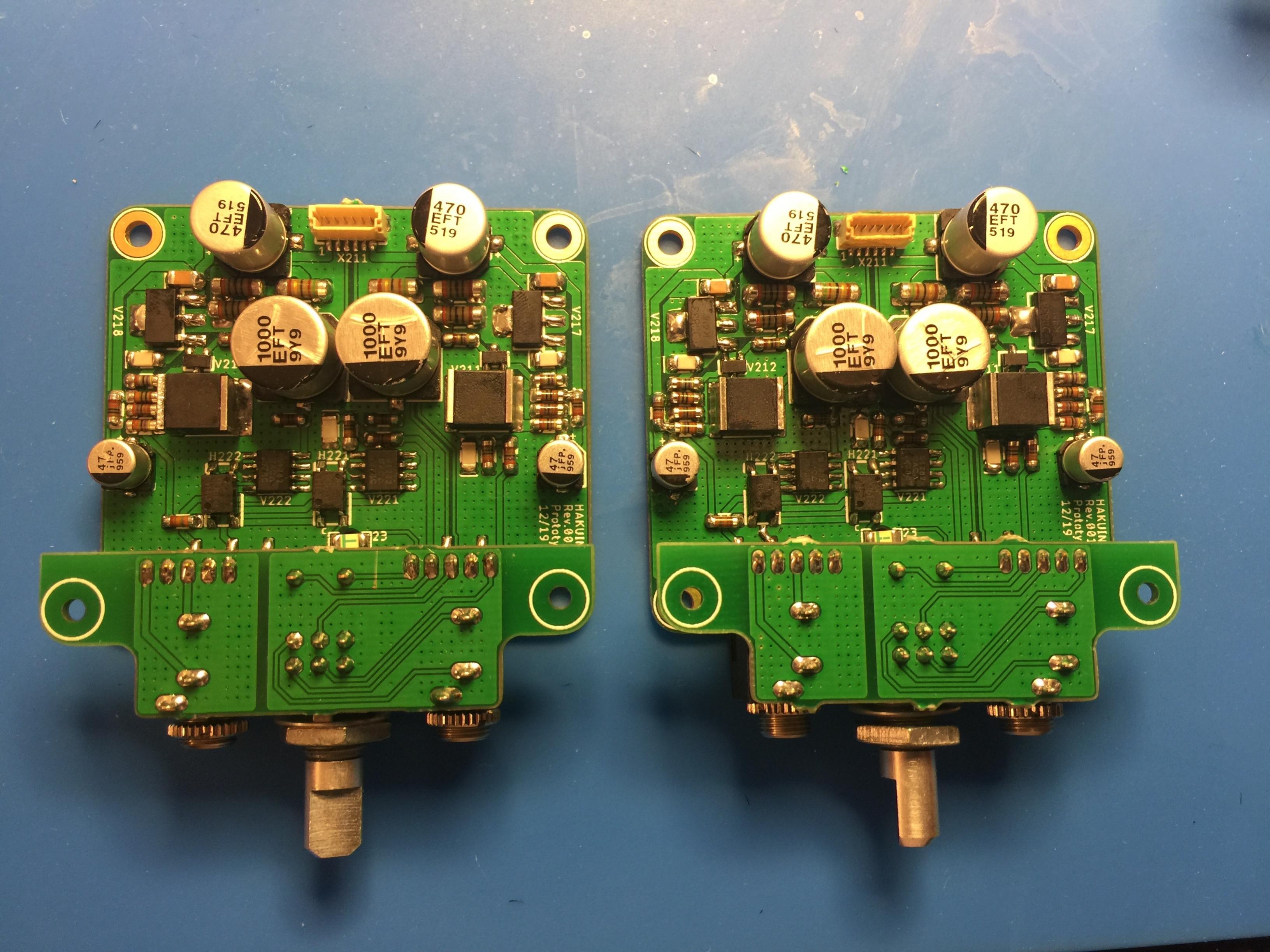

Update --
Finally! I had growing pains with both amps, but they are both up and running properly. Root causes: being in a rush and breaking a trace (amp #1) and cold joint / irregular soldering (amps #1 and #2).
I still need to refine my SMT soldering methods.
I am extremely pleased. I have no basis for knowing whether my lab SMPS is "good enough" for these amps. I'll try with the battery section later and/or wire up some 9Vs. I don't have any highish impedance HPs with 1/8" jacks, so I've been using some throw away earbuds for testing and then the Meze classics and Beyer Xelentos for a few songs. In brief sessions, the amp sounds great. No critical listening, just a guy loving his new amps. No bias here, of course. 😉😀
Meet the twins.

Nice work! Glad you got it all sorted out.
Thanks for all your help!
My SMT soldering was practiced and refined from building over 70 of the PCA’s. 🙂

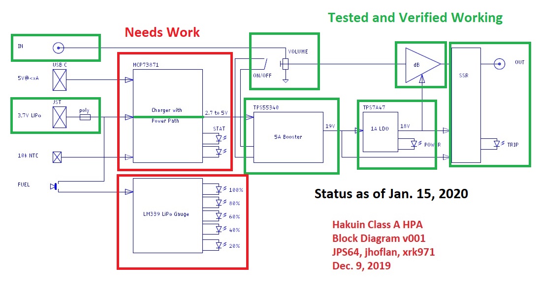

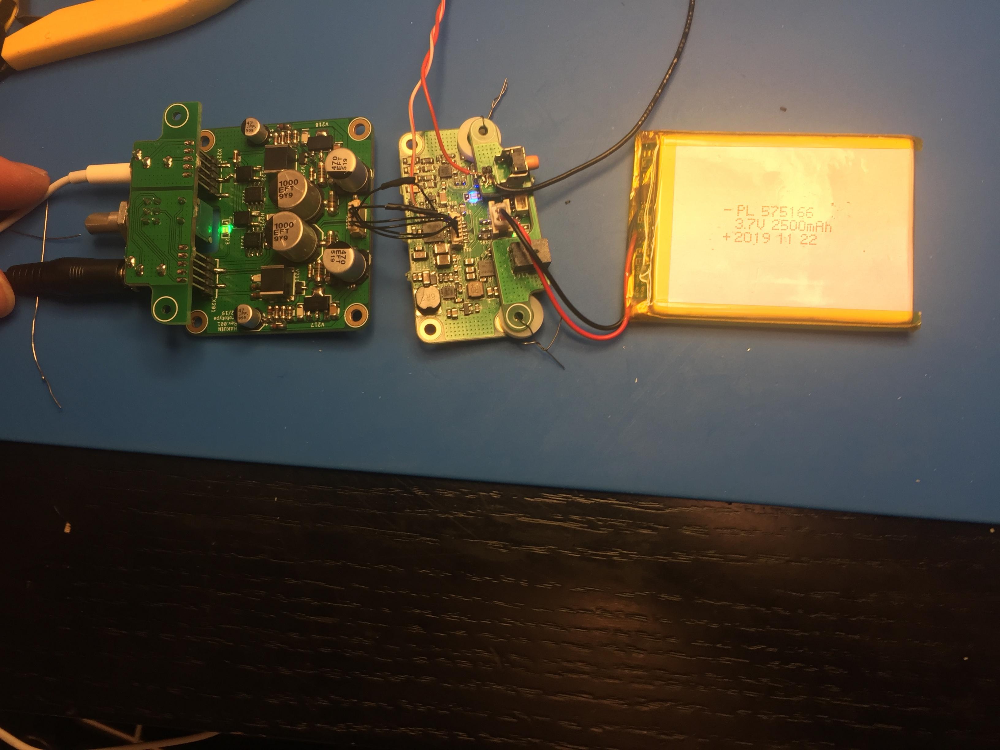

Awesome progress! Does the click switch on the pot turn it on and off? Also, is there a enough delay on the SSR to prevent turn on thump?
The click switch does work properly. Well, it worked once I connected pin 3 X111 to pin 3 X211 properly
I hear a tiny turn on / off thump, but let me report back later. I'm not sure I have any delay.
Ok, we can adjust the delay with a resistor change on the voltage supervisor. The charging is a blinking LED, solid light when charged I think. The fuel gauge will just have to be tested as you use it. Probably 3hrs or so to start running down to about 20%.

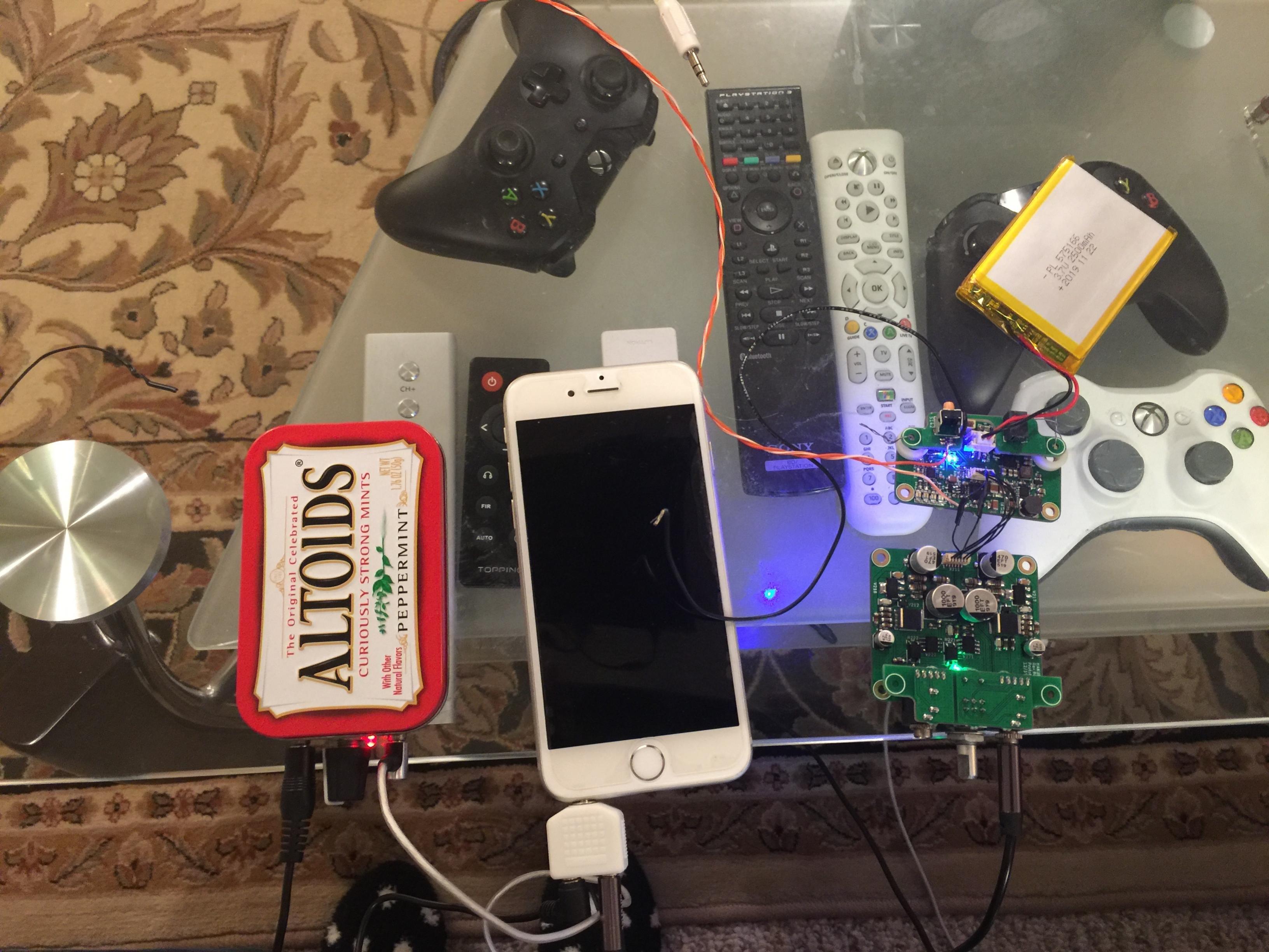

Pic of "High-Tech A/B Rig". Notice the fancy cables 😀

My pleasure. Like I said in the notes, I didn't listen to all the songs all the way through, but it was plenty of listening to gather some initial impressions and feel reasonably confident. I'll have someone swap them blind on me at some point in the future. I'm as susceptible to expectation bias as the next guy. 😀
RE: turn on / turn off. My PCAs have all had a noticeable "thump" at both turn on and turn off. It's nothing I've ever worried about re: damaging my HPs or bothering me, but it's there. The Hakuin has more of a very soft "click" than a "thump" on both turn on and off. It's much more quiet. Hope that helps.
Hi IAIMH,
A soft click for turn on and off sounds like the thump issue is fixed with the SSR and voltage supervisor and delay timer.
Any news on the charging ability of the smart charger on the PSU? It should charge without the amp being turned on. But if it doesn’t, we will need to look at that. Looks like the battery level meter needs to be looked at too.

X-
Great to know. Thanks! As you know I'm still a bit skittish.
I have clearly done something poorly re: the battery circuit - Charging is not working as I'd assume intended and no fuel gauge. I'll first try removing and re-flowing key parts using some heat from the bottom with a proper board heater. This was my first experience with parts having pads on the bottom, and I only soldered "from the top" with the heat gun. So, it wouldn't be absurd to think I've got a bad joint. 😀
It may be charging, but at an excessively slow rate. I set it to charge at 11:00. Value was 3V130. At 14:00, Value was 3V150. That may even be within error margins.

Hi IAIMH,
Thanks for testing all the different aspects of this smart power system: DC-DC step-up, ultra-low noise LDO voltage regulator, opto-isolated SSR anti-thump and delay, automatic battery charge when plugged into 5vdc, and battery fuel gauge.
Well, we made a lot of progress as you can see from this block diagram, now color coded with what has been tested and verified to work vs what still needs more work.
Looks like we have some debugging to do on the charging circuit and the battery fuel gauge circuit. I will hopefully get a chance to build it this weekend and we can debug in parallel.

More importantly. I bodged in a 10k resistor.
Initially, I thought it wasn't working. I powered up with 5V2. Compared to previous runs, H103 or H105 (whichever one blinks) started blinking at a much more rapid rate than previously, and my PSU was "ticking" along with it. The rate was ~2Hz or so. This continued for ~30s. The circuit was drawing a very small amount of current during each click. Then, it seems some logic kicked in, and the circuit started drawing ~1A45 at 5V2. H103 or 105 then went to a solid green vs. blinking. My current assumption is solid => charging. Blinking => charging "error" or prepping to charge perhaps.
When I take a reading across the legs of (Edited) X101, I am getting 4V07 rock steady, so the battery is getting a charging voltage. 😀
The current draw does seem to be varying based on the "baby sitter" circuit. Over a brief time, the current lowered ~1A11. After watching it over a few minutes, the current continues to decrease, so I assume this is as the battery charges. It is at 1A02 as I type.
