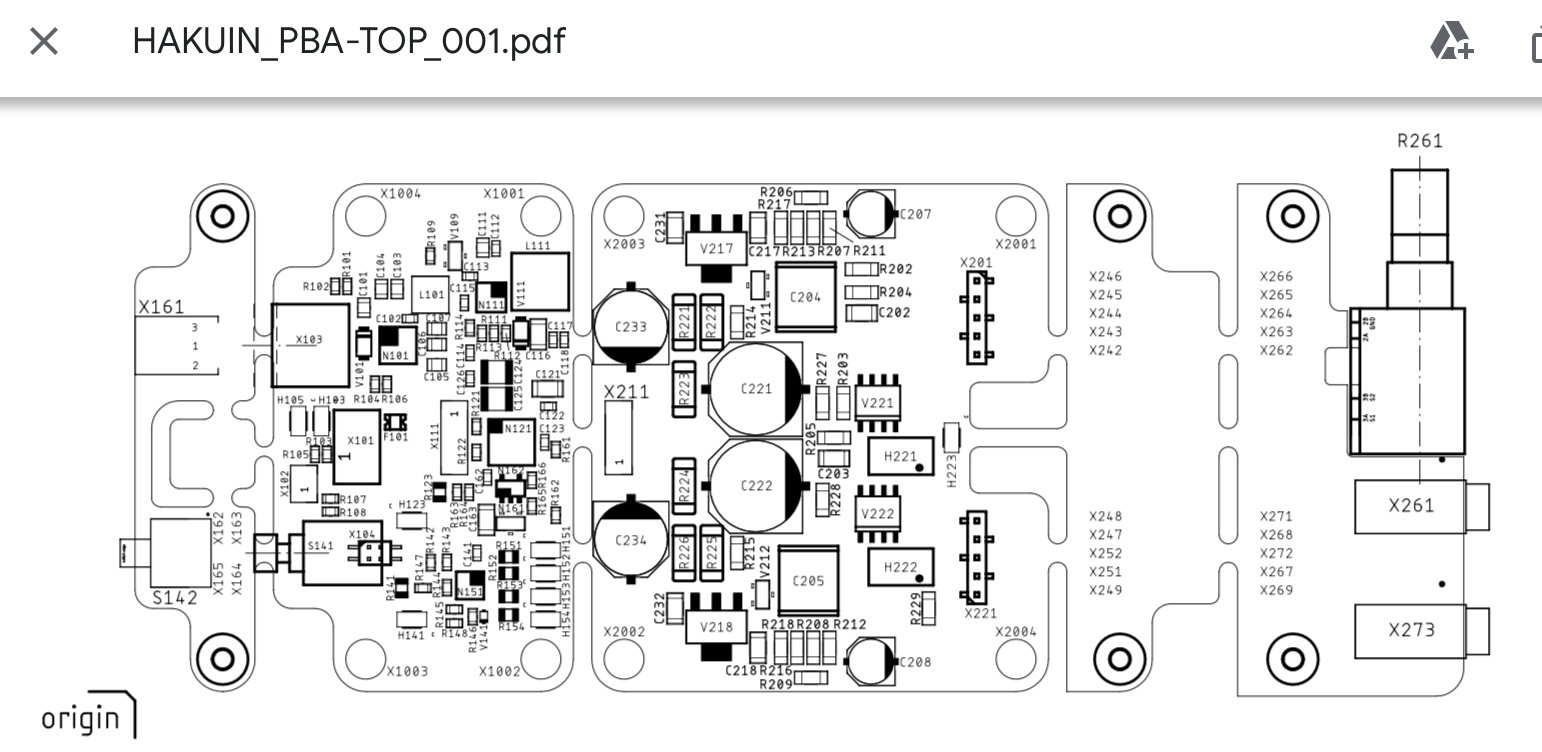

We will have a nice accurate BOM with this one thanks to IAIMH. I didn’t realize there were folks willing to DIY this all SMT amp - it’s got some tricky VSON parts that only can be done with paste and a hot plate or hot air. Nothing smaller than 0603 though.

With the super help from IAIMH, I have now ordered the BOM (mostly Mouser and a few items from Digikey). There are some interconnect pieces from Samtec that had to be ordered directly from the manufacturer. We should be able to build the prototype soon.

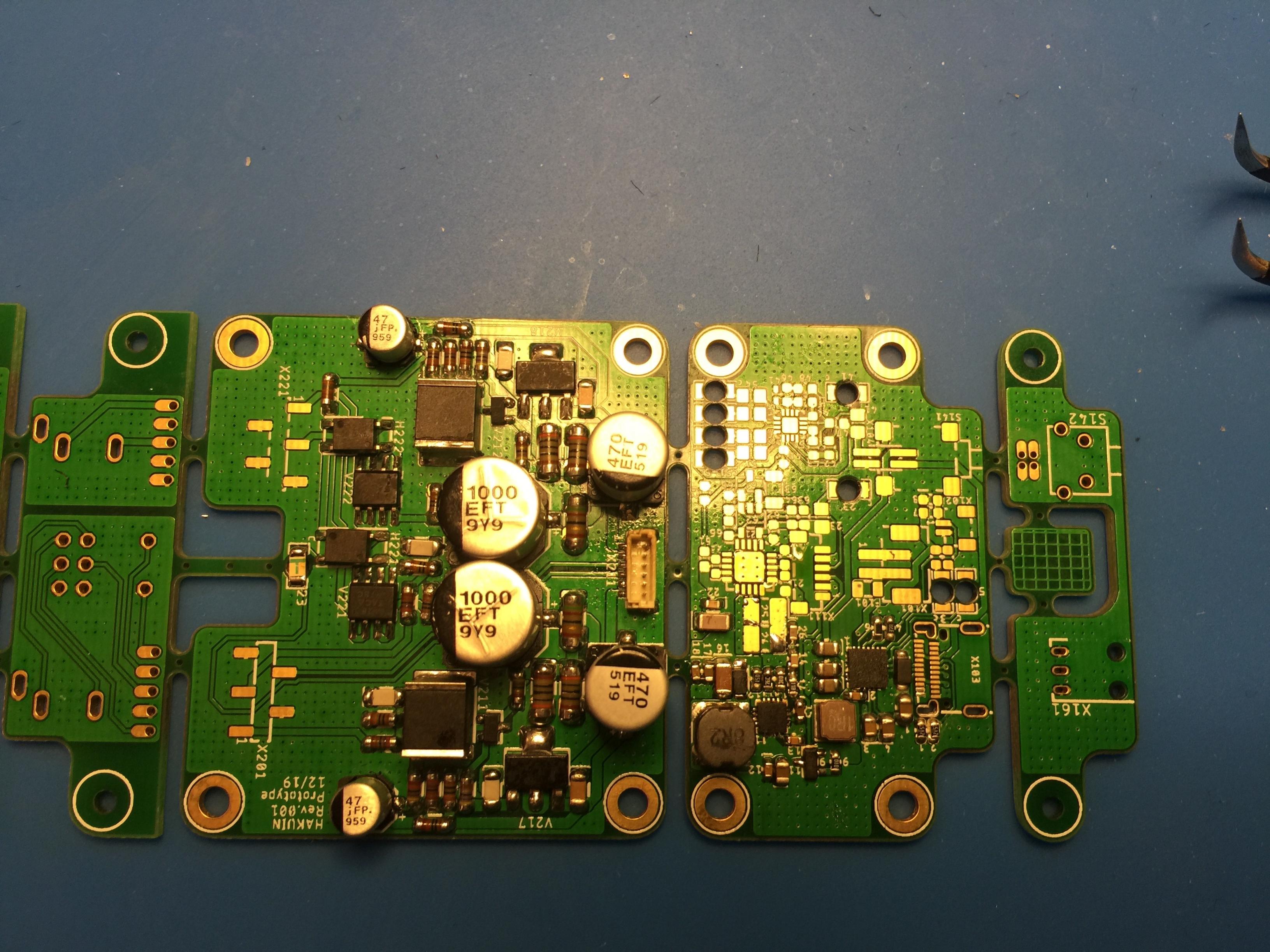

I was honored that XRK971 allowed me to try building an amp from prototype boards. The amplifier section went off without a hitch (I hope) hand soldering the components with some careful planning. The power supply and battery management system requires a whole new skill set for me with paste and a heat gun. With a bit of coaching, I think I can manage to learn how to better solder with paste, hot plate, and heat gun. At the moment, I am paused. I have to take a step back and rethink the plan.
Anyway... here is a picture of the progress so far 😀. Incredibly fun. Now I need a proper scope. LOL!

Nice work! Thanks so much for helping. You are doing great - and you are very careful, ask all the right questions, and you pick things up very quickly. Super skills for a prototype tester.
This project has moved forward a lot faster with your help.

....Anyway... here is a picture of the progress so far 😀. Incredibly fun. Now I need a proper scope. LOL!

Wow!! Your progress looks great, IAIMH 😉
Looking forward to your next move.....
