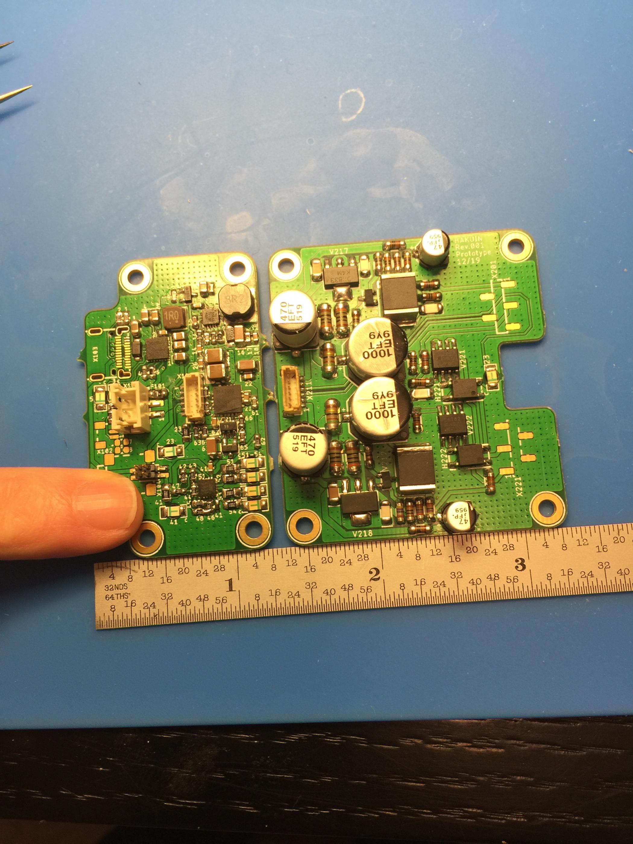

I also have the PSU section for the LiPo almost finished up. A few tiny things before I can test that. Ruler for scale. This stuff is weeeeeeeee tiny.

This stuff is tiny to work with but ulitimately, it is not that hard once you are used to it, and is faster once you are practiced. Think of all the leads you did not have to bend 90 deg, and stick through a hole, and solder, and trim and all the board flipping back and forth.
Just apply solder paste, install little pieces using tweezers, hot plate or hot air or both, minor corrections on parts that stand up straight or otherwise misaligned, or apply some wick to clean up solder bridges, then done. No waste, no jar full of lead clippings, no dirty sponges in your solder iron base. 🙂

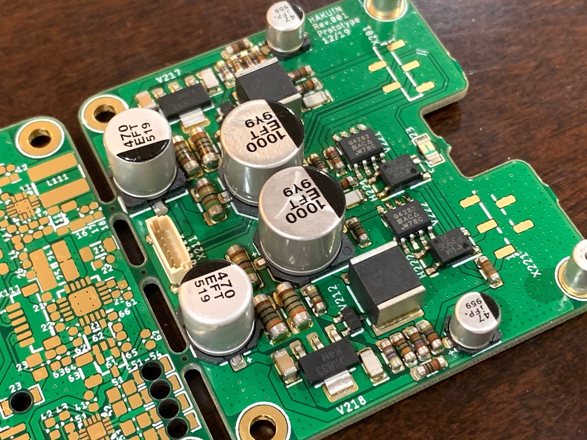

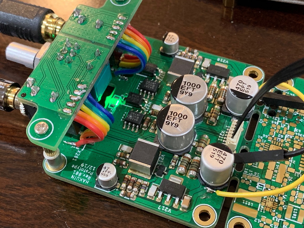

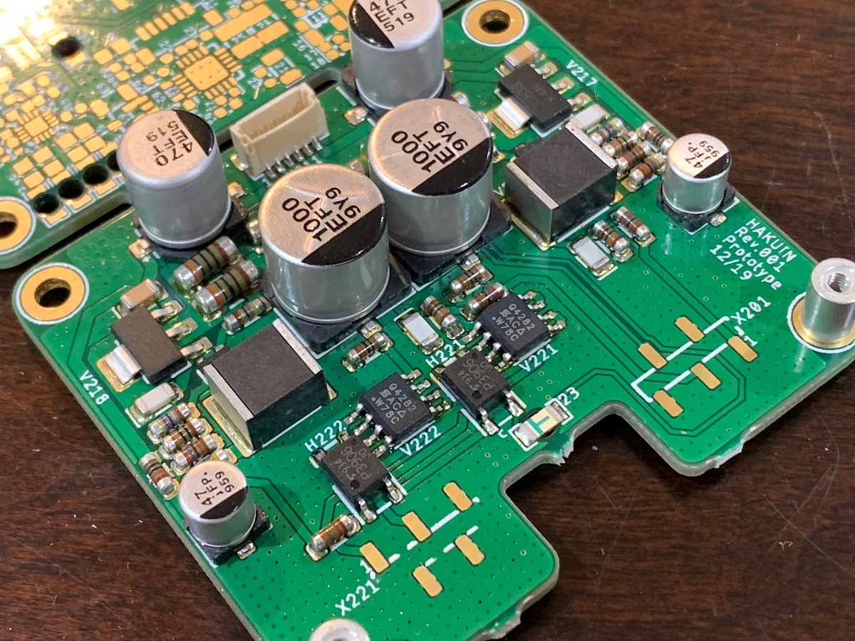

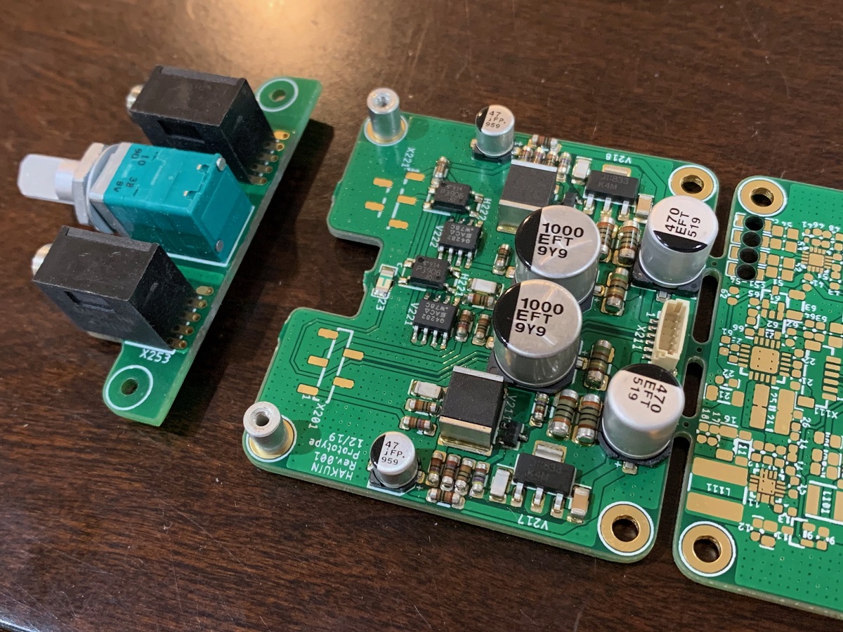

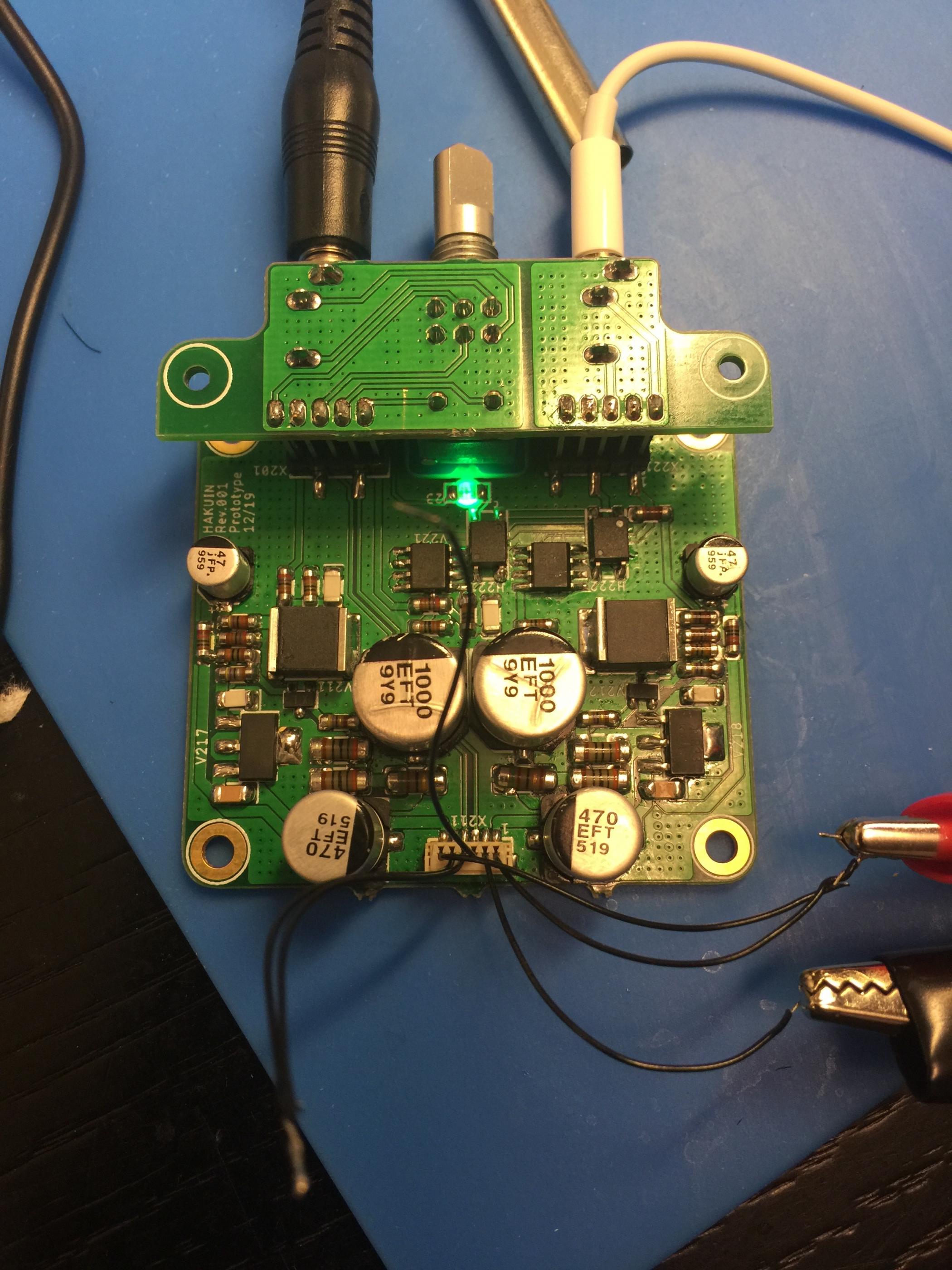

I couldn't let IAIMH have all the fun, buoyed by his success, I had to build my own Hakuin too. So just the amplifier section first. Everything soldered together nicely with paste and then hot plate to 135C and 300C hot air pencil on top to liquify the paste as needed. I did all parts except the big caps and the 6 pin connector first to allow even hot air heating of the small parts. Then I added the big caps and connector for a second round. This way, the small parts were ensured to be well wetted to prevent cold solder joints. Visually, the joints all look excellent.
Then I had to connect the volume pot and 3.5mm jack riser board to the main board but lacked the special Samtec surface mount 1.0mm pitch extenders (on order - IAIMH says they came all the way from Malaysia or something like that). In the meantime, I used ribbon cable to connect the two. Then used a small wire wrap wire to jumper pins 4 and 5 on the connector in order to enable the optoisolator coupled SSR's (these are normally controlled by a voltage supervisor and delay circuit to prevent turn-on/turn-off pops or thumps).

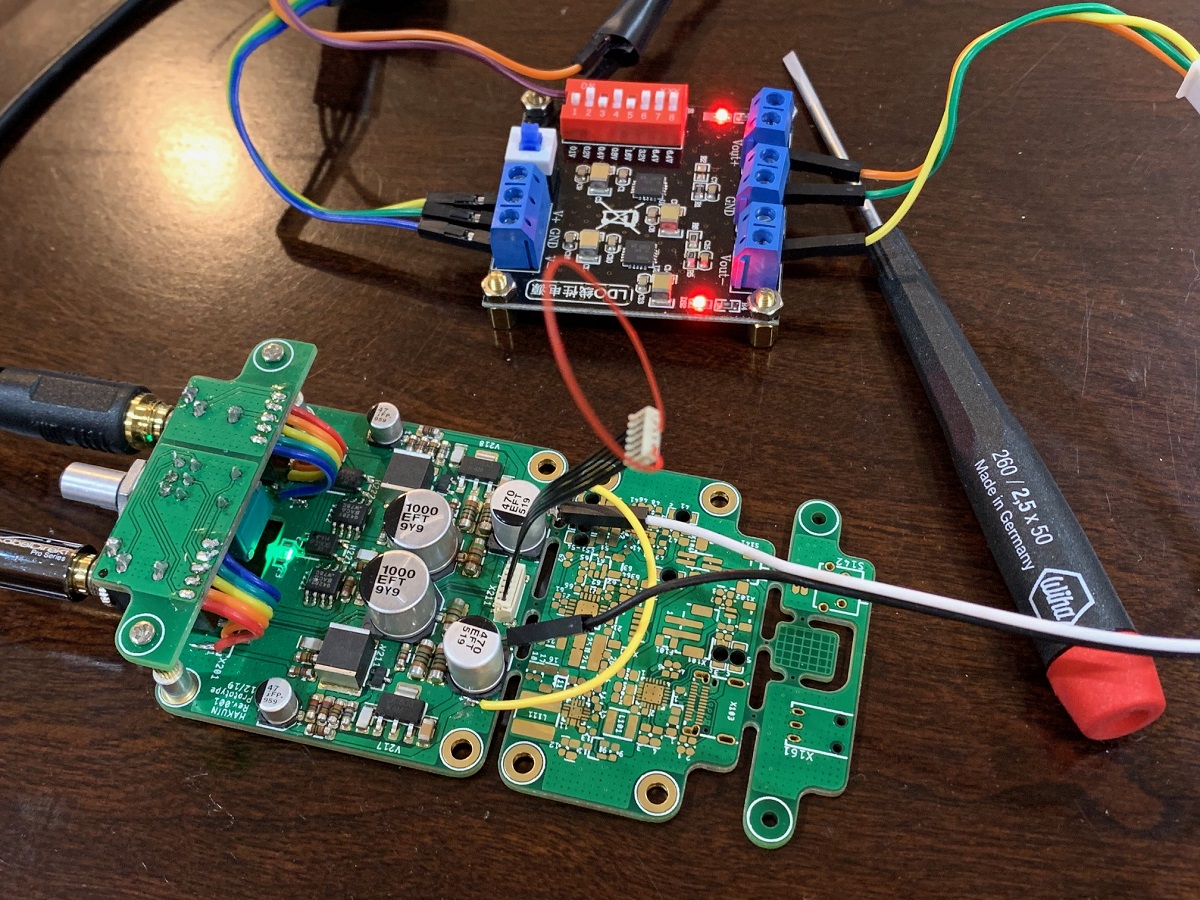

I then used a handy 5v to 24vdc DC-DC converter which feeds a pre-built TPS7A4xxx LDO set to 18.5v to power the amp. Jumpers were soldered to the leads on the 470uF rail smoothing caps (both as the supplies are separate on pins 1 and 6.
Turned it on, plugged in my SMSL Sanskrit 10 DAC as source and my DT-880 chrome SE 250ohm headphones and I have glorious music! It all works first time. Solid layout by JPS64!
The amp sounds great. Only had a chance to listen to a few songs but it is very nice. Super quiet (silent) when source is off.
We might have to play with the DC setpoints on the resistors a bit as the bias current across the 51R resistor is measuring only 40mA vs the 70mA design point. This is to be expected as the models of the JFET and BJT are not exact and there is variability in the parts. The bias currents are balanced though.

I think I know why my bias current was low: I forgot that I only had a small 6v low amperage wall wart power the DC step up so it was current limited and voltage dropped to 10v. IAIMH’s amp is hitting all the DC setpoints let the simulation - about 70mA bias current.
Yep, replaced wall wart with a 12v 2000mA supply and now have steady 18.5v rails. Bias current is 75mA, almost exact value as predicted by LTspice simulation. Kind of lucky I suppose.
