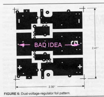

FAB -- I do suspect that a surge blew through some of the transistors.
If you examine the boards from the original article you'll see a problem -- (well, it's not a critical problem, just a big design booboo) -- the dreaded "ground plane" -- Walt Jung would spank them for this. (In Walt's absence, perhaps Janneman would do the honors.)
The wiring in the unmodified Haflers was the among the first issues tackled.

Jackinnj
I was suspecting more a ground connection error but do you suspect a ground loop that could cause such a surge on the pc-19 card?

Ground plane is just a bad idea --
When a transformer is lightly loaded (i.e. at the moment of turnon) the output voltage can be (is) higher than the level specified by the manufacturer. You can see this on a scope with event memory.

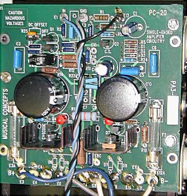

What do I have here.... DH-220 mods by Musical Concepts... to what extent?
I'm new to diyaudio, so please forgive my ignorance. I was out at garage sales this weekend and I picked up a Hafler DH-220. The cover panel also has a Musical Concepts modifications tag on it. It looks to be heavily modified and I was hoping that someone could tell me what I found? It looks to have a large Toroidal (circular coil) Transformer and four large capacitors versus the square transformer and two capacitors in the owner's manual.
Currently neither channel is working, but the left channel was working before my RCA inputs must have loosened up the left post. I noticed that the musicap on the capacitor rail has a burn on it where wire enters the musicap (Part C-2816 1.0 +/- 10% 200V MCPP105KC Musicap).... anyone know where I could get more of these?
I was going to post some jpegs of the amp w/o the cover on, but my files are too large. Email me and I will send you the pictures or put them online.
Can someone recommend some troubleshooting steps that I can try? All the fuses are fine, but the musicap does need replaced.

Over the years Musical Concepts ha several different types of modifications to the circuit cards in the Hafler amps. You need to get a graphics software that can shrink the size of your JPGs and post pictures here. There are several free shareware graphics programs suitable to your needs.
Does your PCB look like this? Without more specific info you will only get generalities in advice.
