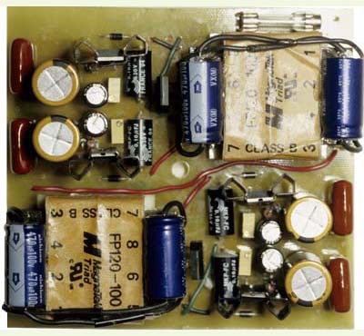

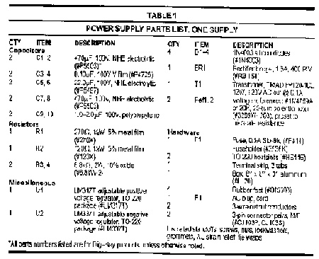

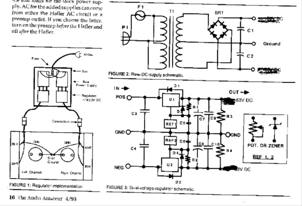

Here are the PCB images and a picture of the finished but unconnected regulator.
The schematic is in Audio Amateur 1993 volume 4.
Before hooking it up, I found that the positive rails had about a 10X difference in ripple current at the output.
Left channel: +0.032, -0.003
Right channel: + 0.032, -0.005
I was not too concerned about this, but wonder why. I used LM337 and LM337 as regulators, and trim pots for their references.
I set the VR's output voltage at 70 (each rail) , and after installing it and connecting it to one channel, I noticed that the bias current was unstable, even after about 30 minutes. I then replaced R31 and R32 and D15 and D16 with wire as suggested in the AA article (see also post 250). After this, I could not adjust the bias current, and it was about 27mA. I checked voltages at some transitors and they were way off on some legs.
I replaced the Hafler board with a spare (no changes to R31 etc), and lost the bias even faster (in seconds). I checked and recorded voltages at the transistors, and compared them with the table in the Hafler DH220 manual. At least one leg (e, b, or c) was way off for every transistor, and the DC offset was 67. Bias current was again about 27mA. I unhooked the voltage regulator and put in another spare board and the amp was fine.
Pulled transistors (Q1 thru Q13) tested okay with a DMM, but Q1 and Q2 were bad when using a testor based on small lamp bulbs. I did not get a chance to test the others this way. All the diodes, including the zeners, are okay. To be sure, I pulled the zeners and they pass 9.8 volts each. The resistors look okay.
There is not much to hooking the VR up, but for some reason the voltage regulator I made and the Hafler board (PC19c) are not compatible.
Any ideas on what could have gone wrong?

mmerig,
Your description mentions LM337 twice but no LM317. I assume this is just a typo and that you use a pair of + and - regulators.
The PC-19c PCB is used, with only 2 slightly different resistors, in the DH-500 amp. Therefore, it can easily handle the 70 VDC you are trying to give it with your regulator. The original article used 63 VDC as the regulated output but this should not be a problem.
I assume you have double-checked your wiring, etc., etc.

Thanks for the help, Dick and FAB.
The LM337 listed twice is a typo; there is an LM317 and LM337.
I figured the 70 volts woud be fine, as most of the transistors on the PC19 can handle about 150 volts Vce and Vcb, and its not much higer than the usual rail voltage. The one exception is Q9 (2n222A). but it normally does not see anything beyond 2 volts. Q9 was the first one I checked with the meter, as it sets the bias current. It passed using the DMM, but I tried a new one anyway, and this did not help.
I tested the regulator output voltages (positive and negative) when installed in the DH-220 amp, and they were -70 and +70 from ground. The regulator has its own transformers (FP120-100, see picture in post 271). I did not test the voltage once the wires were connected to the PCB.
The power from the main DH220 transformer goes to the MOSFETS (after going through the rectifier and caps of course) and is disconnected from the PC19 board.
Essentially, the wires at nodes 3 and 10 on PC 19, which originally got to both the MOSFETS and the board, are re-wired so that they just go to the MOSFETs. The output wires of the regulator are then connected to nodes 3 and 10. The regulator's ground wire goes to the star ground of the amp.
The input voltage of the regulator is 120 VAC and it comes off the main switch of the amp.

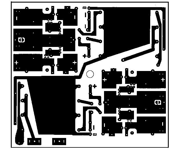

Fab's modified circuit board
