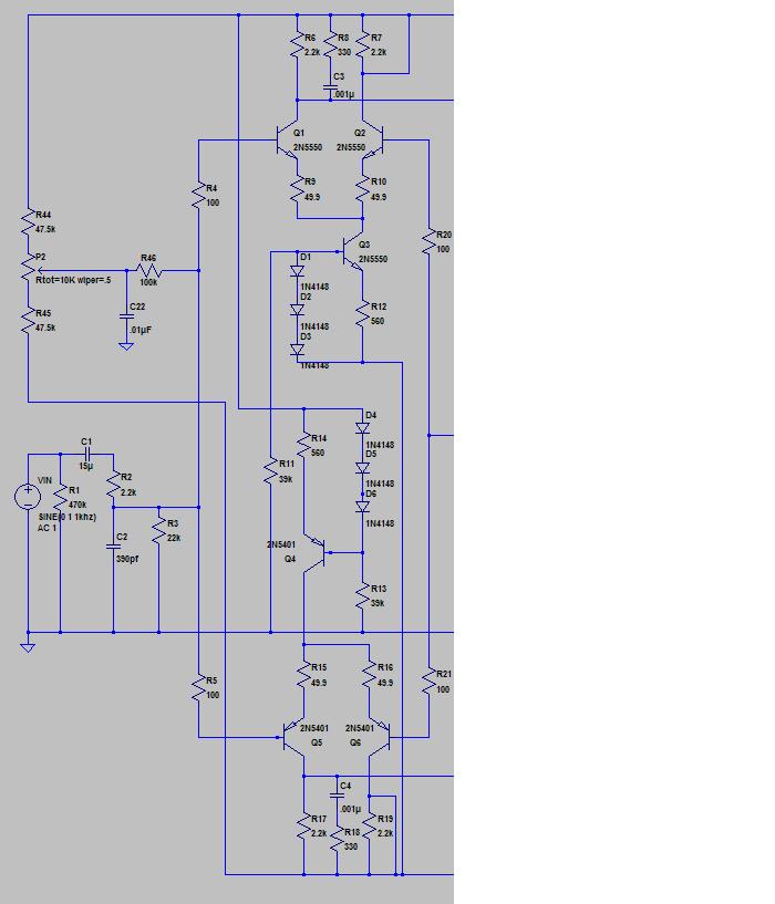

Hello all. I've read over the thread and found it to be a wealth of information. I have acquired an DH-200 and am beginning an overhaul/upgrade. I'll give a quick rundown of what I've fooled with so far before I get to the questions 😉 .
I have replaced the main filter caps with 18,000uF each. Placed a 2.5 ohm 8 amp thermistor between the switch and fuse. Replaced C7 & C10 with 220uF low esr Panasonic caps and bypassed all electrolytics with .1 pp film/foil and replaced most film caps with pp.
I also changed C13 to 33pF between gate and drain on the N channel devises as per Mr. Borbely.
The input jacks have been replaced with some Cardas jacks and shielded twisted pairs running to the boards, the shields tied to chassis ground at input, each signal ground tied to star gnd via 5 ohm resistors. I am also replacing resistors with metal film.
I'm keeping the fuse in the feedback loop for now, just using 5A fuses. I don't like how fuses sound but I had a Dyna 410 weld a Scan Speak woofer at the far reaches of it's excursion once. Wish I had a fuse then. I'll try and rig up an A-B test for the fuse in and out of fb at a later date.
Now I head towards a few questions.
My project experience over the years has been mostly tubes so I'm a bit out of my depth with low impedance silicone gizmos. First I am intending on changing the input section C1 to 2.2uF pp, R2, R3 and C2 to 47K, 4.7K & 180pF. The input filtering with R3-C2 remains about the same. Will the higher input R cause any stability problems? Can I go to 100K? I have several tube pre-amps of my own design as well as my old stand-by SP-6B. (yes I still listen to vinyl on occasion) So 22k input is not what I need & 47K is a compromise.
Another area I'm unsure of is I have run a wire from star gnd to the chassis straight down in front of the bridge. Should the 680pF N channel drain to chassis gnd have a wire to star or is it sufficient as it is?
Also does anyone know a source for matched inputs, My DC offset is pretty far out being 35mV Rch & 71mV Lch. I don't see any other way to correct it.
Thanks in advance for any help. And apologies if I'm too long winded.

DH-200 impedance and DC offset
I do not understand why 22K input impedance is a problem in your system. Is it because your preamp open loop gain is reduced with input impedance of your power-amp? or you have multiple power amps so the load seen by your pre-amp is too low? or your pre-amp output impedance is too high?
22K gives a lower noise figure than with 100K but it may not be noticeable since all other sources of noise. But if you really need 47K you can do it but change R22 DC feedback to 47K also to avoid increasing DC offset at output. For R3 (2k2) you do not need to change it because you change R2. R2 and R23 should be equal for optimization (not taking into account your pre-amp output impendance though...) Increasing R3 to 4k7 also increases noise compared to 2k2.
since the 2N5401 and 2N5550 (Q1, 2, 5 and 6) are low cost you may buy several until you get matched devices. simply use a multi-meter with HFE (BETA) measurements of bjt transistors (or you can build a simple circuit on a "bread" board. Matching may be preferable to using a DC correction circuit if you can do it easily.

Ilardi,
Thanks for the reply and congratulations on completing your DH-220. There is a lot of satisfaction in tearing something apart and putting it back together much improved.
I believe I will add the offset trim to the circuit, easy enough to implement and I do have some multi-turn pots lying around unused. As for the 390pF caps on the output N channel MOSFETS it is my understanding that they are for waveform symmetry and 33pF on each device makes sense due to the inductance of the wires connecting the MOSFETS. The value of 33pF and the placement between gate and drain as suggested by Mr. Borbley seemed a wise choice since he designed the amp.
I have run a wire from c18 chassis ground at the heatsink to a lug I placed in front of the rectifier. Since the heatsinks are fastened to the main chassis with sheet metal screws I thought running a wire to a central point would be a good idea. What I'm unsure about is whether or not to tie the chassis to 0v / star ground. I have done it in a way that will be easy to A/B test once the amp has settled in and the ears will determine if I remove it.
My choice of the 5 ohm resistors at the input was carefully determined by searching through my boxes and finding 5 ohm being the smallest I had under 2 watt. My reason for keeping the inputs referenced above the chassis is that I tend to look at the chassis as RF shield (also antenna) which gets back to not tying the chassis directly to star ground.
I am by no means an electrical engineer just someone who trys to not let the smoke out too often and make things sound good in the process.

Re: DH-200 impedance and DC offset
The simple explanation is tubes. More specifically almost all my gear is vacuum tube. Two CD players are tube from the DAC on out, my main DAC is a CAL Audio Sigma. Preamps are all tube.
So all signals go through caps and I find all caps to be audible. The larger the cap the more noticeable they become.
I realize I am in dangerous territory on the solid state forum. 😉 Some would even say I belong in the tin foil hat crowd. But heck we are all probably a little nuts.
I was a fledgling tinkerer when Marsh and Jung came out with there work on caps in Audio and it had me wildly bypassing everything in sight.
With tube gear at least, I find anything above 1uF to be less than satisfactory, I will generally parallel 2 .47's.
I try to use as small as will get me the bandwidth I want and no larger.
Output impedance is a factor. To me it seems even with 600 ohm output impedance tube gear sounds more open with higher impedance loads.
With lower impedance loads the soundstage will first loose height then narrow and finally become very shallow. The liquidity also diminishes.
Tubes are High impedance devices that can be made to work into a heavy load but they don't sound best there to my ears.
Thanks, That is why I am here. No solid state design smarts. I completely missed the feedback value. The increased offset would have driven me nuts.
Regards to noise, the resistors are now all metal film so I gain something there at least.
I can match tubes but not BJT's. I have no meter do do so. I could rig up a way to current match but I was trying to take the easy way out and hope there was a source of matched parts.
I do have some sockets so I could breadboard a tester.
From your experience could you recomend a number to order for testing? Thanks

Re: Re: DH-200 impedance and DC offset
I have already ordered NPN bjt that have about the same HFE but it was different from the requited HFE for PNP for matching. There is no magic recipe I believe to get matched bjt for complementary part numbers. Sometimes it is better to get several different production lot numbers to increase the chance to get what you need. So it does not depend on the quantity.
In fact, you may have only one or two of your 4 bjt diff input stage that may be replaced for DC offset reduction purpose.
You can try this site http://www.borbelyaudio.com/pics/Compprice.pdf
to get matched parts.
I was able to get lower than 5 mv DC offset for the 4 bjts with HFE matched within about 10% to 15%

mike in florida,
Take a look at fab's post #200.
"You have perfectly understood. Only the K134 that is right. In fact if you check latest Erno's designs on the Borbely audio web site you will see that it is the case. And Erno confirmed that the g-d cap should have been used for the DH-200/220 and others too. However, the g-s cap is not that bad at all but as Erno has indicated the g-d cap improves stability even better. "
As I understood it, the 390 pf g-s cap is removed and the 33pf g-d cap(s) used istead. I further replace the 680pf C18 cap with a .1pf cap per the DH-220 schematic.
I have tied everything to chassis ground,(well first a star ground but I have tied the star ground to the chassis). It seems like a good idea, however, to tie the heatsink lug to chassis ground since the chassis-heatsink connection is suspect.
I think a need a lesson here about RF shielding. Why does holding the input ground above chassis ground improve shielding? Thanks.
