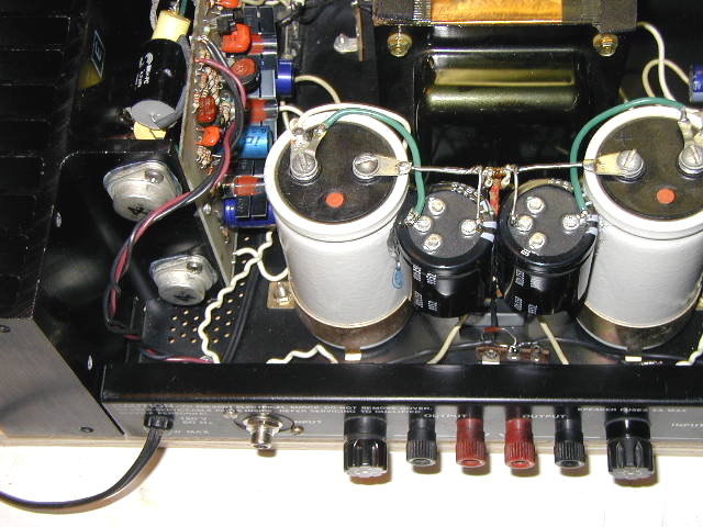

Power supply replacement/upgrade caps
I know the Musical Concepts 26k uF caps make a difference but they are pricey. Who makes these capacitors that then have "MC" silk screened on them?
What suggestions do any of you have as to a good replacement cap for the 20 year old Sangamo power supply filter caps usually found in the Hafler DH-200/DH-220/P-225/P-230 amplifiers? Their size should be 2" dia. x 4.125" high with low post screw mount.
I am not real good at sourcing parts so a brand name and series number would be very helpful.
Thanks....
Thanks....
Replacement caps
Hi Dick
The one I used in one of my DH-200 is Cornell Dubilier 30K uF part number DCMC303U075BC2B (2" x 4,125", 75V nom, 95v surge)
See at http://cdenb2.cde.com/invframe.htm?PTYPE=DCMC
They are also quite expensive unless you buy lots of them in one order.
Fab
Hi Dick
Fab

See posts # 47 (with picture), 49, and 51 for another option.
Two other options are
1) Nichicon KG Gold or Super-through (from Michael Percy Audio) has several choices in sizes that will fit the Hafler clamps (50 mm by 100 mm) in the 10Kuf to 22kuf range at 80 volts. They are about $20 to $50 each. I have not tried these.
2) A cheaper way is to use several snap-in caps (like post #47), and Parts Connection has some 12kuf 80 volts for about $12 each. This is a high capacitance for a snap-in. I would ask them how long these have been sitting around. I recently rebuilt/fixed an old amp for a relative and had to use snap-ins because of limited space (the originals were short, wide, and no longer available). You can probably get clamps for them and just solder the wires to the lugs.
There seems to be debate about how good PS caps have to be beyond smoothing ripple and storing charge. Comparing big (say 22,000 uf) general purpose or computer grade to smaller (10,000 uf) "audio" grade" for noise, distortion, and transisnt response would be interesting. I've noticed a difference in a channel-to-channel comparison in a subjective listening test.

Here is what I did last summer to a DH-200. You can see a pair of 1,000 uF caps soldered in and behind the PCBs you can see the yellow polyprops (47 uF in this case). This followed advice read here to not put the smallest of the cascade at the filter caps but instead mount them close to the output devices.
I can tell you that this mod made a very noticeable improvement over the stock DH-200 and, in this instance, the buyer of the amp was agreeable to purchasing these extra parts and did not insist the amp remain "stock."
