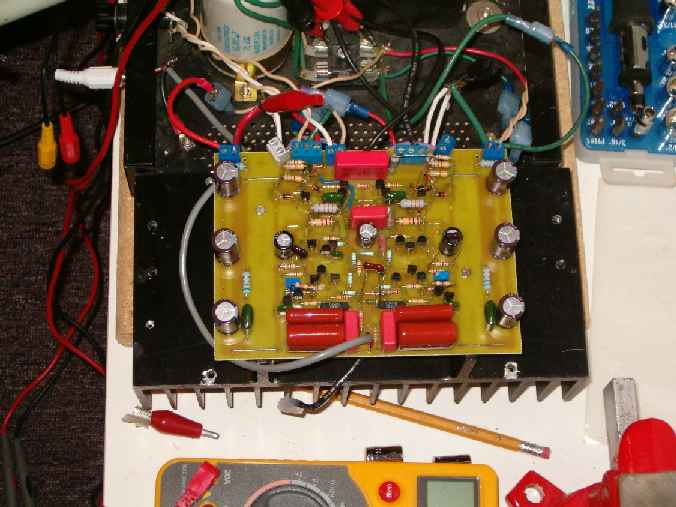

New driver circuit for DH-2xx amp
Hi
I was very curious on another thread about a new Amplifier Guru amp design which uses an original topology. In fact this amp has 3 threads on this forum!
See this link for the disclosed schematics topology:
http://www.diyaudio.com/forums/showthread.php?postid=736240#post736240
I have decided to adapt this principle to the DH-2XX amp keeping the existing Lateral Mosfets instead of using vertical mosfet as Greg does in its design. Of course, added to the fact that the complete Greg new design is not disclosed I had to adapt it to the Lateral mosfet characteristics. I have also included the Low Memory input stage I have already disclosed in earlier posts. So far, I have a prototype built but I need to improve some characteristics like stability for cap loading and distorsion before first trying a sound check with music.
Here is a picture of the prototype installed for one channel in a DH-200 AMP:
It includes tweaking components temporarily installed for quick testing.

Hi
I may request this forum help trying to finalize the improvement althoug Greg Ball may not appreciate this quest...
I could continue to inform you on my progress or I could start a brand new thread.

DH-220 Mods, PA3 Boards Installed
I recently modified a DH-220 with Musical Concepts PA3 driver boards. With one channel stock, and one using the PA3, there was a big difference (night and day) between the stock PC-19 boads (circa 1985, all original parts) which sounded fuzzy and compressed, compared to the Musical Concepts PA3B's (fitted with 100uF/100V Black Gate FK rail caps and a 33u BG-N input series cap) much more clear, natural and dynamic without being overly bright.
Bias current for both setups was set to about 250mA, and used the stock Hafler (Hitachi MOSFETS, 2 per rail).
Also, I replaced the main filter caps (20 year old 10,000u Sangamos) with 26,000uF parts at the same time.
