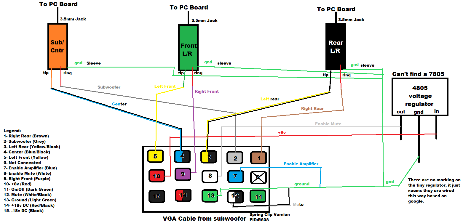

Hello,
I do realize it is 2016 and these threads are old, but would anyone be of any help: Here is my scenario.( A picture of my setup is attached)
My PID is R608 for the Z-5500.
Pins:
1- Brown (Right Rear)
2- Grey (Subwoofer)
3- Yellow/Black (Left Rear)
4- Blue/Black (Center)
5- Yellow (Left Front)
6- Not connected
7- Blue (Enable Amplifier)
8- White (Enable Mute)
9- Purple (Right Front)
10- Red (+8v)
11- Dark Green (On/Off)
12- White/Black (Mute)
13- Light Green (Ground)
14- Red/Black (+18v)
15- Black (-18v)
Anyways, I have them turned on and basically only the front left and right channels work. Cannot seem to get center/sub/and surround channels to generate sound.

Actually this did in fact work perfectly.... I simply had to update my sound driver for my pc lol.
