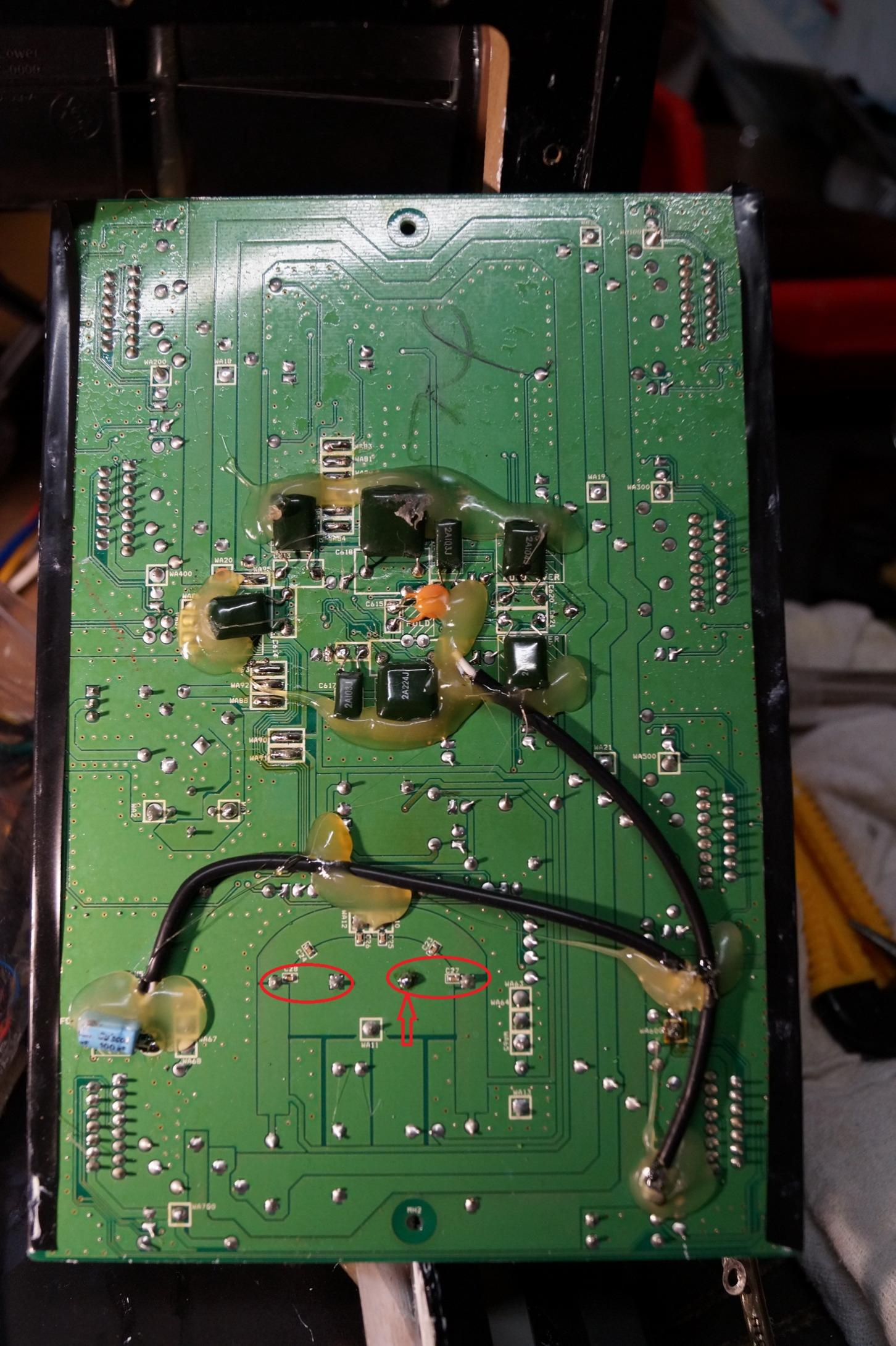

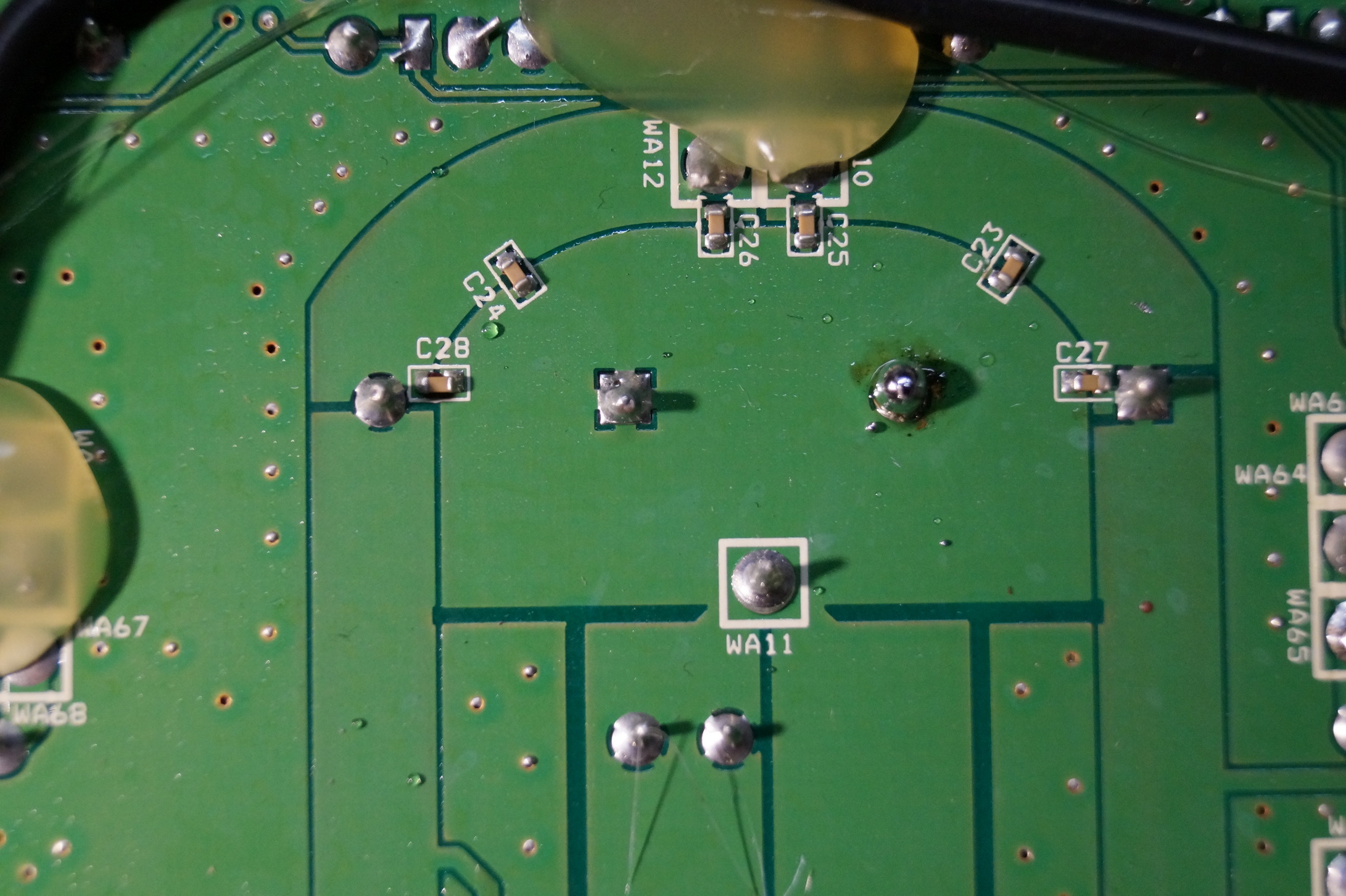

The only thing I didn't manage to get working without a workaround was the center channel. So I still had to connect +8V to center enable on the subwoofer board
When I opened my sub box to make this last modification I thought the solder point on the lower part of the board looked a bit tight to me, so I did some tracing and found that point goes through the board and then comes back out and continues on up to the top of the board and terminates at WA126. This is a much easier (and safer) place to solder.

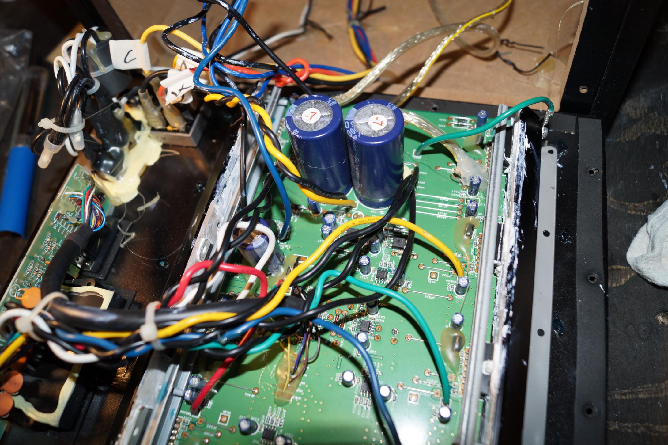

Well, my friends, I want to share one more experience that i had with good old z5500.
I came across a system with PID R818. The system was complete: subwoofer of course, control pod and satellite speakers. The problem was that when i turn on the system, immediately started a humm, very loud very very loud humm from sub and from satellites.
All of them. That made me think that something that is common for all amplifiers inside has gone bad. So the common for all chip amps inside is power supply. 50Volts DC. This comes from 2 biggest capacitors 10.000uF each. So i took a look from the other side and saw that one pin from one cap wasn't quite right. When i looked closely, the pin was free to move in its place. I soldered it and system works like a charm. I think that from vibrations these pins gets loose from time to time...maybe. Well that's it. I am also sending some pictures. All the best from me.

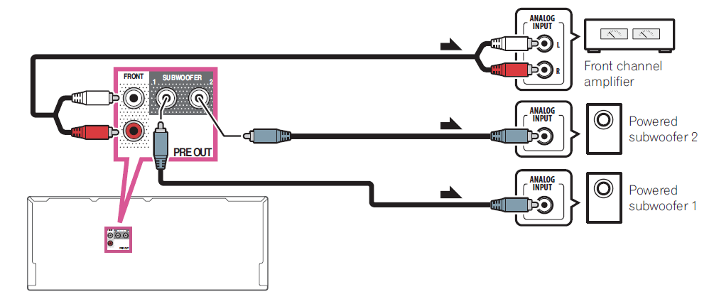

Everything seems to be properly connected. The questions:
Is the signal that you bring to z5500 allready amplified by the receiver or it's coming from a pre-out?
Do you hear sounds or music when you play them on z5500 (through a receiver) or not? what is exactly happenning?
What is the PID of the z system?
Thanks for the reply.
The signal comes from a Pioneer SC 1223 on the sub out port. I have no idea if that's already amplified, but I can't imagine that it is?
The subwoofer is actually playing when it's connected, and it sounds like it should. The only problem is that the receiver becomes unresponsive. When I measure the signal when it's connected it seems to draw it almost empty... I really can't describe what's going on. One thing is for sure: it's not right and I don't think it's any good for my receiver either.
My PID is (the M/N on the back of the sub right?) S-0115B
Well, that's strange. I can't imagine how can a pre-out signal draw the receiver empty. So, I'm sending you a picture. It's the back of your amp. There are two sub pre-outs. I think you can use any one of them. One chinch is for one sub the other is for the second. You only need one. If you connected it from here then and it happens what you described, i would try them separately. Did you try the receiver on other equipment and verify it's ok? At this moment i have no other possibility.
I have another custom-built subwoofer to test with. That works fine. I connect them both the same way. The other subwoofer also has a RCA cable running to the amp of the subwoofer which powers it. The only difference is that my receiver works fine with that subwoofer, and becomes slow to input with the Z5500 sub connected. The sub does actually work fine though... That's the strange part. Can it be due to interference from something?
I'm now stumbling in the dark.....the way i see it is this...the only connection between the z system and the amp is subwoofer preout. So that's the only point where the z sub can influence the amp. the only one. You said the amp works fine so we have to assume that the z system is interfering with the amp. What i would do is measure the pin 2 from the logitech sub with multimeter on dc voltage or ac voltage(relative to the ground). To see if there something there...but on the other side if there was something there that would interfere with the output signal. So that's like a long shot. The other thing is the ground from the signal. Maybe there something wrong with the lm7805 and brings something bad to the pin 13 but that would also proceed to the output signal and you said sub works fine. At this moment i have to get out..at this moment i don't have a solution. One more thing, but that also doesn't hold the water so to say. I had a system with PID R818 and i couldn't turn it on with this schematic on pin 8 and so on i could only do it on pre 636 PID systems. But yours is on and works.
