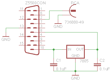

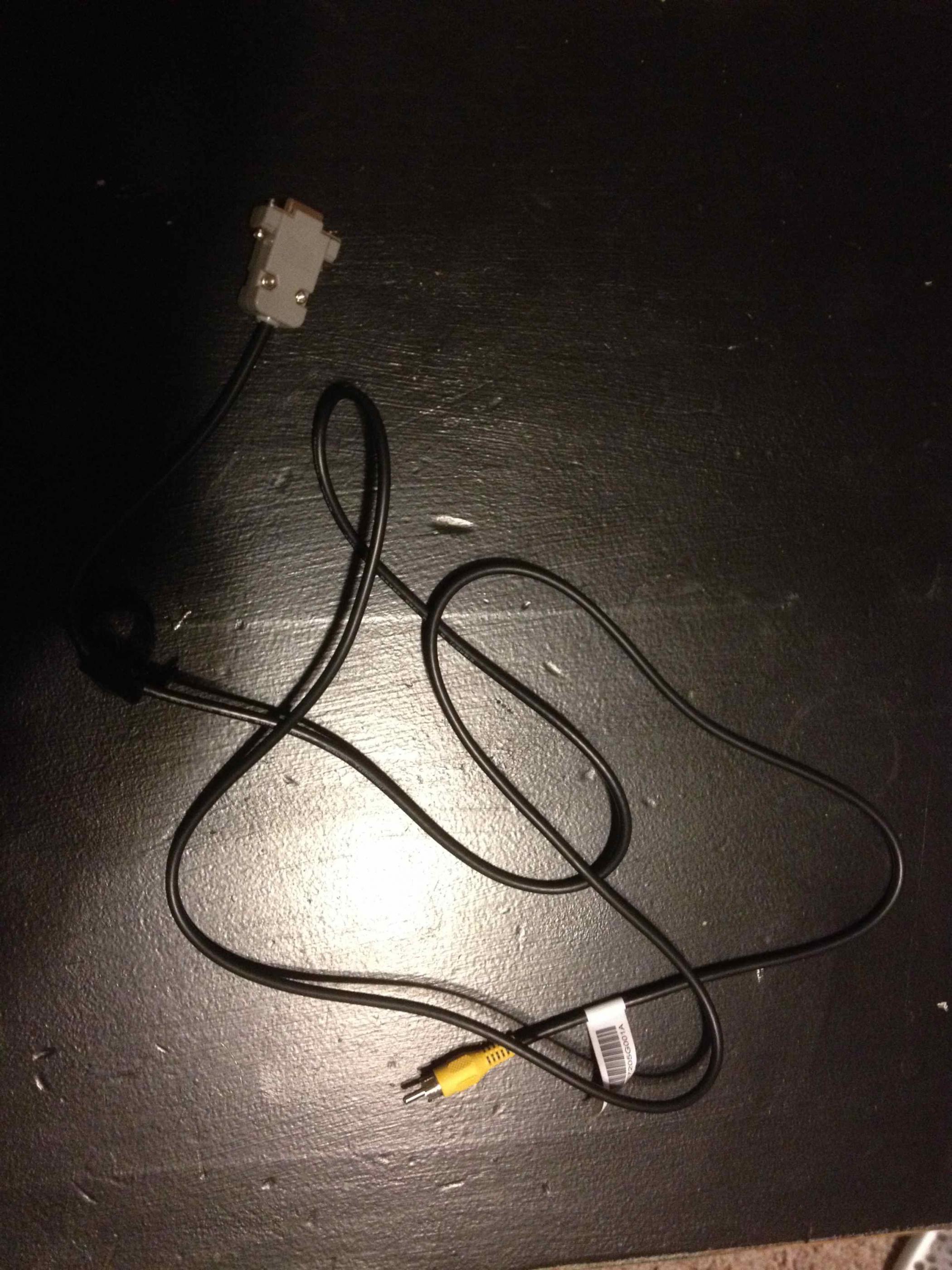

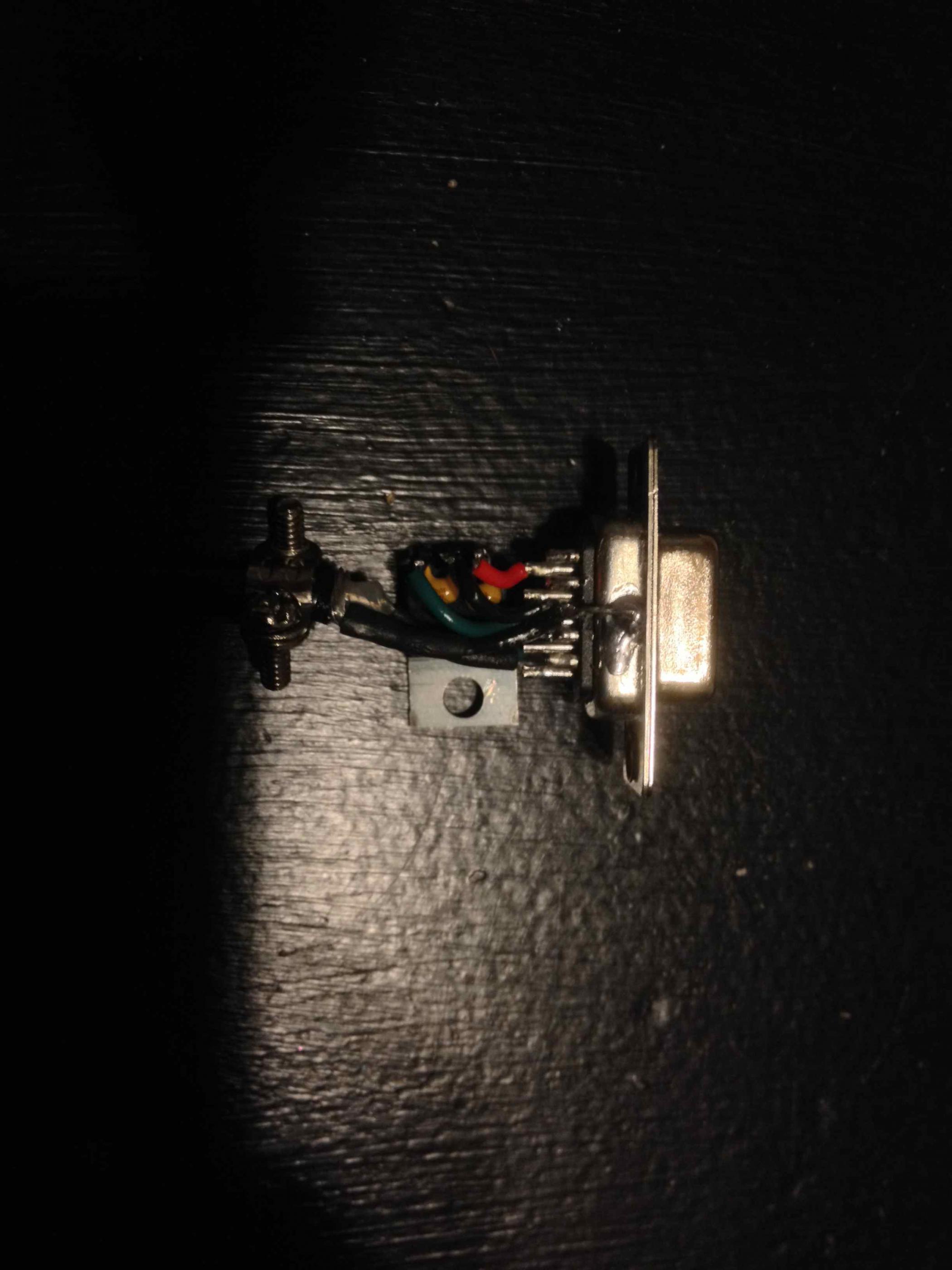

Thank you guys so much for this thread. I just made a sub preout adapter for my Z5500 (spring clip R540). I used the schematics from post 461 (along with others). To make the 5v for pin 8, I ran the 8v from pin 10 into a 7805 regulator (I had some laying around). I soldered it to a 15pin female dsub to avoid taking the sub apart (my pod still works, I just want to use the sub with a new receiver). The adapter works great as long as the rca plug pins are not left floating (left unplugged you get the nasty tone others have mentioned). I have attached my schematic for others to use if they want to build one. Thank you all for your hard work.

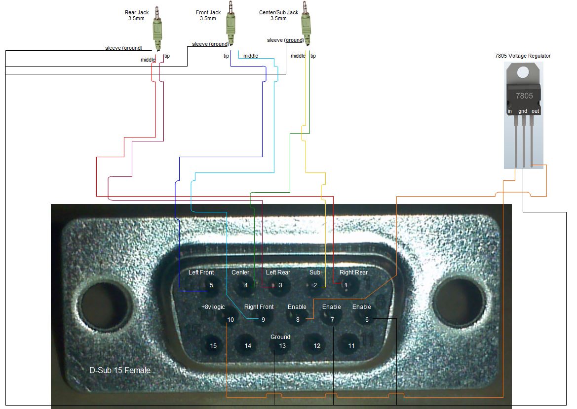

Bypass successful! Sound Card to Sub. pre-636
Thank you EVERYBODY for you contributions to this thread since 2007. Truly inspirational!
I too have a pre-636, spring-clip version Z5500 with dead control pod. My goal was to create a bypass cable going from my computer sound card straight to the sub, with no internal sub mod, and still having 5.1 surround, yes all six speakers working, including center and sub working perfectly, and independently, just like they should.
The posts that helped me the most were knexkid, Toffmonster, fluxarc , Sstevensn72 , and the final big puzzle piece, foodbag, the key being the 7805 voltage regulator, and not directly grounding pin 8. Thank you all for your help!
My bypass works perfectly, all six speakers. Front Left, Front Right, Rear Left, Rear Right, Center, and Sub all working, tested independantly using Realtek test screen where you can select each speaker and hear it play. I also added pots to control volume, just as everyone else recommended. I recommend too, as it is very loud. Here is youtube video of my bypass in action.
The only thing that I noticed was my D-Sub female connector numbering is backwards from what this forum suggests. I've attached my schematics for both no-pot, and with-pots. You can see my D-Sub connector with embossed numbers. They are definitely backwards, but this works great!
I hope this post helps someone like all of the others did for me. Good Luck!

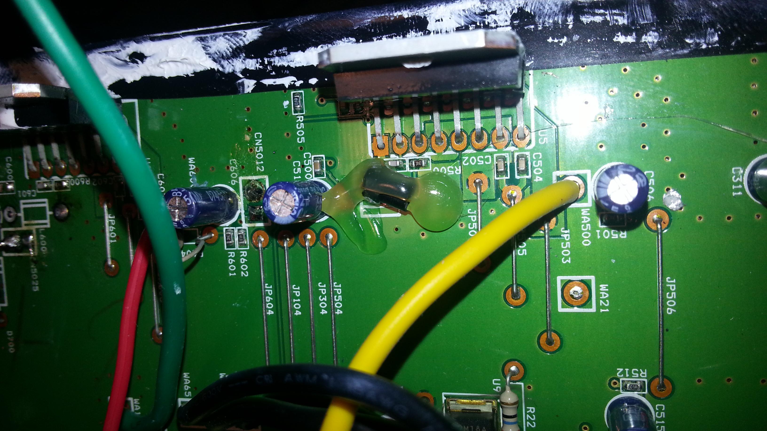

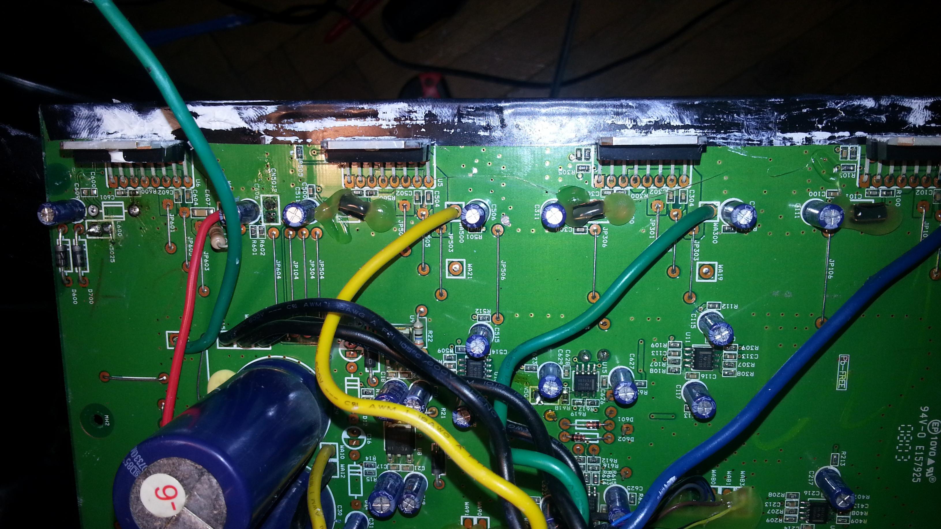

Hello all, first sorry if my question is not for this thread.
I have z-5500 speakers and for some time now the subwoofer starts and stops playing randomly, all other speakers are ok. So I decided to open the SUB and check what is happening. I saw L600 coil on the picture below is ripped from one of the sides. And the subs reacts on moving the coil, but when I moved the coil the copper wire has ripped completely. So My question is what exact kind is this coil L600 and also there is broken smd capacitor C600. What is the value of that capacitor.
Thank you.
