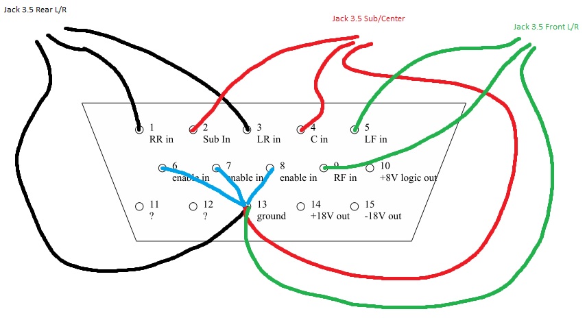

Hey guys! Thanks for the help, and as promised I have successfully made a cable to use the z-5500s with no control pod. I'll recap for anyone still a little confused on how to make this cable, as I was.
Parts:
d-sub 15 pin, 3 row connector and housing ~$2
two 25 feet 3.5mm (1/8inch) male to male stereo cables ~$10
soldering iron, flux, solder, patience
The 25 feet cables were cut in half to create 4 cables (3 are used, you will have 1 spare). So my cables are a little over 12 feet long.
Using the pinout previously found in this thread (I re-attached it for reference).
One the three cables for direct 5.1 audio:
-tip is center, rear left, and front left
-center ring is sub, rear right, and front right
-bottom ring is ground for all
For the purpose of this guide:
Cable 1: front left/right
Cable 2: read left/right
Cable 3: sub/center
Pinout (note this if for SPRING CLIP version of z5500):
1: Rear right in (cable 2 center ring)
2: Sub in (cable 3 center ring)
3. Rear left in (cable 2 tip)
4. Center in (cable 3 tip)
5. Front left (cable 1 tip)
6. Enable in (to pin 13, ground)
7. Enable in (to pin 13, ground)
8. Enable in (to pin 13, ground)
9. Front right in (cable 1 center)
10. UNUSED
11. UNUSED
12. UNUSED
13. Ground (input from pin 6, 7, 8, and ground from cable 1, 2, and 3)
14. UNUSED
15. UNUSED
Please note again, this is pinout for SPRING CLIP version. The pinout for the RCA version can be found in this thread.
In order for the subwoofer to properly function, you must enable bass redirection from you soundcard's preferences. PLEASE SEE MY NEXT POST I HAVE QUESTIONS REGARDING THIS
Please let me know of any suggestions/clarifications I can make.

If you read my previous post, this brings to me here. As I stated, you MUST enable bass redirection in order for subwoofer to properly function. Without it, it makes no sound. My question is, WHY? When I test channels from sound properties (with no bass redirection) the subwoofer properly responds, but there is no bass in music, games, etc until you turn bass redirection ON. Why is that? What exactly does that do?
Part 2 of question. I was thinking about getting this: Amazon.com: Logitech 5.1 Game Console Adapter Convert Rca Plugs To A Single 1/8: Video Games
This would allow me to use this 5.1 channel cable from stereo sources. Would I still have bass issues? Would the bass properly work if I used this adapter and plugged it into my TV, xbox, iPod, etc? That answer will determine whether I buy one of those adapters or not. Thanks for the help guys, and please let me know if I can make my little tutorial better. I feel like it's what noobs like me need in order to make one of those cables without having to sift through all 25 pages of this thread.
