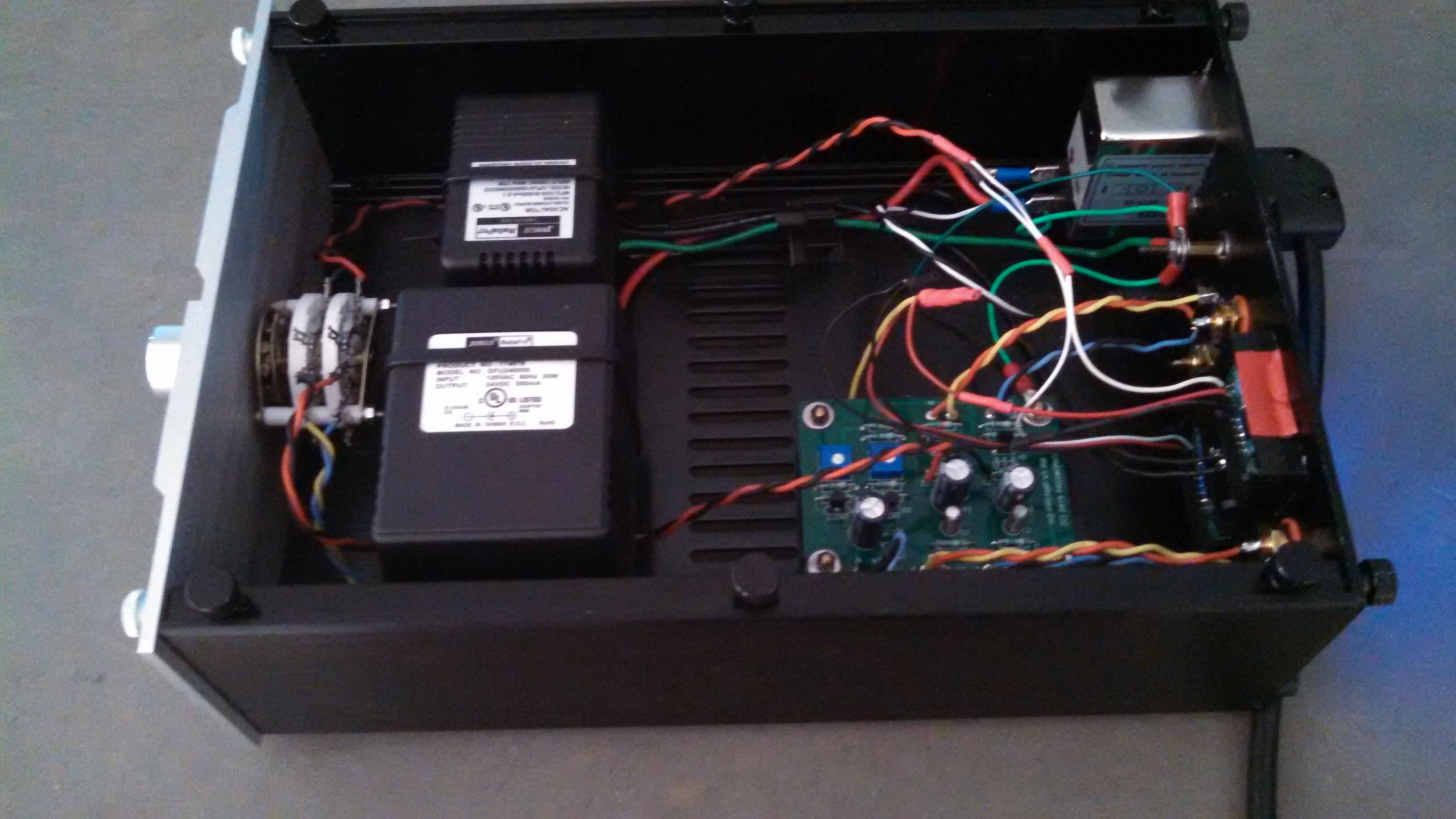

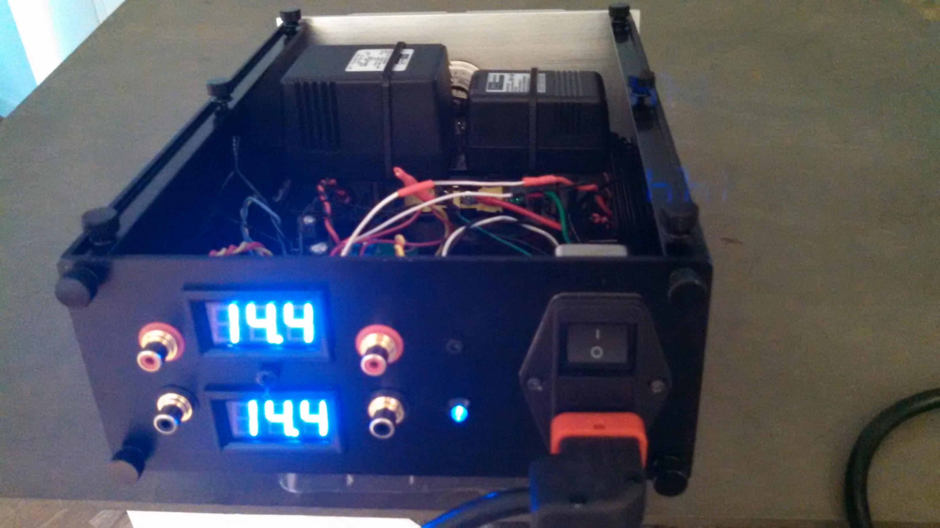

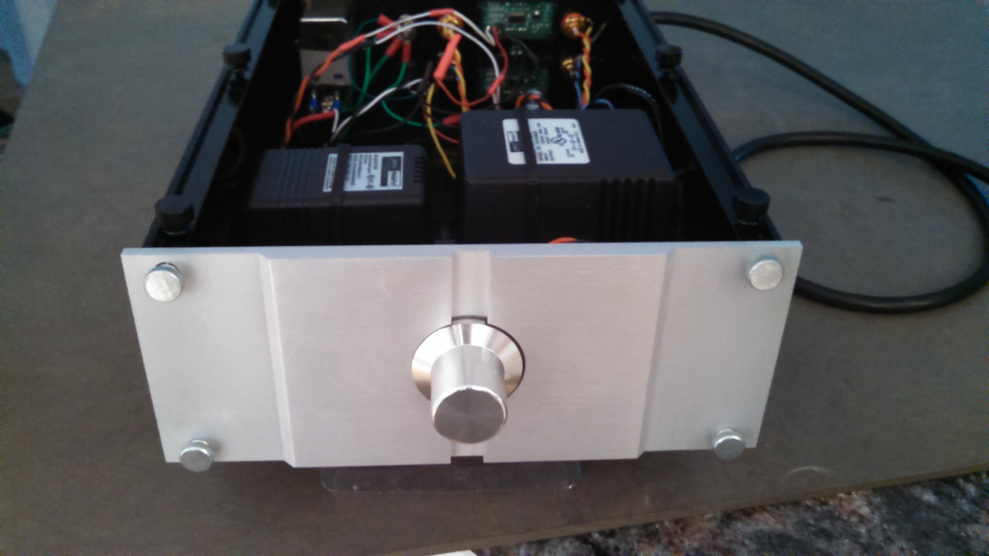

Had (mostly) fun building the 2nd generation of the Pass H2 Harmonic Generator and even found a knockoff "Pass-style" amp chassis to house it. Two wall-wart LRPSs are used for the 9V (LED meters) and 24V (H2 board) rather than purpose built supplies for each since that is out of my lane. A low profile duplex outlet was wired to the incoming 120V for the warts. A 2-deck rotary selector switch allows for monitoring the adjustment of the voltages of the 2 channels or the output of the two power supplies.
