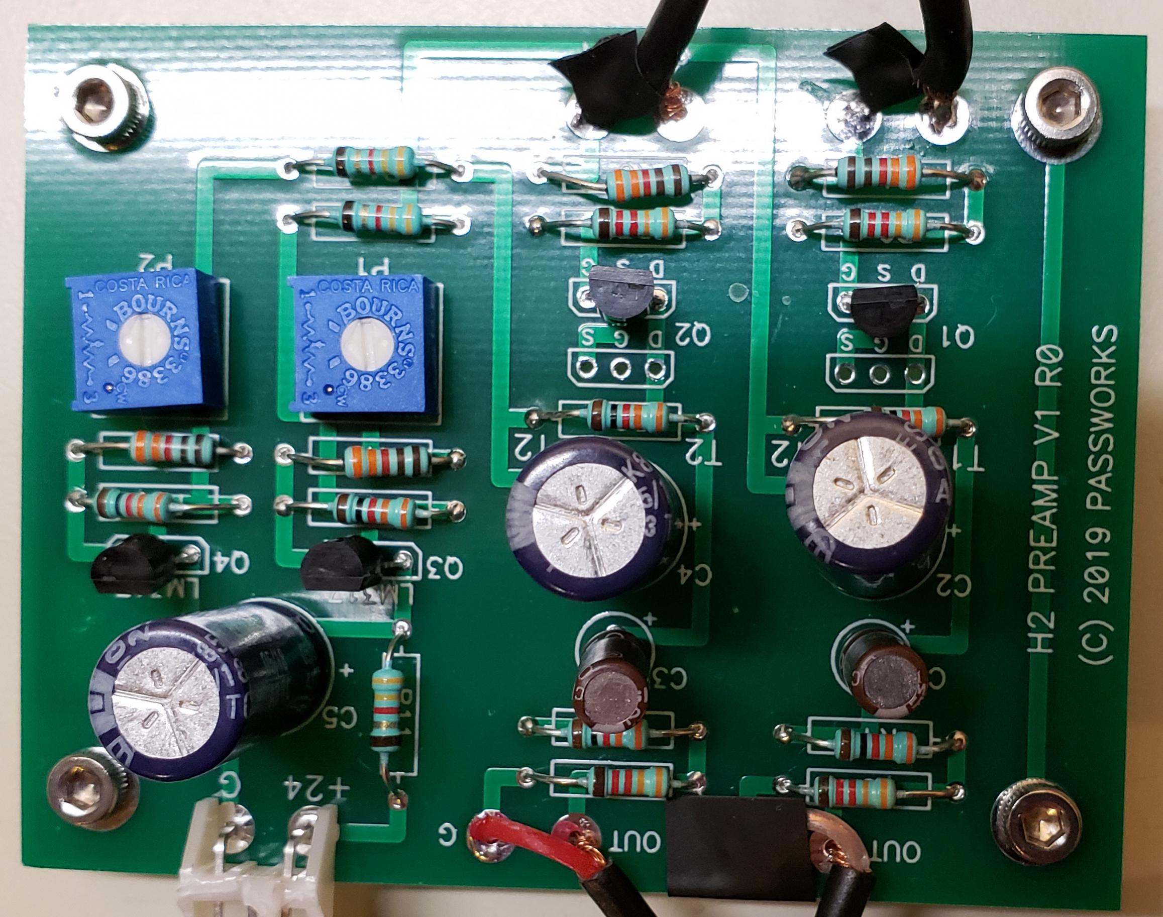

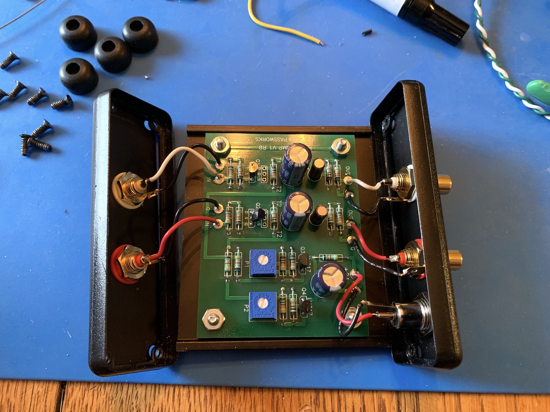

Just finished my H2 V1 build. Thought I’d share my challenges.
Took a few hours to stuff, adjust and wire it into a Hammond box. I’m not fast – an experienced builder could probably knock it out much quicker. On my initial test, one of the channels went silent after a few seconds of playing.
I checked continuity between the PCB outputs and cables – no issues.
Checked DC voltages – no issues
Swapped the JFETs (I used sockets). Problem remained on the same channel - so not the JFETS.
Inspected my soldering and found I missed one lead 🙂. Soldered this – no change 🙁. All the other solder joints looked good with no bridging.
Reflowed all of the points on the problem channel. Problem solved! 😀 Just because it looks OK doesn’t mean it’s actually OK.

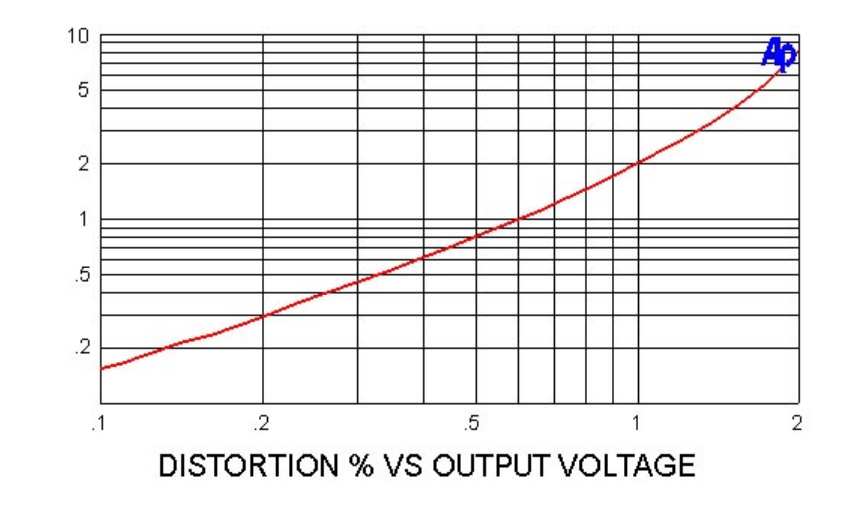

I used H2 (no volume control, standard build, gains, swap outputs terminals for negative phase) in line between a CD player and Whammy. I set H2 to 1% from the chart in the article. The distortion seemed excessive and volume level is much lower than without H2. Both channels are similar. Does this make sense ?

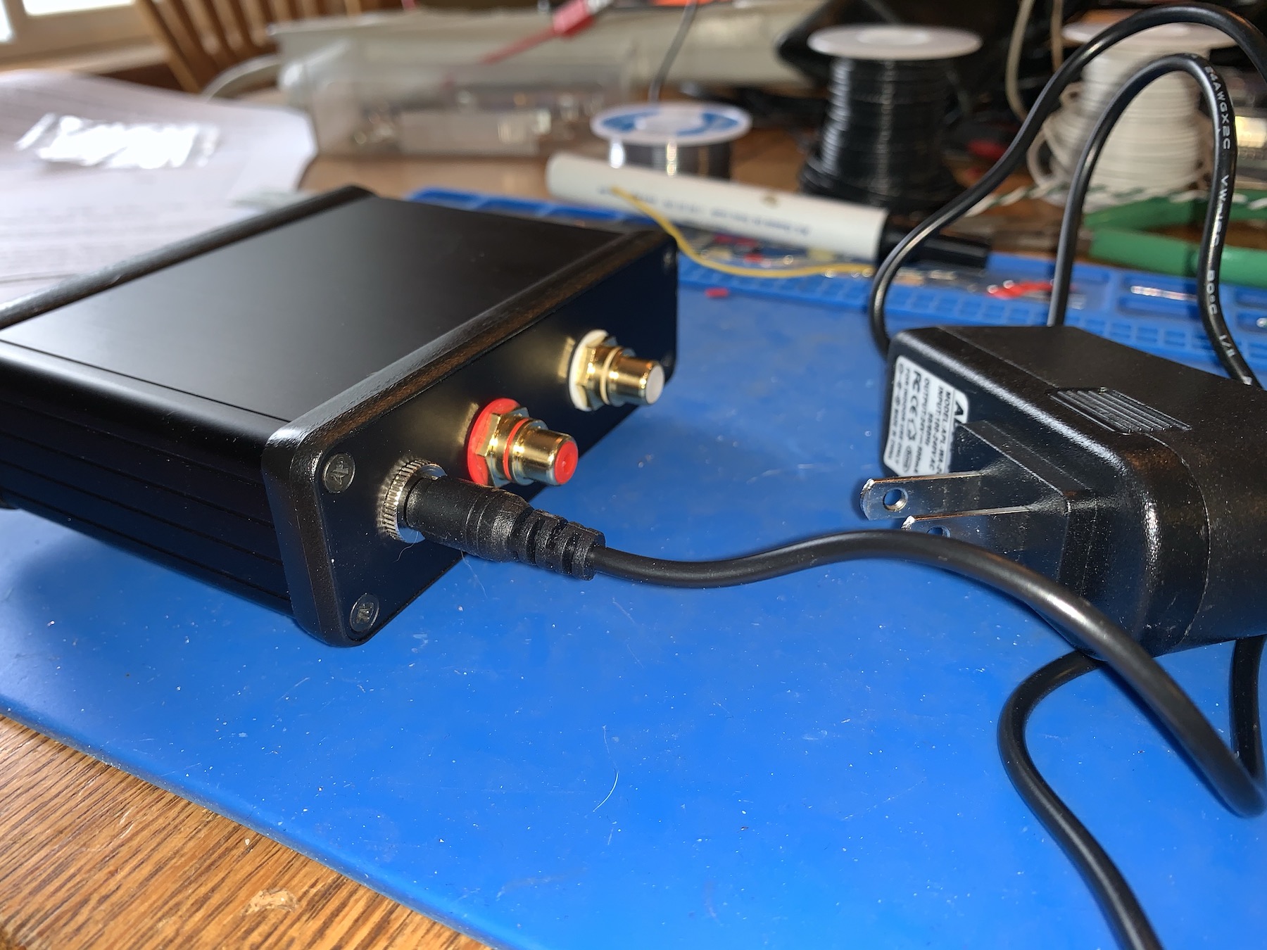

Damn! I got my rca connectors from Mouser today and they don't have washers to isolate from the chassis!!! I don't remember ordering them separately for my Pearl 2. Any suggestions on how to jerry rig so I can plug this thing in?
I went through the same issue with a build. At the end of the day, it was simpler to just order connectors with insulating washers. I had trouble finding a non-conductive washer with a large enough inside diameter. I ended up ordering from Parts Express.
