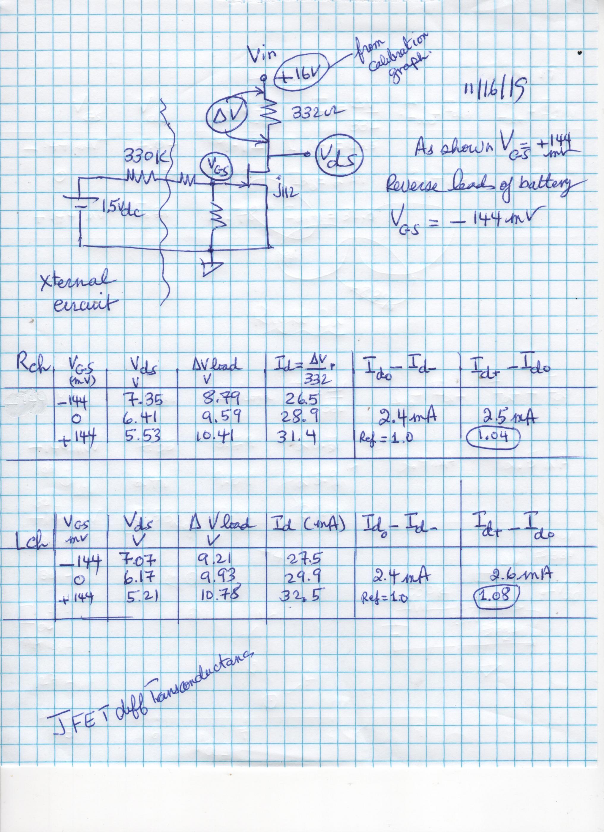

Thanks Mr. Pass for your comment. You inpired me to do this following experiment with my H2 Preamp V1 [H2 V1]. The purpose is to understand the synthesis mechanism of H2. Maybe useful for calibration and matching the two channels.
1. The useful and suggested output of [H2 V1] is 1 V rms. This the same as 2.8 V peak to valley of the AC signal.
2. [H2 V1] has a voltage gain = 10. So the input signal at the gate of JFET is 0.28 V peak to valley. Or +0.140 V peak at the gate relative to the source which is at zero volts. My supposition is its positive-going value causes the FET to operate in the enhancement mode.
3. The minimum value of the signal's valley is -0.140 V at the gate relative to the source which is still at zero V. My supposition is the FET now operates in depletion mode.
4. [H2 V1] is a DC and an AC amp. I can easily drive its gate with a +/- 0.140 Vdc. And note the resultant voltage drop across the load resistor. Will this voltage drop across the drain resistor at a [+0.14 V] gate drive be equal in value across the same resistor due to biasing the gate at [-0.140 Vdc instead]?
I have already inserted [H2 V1] between my SONY CD player and my Threshold S/150 power amp. The resultant sound [c/o ADS L730s] due to H2 negative phase is highly detailed, delicate; dancing and very satisfying. I still have to reverse the leads of the speakers for sjubjective comparison.
Best
Anton
The attachment describes the circuit I used to study the JFET; in order to understand the synthesis mechanism of its resultant H2. I had fun learning/analyzing it.
1. JFET operates as a DC amplifier
2. A 1.5Vdc [AAA battery] and a series-connected resistor [330 K] generate a [ +144 mV] bias voltage at the gate of JFET [Vgs]. A [Vgs = -144 mV] is obtained by reversing the leads of the battery in the same circuit.
3. The two values of Vgs = +/- 144 mV are frozen snapshots of the AC signal at its peak value and at its minimum value.
4. The two tables show the resultant voltage measurements in the circuit for the Right and Left channels. I am seeking matching data!
5. Delta V is the voltage drop across the 332 load resistor at the drain port of JFET. I calculate the drain current by dividing this Delta V by the load resistor.
6. The calculated results in the last two right columns are the significant answers. They effectively say that for either channel; focus L ch :
6a. A value of 2.4 mA is calculated by subtracting drain current at Vgs= 0 from the drain current due to Vgs=-144 mV. I then calculate a value of 0.80 V by multiplying 2.4 mA by 0.332 K load resistor. The resultant value of [0.80 V] is the absolute minimum value of the "equivalent" AC signal.
6b. A value of 2.6 mA is calculated by subtracting the value of drain current due to Vgs = +144 mV from the drain current due to Vgs = 0. I then calculate a value of 0.86 V by multiplying 2.6 mA by the value of 0.332 K of the same load resistor. The resultant value [0.86 V] is the peak value of the equivalent AC signal.
6c. I carefully draw a sine AC signal which has a resultant peak amplitude = [0.86V]; due to its positive- going segment in the time frame of 0 to T arbitrary. I carefully measure the area under the curve of this segment and call it A+.
6c. I continue drawing the negative-going segment of the AC signal which bottoms at [- 0.8 V]. The resultant area under the curve of this segment spanning the later time T to T1 is called A-.
6d. The area A+ is larger than the area A-. This is exactly the teaching of Mr. Pass in his H2 article:
1. {The input signal to JFET [Fundamental] has the area under the curve of its positive segment equal to the area of its negative segment.}
2. { Any difference between the area of the positive and negative segments is called H2; or a Fundamerntal frequency that is enriched with an internally synthesized low level double the frequency of the parent.
3. {I described in my example an H2 Positive Phase}.
The above verbiage is distilled in this simple statement:
The transconductance of this JFET during the positive Vgs drive is larger in value than the transconductance of this JFET during its negative Vgs drive. It has a non-linear amplification.

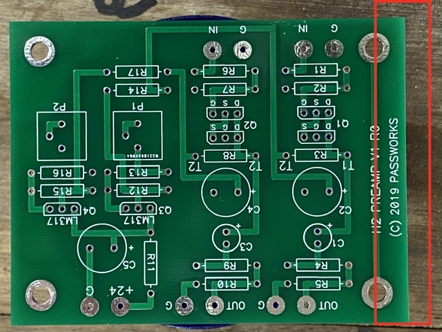

Looks OK to me Roo2, looks like you are cutting off 5mm to suit the 75mm slot width in the Hammond Box - they are nice small enclosures by the way. No other pcb tracks will be interfered with it seems. Go for it I say.
Are you getting that locally or from an OS source?
Gary..
Just over $30.00 AUD from either RS or Element 14 here in Oz plus freight.
$25.00 AUD from Arrow with free delivery from the US for orders over $50.00 USD. So if you need some other components, then an order to them is worthwhile. Mouser is much the same but minimum $60.00 AUD order value for free FedEx delivery. I buy most if not all parts from either of those 2 suppliers. Arrow, can be very cheap at times on semi's, pays to shop around. For instance,I got some Infineon IRFP150 Mosfets (ZM's favourite) from Arrow at less than half Mouser's price 2 weeks ago.
Gary..
