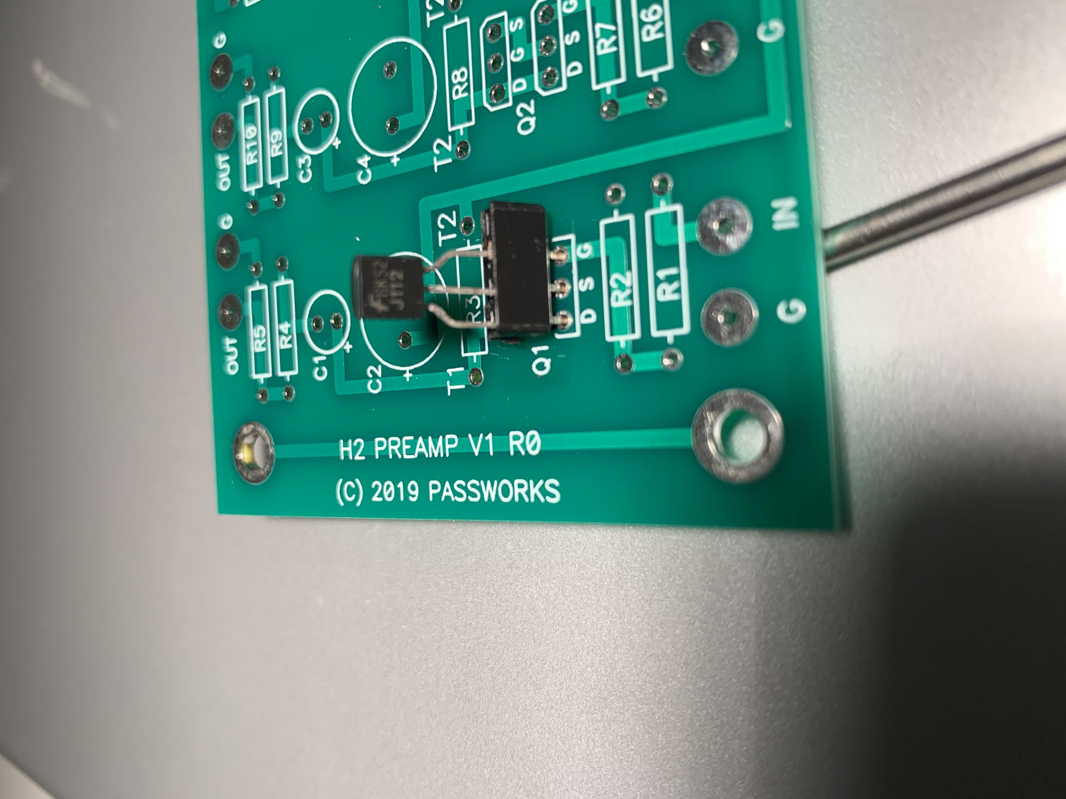

Thank you Nelson for your generosity, I just received my H2 kit in the mail, great birthday present for me (11/11).
Hello hifibluedevil. My thanks to Mr. Pass for his generosity, and for sending me two kits of H2 Preamp V1.
I have assembled one kit; easy but ran into this particular trouble. I did not check the pinout of the enclosed FETs [Q1 and Q2] before soldering in place.
The PCB shows two possible positions for a FET. The one close to the 1000uF capacitor [position 1] has a a bottom-view pinout which is [D G S]. The one below it [position 2] has a botton-view pinout which is [D S G]. The two positions are not the same. I made the mistake of soldering the supplied FETs [D S G] in position 1 which is[ D G S]. Didn't work for both channels and no damage was done to the FETs. Drain current was ~ 1 mA
I desoldered one FET [D S G]; like a dentist pulling a wisdom tooth. I put it in its proper position 2. This channel works.
I lost the other FET; Its leads were delicate and I was rough. So I borrowed one FET from the second kit and put it in position 2 where it belongs. Both kits showed awritten Pinch-Off voltage equal to 2.79 V. for the 4 FETs. I was safe!
I will send you another pair.

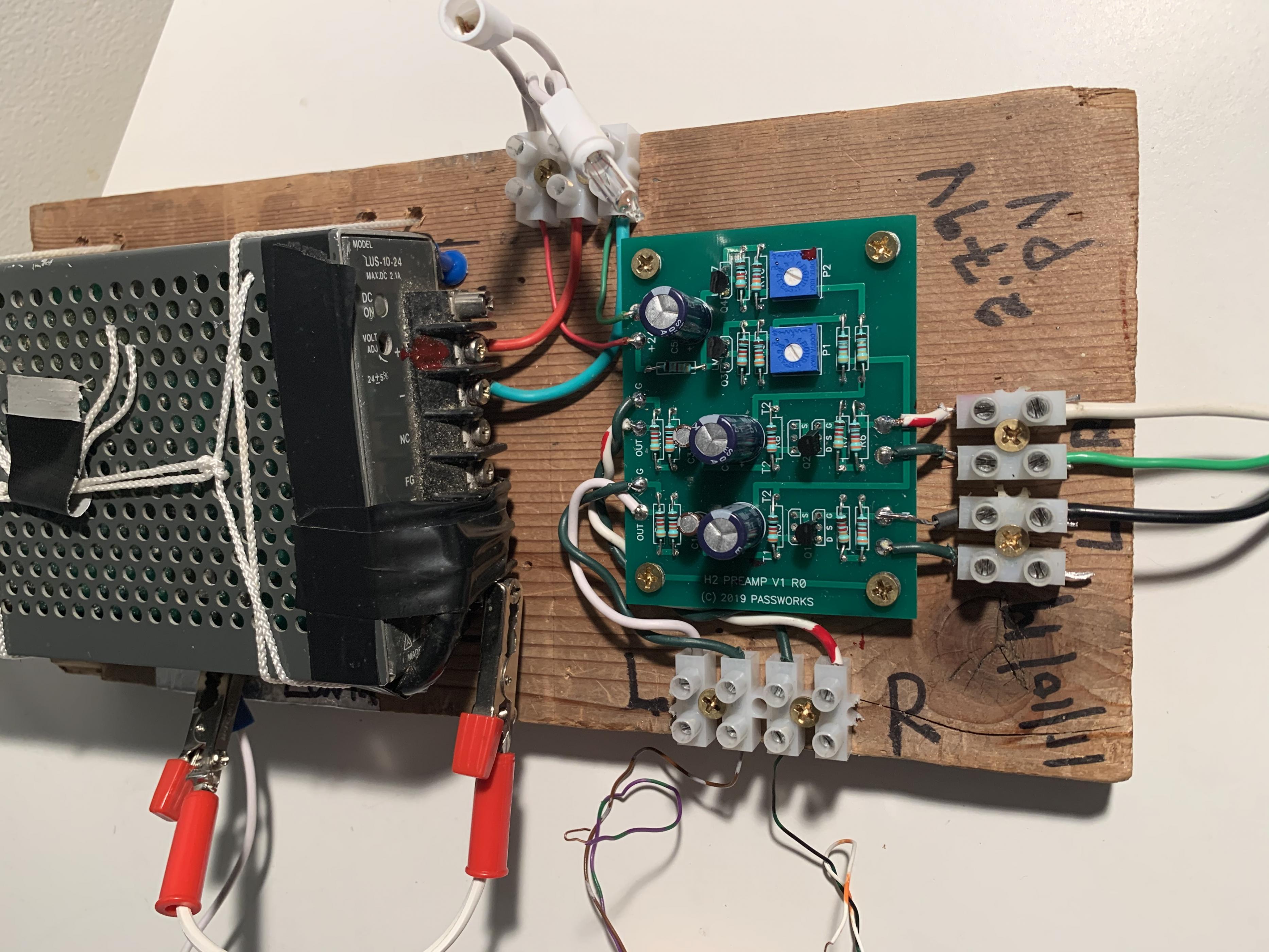

Picture of build
The picture shows my build of H2 PREAMP V1 R0. Its assembly was easy and straightforward. I could use more practice soldering/desoldering. Pay attention to the bottom-pinout of the enclosed FETs [Q1 and Q2] . It must match the required insertion points on the PCB. Please see my earlier post.
The 24 Vdc PSU is an oldie. The shunt of the aligator clips connects its body/case to power ground/earth. Its voltage output is {transformer} isolated from the higher voltage front end.
Its voltage output is fused with an X-mas light bulb; which is expected to blow at ~200 mA. The bulb lights up briefly on turn on.
I drove the input of H2 V1 with the headphone output of my laptop. I listened to the output of H2 V1 using my Grado headphones [32 Ohms]. It work very well; but I needed to raise the volume on the laptop output to get an adequate sound pressure. Understandable; because H2 V1 has a high a output impedance, and works as a current source amp to the lower load impedance Grados.
The build did not achieve the suggested Pinchoff voltage [PV] of 2.79 V. The Left channel FET had a minimum PV =3.10 V at a drain current ~30 mA . It was calculated from the voltage drop [9.83 V] across the FET's load resistor [332 Ohms]. The minimum PV for the Right channel FET was 3.38V, at its drain current of ~29 mA.
In order to attain the required PV of 2.79 V, it is possible [for me] to increase the value of the resistors in the schematic [R14 and R17; each equals 33 Ohms]. Or the output voltage of each regulator needs to be decreased.
I'll collect more data on the build as is and report.

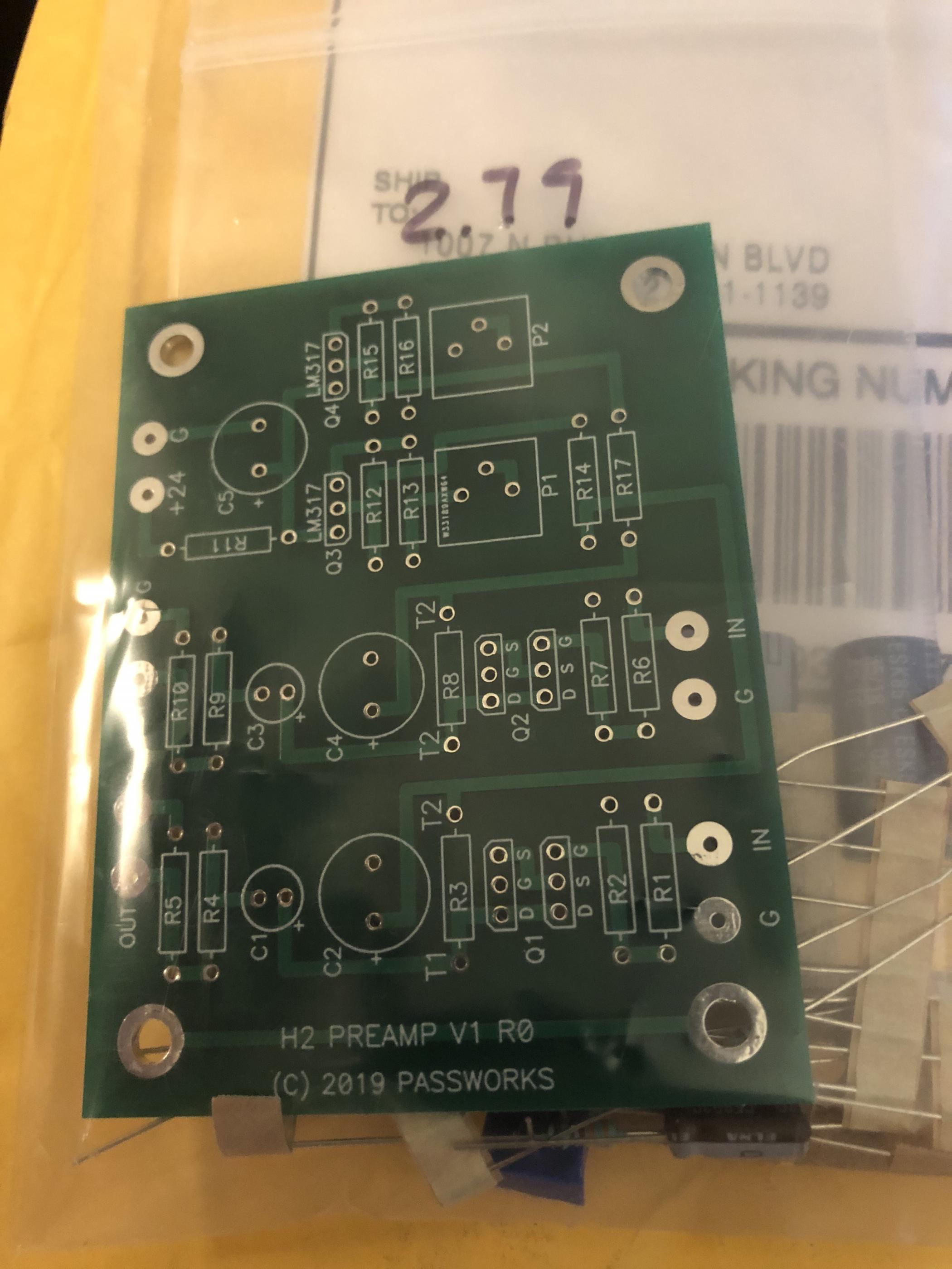

The FETs [Q1 and Q2] in the H2 V1 kit are very valuable; like it because PASSWORKS has already done work to match them up from a large collection of FETs for this application.
The attached photo shows a possible approach by the DIYer to safeguard the FETs, and to do its own FET testing matching under dynamic conditions.
I cut an 8-pin DIP OpAmp socket into two subsockects. I filed off the excess plastic. This socket is to be soldered to the PCB and the FET [J112] is then inserted for testing or left in permanently.
I hope this trick may save heartburn in assemling the kit.
Perhaps there is some confusion. The Vp on the J112's is achieved by
placing +12 on the Drain, grounding the Gate and using 1 megohm
series resistance from Source to Ground. The Vp is the resulting voltage on the Source pin. The Drain current is a couple microamps.
This is used to decide what the rail V+ voltage should be on the supply
voltage at the test points as referenced by the curves in the article.
