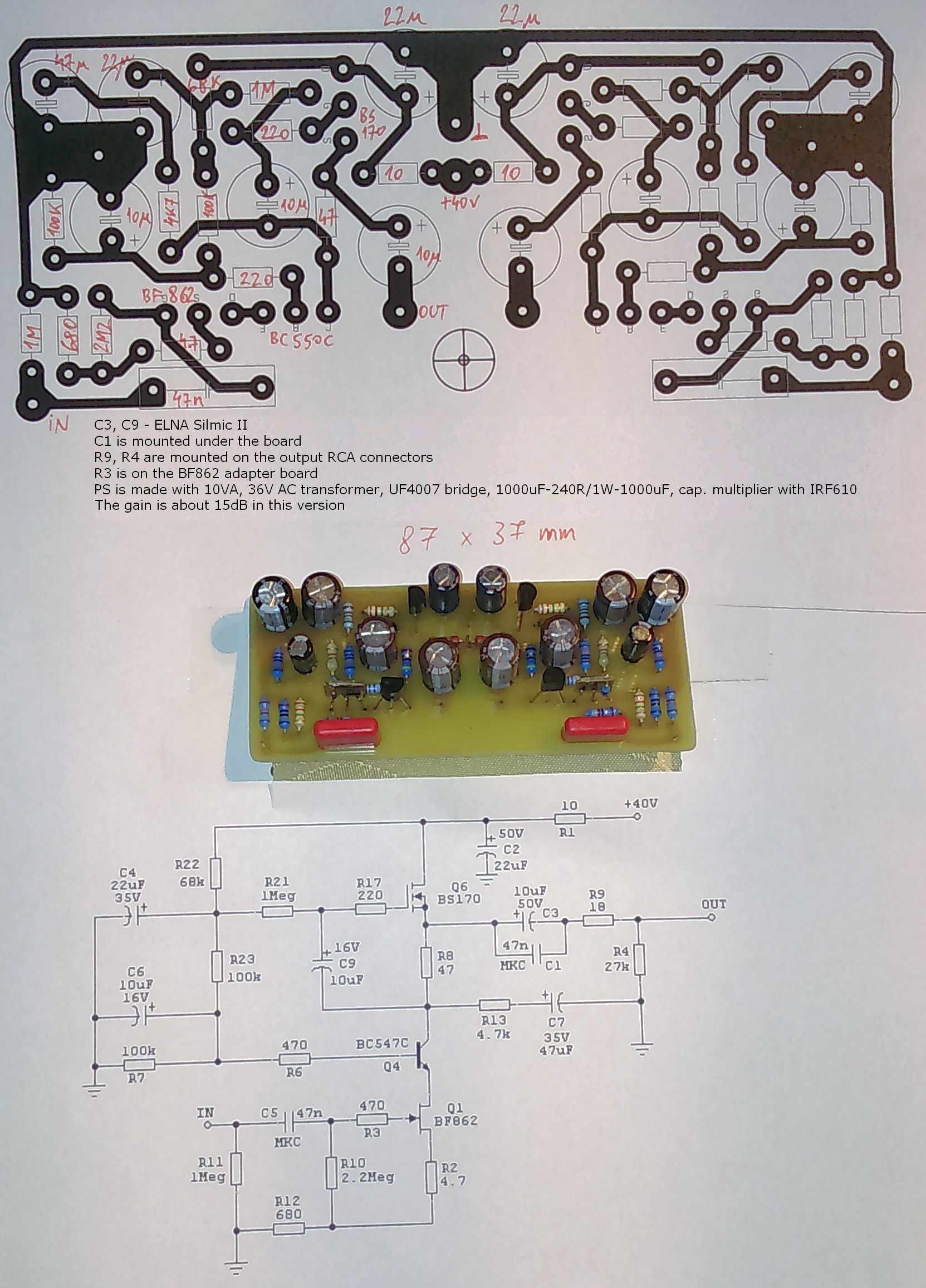

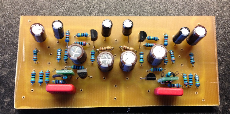

I have run the amp today. I does play music, but I have very high level of hiss/somewhat white noise.
I have had issues with noise in a different amp before and it was due to some zeners from China.
Here I am pretty sure my jfets are from a trusted source (RS Components).
I am not absolutely sure where the BC550 comes from.
In my version I lowered R13 to 3K3 to lower the gain. Also my BF862 Ids was some 17mA as far as I remember but I did not increase the source resistor. Could it be the problem?
I should add that I am running it form a printer power supply just as Juma with a capacitance multiplier (I tried to bypass the multiplier to see whetehr it is injecting noise, but the hiss was not gone but I obviously got hum. I also tried a regulated linear PS and the effect was similar. So it seems the noise is in the preamp).
The volume control is 10k.
Here are my values (in reference points provided by Juma in post #54)
1. across the R2 (4R7) - should be about 50-60mV I see 60mV
2. across the R8 (47R) - should be about 500-600mV I see 600mV
3. between the source of Q6 (BS170) and the GND - should be about 27V I see 27V
4. between the base of Q4 (bc547c or bc550c ) and the GND - should be about 13.5V, I see 13V
5. the Vgs of Q6 - should be about 2.3 V I see 2.6V
6. the Vbe of Q4 - should be 650-700 mV I see 600mV
7. across R12 (680R) - should be about 7.5V, I see 9.7V
8. across R1 (10R) - should be 100-120 mV, I see 140mV
If anybody has any idea let me know. I would prefer not to desolder active components one by one and replace them blindly.
Edit: As a temp solution I lowered the gain to 5.7dB (the hiss is still there but less annoying). In fact I can use the volume control better now. Can I reduce the gain even further without ill effects? My normal preamp is B1, so I do not need gain at all.

Gregje,
values you measured are close enough and you can adjust them more to your liking (it's already explained in the thread).
As for the noise, I don't know what causes it in your build, you got to hunt it down ...

Gregje, you have some very large resistors there on the input. 1M ohm and 2.2M Ohm, also the 2.2 seems to be a 5% type so I would think it would not be a "low noise" one and probably carbon comp.
Any reason you are using such large values here? I looked at Juma's original circuit and it has much more "normal" looking values.
The higher the resistance the higher the Johnson noise, this is especially so for input and feedback resistors....

Hi Winternute,
You are probably referring to the original schematics at the beginning of this thread.
The final version is in posts #24,#37 and the attachment of my post above. It says 1M and 2.2M. Having said that I agree with your comment that the higher the resistance the higher the noise. On the other hand reading Juma's posts (in general not only here) I would assume his circuit works without fancy parts.

Tried replacing bc550C with another npn and bf862 with 2sk170 (all my bf's are from the same batch and both channels hiss so there is little sense trying a different one). No change in both cases.
All my bs170 are from the same batch again, so need a different batch or an equivalent.
And then to passive elements...

That's not going to work very good. It was meant to add the gain and you don't need it with mini-A (20 dB gain) and 95 dB sensitive speakers.... I lower the gain of Juma's preamp to below 6dB.....
What you need is a buffer that sounds better than B1. There's many of them, one that you can you easily make is this one (first sch. in post #66, buffer is on the right hand side of C7):
http://www.diyaudio.com/forums/pass-labs/244106-lsk-pre-baf-2013-a-2.html#post3682031
That buffer will work at lower voltage too (say +/-12 or 15V) but in that case the value of R19 has to be increased so that we get about 3-4V at the base of Q7.
