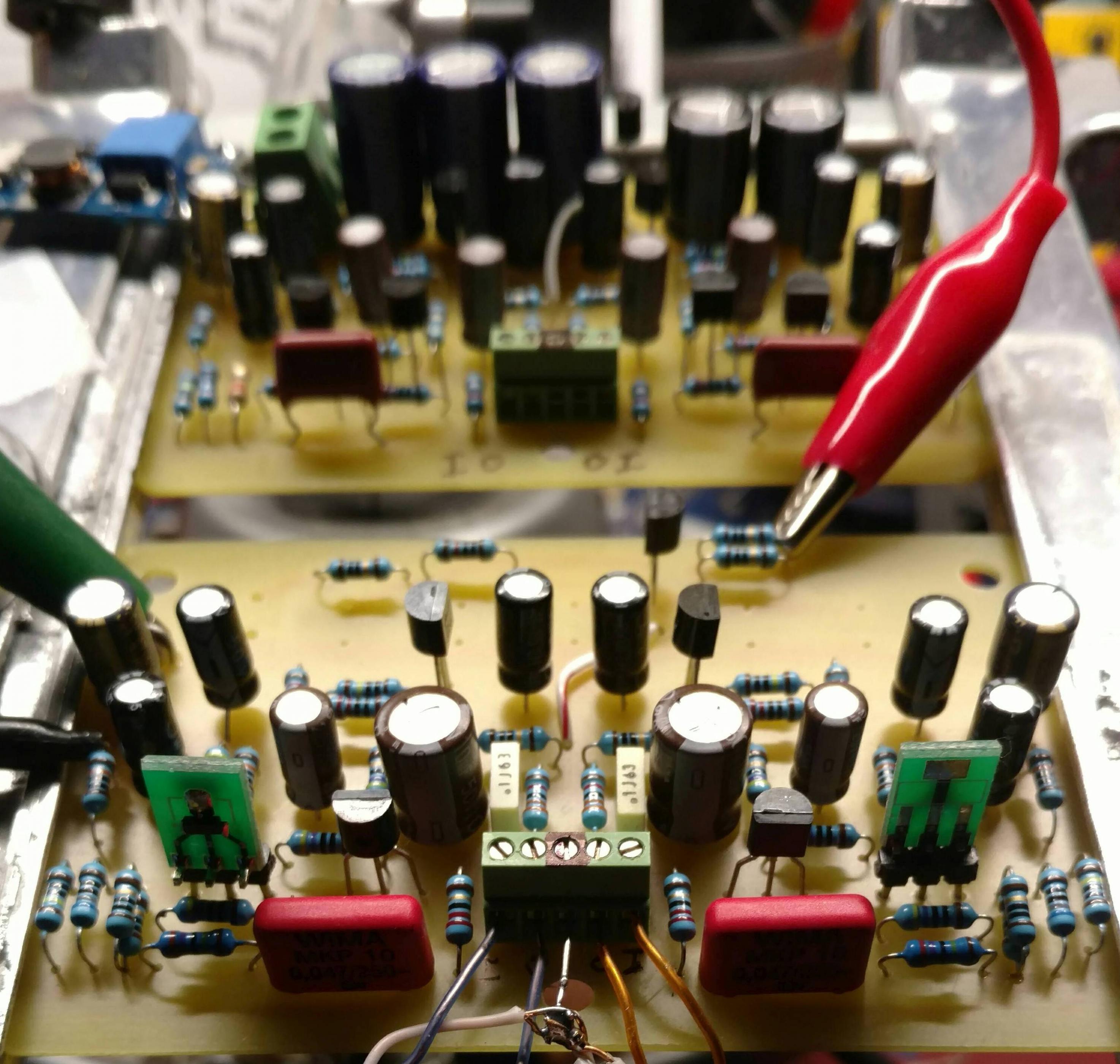

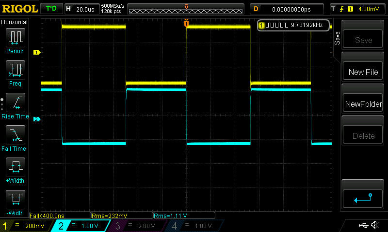

An update on my build:
I swapped in a fresh Fairchild BS170, but it didn't make any difference: Unchanged THD (so-so), and distortion residual/harmonics (nice).
I have lowered R13 to 3K2, which lowered the THD to 0,12% with 0,3V input, which I find acceptable given the nice H2 shape of the distortion. Gain is now x3,8.
The THD rises almost linear with input amplitude, so not a good idea with super hot source. My BF862 are 13,2mA IDSS.

Next step: I will put the amp in a case with a PSU, so I can use it in my living room and do some subjective testing - i.e. listen to music 🙂

Just "for the record": I am well aware that THD level has no direct correlation to (perceived) sound quality. My focus on THD was mainly to be certain that I had built the amp correctly according, and that both channels were closely matched in objective performance. Then after you said that my posted THD was an order of magnitude to high, I tried to lower it by swapping some components and adjusting resistor values as suggested.
I understand your concern now but I still wouldn't worry too much. Our measurement setups might differ too - in that moment I had DS360 and HP339a at my disposal so I played around with it for a while...

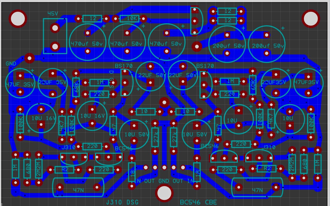

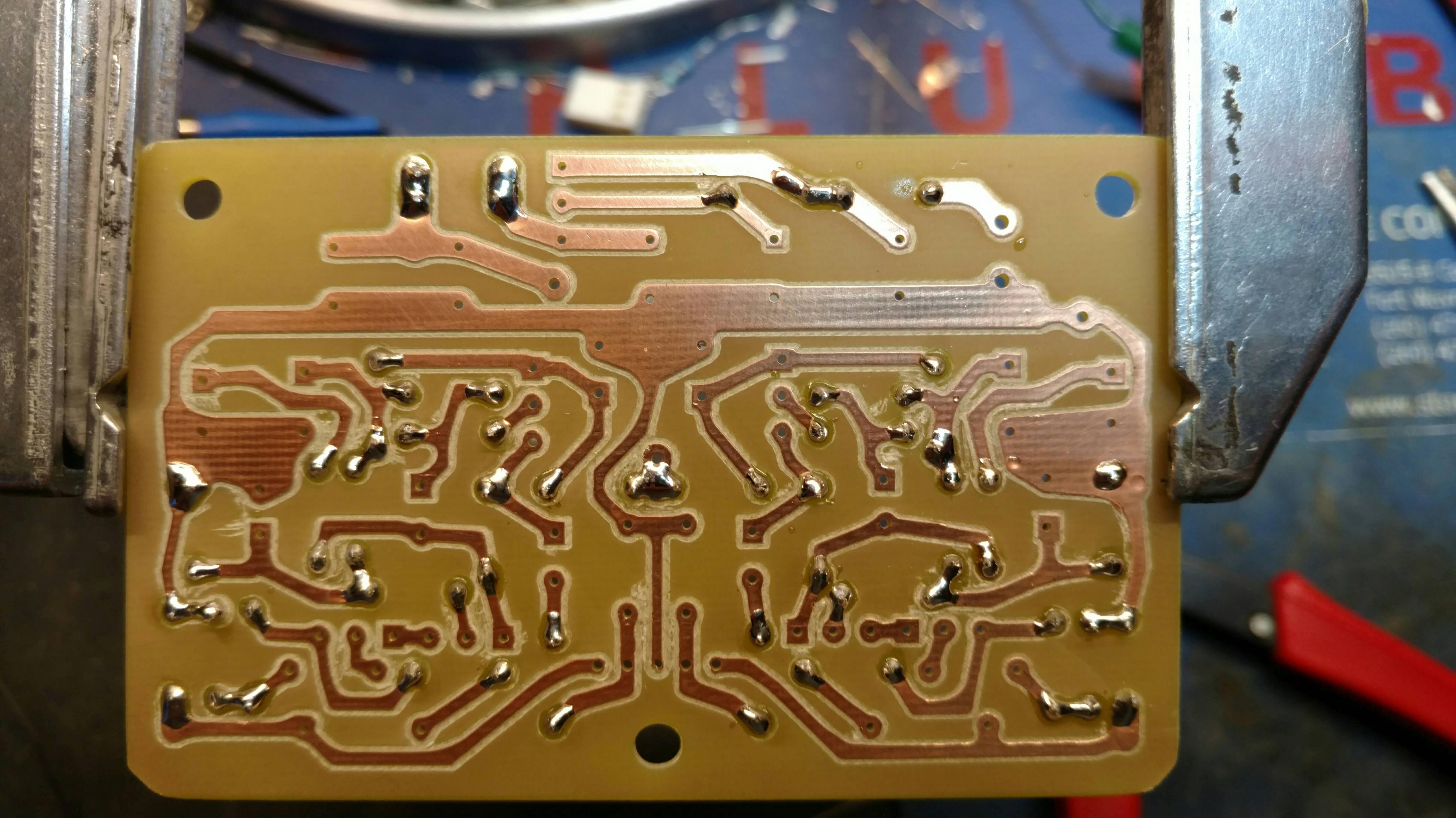

I have made my pcb's today.

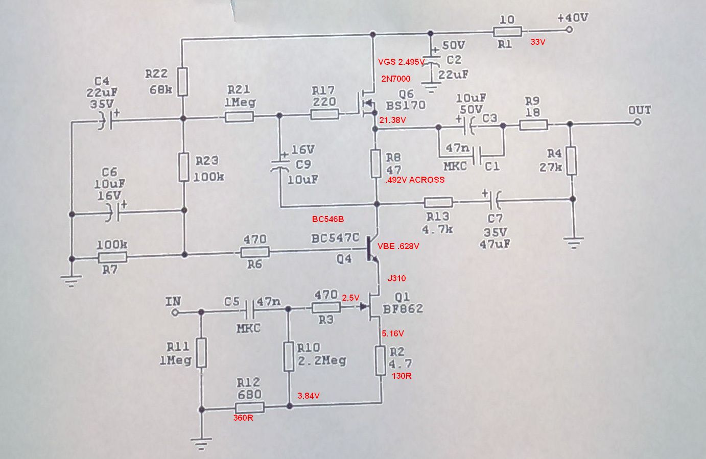

I've ordered bs170 and bf862, better input caps, and made a board to try out.
while waiting I used closest parts I have and it works at least,
2n7000 for the bs170 and J310 for BF862, Followed post #37 schematic.
The plan is to use a printer supply for now and try a linear supply later.
the J310 is not set up right as gain is unity, will try other values tomorrow.
with R12 of 440R the gain is 3.5x but current goes from 12.5ma to 19ma using 35V bench supply.
I would like to find a use for those J310's as I have a few..
one person already made fun of my crooked 1R jumper so feel free to also🙂
so far this is what I came up with following Juma's example.
To set the J310's Id to 10-12mA you'll have to change R2 to 120-180 R, depending on its Idss.
I made this for BF862 which differs a lot (low Vp, high gm...). Try some load line optimization, but that will change the rest of the circuit a lot.

Here is what I measured, also noticed that even a DMM loads the circuit enough that numbers don't quite add up when you measure volts to ground (B C E) and compare to VBE
I will build a new one with the correct parts when they get here.
This practice one is much closer now I believe, and the gain is 6.5x
Who knows I might even like this but its far away from what you laid out.
I don't yet understand load line optimization, no worries I will keep reading "the sweet spot" and
staring at the curvy charts in the data sheets. 🙂
Numbers look ok for 33V supply voltage. If the gain is too high for you, try lowering the R13 and/or raising the R12. Don't forget to listen when you change something - I'm sure you'll find what you like...
